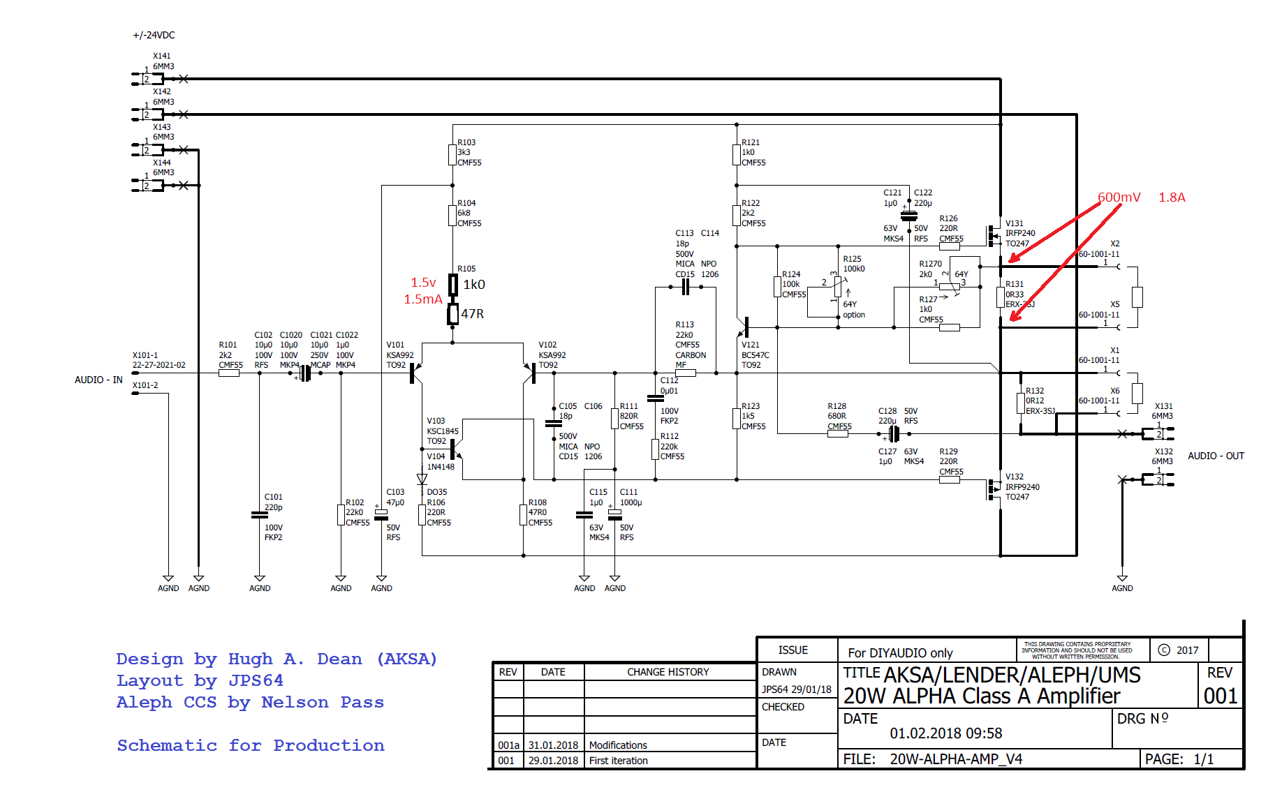

It is designed for 8R with dips to 6R. However, it will run with a 4R load until it current limits, which would be at around 3A. This would be a peak of 12Vp, which is around 18W. If you wish to take it to more output, essentially you need only increase the quiescent current, to about 2A. To do this, change only the R131 resistor in the source of the nmos to 0.3R. You can optimise things more than this one resistor, Danny from Belgium has done a lot of work on this and in this thread you will find his table which lays out the changes for optimised power.
BUT, I would suggest you leave it as it is and simply move to efficient 8R speakers!
Ciao,
Hugh

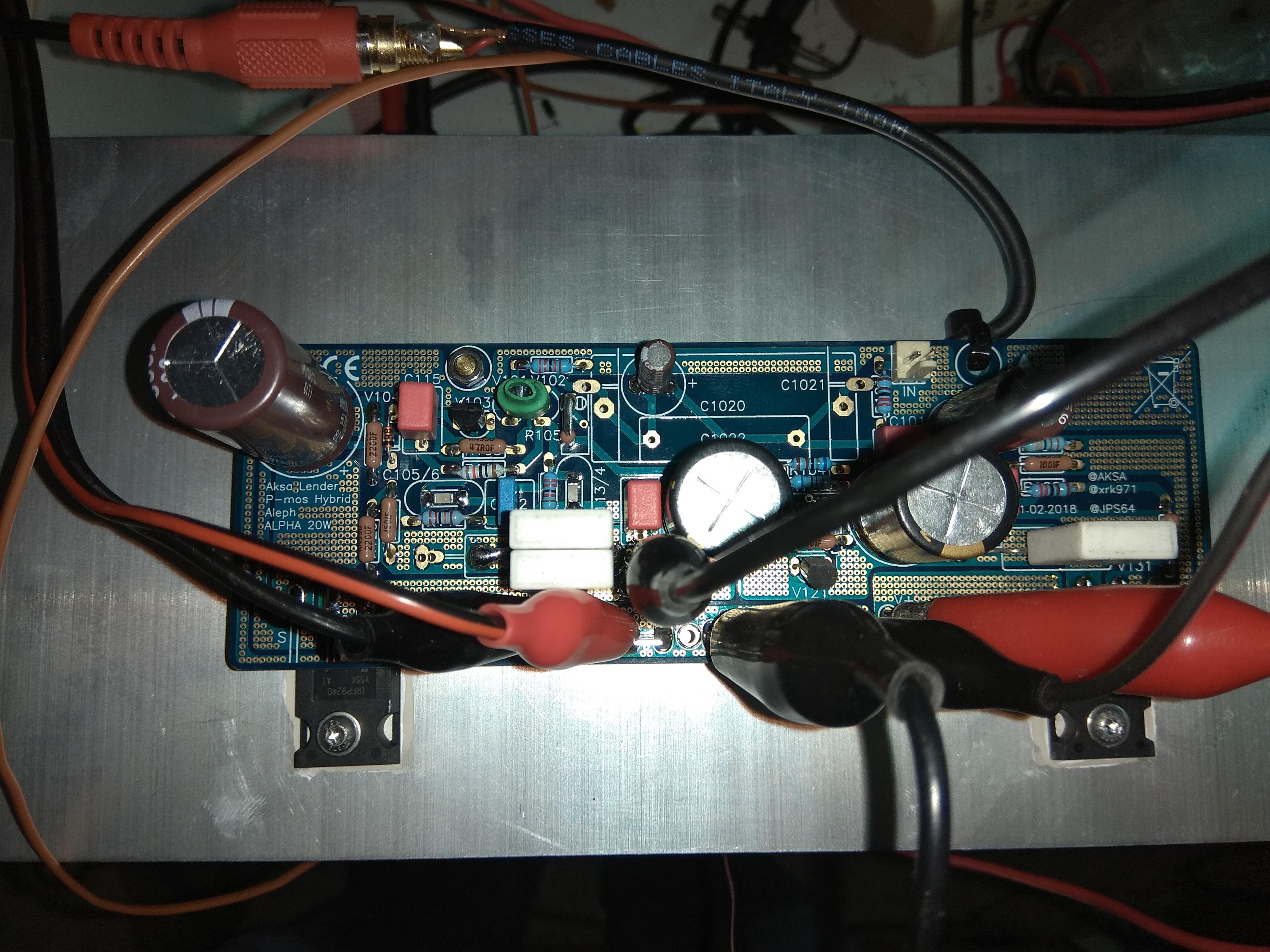

Thanks Hugh!
I ask to know if mine run hot due to low impedance load.

How's it sound, Thimios?
Does it get hot? What is the quiescent current?
Hugh

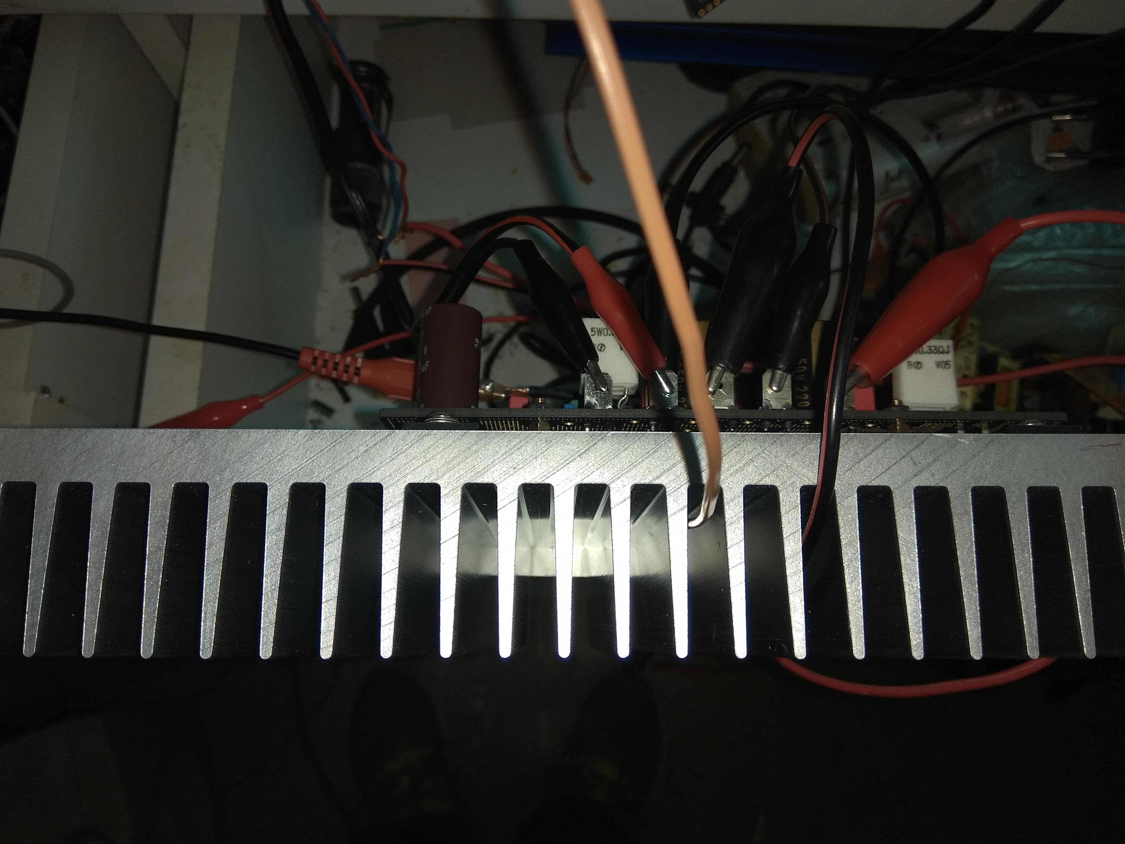

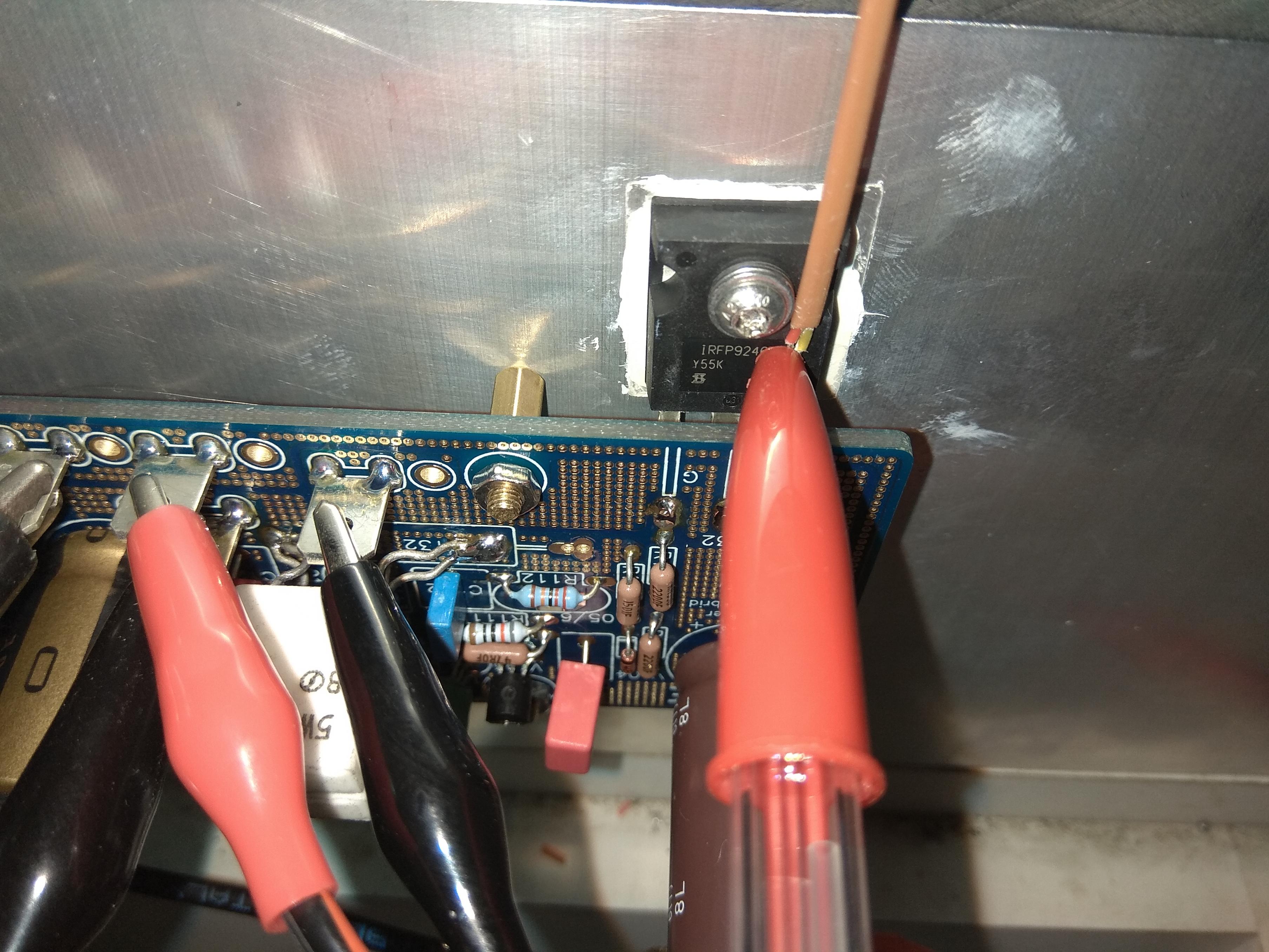

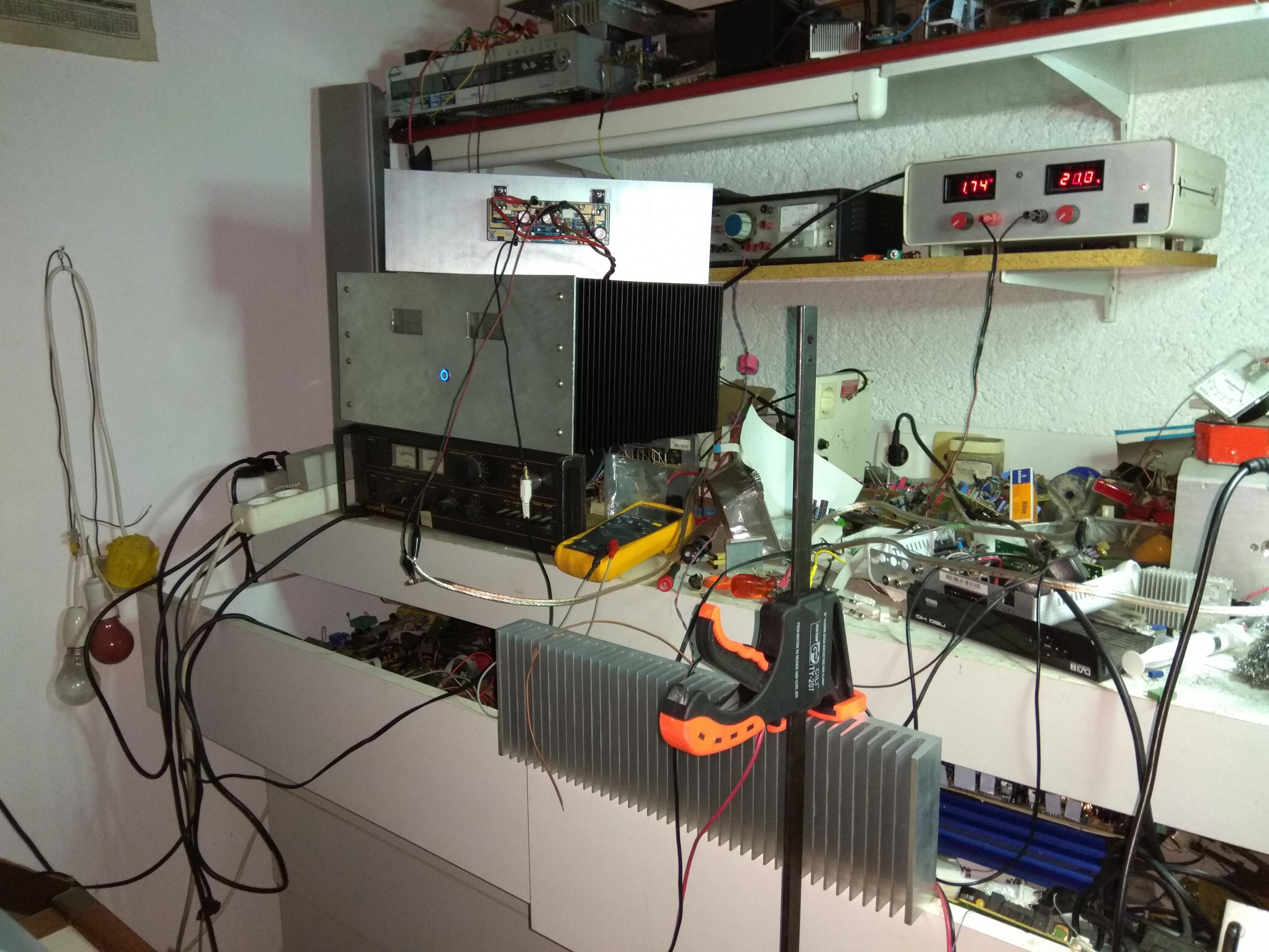

Because one power supply is fixed +/-18v(from an existing SX class A) i manage to run both chanels using same voltage(one using two variables bench power supply and the other using the existing Bonsai SX class A power supply.
Power supply +/-18v
offset after warming period=15mV

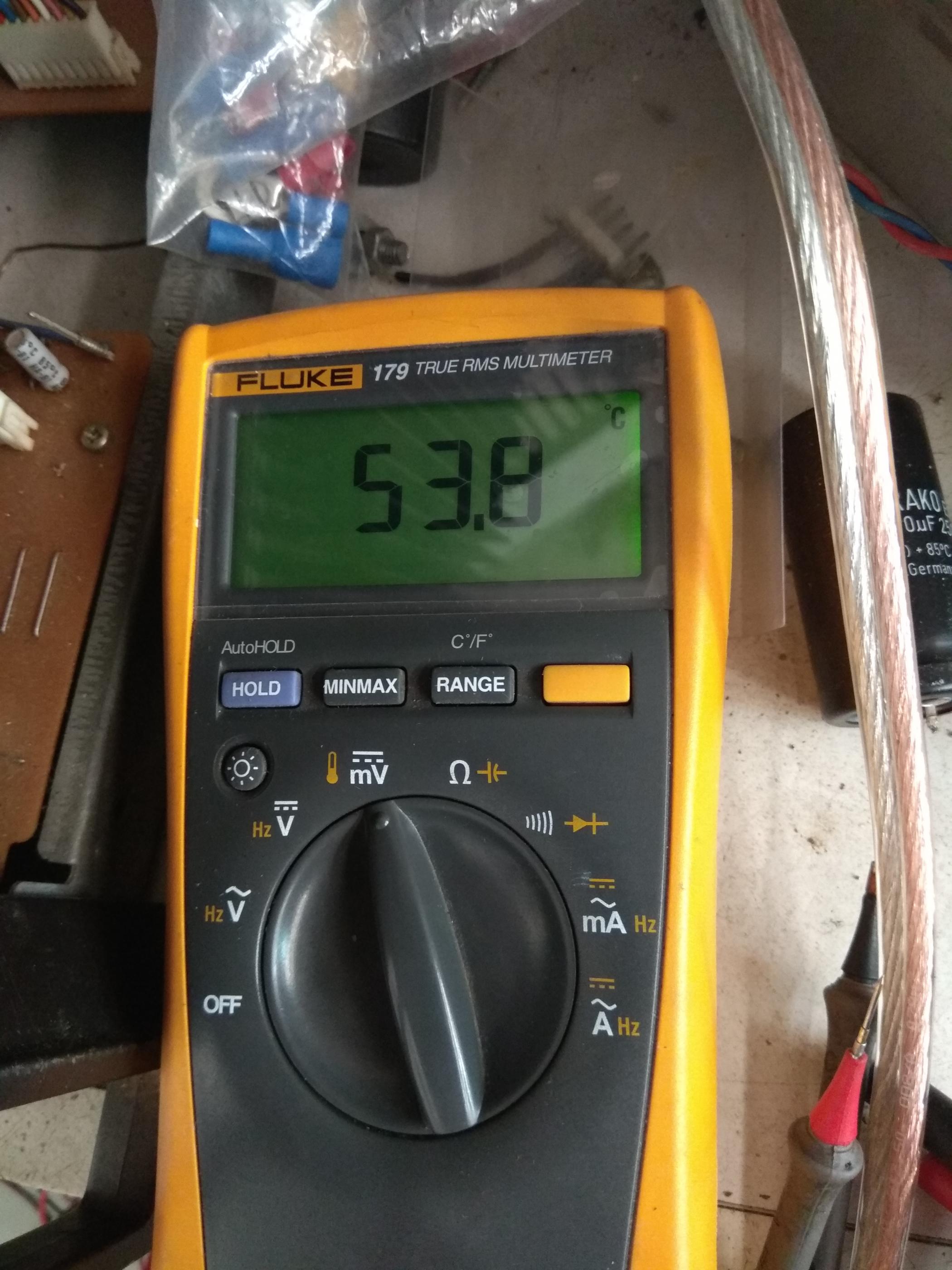

Heatshink temp.=54 C

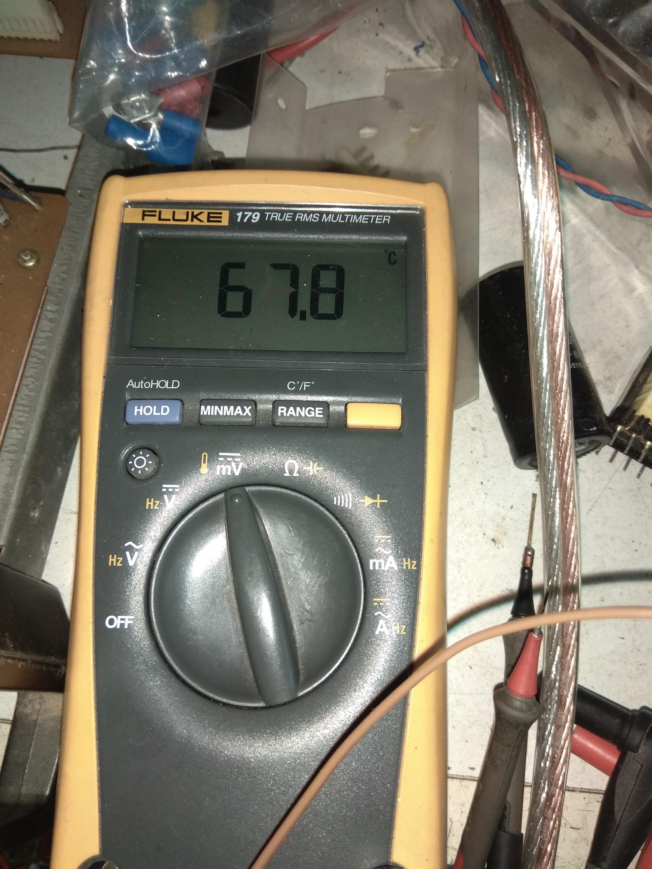

Temprature direct on fet body=67 C
Speakers are 4ohm(no circuit modifications), keeping volume at the midle(laptop player).
Listening period about an hour,not enough .....
How's it sound?
Cheap speakers playing wonderful!
Yes i like this a lot.
I can <<place>>the organs in the orhestra!
That's for now.
Thanks Hugh for this wonderful simple amplifier!😎

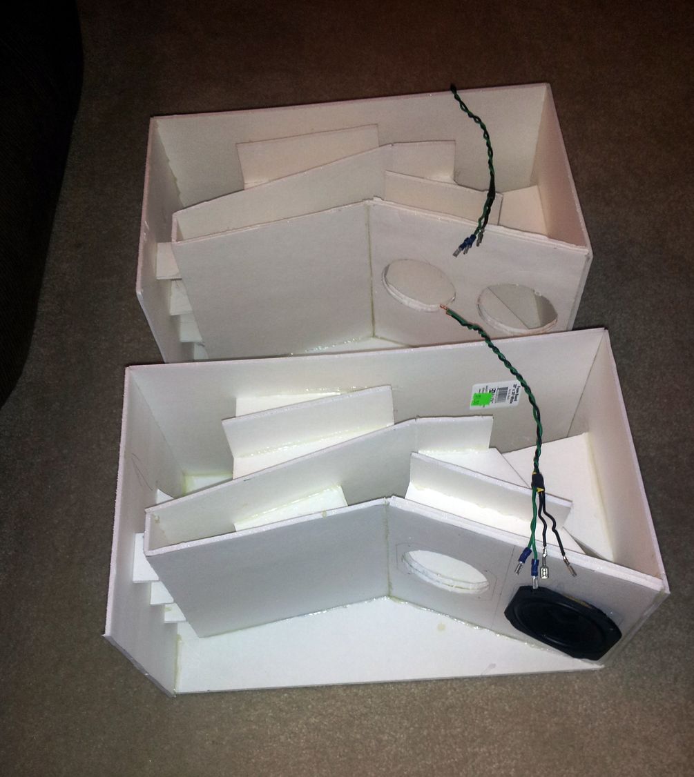

Get some Faital Pro 3FE25-16's, make a 0.53x Karlsonator (out of foam core or wood) and you have a 93dB speaker with rich, full sound. $80 for 4 drivers and $10 for foam core and glue.
Mini Karlsonator (0.53X) with Dual TC9FD's
Plans here:
http://www.diyaudio.com/forums/atta...fds-0-53x-karlsonator-score-fold-plans-mm-pdf
Or use four TC9FD's for 92dB at 2.83v (4ohms) in same speaker box. These are only $12/ea or$48/set. It is possible that with basic tools like a razor, ruler, hot glue gun, and foamcore, and drivers, anyone can have a nice high sensitivity (90dB+) full range speaker for under $100.
