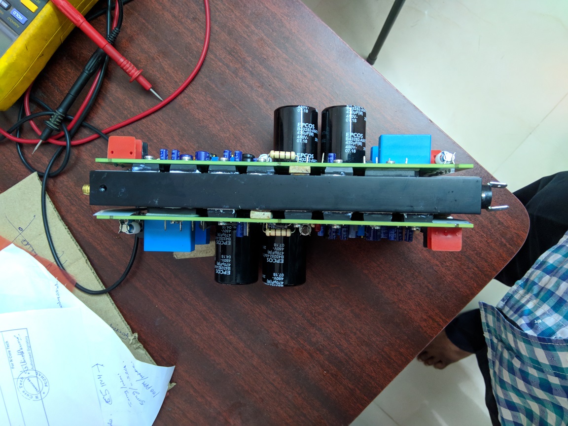

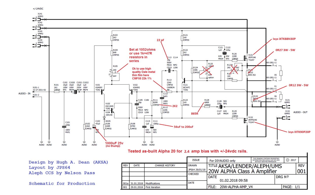

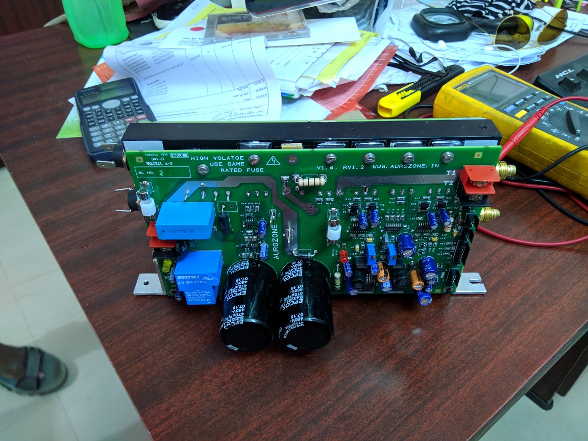

Hi
I completed alpha20 with respect to 4ohm version and facing the problem
The DC offset is 22v
These are the voltage ratings across the transistors with respect to ground
V131
S 22
D. 26.5
G. 26.3
V132
S. 22
D. -26.57
G. 19.7
Bc547c
C 27.35
B 23
E 23
V103
E -26.75
C 20.6
B -26.14
V101
E 0.75
C -26.3
B 143.9
V102
E 0.75
C -26.7
B 9.94
Please assist me to solve the issue

Can you clarify what is B of V101 again? 143.9 is not right.
Hi Cl00sed,
Also, if you can take the time to hand write or use paint program to enter values above into actual schematic it will save us from having to do that ourselves. The visual image of the whole amp with DC setpoints is what we need to see the problem. I can see that gate voltage on V131 appears to be too small. There is thus no current supplied by the Aleph CCS.
Thanks,
X
