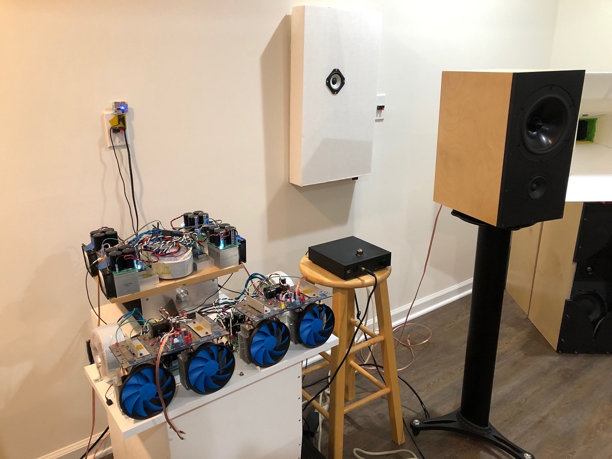

I had a rare opportunity to play with three of Hugh's amps last night and listen to them at the same time switching around. Here is the Alpha BB in the front (52w), with a new Aspen Class AB (85wpc) in the little case underneath the Omega Class A (35wpc). It's not everyday that one gets to listen to three world class amps for fun!

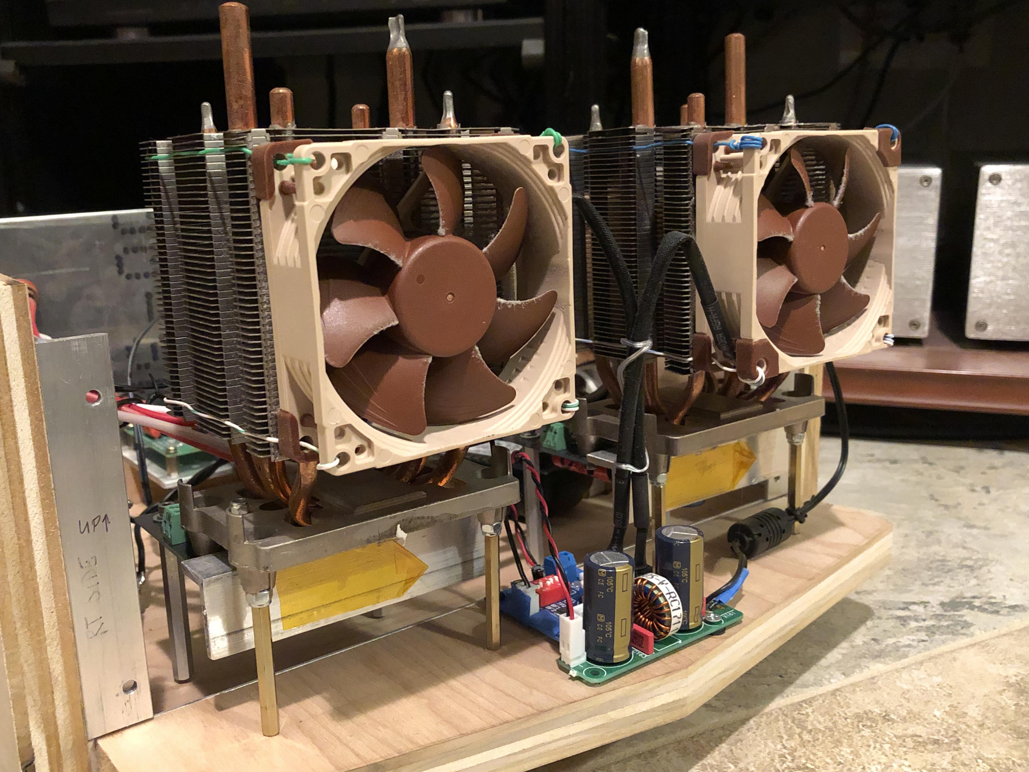

Basically the CPU heatsink is bolted to the bottom side of the board using a suitable insulator washer (felt in my case). Then on top side apply thermal paste then ceramic spacer pad then more paste then the MOSFET. Then use a L section bar to clamp the MOSFET to the CPU heatsink. I used a US $0.05 nickel as a spacer with a silicone pad to give some cushioning below the clamp bar to press the MOSFET down. Gently hand tighten the screws to eveneky distribute the pressure. When running check temps - of one is too hot relative to others it may be poor thermal contact.
Here is how I did it with a MOSFET on a flying lead to a Dell CPU cooler. Also used clamp bar and ceramic pad and thermal paste. This one is on my MOAMOFO dissipating 160w with a Noctua 80mm fan (not shown as early photo before they arrived) running in silent mode with temp feedback to PWM fan drive. Very very quiet.

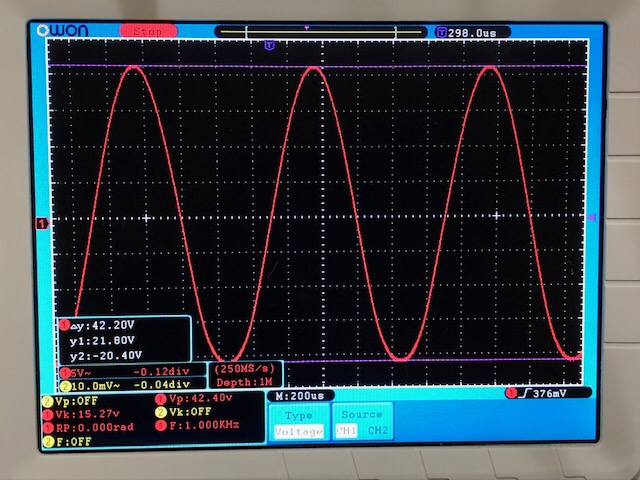

I need a +/-28v PSU for my Preamp in order to hit full 50wrms. Here, with +/-24.5v supply I can only do 44.4Vpp into 8ohms:

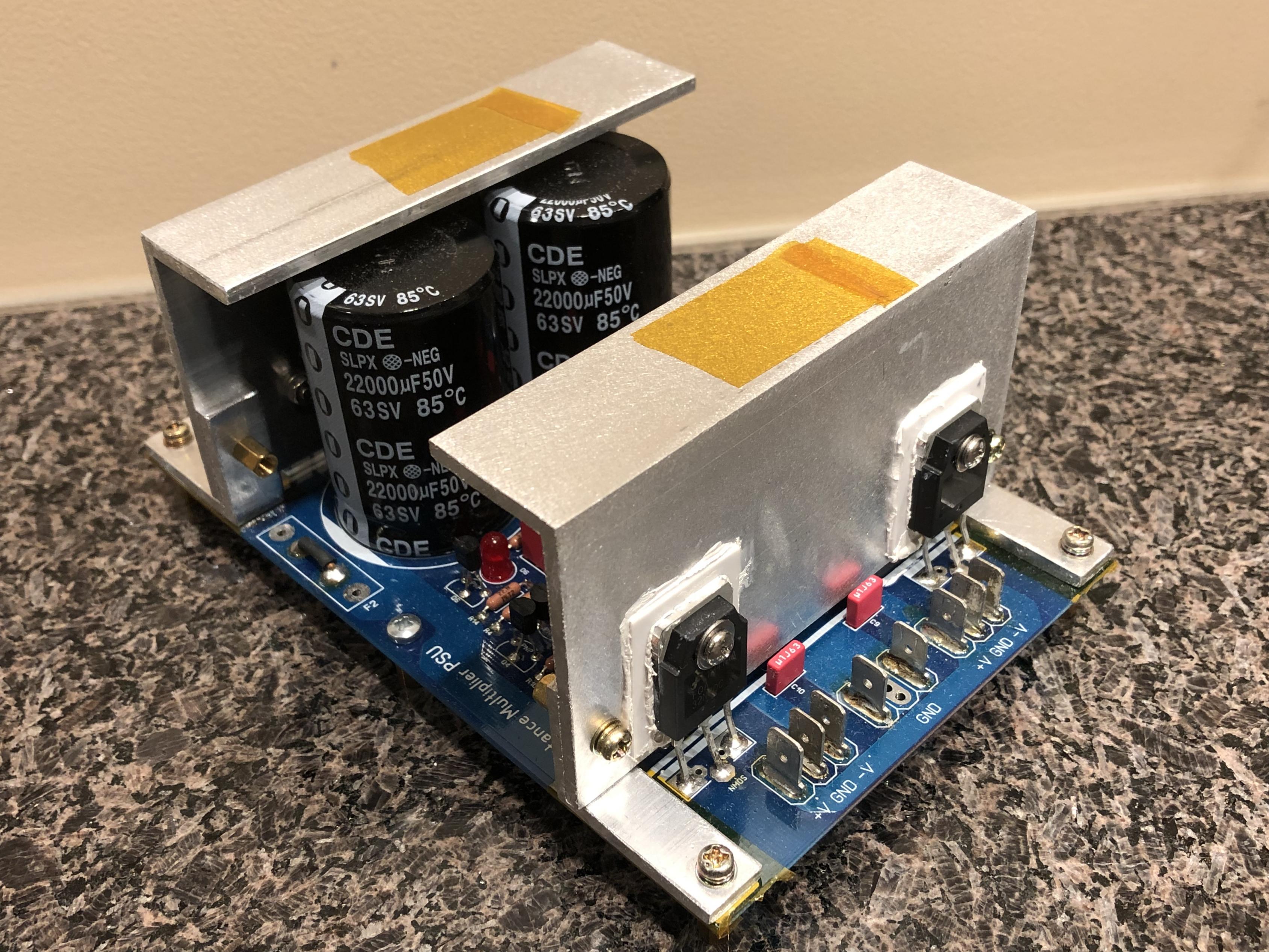

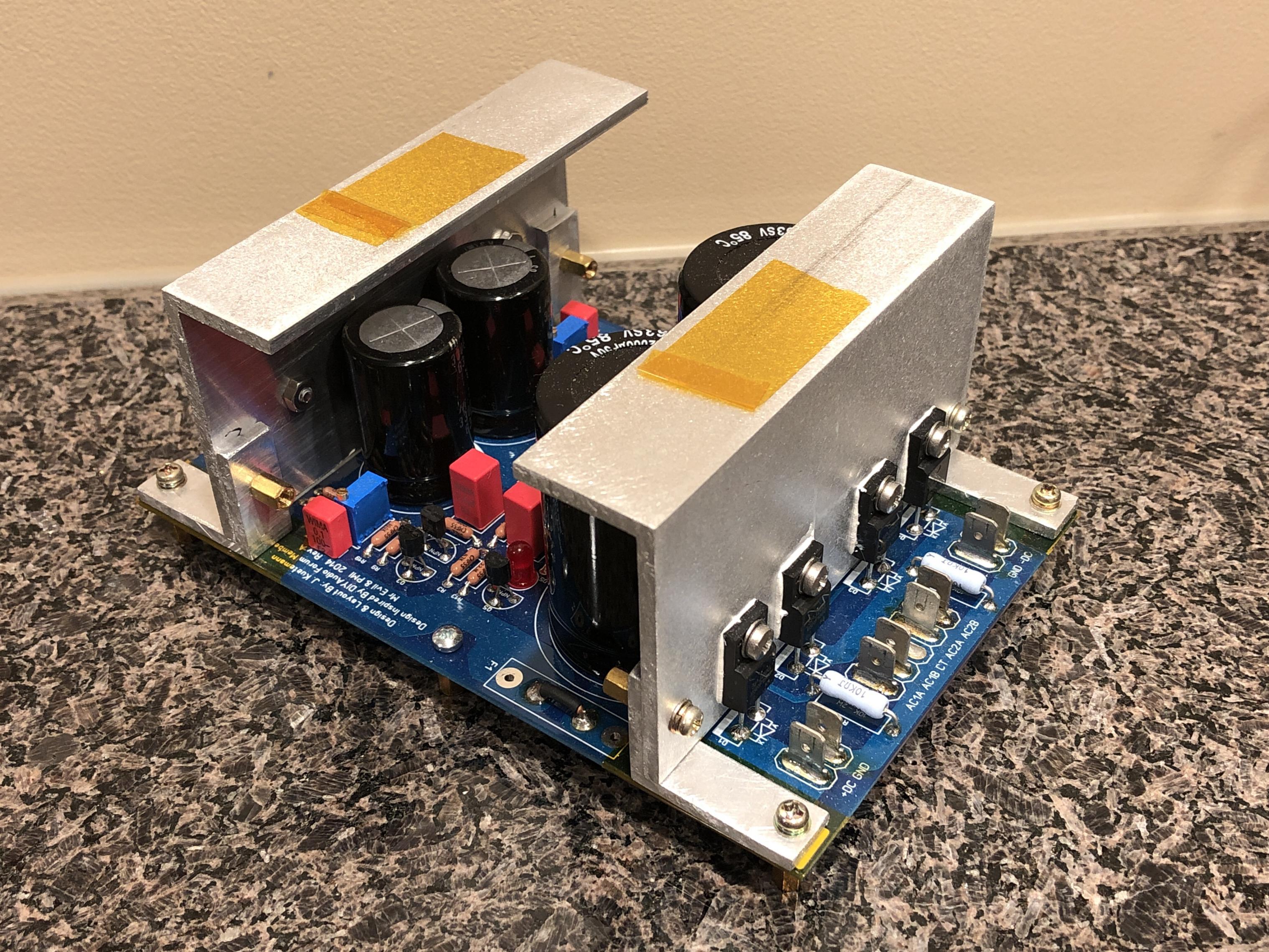

The basic premise is that with a big BJT and a heatsink you can get 2mV ripple for a Class A amp with a small 22mF cap. A BJT and a heatsink from a case floor wall is a lot less expensive than 8 x 33mF 50v caps. And the CRC has more ripple.

With a 600va, 32v secondaries trafo the BB gets 38-39vdc. The onboard rectifiers and output Mosfets need to be heatsinked. If I build another of these, I will use a pair of bridge rectifier mounted to the chassis instead of the onboard discrete rectifiers.

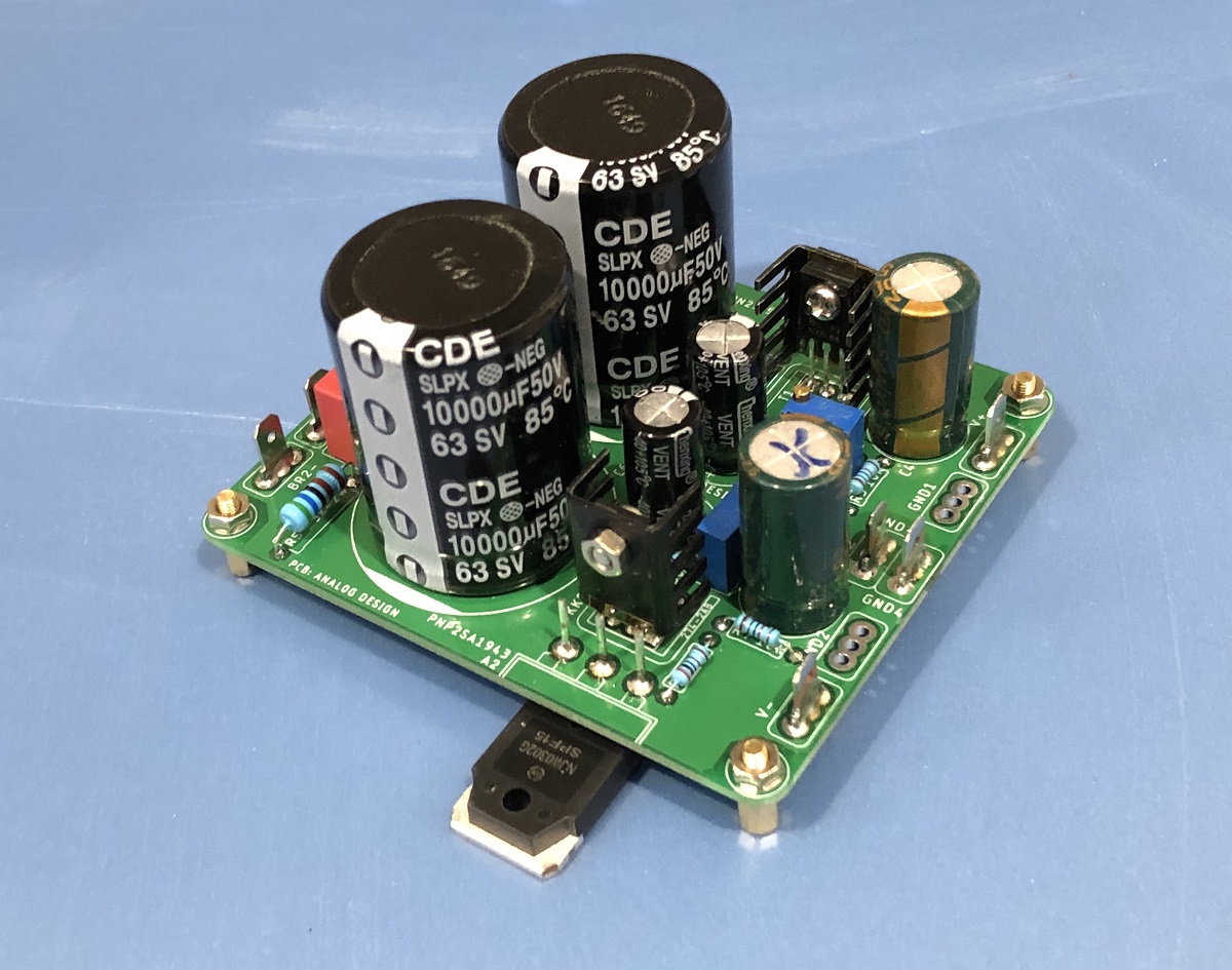

It’s a different one by Mark Johnson - uses a BJT with adjustable voltage drop from 1.3v and up. I run at 2v drop so for 3 amps it is 6W per rail or 12w total. Requires a small heatsink.
708009d1538921915-jumas-easy-peasy-capacitance-multiplier-mjohnson-cap-mx-build-01-jpg
The MOSFET based unit had 4v drop do twice the dissipation.
Vunce said the MrEvil one is also adjustable and he runs it at 2v drop as well.

My recent foray into cooling an IXYS MOSFET running 37v at close to 5amps of bias current with a surplus Dell CPU cooler and 80mm PWM Noctua fan has reaffirmed that it is possible to remove 160w and be absolutely silent. The Noctua fans are engineered with all the CFD-developed tricks in the book to minimize noise, and it works. I cannot tell the fan is even on with my ear 2in away. It is eerie how silent something that spins and moves air can be. In the low speed mode absolutely silent mode, the 160w MOSFET body is a (too hot to touch) 70C, and fin temp is 55C. If I allow it to use the temperature feedback and speed regulating feature, the MOSFET is 50C and fin temp is 37C, and sound is barely audible at 6in away, but the sound is 100x quiter than the blue 120mm Artic fans.
So, if sound emission from fans has been a concern for folks on the wall about whether or not to fan-cool, there is no need for concern. The sound is less than typical household ambient noises (HVAC, laptop PC fan, people moving about in a house, etc).
Having said that, I think that if you used a thick copper plate heat spreader to a larger aluminum fin heatsink with fans, that can work too. But it is much more costly than a $15 surplus CPU cooler with heat pipes.
Here is Vunce's MoFo with the Dell CPU coolers and Noctua fans:
726075d1546401150-build-mofo-513abf01-30a5-4ae3-bbdb-80c8f904b97b-jpg

With help of Melbourne (Aksa Lender preamp in bipolar supply mode), I was able to drive the MOAMOFO to 42.4Vpp into 8ohms (limited by +/-24.5v rai;s on Melbourne):
728321d1547254311-build-mofo-45502640-20b4-42ed-8572-a43a374d4f7d-jpeg
