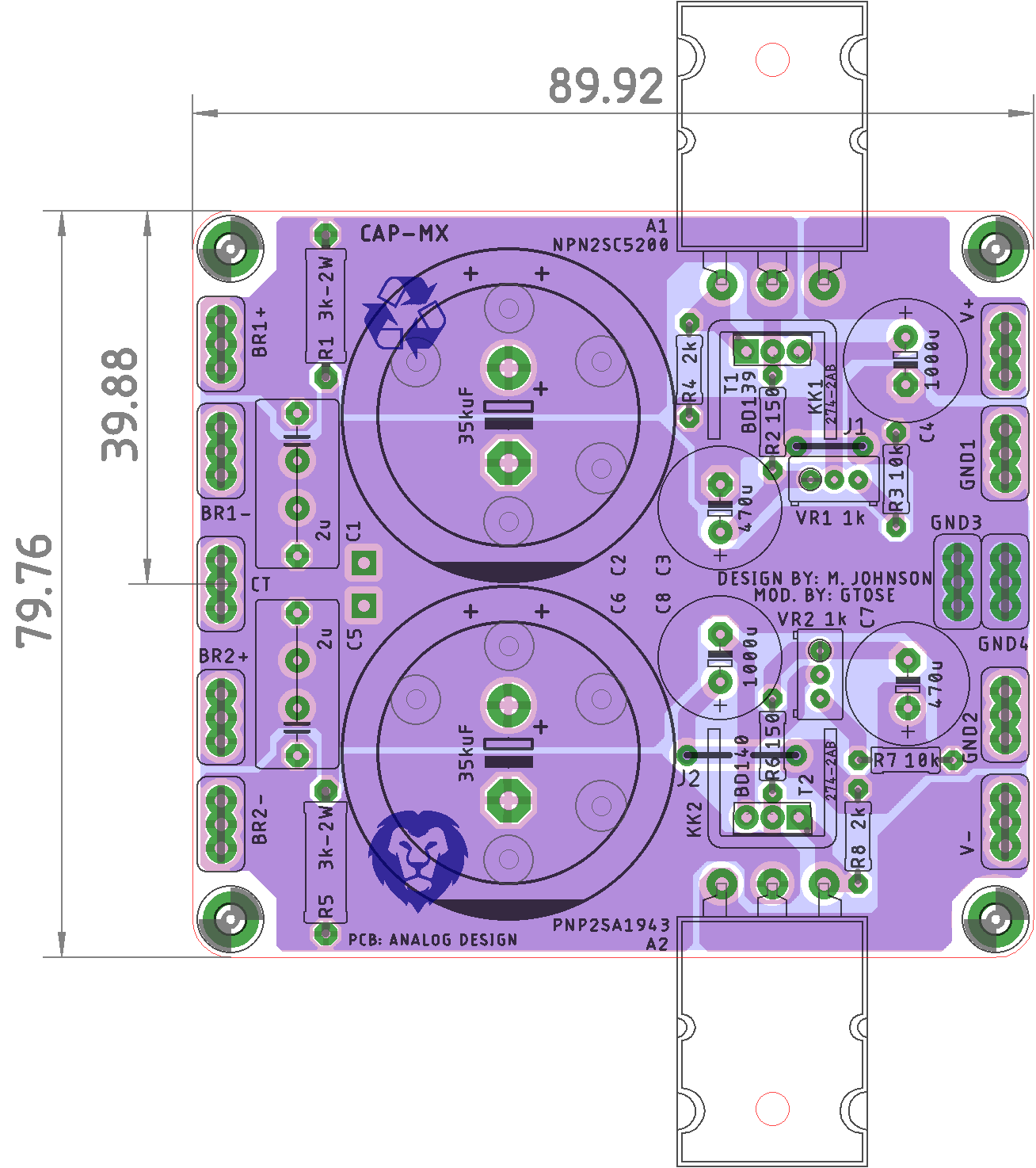

That 'M2' cap multiplier is impressive. Could you please put up the schem again, there were a few changes...... I love Prasi's pcb too, elegant.

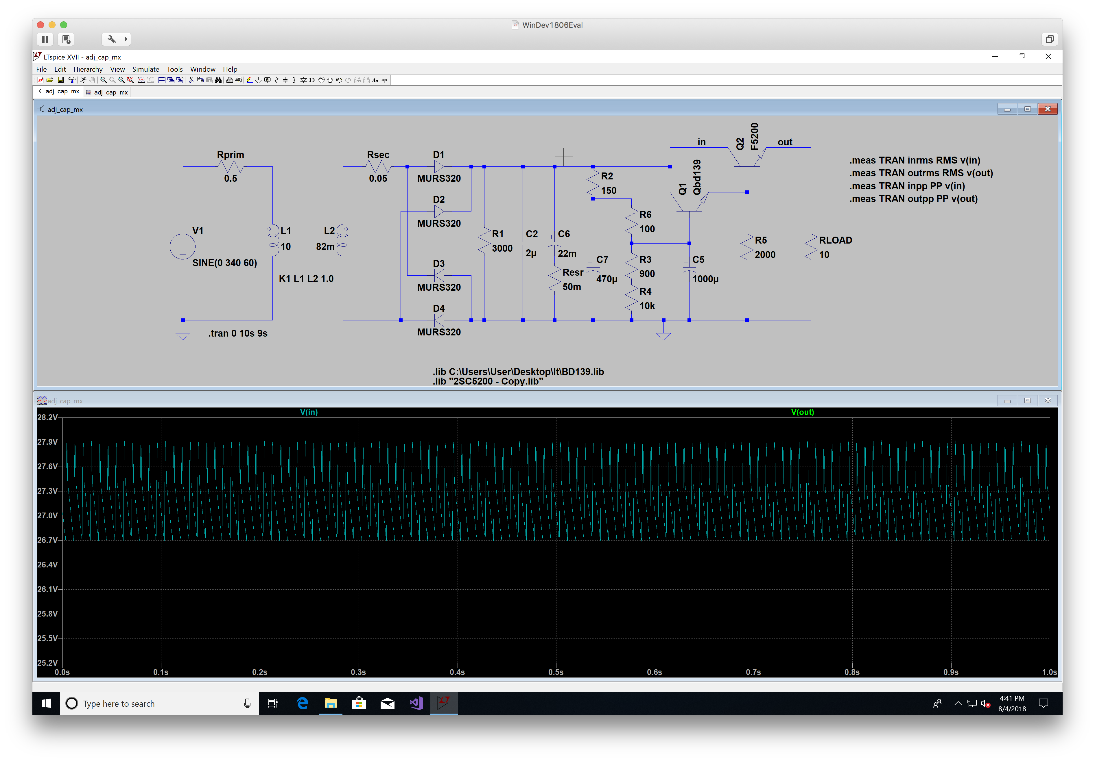

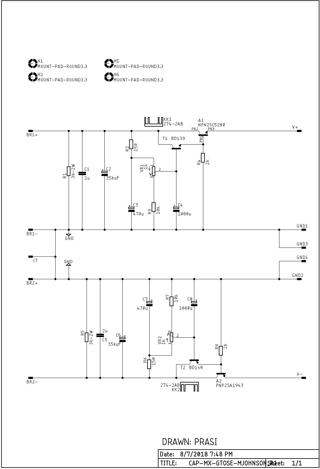

Here is the schematic for the layout (design by Mark Johnson, and modified by Gtose):
Here is the LTspice schematic by Gtose:
Layout by Prasi:

Gerbers are posted in the above thread around post 512. These can be made as "add on" orders if you are already getting something at JLCPCB for $2 for qnty 10.
The cap multiplier above works phenomenally well. Just real basic parts - I am thinking of converting it to lower current (300mA) HPA duties using a smaller and less expensive TO220 BJT for the output. Just using a 10mF input smoothing cap was enough for running 1 channel for the M2 at 1.27amp bias current and about 2v drop. Note that the dropout voltage needs to be greater than the input ripple plus 1.2v in order for the cap Mx to be able to absorb the ripple. So at 2v drop I can have up to +/-400mV ripple on the input.

Looking at the schematic above, it seems the time constant on this system is only 0.15sec - too fast. We would probably have to play with some simulations to slow the DC chargeup. If I look at it on an Oscope during turn on I can verify this. Probably even a DVM can see that it may be too quick in stock form.

https://www.diyaudio.com/forums/attachments/power-supplies/695876d1533656392-jumas-easy-peasy-capacitance-multiplier-cap-mx-gtose-mjohnson_sch_r1-png
Hi Jwjarch,
I think it is R2/C3 and R6/C7. Currently, it is 150R/470uF combo. On the Juma Easy Peasy, this main R/C combo is 10k/220uF which has a 0.7RC time constant of 1.55 seconds. For 150R and 470uF the 0.7RC time constant is 0.05 seconds, that's 31x faster and too fast to provide a slow ramp up. I connected a DMM to the output and switched it on, and sure enough the voltage jumps up to the nominal output value almost instantaneously. This will not work for turn-on thump reduction.
If we switch the RC combo to something similar like the Juma Easy Peasy, we could simply use something like 4k7 for the R2 and R6 value. However, I am not sure how that will affect the rest of the circuit in its ability to provide the ripple reduction over the bandwidth of interest.
Let me ask Mark Johnson in other thread as he is the designer.
