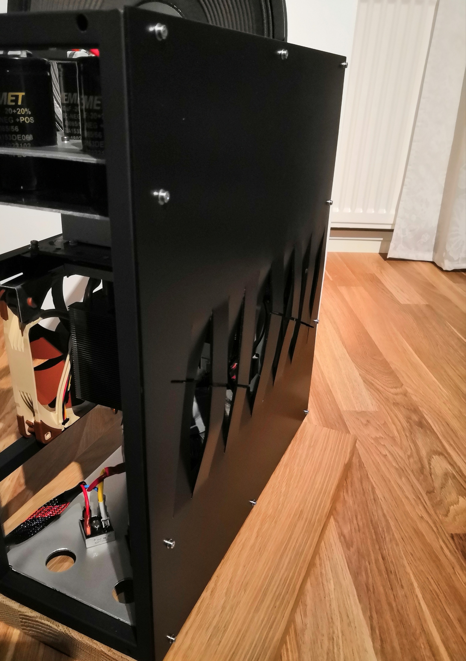

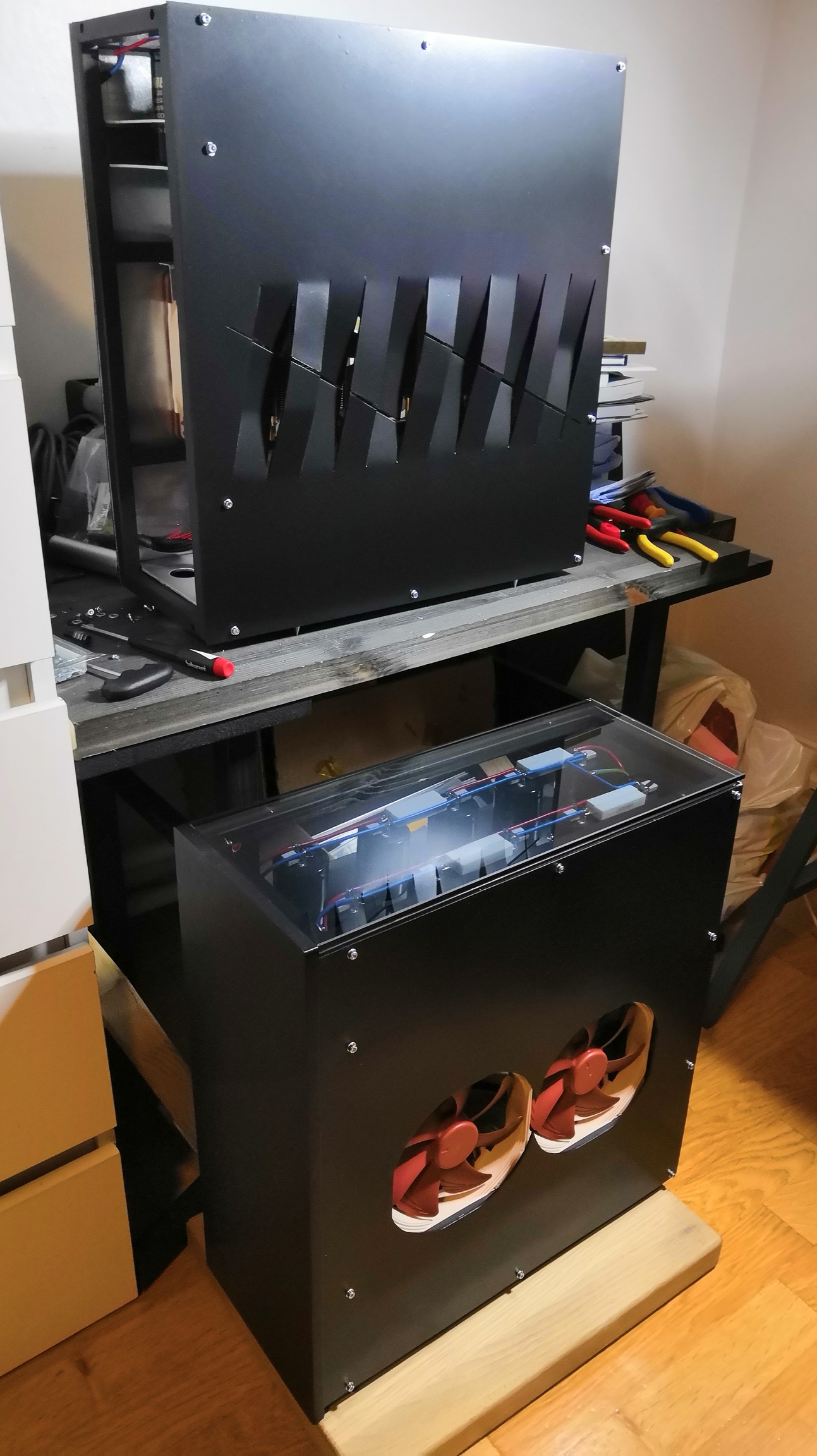

Those “shark gill” slits look very cool. As long as it lets air in without turbulence or whistling then it’s good.
Yes it does, had to run test just few moments ago. Just as quiet as square hole. Case lets hot air flow through the roof as well, capacitor deck is open from front and rear. Also glass roof is rised few millimeters.
Very nice job, Juntuin!
Thanks X! Painting went quite wrong again, but this is DIY!

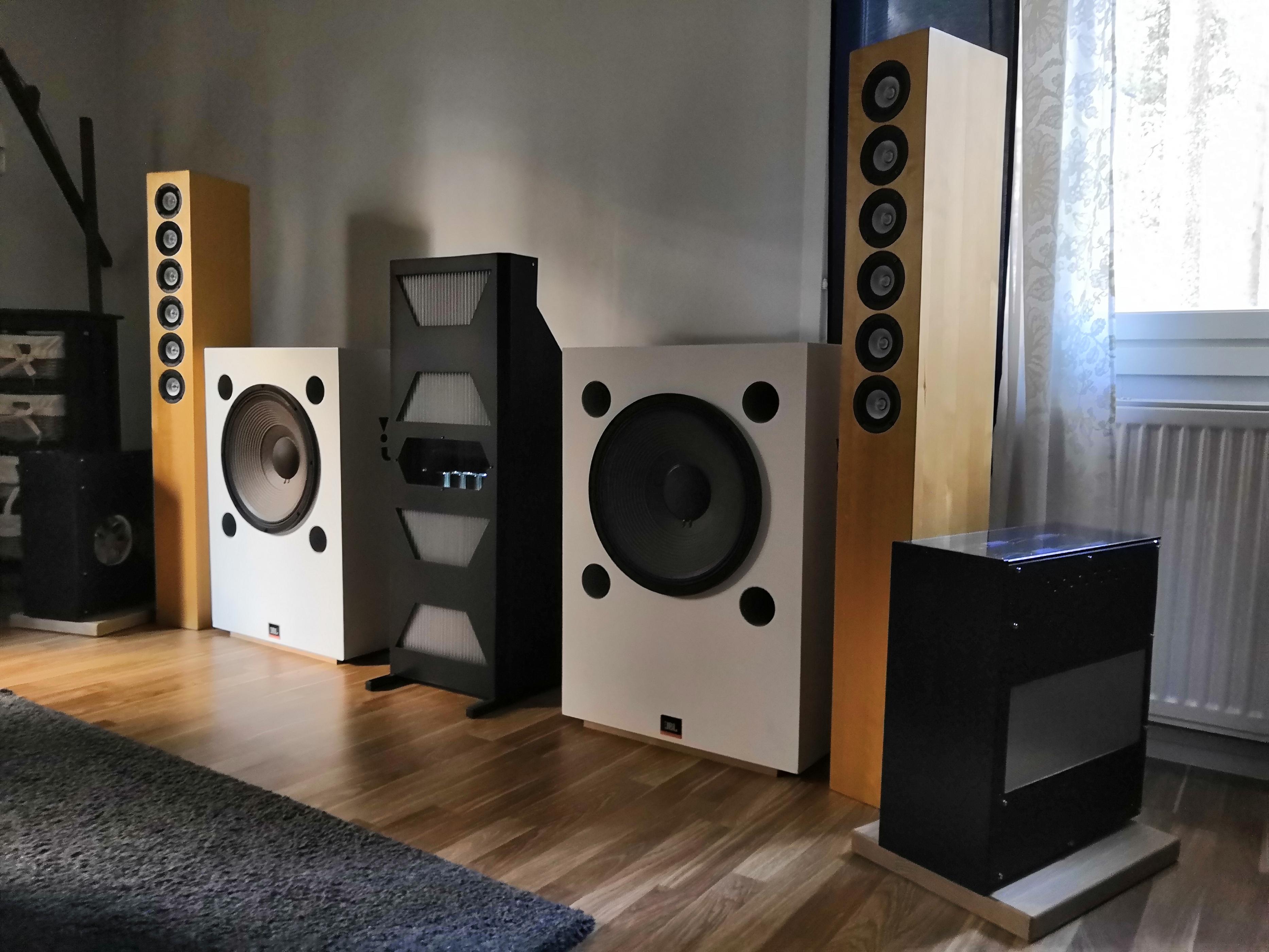

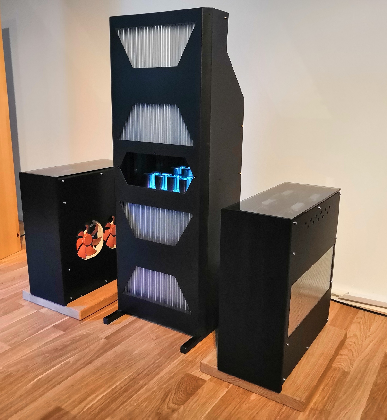

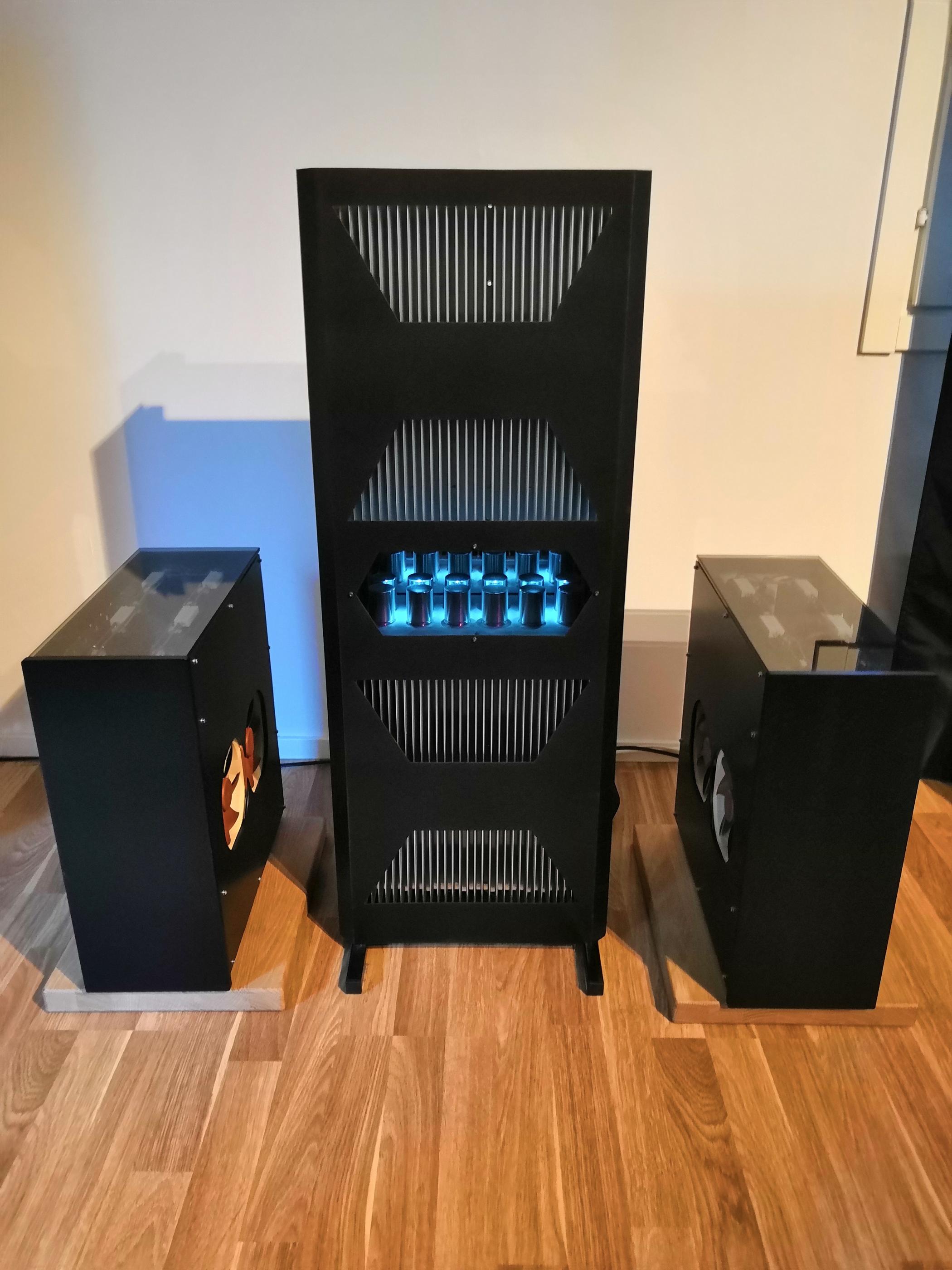

Made X a promise earlier that I'll post some family photos with Alpha20 and B. B.
Very cool Juntuin... Class A all the way!
