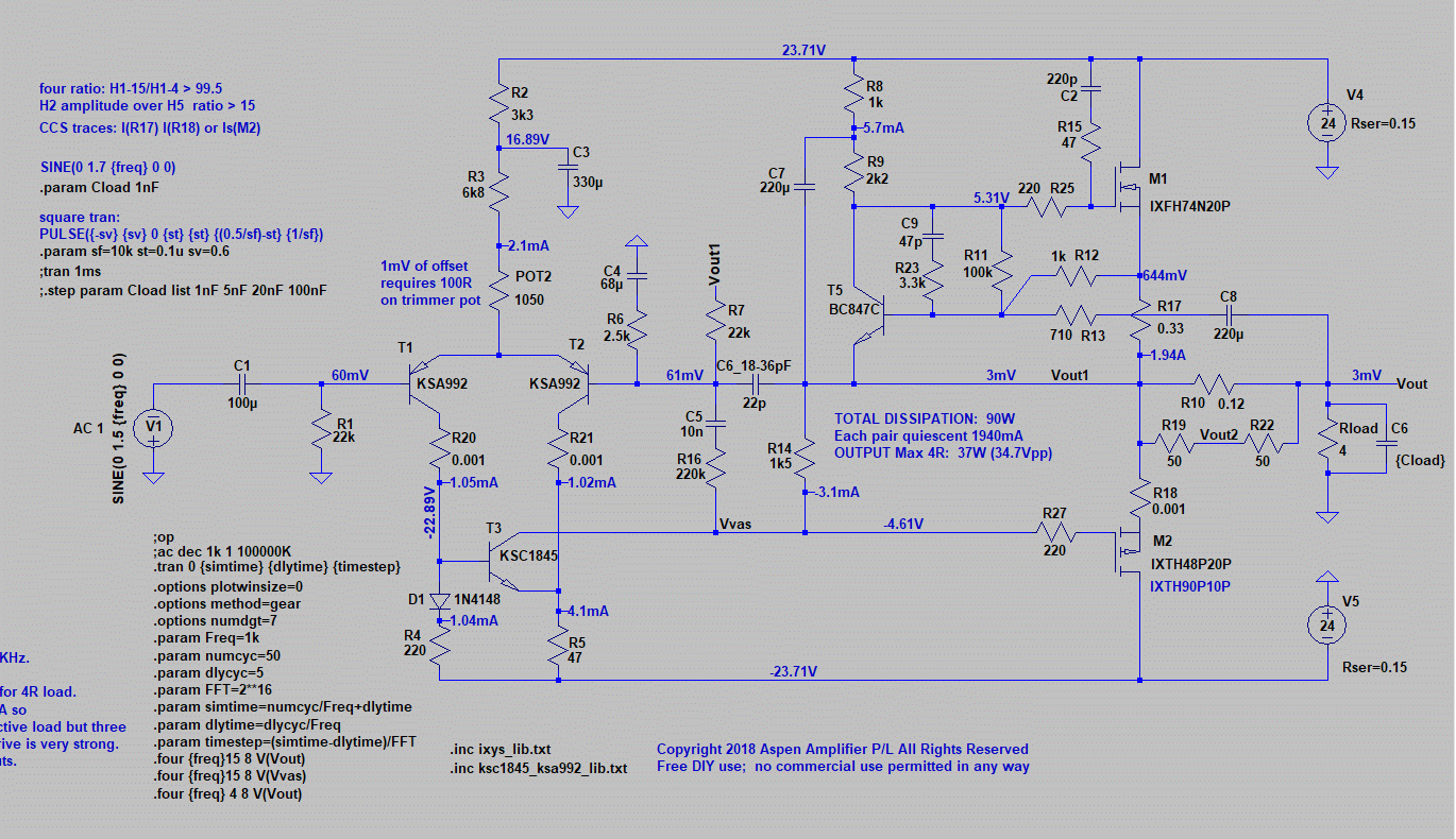

There are two resistors only to change for slightly less current.
The CURRENT SENSE is R131, presently on this schem at 0.27 which gives 2.4A which relates to a Vbe voltage at V121 of 648mV.
If you increase R131 to 0.33R, you will see a quiescent of 1.96A, which is close to what you want. If you want 2A, you'd need 0.324R, but this is NOT a preferred resistor value.
The second resistor to change, perhaps, is R128, on this schem at 865R. If R132 is left unchanged at 0R12, it will change considerably to 680R, or even 700R if you can find this precise value. This resistor sets the dynamic range of the two output devices; that is, we choose a value which ensures both devices see the identical current range, low to high, to maximise the efficiency of the amplifier, that is, maximum clip.
I did the LTSpice again to be sure about this......

In any case, to summarize...to set the current to 1.96A, then:
1. Change R131 to 0.33 ohms
2. Change R128 to 680 to 700 ohms (closer to 700 preferred)
3. Keep R132 at 0.12 ohms
Is that right?
Thanks!
Anand.

Hi Anand,
For 4R and 1.9A change also the feedback shunt resistor to 2.5k or 2.7k (R6 in my schematic, R111 in the above one)
this will bring some more stability with this lower bias at 4R.

Yes X, I was also looking for a less hot version of the Alpha 4R.
At 1.9A and 4R, distortion starts rising at 26vpp instead of 30vpp for 2.4A and 4R (both with 2.5k as shunt feedback resistor).
That won't be a problem unless your speakers are very inefficient or you like it extremely loud and the neighbors too

Yes, Anand, your figures are correct......
Thank you Danny, the shunt resistor R6 at 2.5k will reduce the gain to (22+2.5)/2.5=9.8, around 19.8dB. This is consistent just as you say with a 4R load since lower impedance speakers should theoretically require less voltage to handle twice the power.... good thinking.

Alpha 20 with 1.96A bias and +/- 24V rails
Danny, Hugh, XRK:
Thank you all!
So in summary for 1.96A bias and overall 20dB gain:
1. Use the schematic in post 2781
2. Change R131 to 0.33 ohms
3. Change R128 to 680 to 700 ohms (closer to 700 preferred)
4. Keep R132 at 0.12 ohms
5. Change R111 to 2.5K or 2.7K ohms.
This should work nicely with my 96 dB efficient speakers that have an impedance nadir of 4.8-4.9 ohms.
