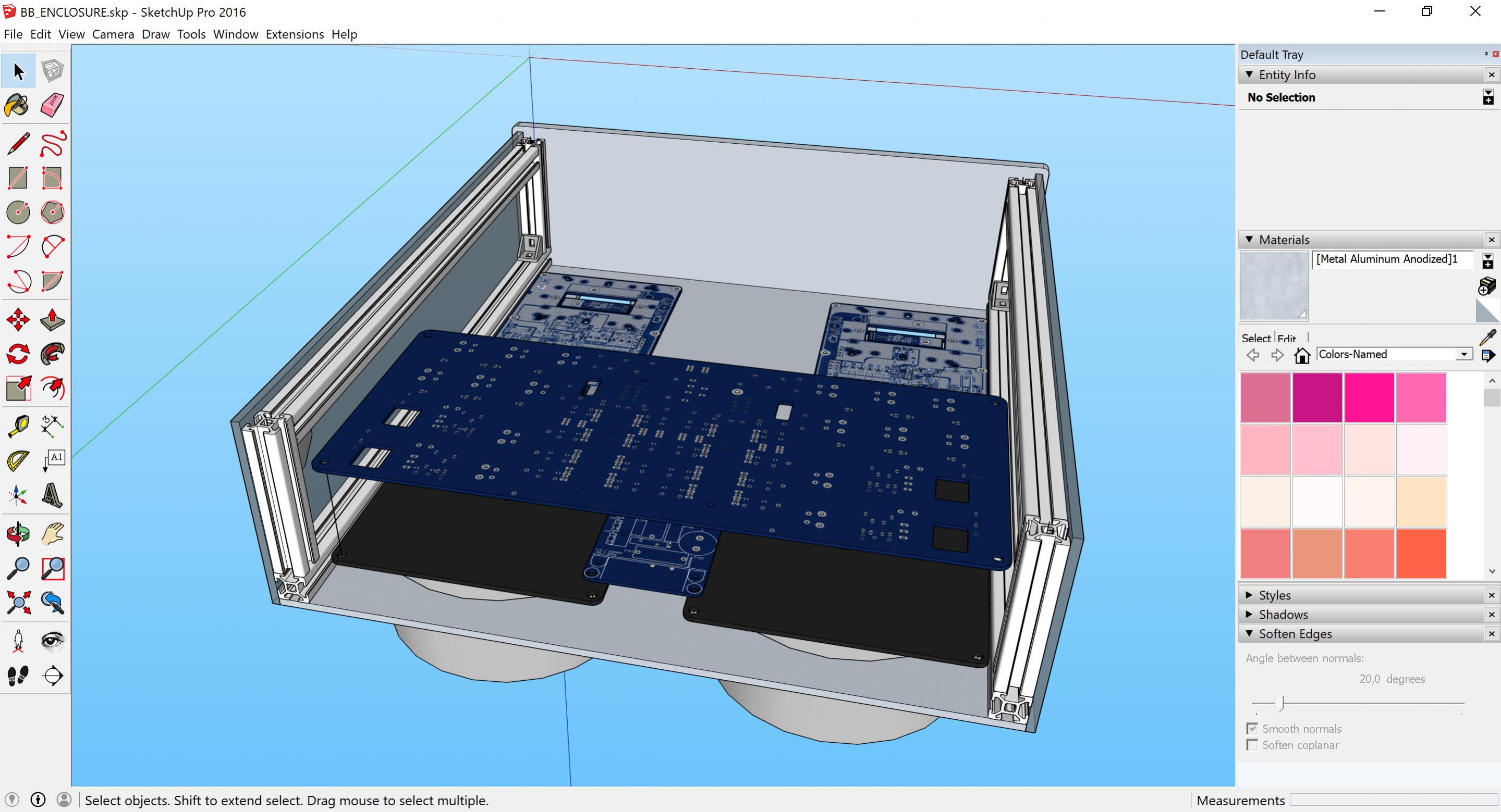

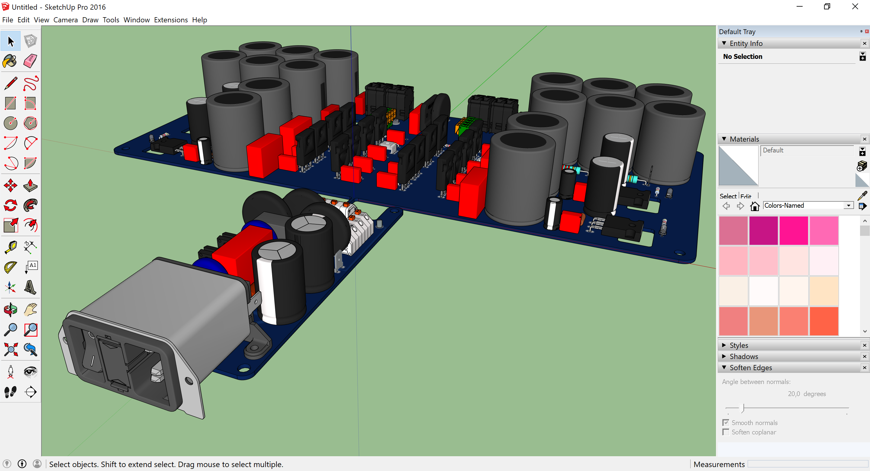

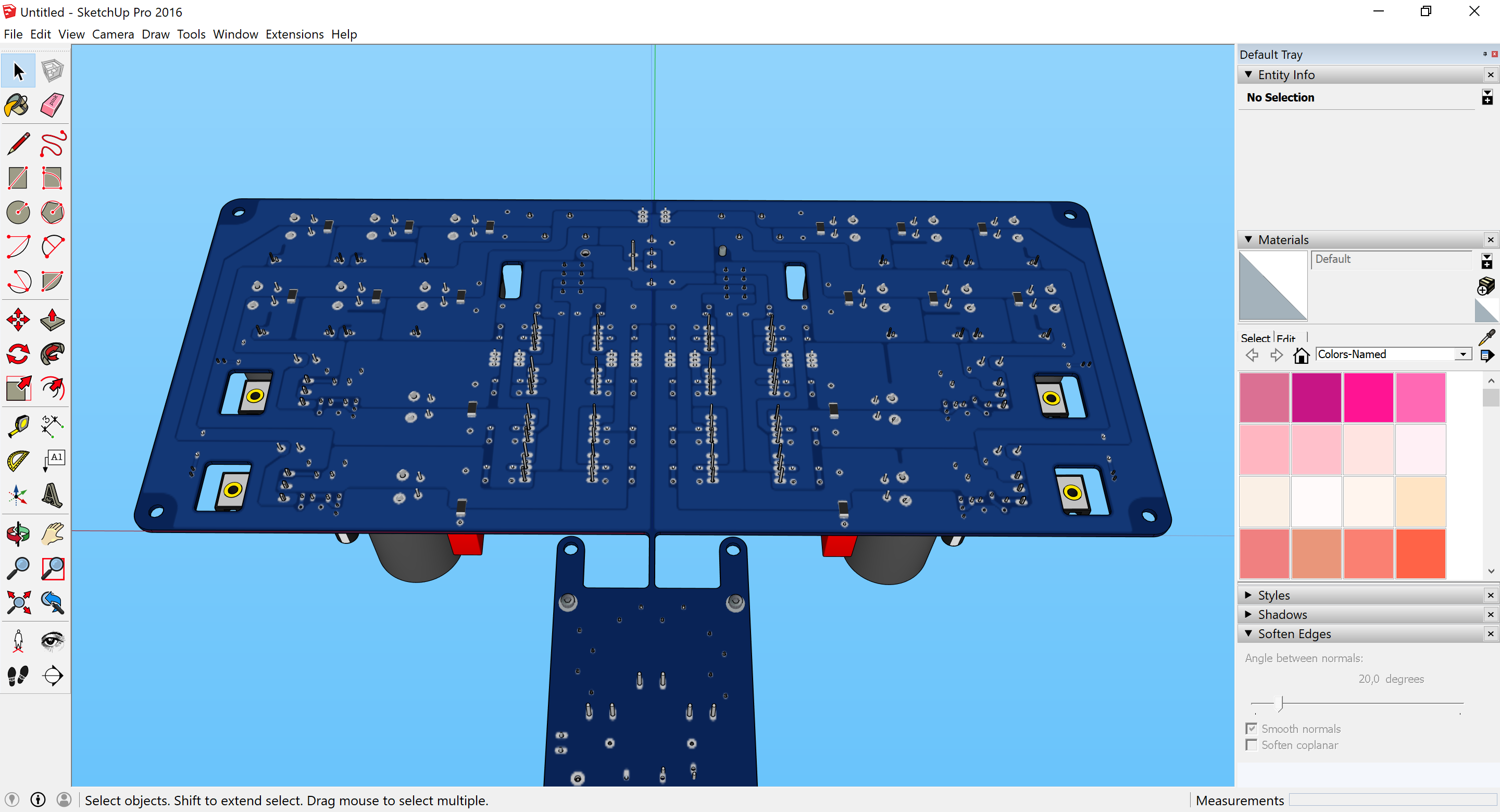

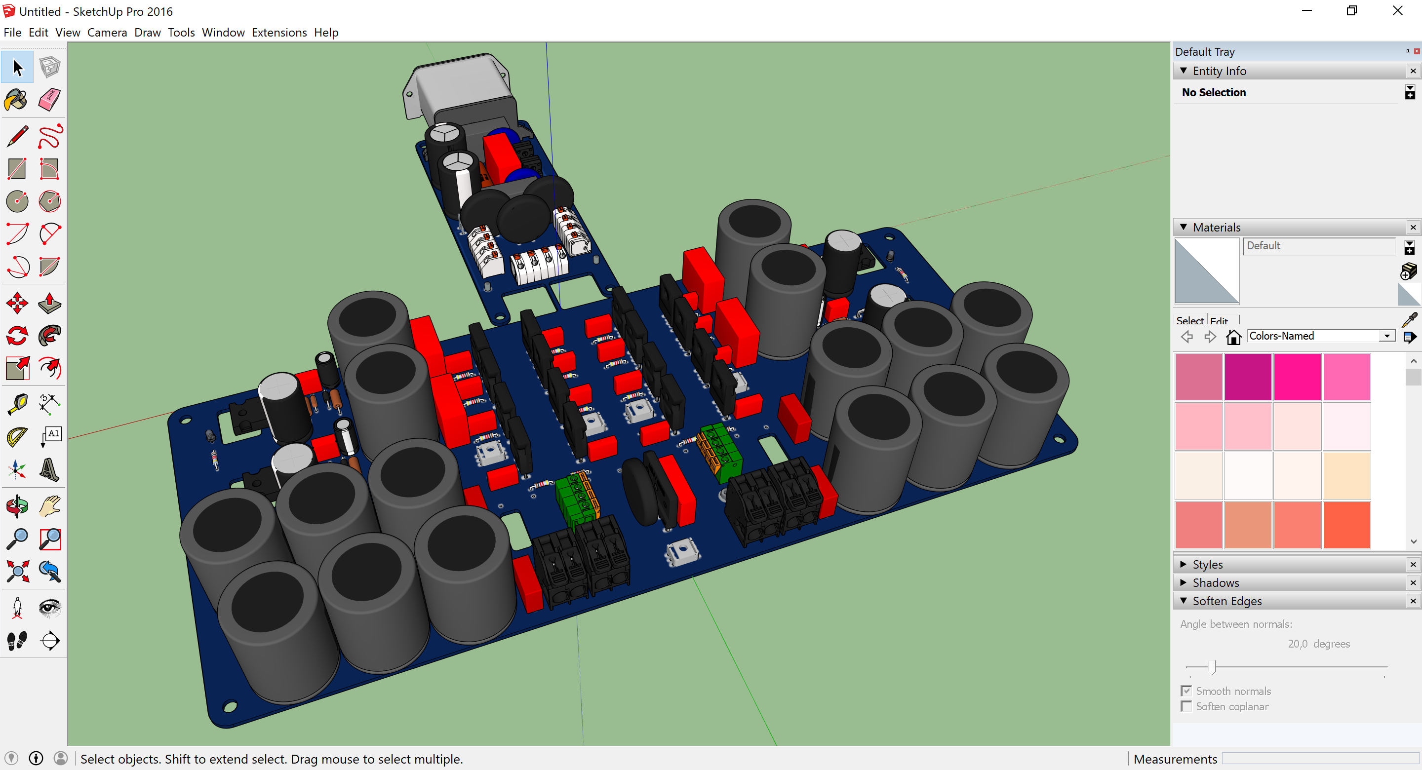

Nice work JP! That PS board is a monster!
That PSU board JP is working on is one serious piece of hardware. A board that size in 2mm, 2oz, ENIG will cost an arm and a leg. 😱
Well, what´s cheaper? Two CRCRC PCB + one double capacitor multiplier + a lot of cabling? 10 pieces 2mm, 2oz, ENIG and a lot of vias for 30$!
JP
JP
