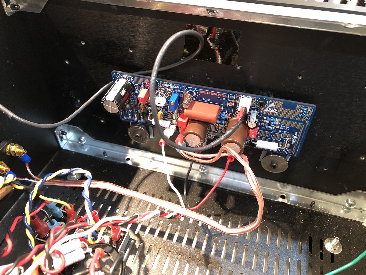

The Alpha 20 can be installed conventionally on passive heatsinks as thermal load is fine. It fits UMS heatsink offered by DIYA store in fact! I have mine mounted on Dissipante 4U x 300mm. All stand-off and MOSFET bolts match up perfectly.
Here is proof it fits UMS:
Good to hear that you are deep in DSD!

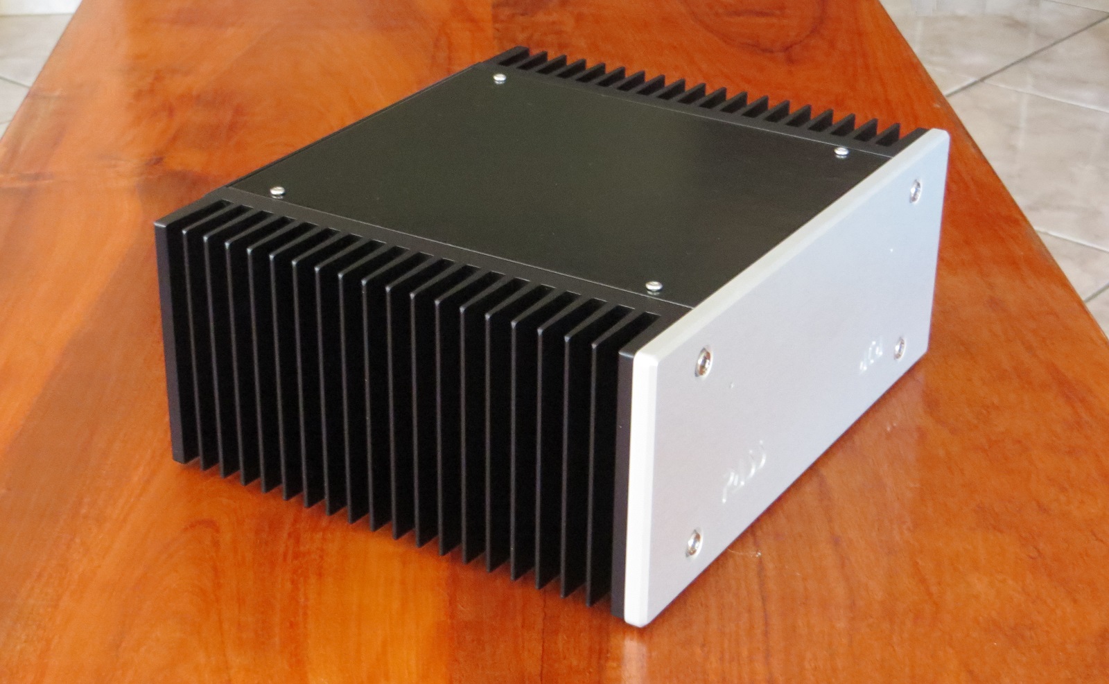

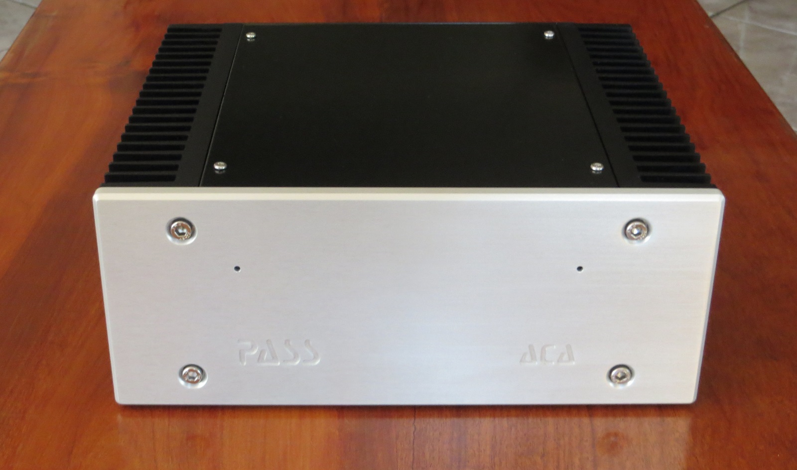

I have the same problem with cost and shipping. But fortunately a chassis for class A is easy to make. Once you have the two heatsinks, you just need top, bottom and rear panels - which is easy to make and drill yourself. And lastly a thicker aluminum faceplate to round it off.
That's the route I went with my ACA and it didn't cost an arm and a leg. An added bonus is that you get even more bragging rights, having made the chassis yourself.

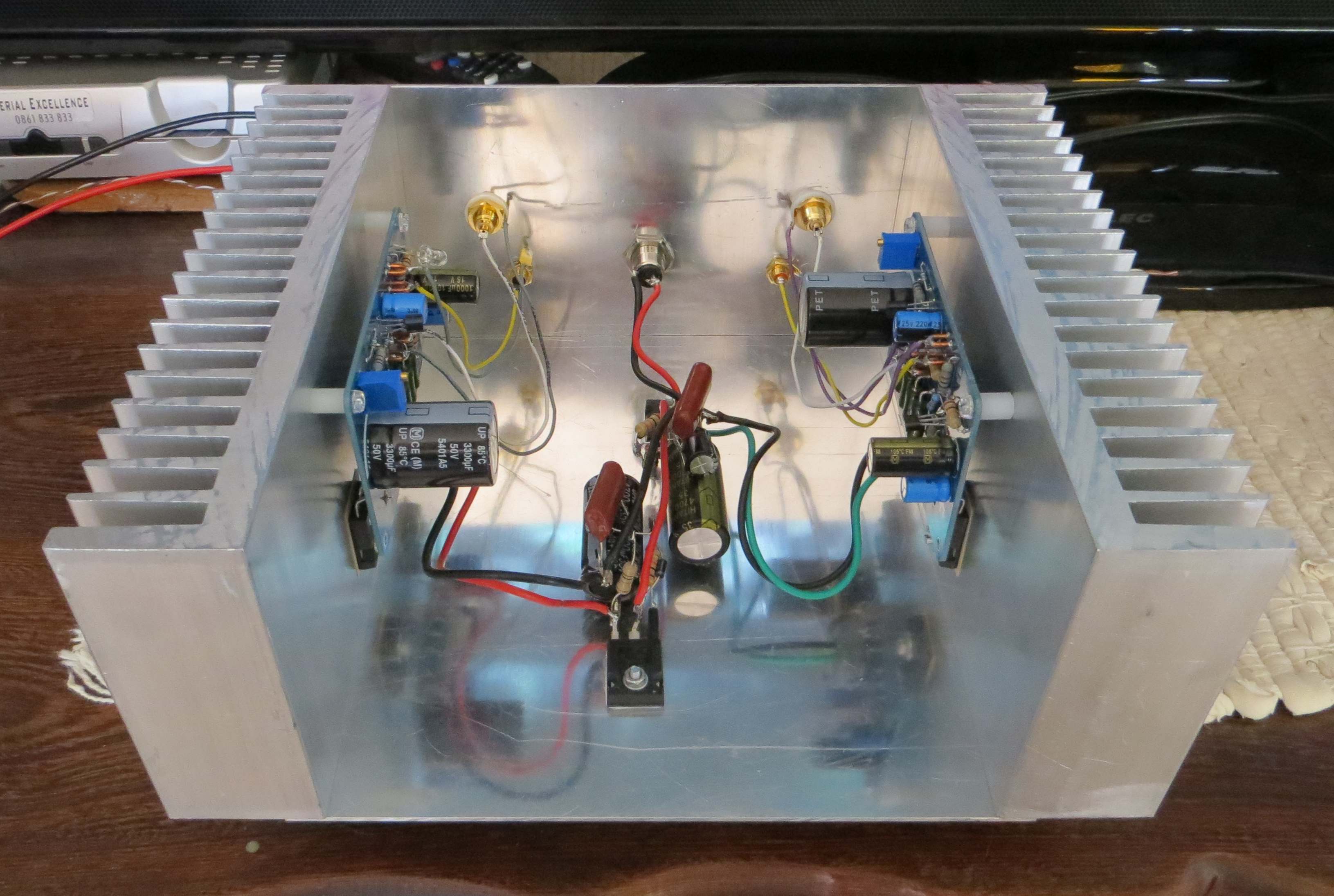

Below is my ACA chassis - all home made, except for anodizing and machining of the faceplate.
Beautiful work Skylar! Totally pro looking - you should be very proud. Photos of insides?
Thanks guys.

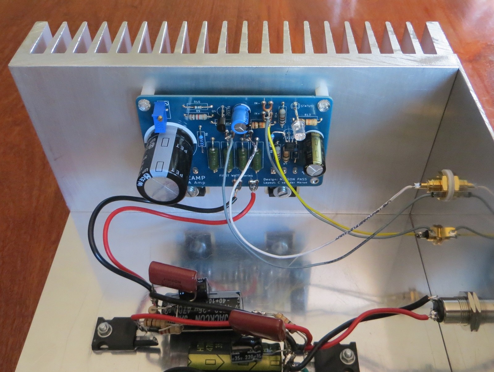

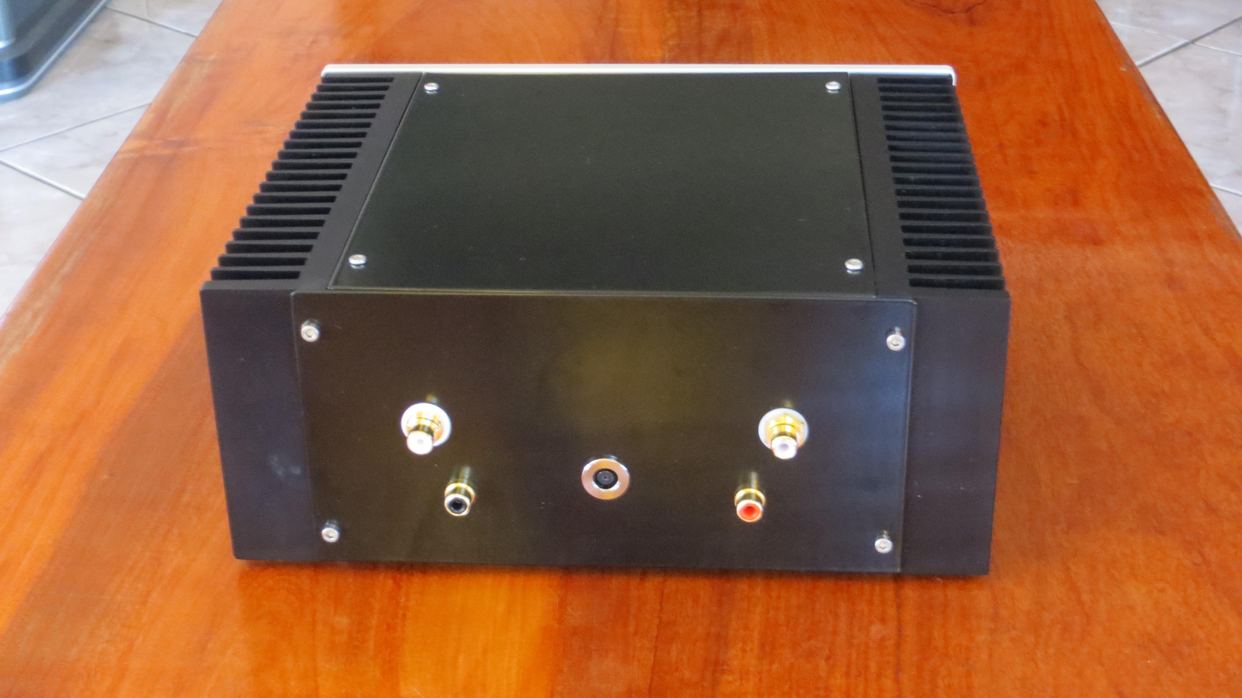

I don't want to hijack the thread, but here are two pics before anodizing and painting. X, you should recognize the cap Mx's on the bottom panel. 😛
It took two weekends to sand away the saw marks on the heatsinks!
I also custom designed the boards and had it made by seeedstudio.com because the store didn't have stock. Now I have even more bragging rights! 😀

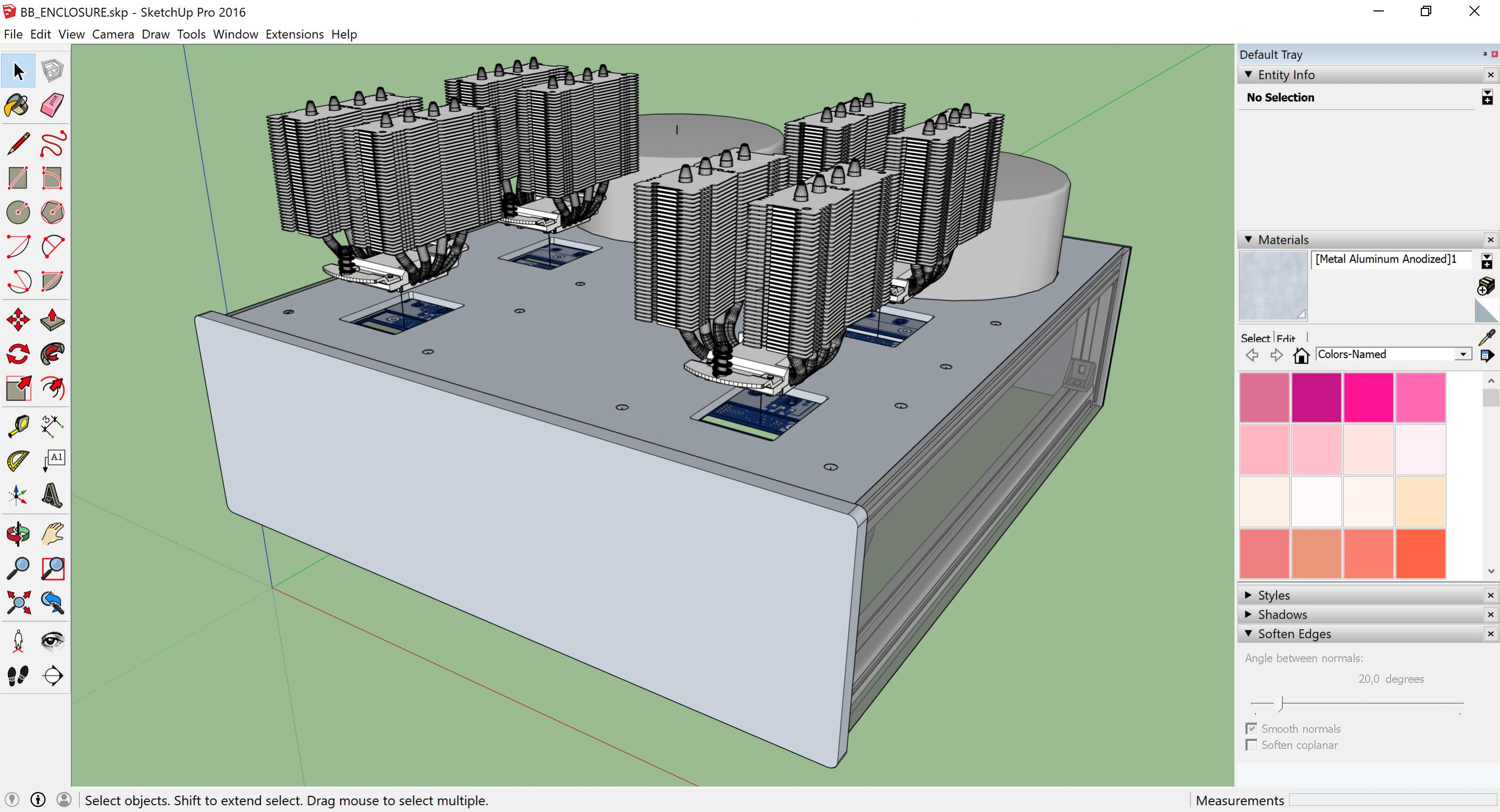

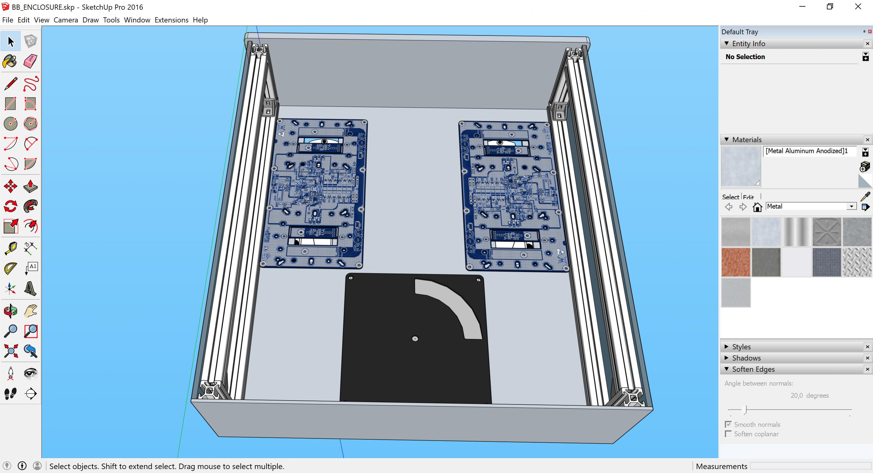

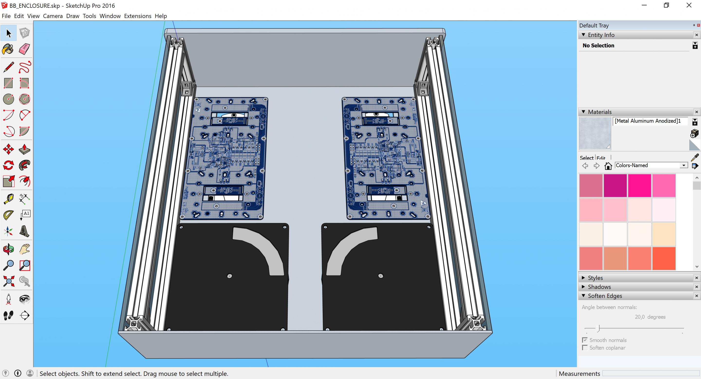

3D construction started (3U):
- BOSCH 20x20mm profiles with accessories
- 4x NOCTUA NH-D9L
- Toroidy TTSAS0800-2x25V
Missing input filtering with DC blocker and pro channel, cap multiplier, CRCRC (probably new design based on Prasi´s one).
I´ll define the volume for my UPACC (with 7" display).

JP,
Nice clean enclosure rendition for the BB 🙂
I think maybe you should increase transformer VA and output voltages thought, especially if not in mono block configuration.
I’m using a 600va, 2x32v trafo with CRCLC and get an end result of +/-38.5vdc with a single BB channel connected.

JP I like your take on the heatsink mounting. I am down the road a bit on my build, so it's nice to see other design options.
It's always nice to see how the designer of the boards makes his enclosures 🙂 Looking froward to seeing your builld progress, JP.

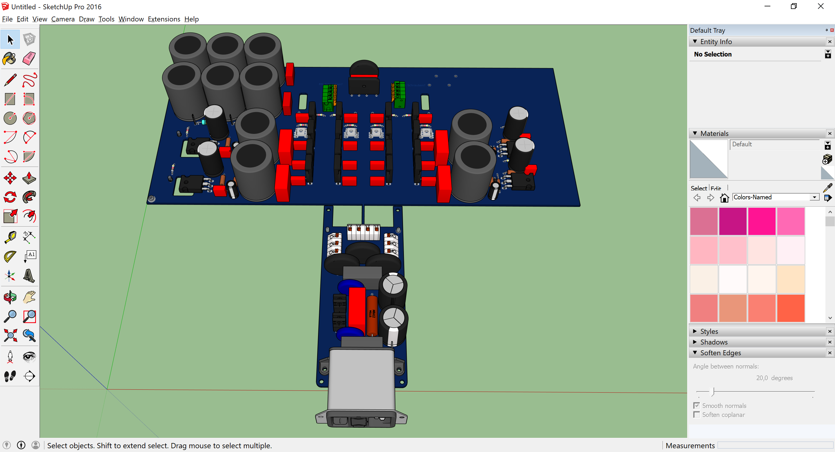

Progress...
Two 600VA donuts.
Main power PCB with filtering, DC blocker and terminals for the two donuts and the UPACC between the two donuts.
Big dual power supply board with Graetz rectifier, capacitor multiplier, CRCRC and star grounding stacked up. Not finished yet but good progress.
