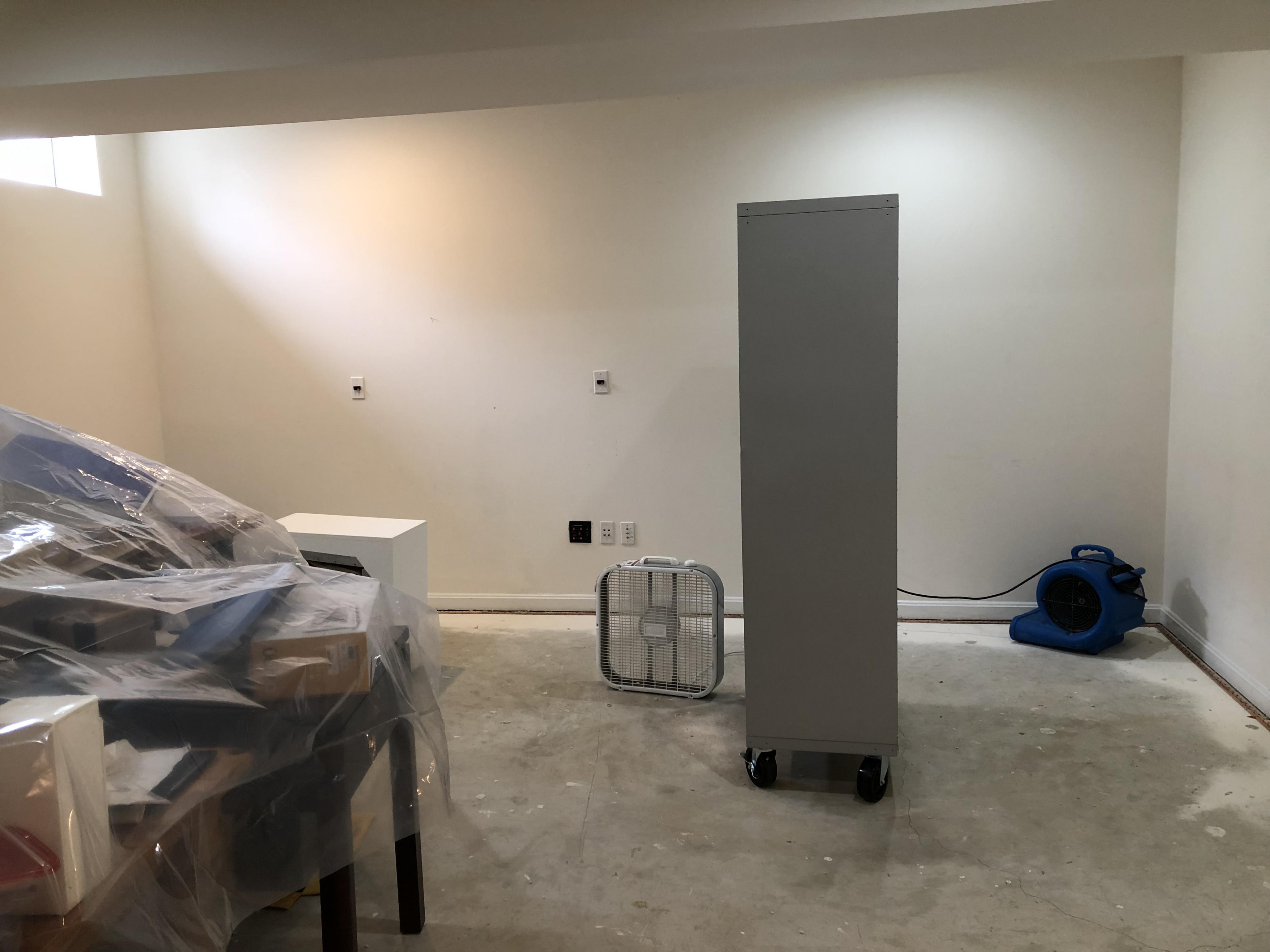

The speakerlab where Alpha B.B. was playing is now under renovation. I had a basement flooding over the weekend and dealing with cleanup. All amplifiers were ok but I lost several foam core speakers. It will be a while before back up and running. I do miss listening to this amp. All wet carpeting pulled out and now in process of drying. Things will be a bit quiet on DIY front for a while.
