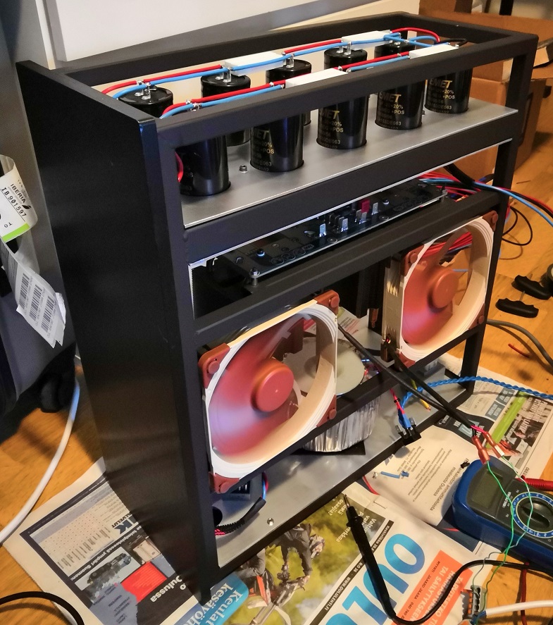

Super nice build Juntuin!
Maybe you could use both left and right sides with speaker grill clothe, covering complete both sides or just one. It would have an audio look? Make a black painted wooden frame with rounded sides to lift everything 10mm?
Just a thought..

Thanks Pinnocchio. And actually that is very good idea, I'll have to do some measurements 🙂
Good idea JPS, but I'd rather try to fabricate something myself since I don't have access to 3D printer. It gets expensive quite easily 🙁

Hi Tonza, I wasn't thinkin using that for the whole side 🙂 but why not, it might work!
..and black edition. I don't know, maybe that tinted acrylic would be better than any of these.
Why do you want to hide the gorgeous details? Show it off.
I agree, showing it off is nice.

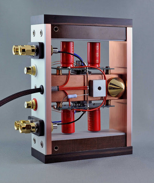

Is that an ACA or a MoFo? How does all that heat from the two MOSFETs bolted to the center bar get dissipated?

If I am not wrong that is a gainclone amp by Peter Daniel:
6moons audio reviews: Audiosector Patek
Juntuin,
Very nice work with the build! Congratulations on the successful execution of some bold design ideas. 🙂

I believe that is a chipamp/ gainclone type of build.

Thanks Z, sides will get trashed tough and something else is coming as replacement 🙂 but even then, this is not the most conservative build..but neither is the B.B., it's rather something old combined to something new.
A gainclone built like a Class A. Nothing against chipamps here, just so much more fun to make discrete amps.
