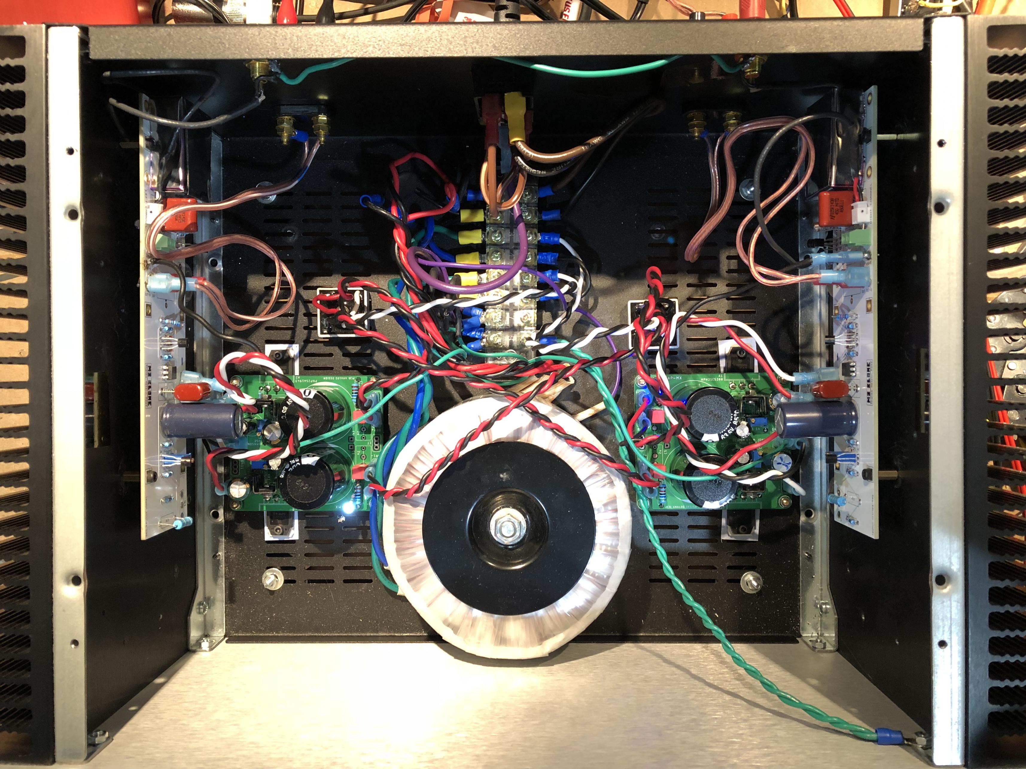

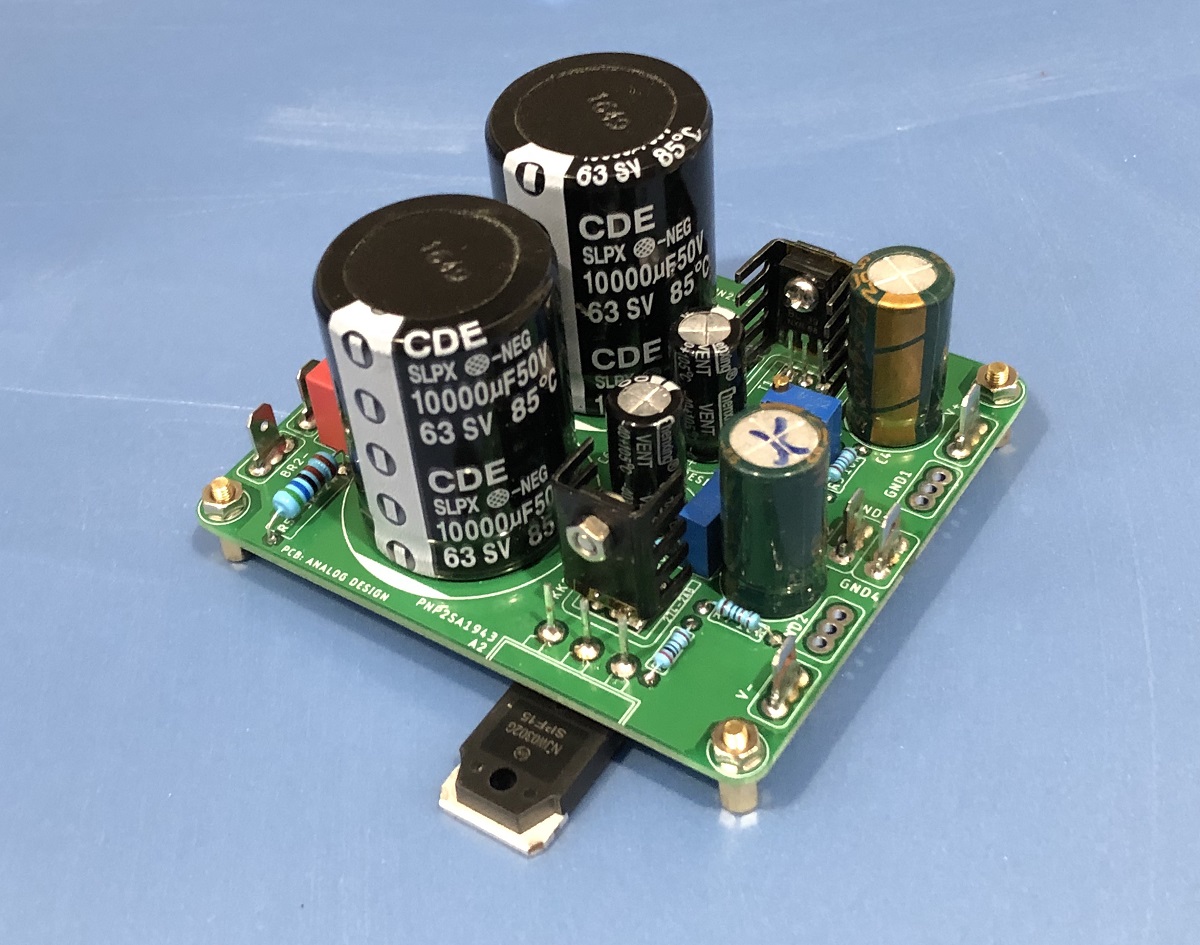

I just tried out the new Mark Johnson cap Mx (Prasi layout)for my Class A M2. Using a single 400VA trafo and one pair of external bridge rectifiers powering two independent cap Mx boards, I was able to get operation without any hum or noise. 100uV rms and 300uV rms on outputs of amps.
Might be a good choice to try for Alpha 20. I am running 1.27amp bias on each channel. Voltage dropout is about 2v and main benefit is only a pair of 10,000uF smoothing caps required per channel.

So a pair of 10mF caps is about 1/10 cost of 8 33mF caps. Cost of 4 BJTs and miscellaneous cap Mx is about $20/pair. So it’s maybe 1/2 cost of CRCRC cap bank for F6 but with better performance of -50dB ripple reduction and superior channel separation. More compact too.

I haven’t tried it in an Alpha 20 yet, but the sonic quality on the M2 beats the CRCRC. Quieter and superior stereo separation which gives better imaging. Note that if you have two power transformers your stereo separation won’t be improved. I am listening right now and have not heard the M2 sound better. You have to deal with the 2v dropout though so size your trafo for higher voltage. I look forward to making another Alpha 20 to test it out.
