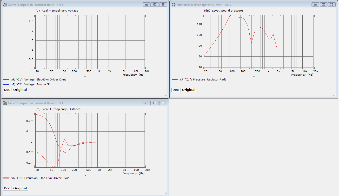

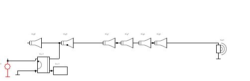

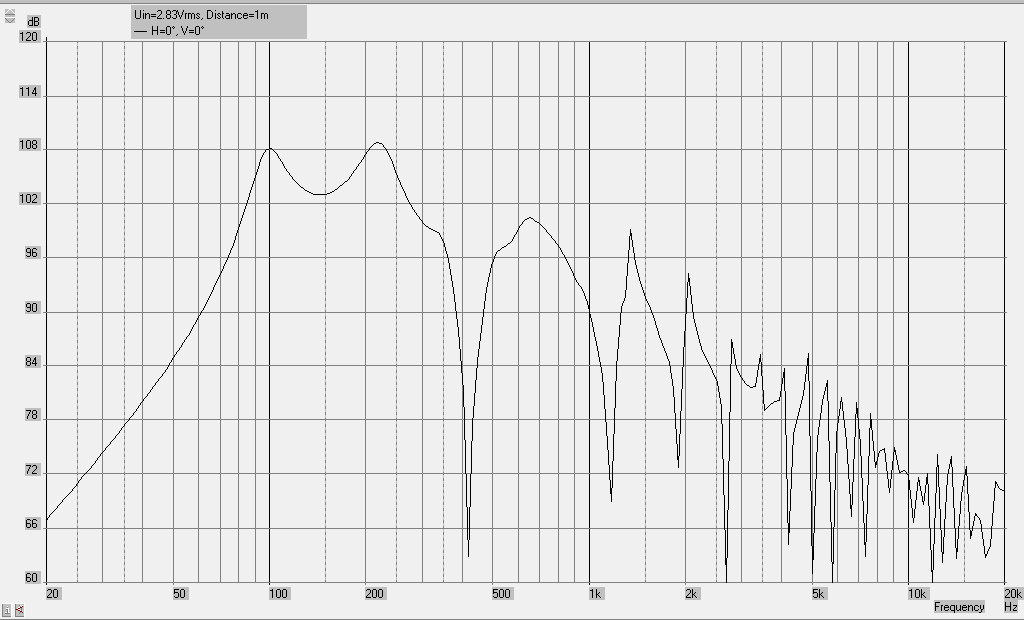

hello all

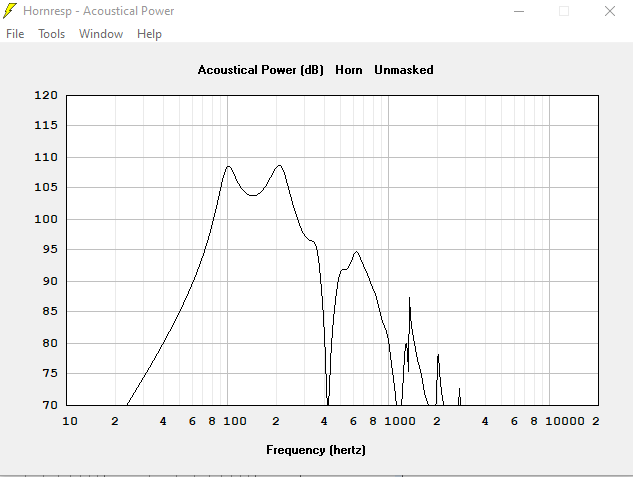

i will present 3 simulations, hornresp akabak 2.0 akabak 3.0 in attachement
so hornesp and akabak2.0 is similare so different of akabak 3.0
in akabak 3.0 driving value 1 isrms not select and source at 2.83 for input voltage in source and driver are in 2.83v rms
how to adjust akabak 3.0 correctly without having truncated curves
I only use the LEM part for simple script meshes for the different horns idicat in attachement

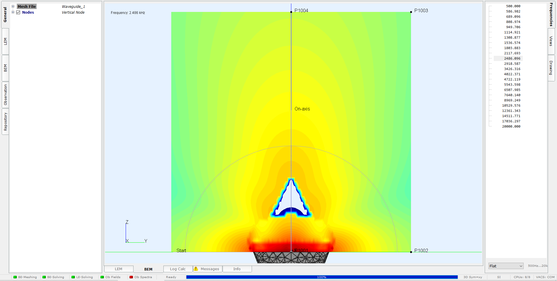

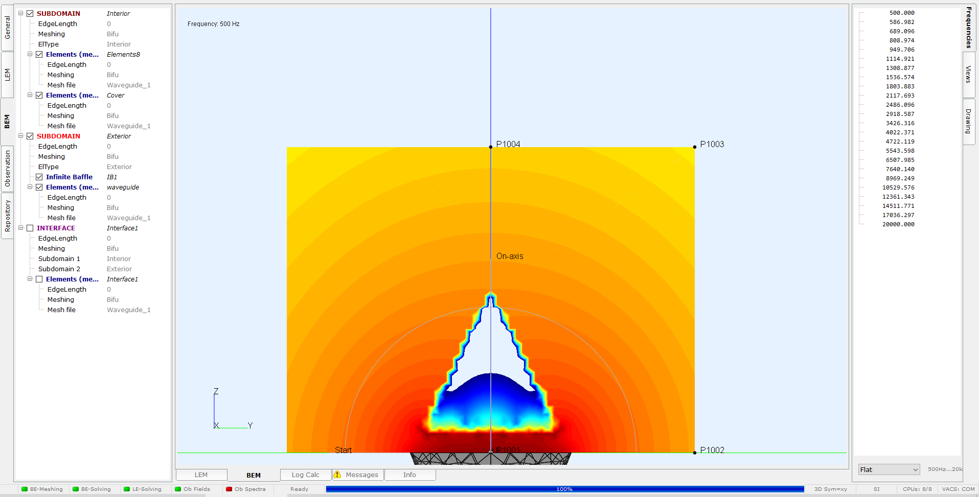

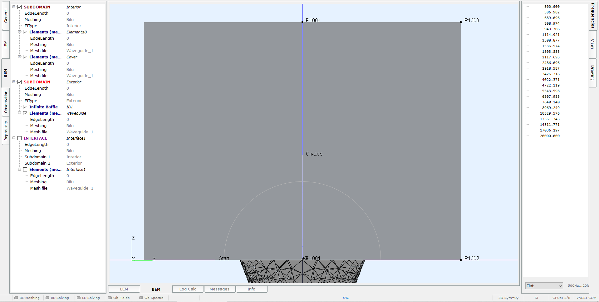

Waveguide Simulation
Hi Guys.
I'm trying to simulate a waveguide geometry but when I run the simulation something goes wrong with my results, there seems to be something in front of it hindering the wave propagation.
I'm using the normal interface that needs to be, I tried to turn off some elements but nothing worked, does anyone realize if my BEM setup is correct?
Thank you all.

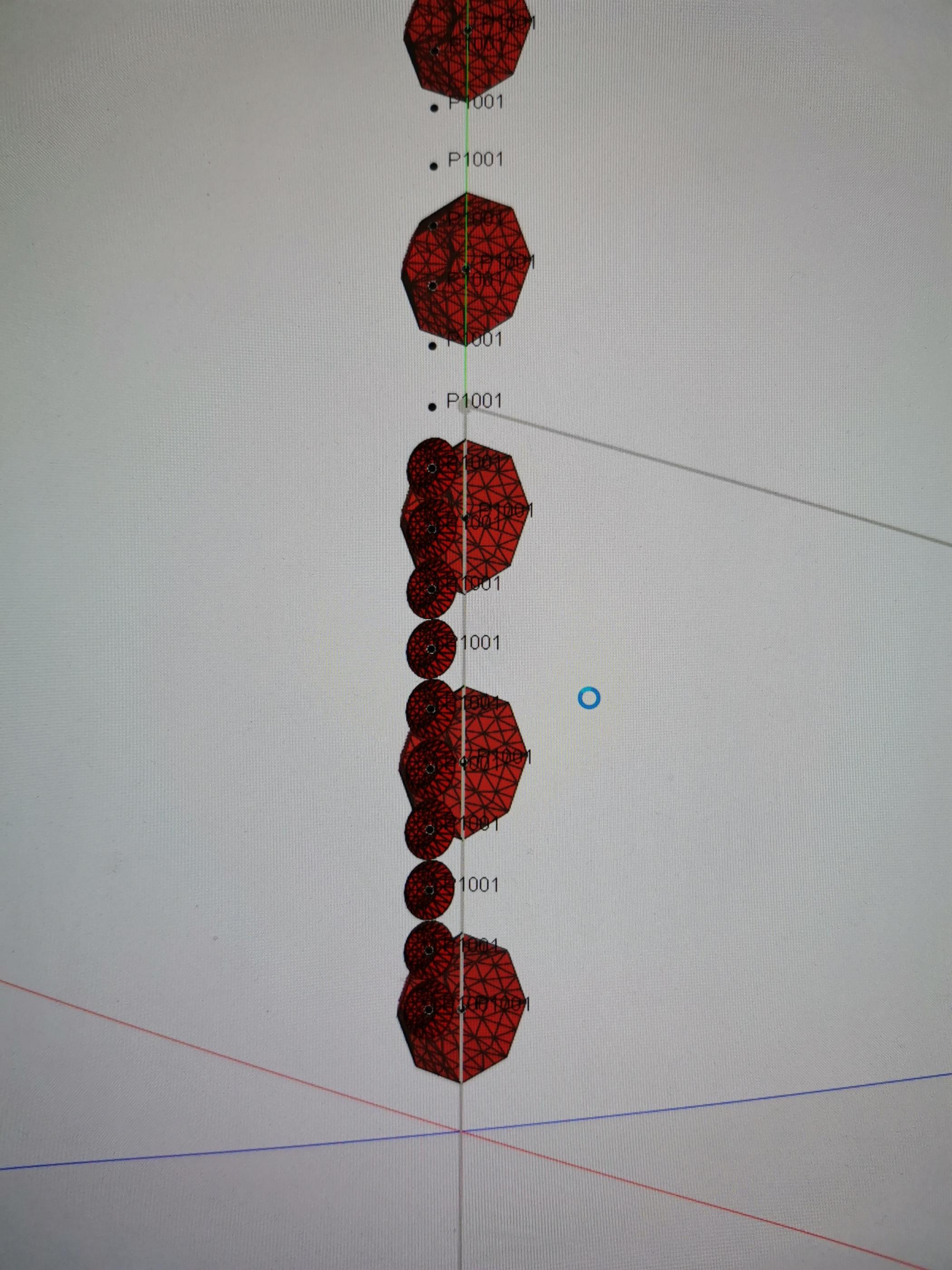

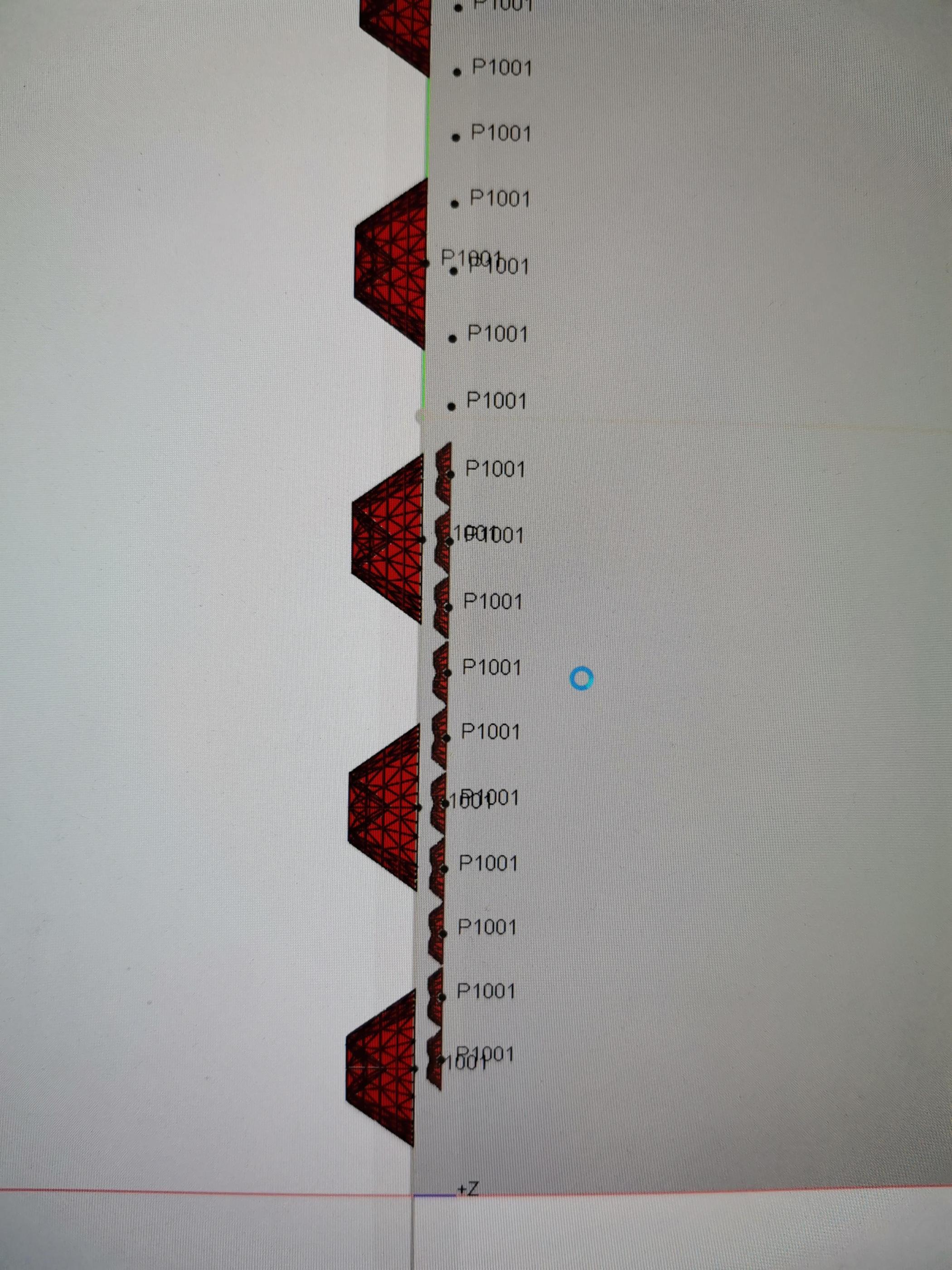

I've been trying to simulate a line array, but when i have more than 10-12 drivers, I get this error:
"Singularity in linear algebraic equation solver.
LUDecomp2 (6.27210971...)
Solving aborted"
The BE mesh and the BE solver show in green, the LE and the rest are the ones showing in red.
If I just delete drivers, it simulates properly, so I guess the method is not completely wrong... But I also don't know where to look.
I also tried to reduce the diameter of the diaphragm in case there was a clashing between the edge/tangent of the diaphragms, but I get the same error.
I guess is something basic that I am missing but I just can't see it, any ideas/comments are welcome

In Akabak 1, there was a limitation on how many elements you could have. It was about 52 or 55 as I recall. In simulating a 25 driver line array I remember I had to be very judicious with how many separate rear chambers etc in order to stay below the limit. This was a lumped element model, and maybe Akabak 3 is still relying on the Akabak 1 core?
I also deleted the LEM elements and only used the BEM diaphragms, and still no luck, I still get the "very high level; change range or move away the observation mesh from the source" or the singularity issue, depending on the number of diaphragms used.
Right now I have what I believe the most simplistic model which is: one node for each speaker position, exterior subdomain, with diaphragms nested in the subdomain, without any baffle and I still get this error, adjusting the range doesn't solve it, neither if I offset the 2D shell for mapping.
Could it be something really basic in the BEM global settings?
