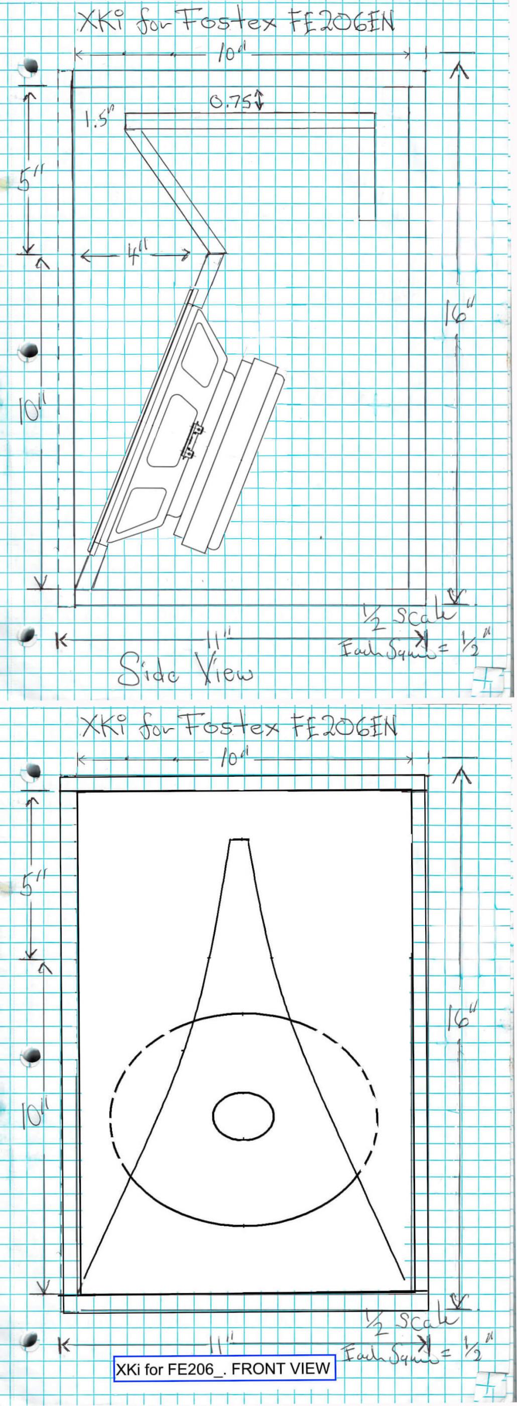

@ kaameelis
Look at this simple Karlson type which has an added "stub" in hopes to flatten response and limit artifacts. There would be damping material in that stub.
Do you see a way in Akabak3 to simulate damping material in that upper cavity ?
So far MMJ and myself have been limited to using hornresp for this arrangement. That may be pretty good - but its not known. Akabak3, if damping material can be simulated for the stub should tell how well MMJ's hornresp approximation works - or show directions for improvements.
As I understand damping materials can be simulated if some damping body/case part is drawn and corresponding wall Impedance is defined for that. I did not know what must be the body shape and wall impedance to get similar damping as is get in real life.

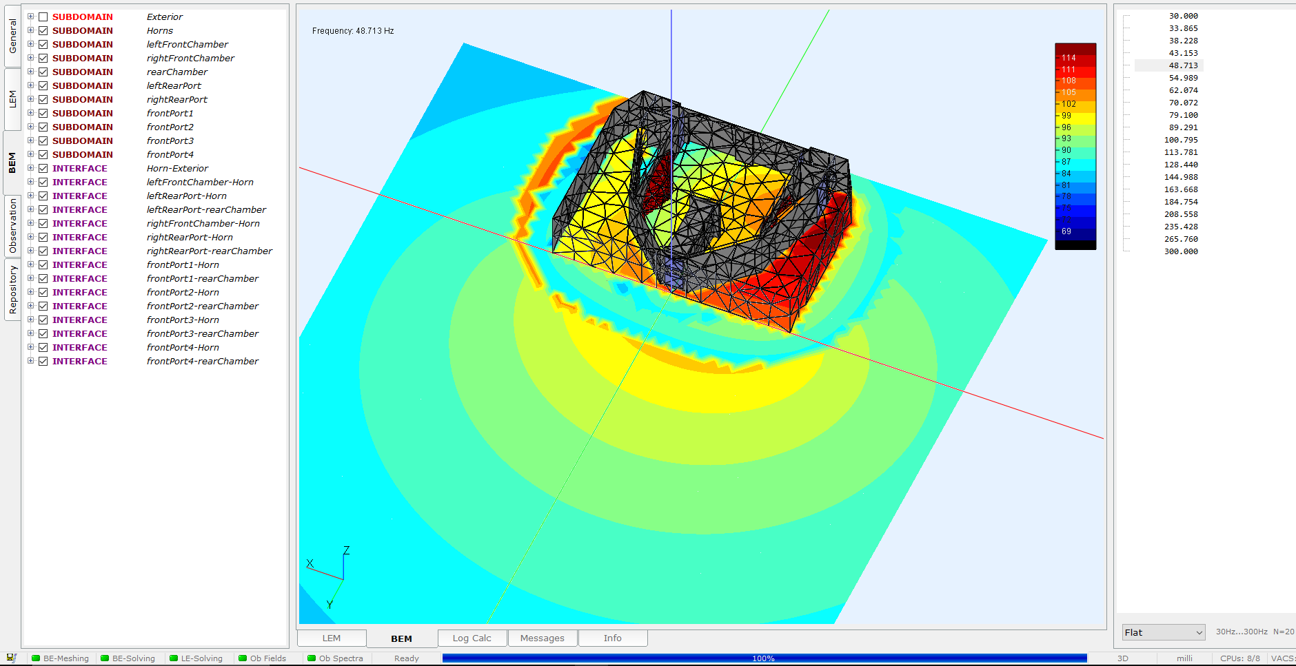

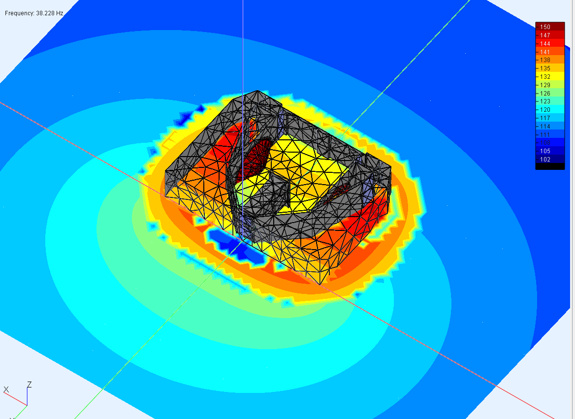

Do we have here any Akabak3 guru? Trying to model modified version of Void X-Air but I'm getting no errors and weird results 🙂. I've already simmed the cab in a LEM getting some plausible results but BEM+LEM is not my friend yet.
Would be anybody so kind and review my Akabak project? I'm particularly interested in checking the BEM boundaries definition as I had some difficulties with mesh generation in gmesh and mesh is not exactly what I would like it to be - in a nutshell - some BEM boundaries are shared between multiple subdomains.
Project overview
Cab construction: dual reentrant hornloaded 6th order bandpass ?🙂
Simulation type: BEM+LEM
Processor: Intel(R) Core(TM) i5-10210U CPU @ 1.60GHz, 2112 Mhz, 4 Core(s), 8 Logical Processor(s)
BE-meshing + BE-solving time: 37m
Subdomains: 11
Interfaces: 15
Frequencies: 30Hz - 300Hz

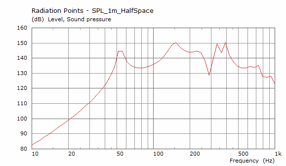

LEM simulation (what I would expect in BEM+LEM)
Current BEM+LEM SPL field is far from consistent 😕
All interfaces' normals directions were triple checked.

Found out that I had both front sides and rear sides of diaphragms in the rear chamber subdomain. After moving front sides to front chamber subdomains I'm getting somewhat better results.

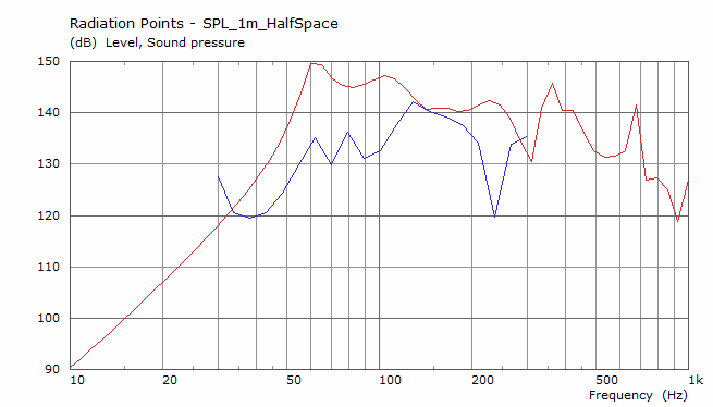

Red: 1m half-space SPL (LEM only method)
Blue: 1m half-space SPL (BEM+LEM, mesh)
Radiation field still inconsistent

The elements in a subdomain must be labeled either interior or exterior. The default value is interior. If that label is not set correctly, you can results for the fields like you showed in your post. It happened to me several times because it is very easily overlooked.
