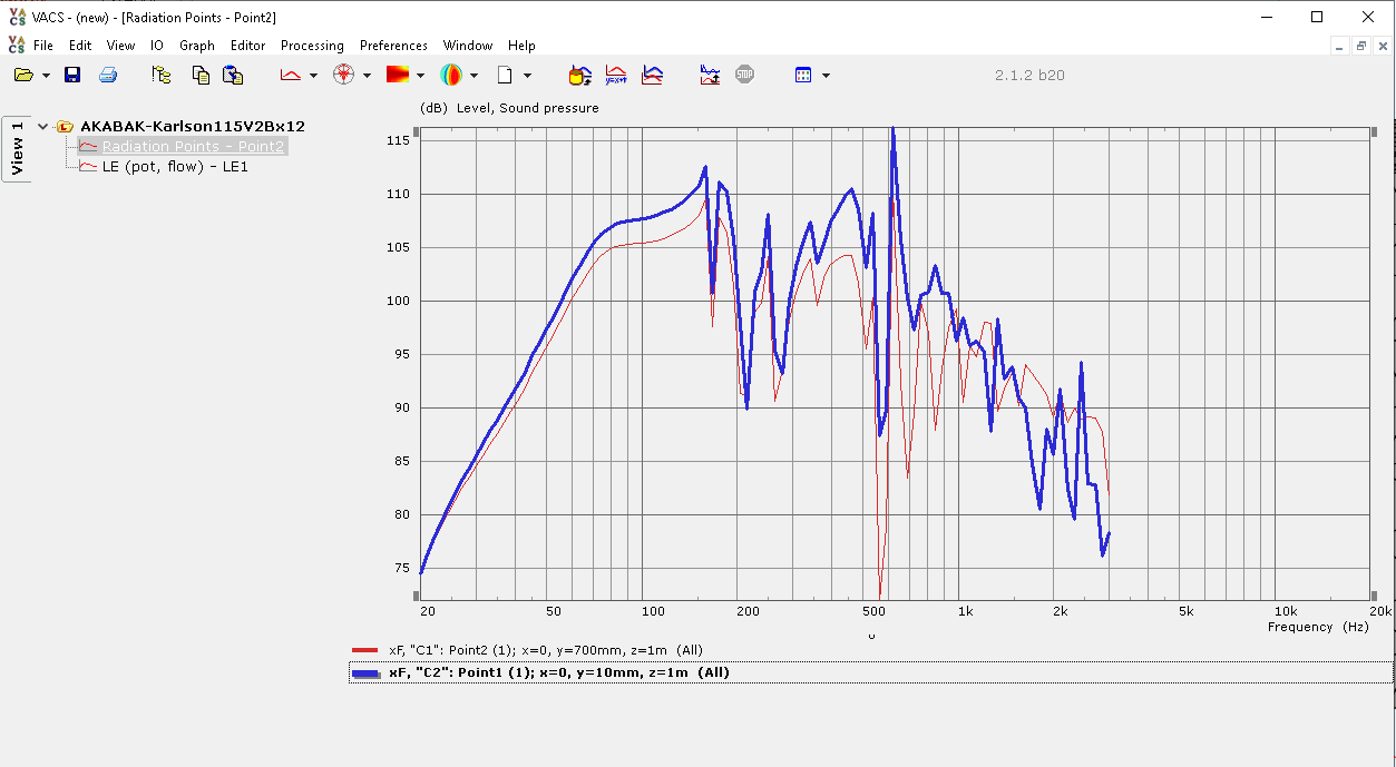

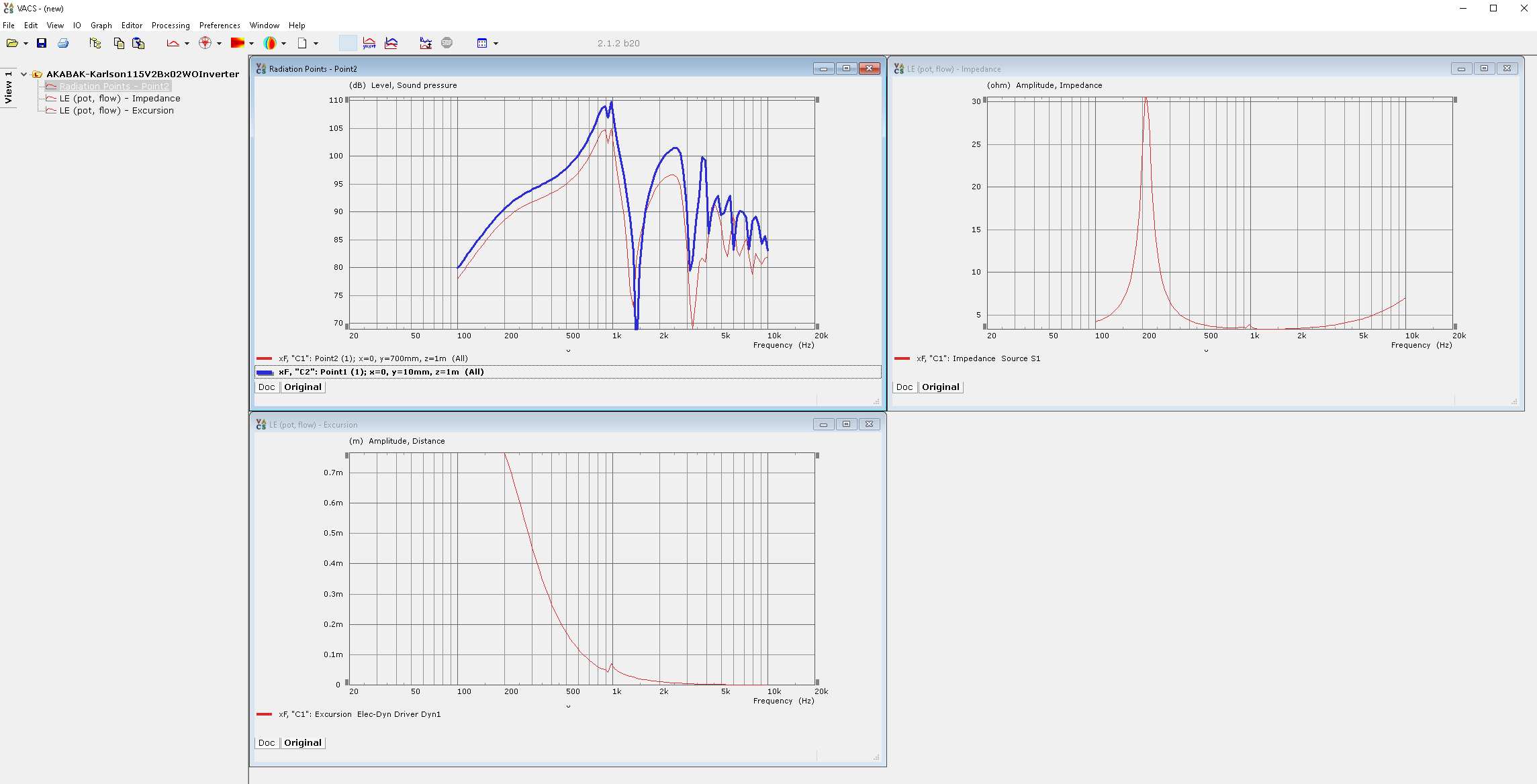

Here's (I think) an on - central cabinet axis graph of K15 outdoors vs a reflex the size of K15's rear chamber. Sorry I did not use the same driver for both but had no help to carry things.
As I understand AKABAK not simulate cabinet material properties, it is always like fully non-flexible, and all cabinets have maximum possible Q, at least in way I currently simulated Karlsons. I did not know is there other way possible. Probably can be, I see not reasonable to make so complex software without material properties simulation functions.@kaameelis.
Thank you very much. I think the correlation between your Akabak3 simulation and my graph is very good other than the depth of the nulls.
What factors in the real cabinet vs the simulation might make the nulls appear different in depth ?
115BK were made fairly well of Russian 18mm* birch plywood with twp 9mm steel allthread braces for the "wings". Akabak3 is quite powerful to be able to examine such enclosures such as Karlson type from a 3D model.

I checked Akabak manual. There is possible to define for subdomain elements (mainly cabinet walls) boundary parameter like Wall Impedance, this can involve material reflection and damping.
In all previous simulations I had made or modified, boundaries where defined as "Neuman (full reflective)". Wall Impedance can be defined also as data file.

This it is, Karlson115 multiplied by 1.2. Speaker element diameter is 410 mm, T/S parameters are form Kappa Pro15A.
For previous simulation I also used Kappa pro15A T/S, but diameter was 340 mm, what is not very correct, significantly less than Kappa Pro 15A actually had, this probably caused faster roll off in low frequencies.
interesting. Yes - smaller Sd than a normal 15 inch deiver in the 1X 115BK cabinet would roll LF off faster and probably peak the response curve sharper around 200Hz.

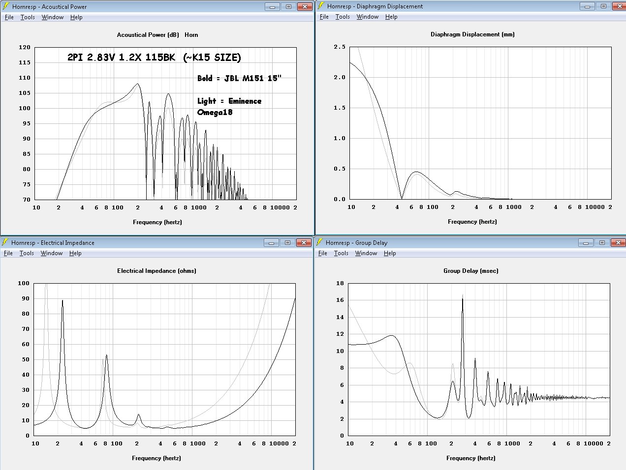

I currently do not have access to hornresp. Matthew Morgan J. made an approximation of 115BK's behavior for hornresp.
Here's a hornresp MMJ napproximation from some time ago of 115BK at 1.2X with Eminence Omega18 T-S.

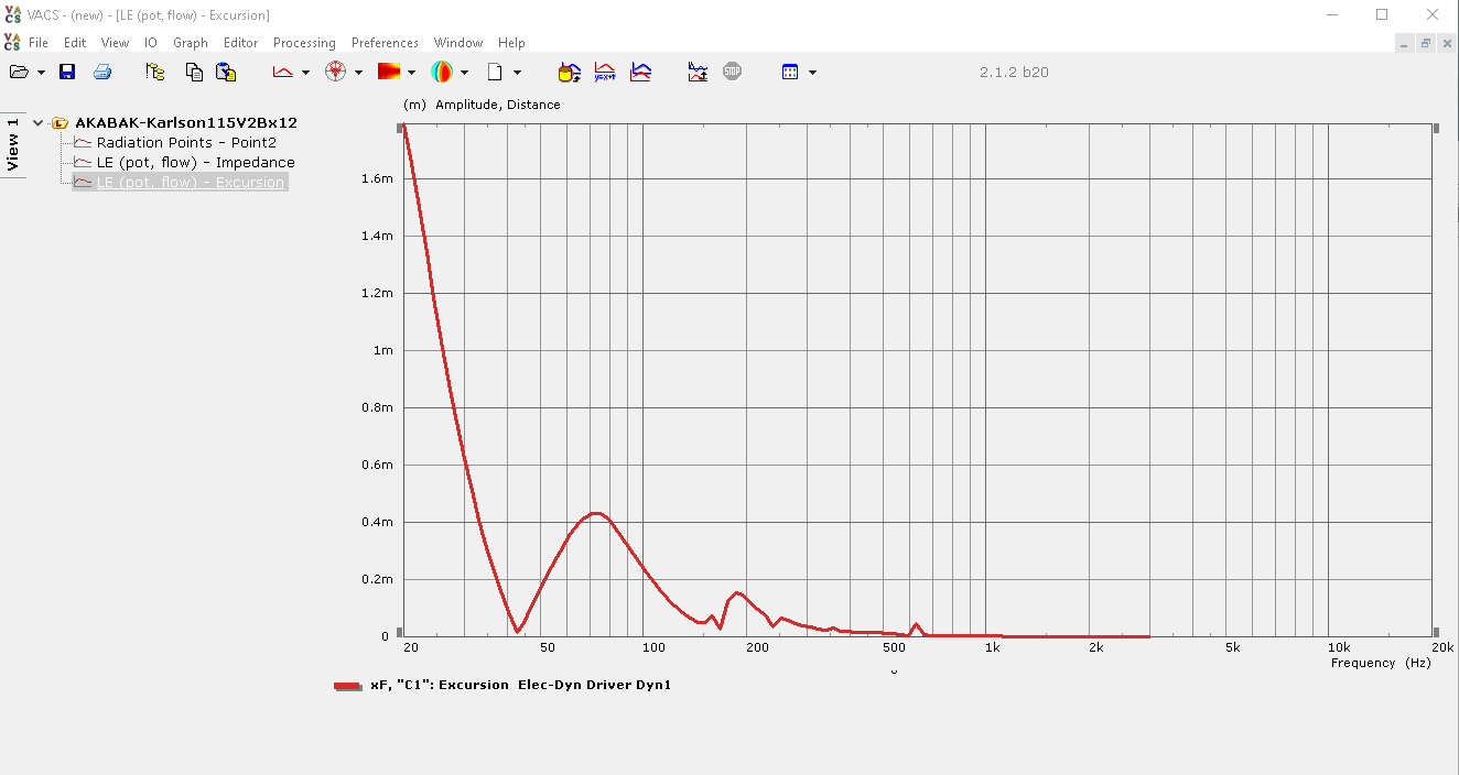

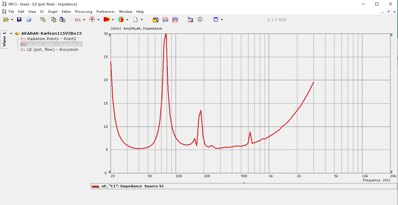

If you still have your 1.2X simulation file open, might you post its impedance and excursion?
Very cool - - - tuning looks right on a 4 string bass guitar or string bass "low E" string. Also, there is substantial excursion reduction where the front chamber resonates so would guess modulation distortion to measure low over a certain range of two tone combinations.

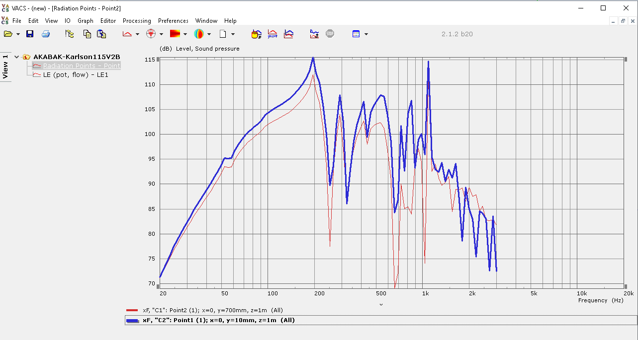

Regarding the Karlson115 1.2X simulation, is there an easy way to shut off the vent's contribution and see response with the back chamber sealed? - - Or does a new model have to created?
I was easy, I redefined interface between rear and front to wall.

The basic 115BK sealed port cabinet response dips scaled 5X "up" in frequency and are quite deep.
I wonder if the back chamber and middle chambers (which have no damping material in the model) are causing a lot of the dip activity?
For tweeter use, the middle chamber could be eliminated, damping material used in the rear chamber, and maybe an aperiodic vent for the rear chamber to lower the impedance peak. Rear chamber volume could be decreased to increase power handling.

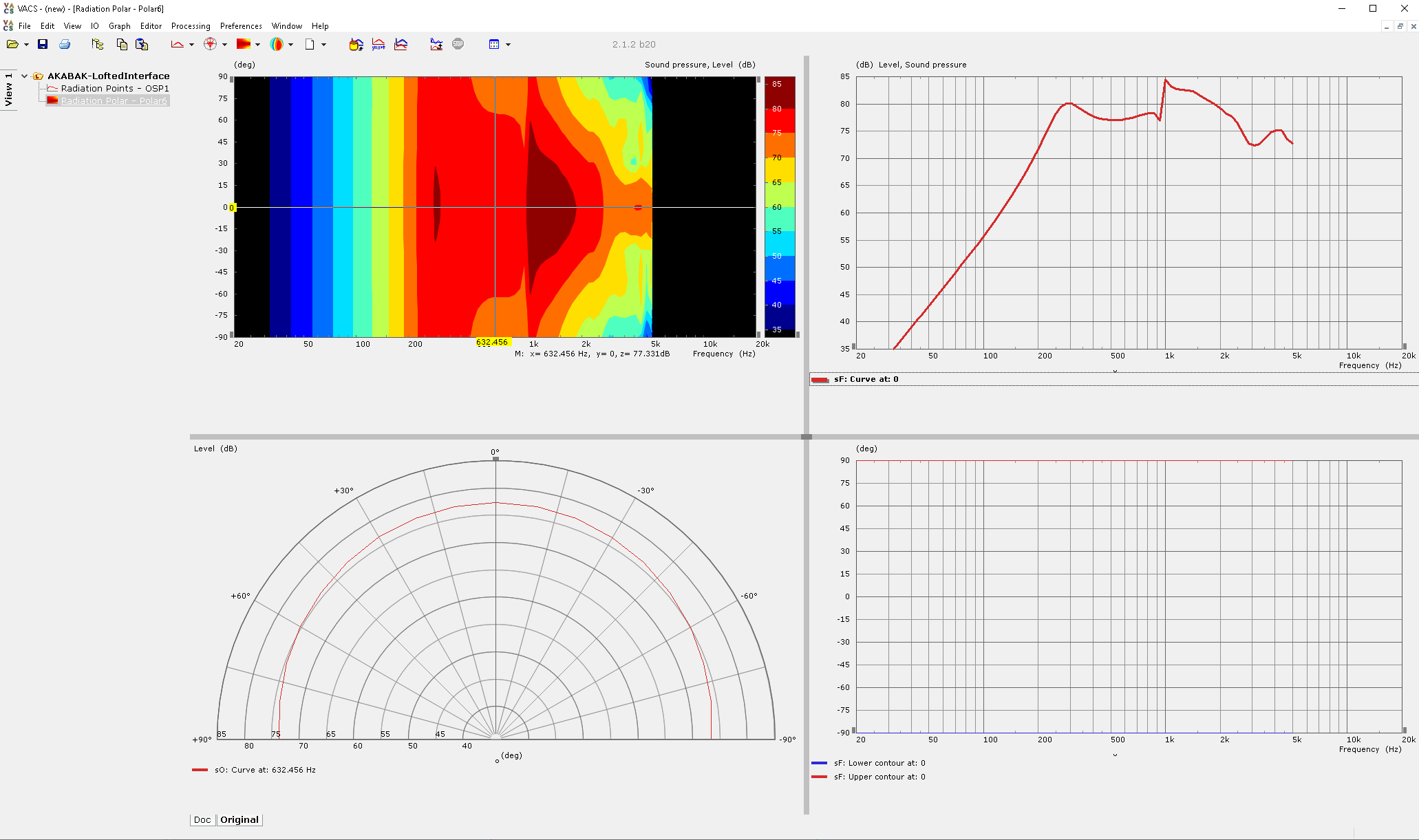

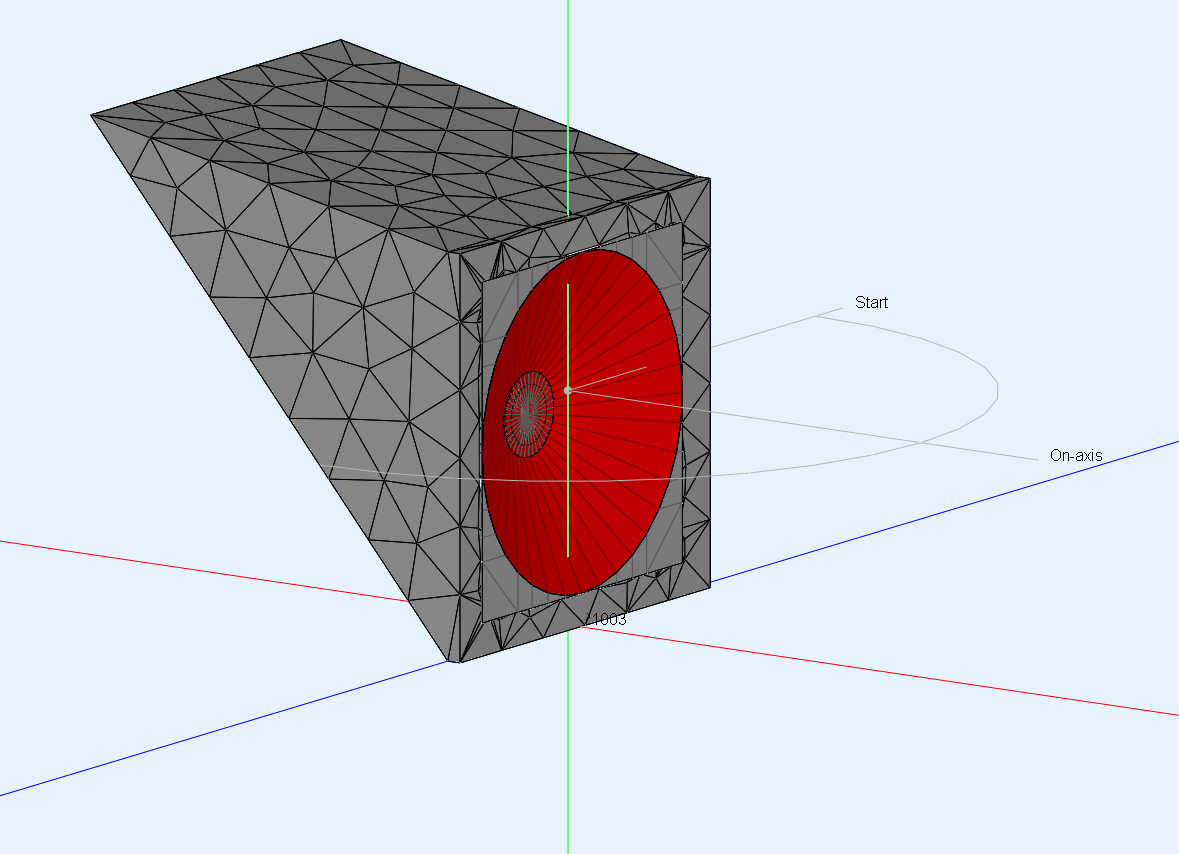

I simulated the LoftedKslot, but increased its size 2 times, to fit my speaker element what is used for simulation in this thread: Open baffle MTM questions
Result is interesting as this works for OB speaker to reduce significantly dipole nulls and peaks what I actually looking for. Polar plot is not very dipole like but good compared to my other OB peaks and nulls elimination attempts.
Only problem is that speaker magnet did not fit in to cavity as it is very big, simulation is made without magnet, only pure diaphragm radiation.
I am not sure I understand this - the model I made is meant to be attached to the front of the driver with a back chamber for the magnet. But the results look encouraging, the deep dips are now gone. I need to measure this soon.
