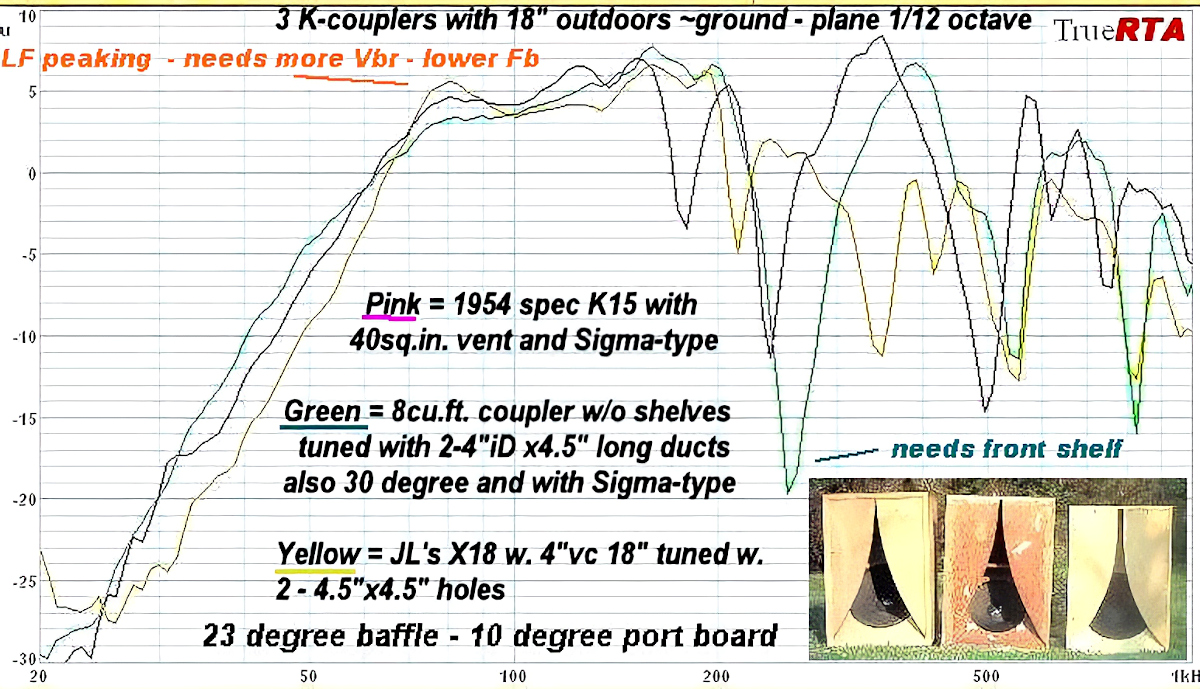

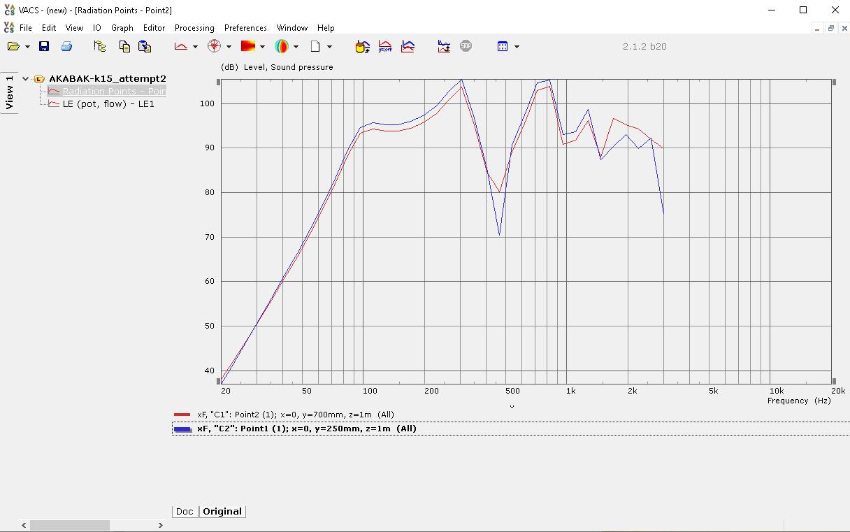

That looks plausible - and suggests front chamber aspect and depth might be changed in hopes to lessen the first dip - such as making the front cavity less deep.
The cabinet with the deepest dip in this picture was about K15's size and with a 3 panel reflector. The middle cabinet is an old K15 with 40 sq.in. port and its 18 inch speaker mounted over the 13.3 inch cutout. The smaller cabinet to the right has a more shallow front cavity and smoother response.
I'm not sure if having the microphone on the ground is a good way to check smoothness - what do you say ?
This is case where Akabak3 could solve things which normally take empirical work. Such as see if a particular cavity, port placement, and other factors produces better results than others.

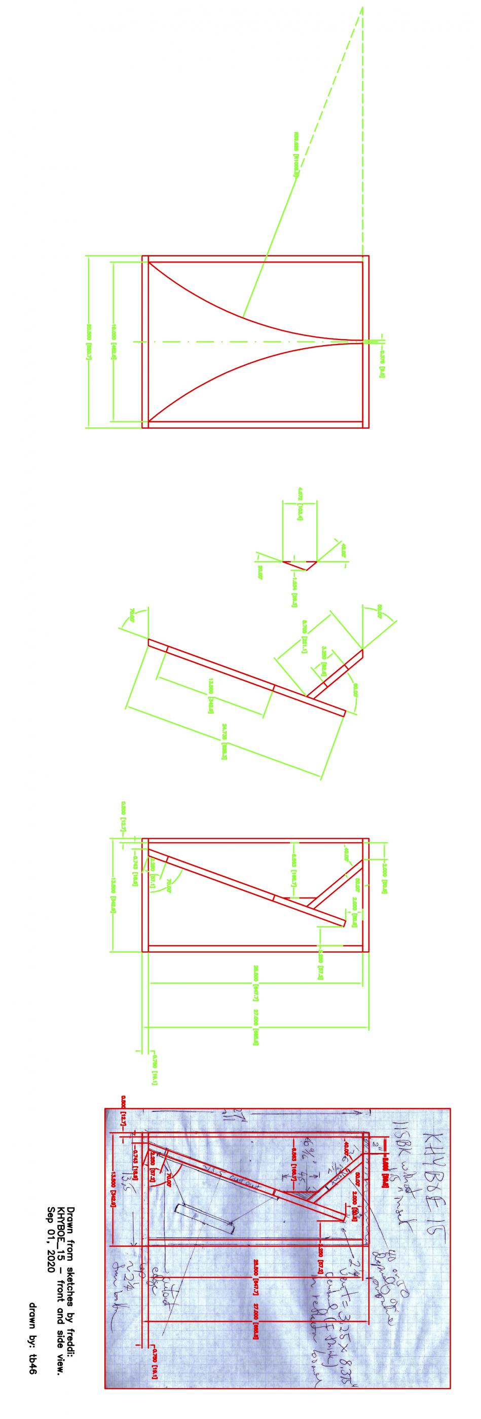

maybe pelanj or other handy person could make a 3d model from the Acoustic Control 115BK, which when scaled 1.2X would be K15's bulk and accommodate 15 or 18 inch speakers.
I don't know if there's any inherent advantage to its baffle layout - but it does play smooth

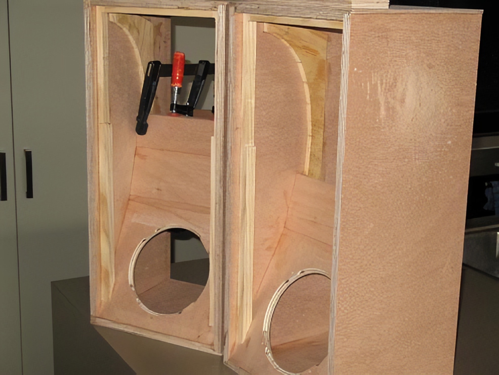

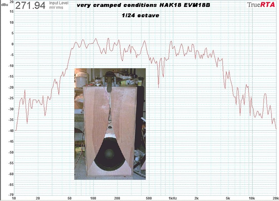

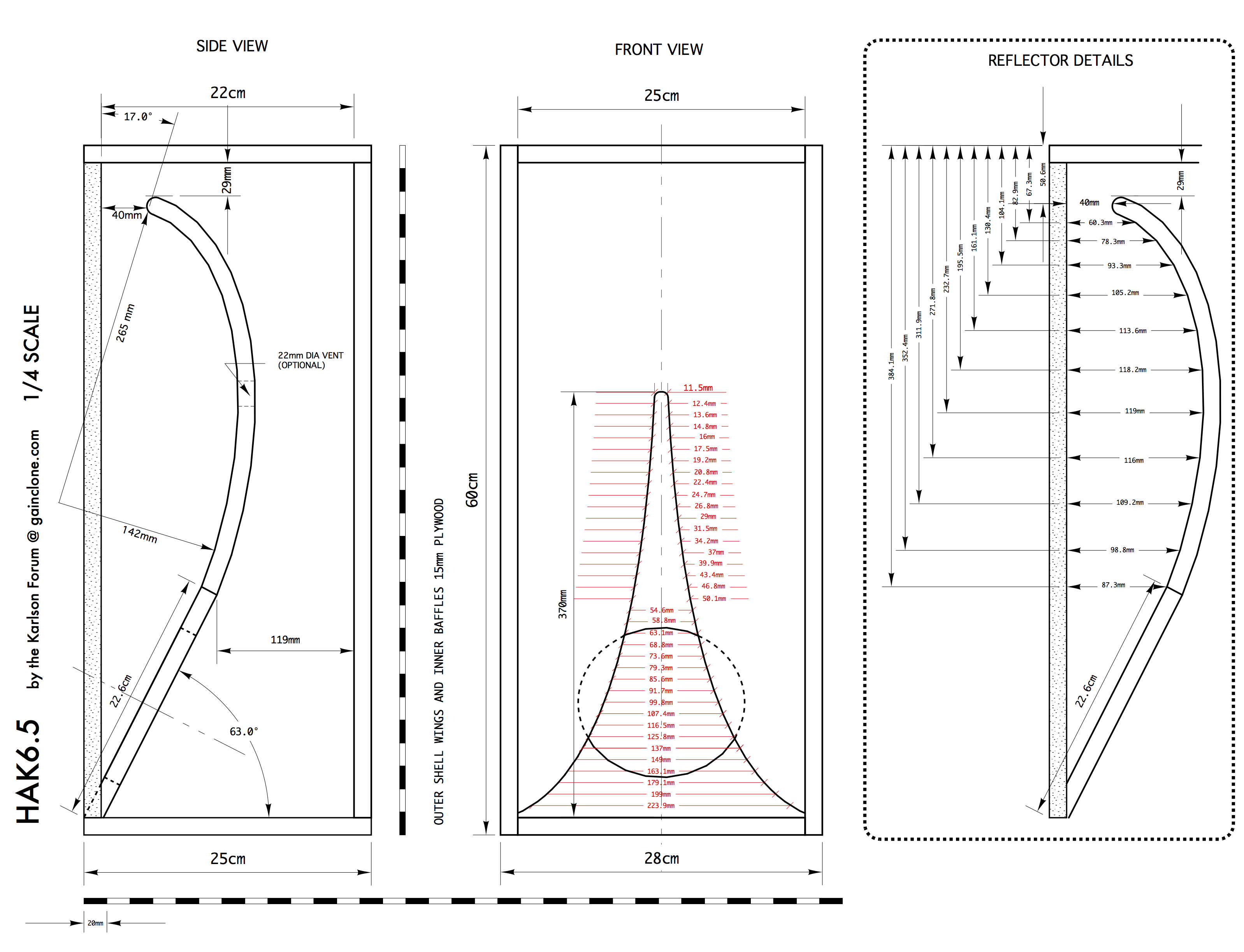

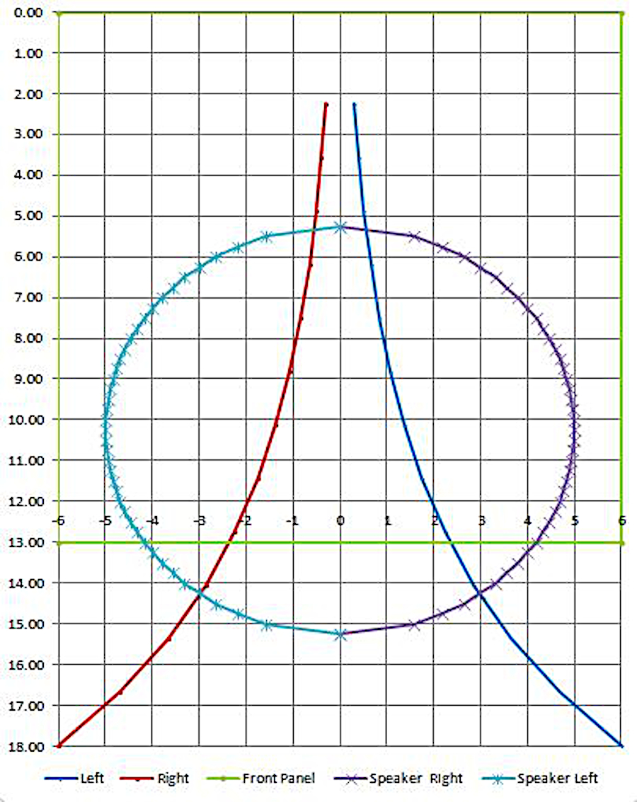

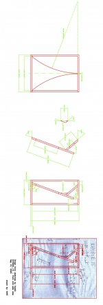

also, one Karlson builder's scheme with a curved reflector and vent at the top of the reflector. This plan is a 6.5 inch driver version scaled down from an 8 inch cabinet plan
It would be interesting to see what Akabak 3 would do with that cabinet.
I have an 18 inch driver Karlson type which is a very good performer - was just a guess.
The picture at the far right is the 6.5 inch driver cabinet

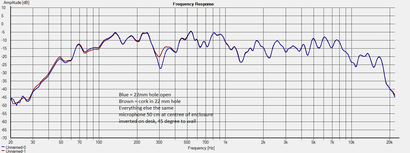

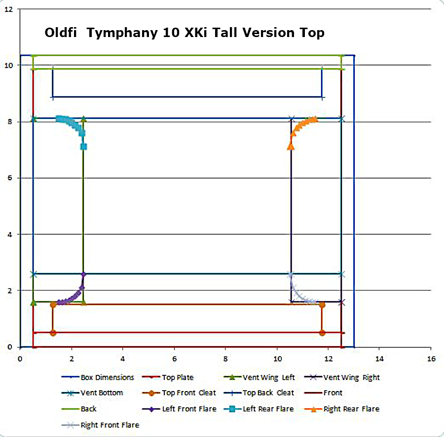

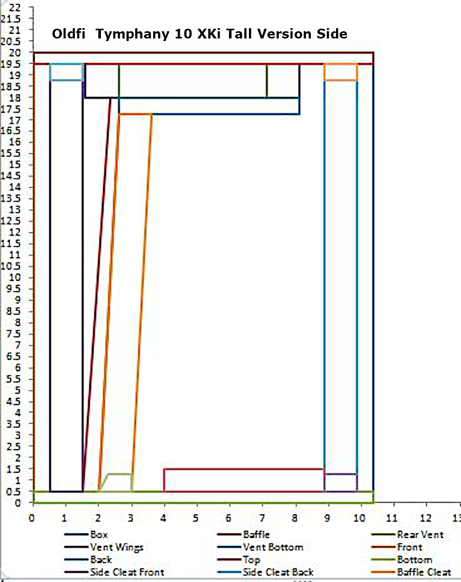

another case where Akabak 3 should be very useful would be to examine horizontal on and off axis response of member Oldfi's "XKi" cabinet as its tapered aperture is quite narrow.
The vent is shown in the top view and 1.5 inches high and flared at both ends.
-- thanks to TB46 for an Autocad 2d drawing, and Pelanj for translating that drawing into a 3D file, I now have the 3D file for Acoustic Control's 115BK Karlson-type cabinet.
It would be interesting if kaameelis would examine how it does in Akabak3 at regular size, scaled ~1.2X to K15 size (would accommodate 18" speaker) and perhaps see if it could downscale somewhat.
I'm not sure how to upload that file so PM for my email if interested

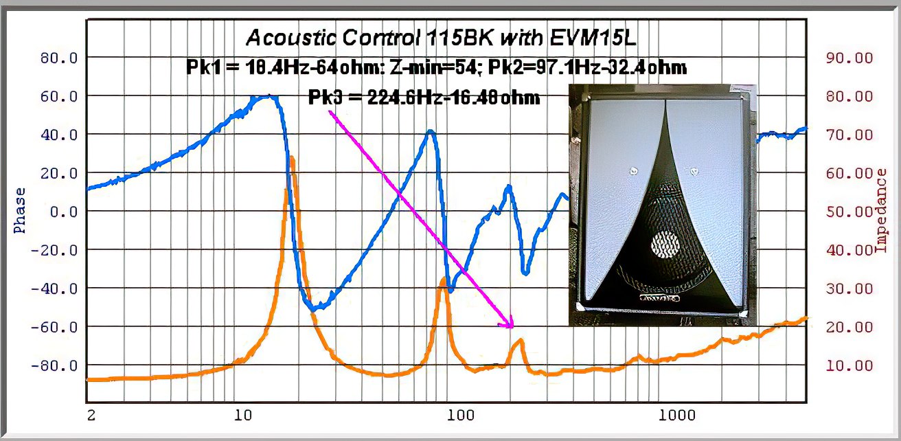

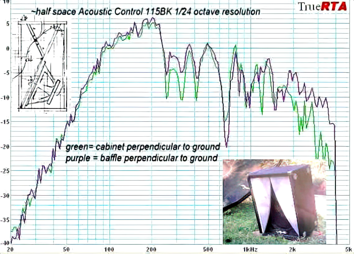

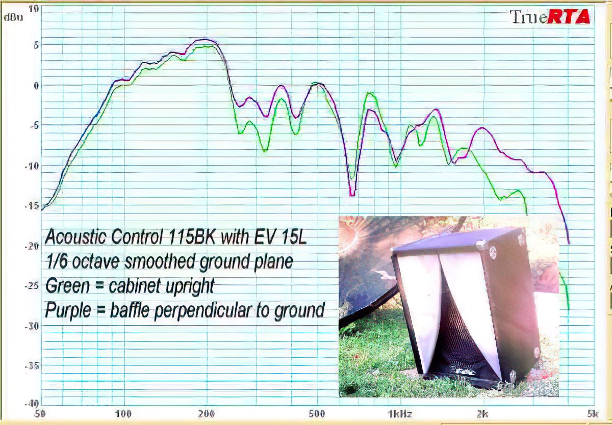

For reference, here's what I have for measurements of the Acoustic Control 115BK cabinet, loaded with Electrovoice EVM15L.
The mic laid on the ground 2M away from the cabinet. Two sweeps were made - one with cabinet upright, one with cabinet tilted forwards as to put the speaker baffle perpendicular to the ground,.
There was no damping material whatsoever in the cabinet.
I have a question which hope Akabak3 can solve. Is there an excursion dip where the front chamber resonates? Perhaps that would show different for the 1.2X version with 18 inch driver than with 1X and 15 inch driver. That does not show with hornresp.

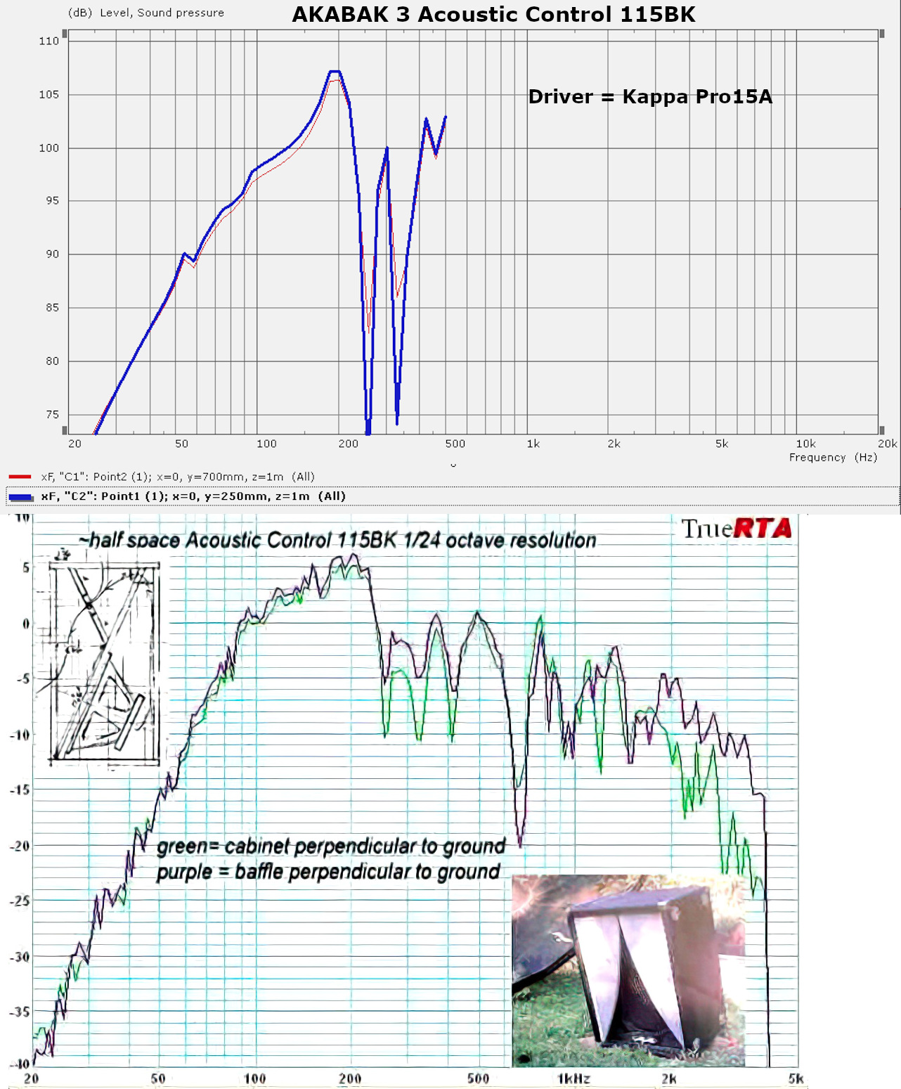

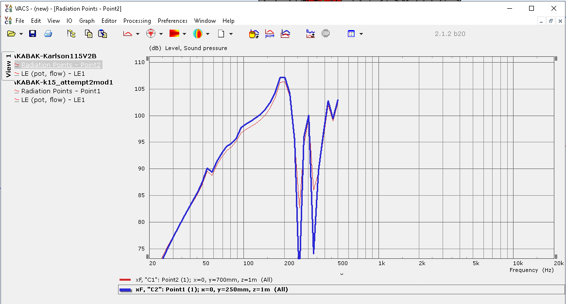

@kaameelis.
Thank you very much. I think the correlation between your Akabak3 simulation and my graph is very good other than the depth of the nulls.
What factors in the real cabinet vs the simulation might make the nulls appear different in depth ?
If both the 1951 Karlson "K15" and Acoustic Control's 115BK were new - "not yet built" designs and 115BK were scaled to K15's bulk, plus each used the same driver, one would probably say K15 is the better of the two proposed designs based on Akabak3's interpretation.
