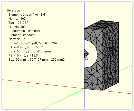

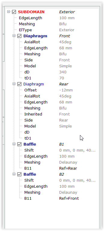

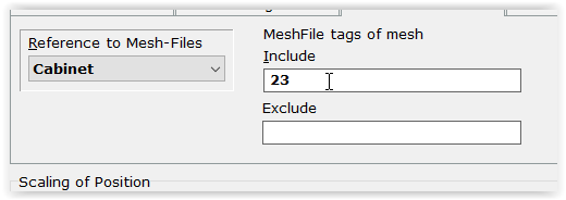

I did not use the mesh file but baffle component to define the baffle.
Use the tag (23 in this case) to align the location of the diaphragm to mesh define baffle.
Hope this answer questions.

Is this general rule that alignment to mesh file boxes is made with pointing mesh tag? What point of mesh is actual alignment point? All meshes had 3 points.
What if mesh file box had no mesh element in the center of speaker installation hole, if it has just empty hole?

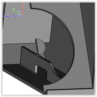

Use the tag number, which consists of multiple points (elements), to align the driver.
We use tag numbers (names) to select which parts of the mesh file is included in a specific subdomain.
You need to add a small disc in CAD drawing solely for driver alignment.

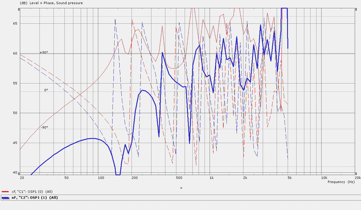

I get some result out of AKABAK with test OB speaker.
But result is not very reasonable.
As can be seen on image OB speaker missing dipole peak and dipole minimums in level lines.
Measuring points are 1 m from speaker.
What I had possibly made wrong?
Project file contains 3182 elements and full calculation time is over 1 hour on 3.7GHz 8 core CPU, calculate at your own risk.

When I look at example project "Speaker Cabinet SP38 Mesh-Files" I see rear and front diaphragm had offset 12 mm. In my understanding this can give wrong results. What can be the reason of diaphragm offset?
This is an "error". The project is updated as the attached. The baffle thickness is 10 mm. An offset of -10 mm is used to not taking the "tunnel" in the model.
I shall compare the AKABAK result to LEAP.
Did this mean that offset give smaller error than tunnel?
But in real life there is also existing "tunnel" and sides of diaphragm had zero offset.

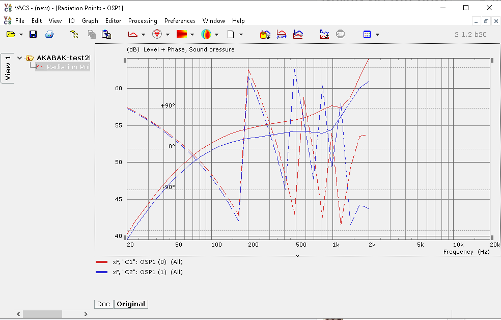

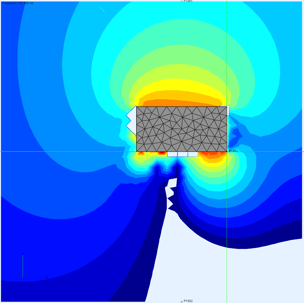

Had you look at my OB project, why I am missing dipole peak and dipole minimums in level lines?
I made other mesh of open baffle speaker box without cutout and attached same speaker elements to it but get nearly same result. No dipole peak and dipole minimums in level lines.
I upload also pictures to see, what kind of problem I had.
OB is U-frame with 300 mm depth, 2 elements in it. I not using symmetry for calculation. Diaphragmas are standard, with magnets and detailed measurements (this take very long time to calculate)
Result is not very symmetrical and on level lines dipole peaks and minimums are not very accurate. If I use simple diaphragms, result is better but also not what I expect.
On images front side is down and with blue line.

Keep the BEM elements less than ~5000. Otherwise, computational time is very long. Set the mesh length in Global. Use smaller length in critical elements. This is similar to mesh optimization in FEA. We need to control mesh size (density) wisely.
Your model is symmetry. Use it to save computing resources.
Your model is being simulated in my PC.
Yes, my test model has symmetry, but my target is to make fully asymmetrical OB frame rear part, so my test is symmetrical (results can be checked with other non-BEM software) but I make and calculate it as asymmetrical to take clear how it can/must be done.

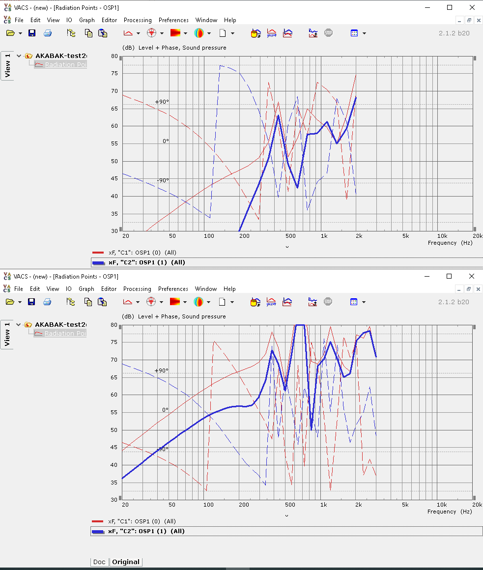

More results.
I changed mesh of diaphragms to Delaunay, get element number down from 3100 to 2000. But also very different results compared to previous image what had Bifurcation mesh. On new image lower part had rear diaphragm offset of 2 mm, all other parameters are unchanged, this cause also very different result.
