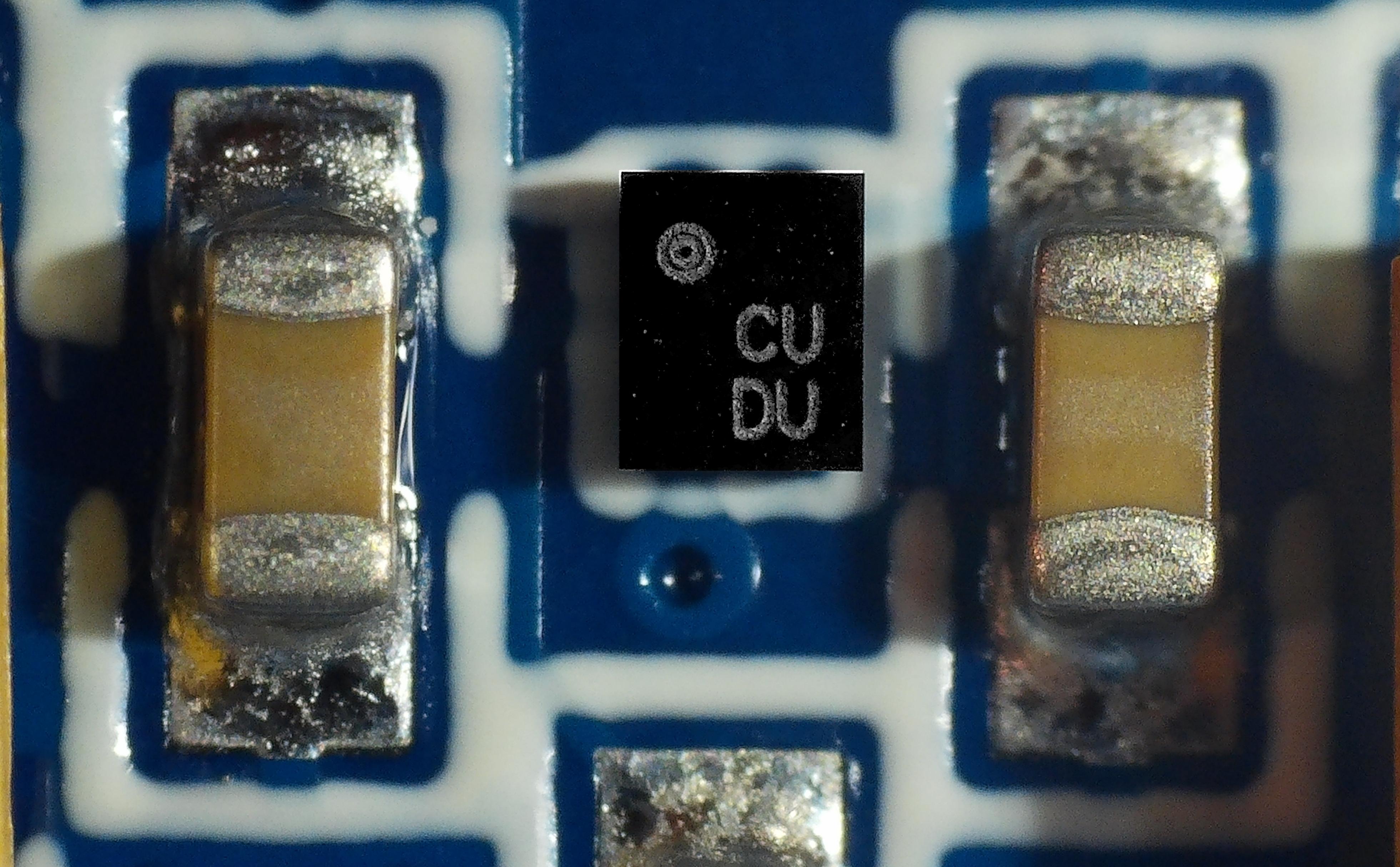

Speaking of AK4499 dac implementations, just did a bit of looking around inside of the Topping D90 case. Saw what looks to be four tiny voltage regulators, possibly as a source of 5v for Vref (one per channel). Don't recognize the chip from the marking code, but perhaps someone else around here will...

Well mark that looks like a WCSP 4 pin package to me. I suppose it could be 6 pin. The LP5907 from TI would be my first guess but this isn't available in a 5V format.
