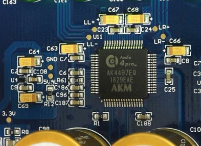

well, ADP7112ACBZ would be about 1€ in contrast to 2.7€ for LT3042, but the latest will need more parts around.
still I think that Toping is somehow recycling design fragments. for instance this is the case comparing their es9018k2m and es9028q2m dacs.
so, I would not be surprised in order to quickly release the product many things are copy-pasted. for the first time I saw this tiny reg in Dx3pro, it is also present in D70. not sure, whether it powers Vref there (U4 in the pic attached).
