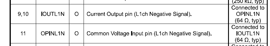

> A few points I'm struggling with - in I/V mode I don't see the advantage of the I/V stage feedback being returned to the die..
You may find this useful :
http://www.easyaudiokit.com/bekkan2019/NewDevice/NewDevice.html

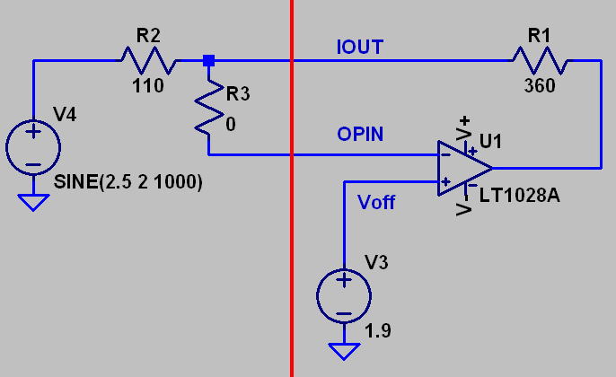

And of course R3 is not 0R, but 64R.
But not important for FET input opamps.
And most likely not important for discrete IV circuits also.
Patrick
Patrick
Patrick,
Where did you get the info that R3 is 64R? - if true I wounder why AKM would add 64R in series with the input stage of the I/V stage, this will only add noise...
Patrick,
John,
64R is the DAC OP impedance (resulting from the paralleling of whatever number of unity weighted resistors). Patrick has merely simulated it as a voltage source in series with a resistor which is the equivalent.
TCD
See attached.
There is no additional 64R external to the IC in the recommended IV schematics, as far as I can see.
R2 (Zout) is still 110R, as per datasheet.
Patrick

Just for my own interest, as a design challenge.
The IV circuit has been updated with the offset voltage and the equivalent output circuit of the 4499.
This fully demonstrates the importance of a low Zin of the IV circuit.
The complementary MOSFET input solution, with its low Zin, gives a very decent distortion spectrum.
The single ended solution, while much simpler (without the need for the complicated bias circuitry), is 5~10x higher in H2 and H3.
Other so-called discrete solution that I have seen on the net are all using discrete opamps with high Class-A output bias.
I have not found a current-conveyor-based solution as yet.
Not that they do not exist.
Patrick
