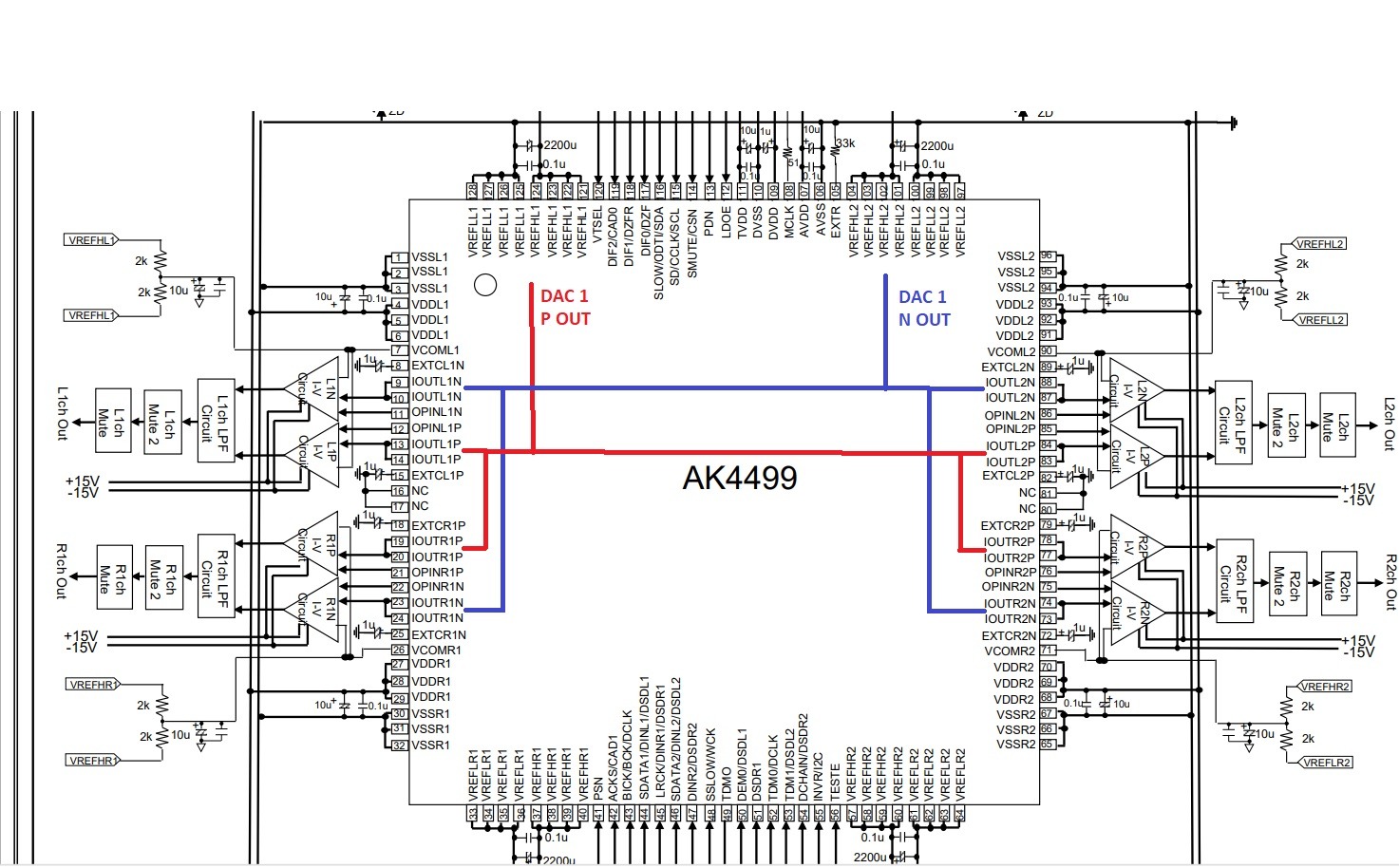

I have dac that is dual mono ak4499.
1.) can be put to voltage mode out?; because it plays ok in just followed srpp output stage.. You can swap dac boards to ak4497 and ak4490 and es9038pro and all are followed with the same output stage with firmware updates of course.
2.) can be all IOUTP and all IOUTN summed prior I/V stage... i read in datasheet that all IOUT pins should not be connected. I have problems with clipping on IOUTP of VOUTP and VOUTN outputs. or in picture below DAC P OUT and DAC N OUT. So on scope upper part of sine wave is cut at 3/4 value.
Cipping is present at 0db out but not visible at -10db.
If this is not ok, how will be best connection for dual mono out without I/V opamp stage?
Thank you.
