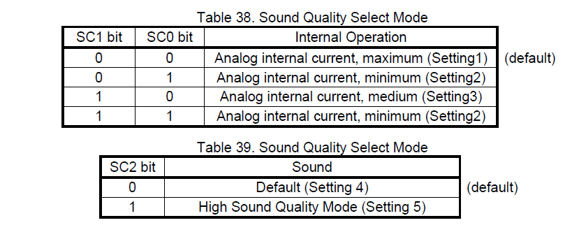

Getting closer to topic one example of this is with AK449x dacs which have a sound setting. The "high sound quality" modes actually increase distortions.

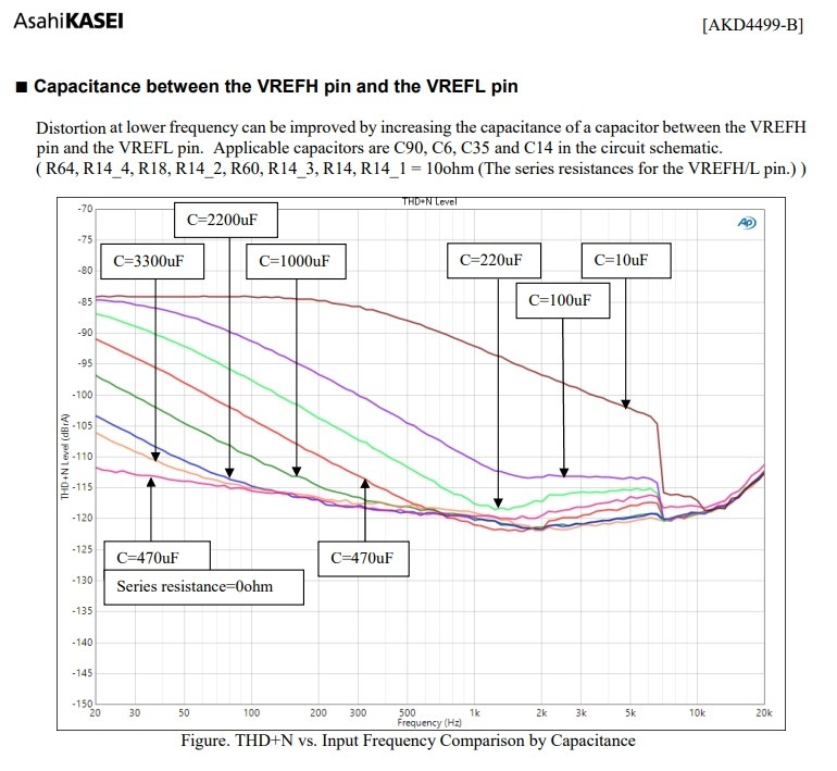

Another similar example is in AK4499EQ evaluation board where AKM added a RC filter on Vref. As can be seen from the attached graph this RC filter mainly adds lf distortion and noise. The best performance is without the RC filter (i.e. series resistance=0 ohm).

thd is better with rc see 1k to 10k...
With the filter in place, the sound of the filter caps dominates the sound (we checked). AKM chose the cap values to give the best subjective SQ. Larger value caps made the sound, perceptually speaking, more 'dull and lifeless.' IMHO the reason for the filter in the first place was because the Jung-ish regulator on the main board didn't sound very good (maybe it could be described as grainy). Also it was too far away from the dac chip for a Vref supply, IME a lower impedance connection usually tends to work better.
EDIT: looks like I was typing at the same time as another member.
