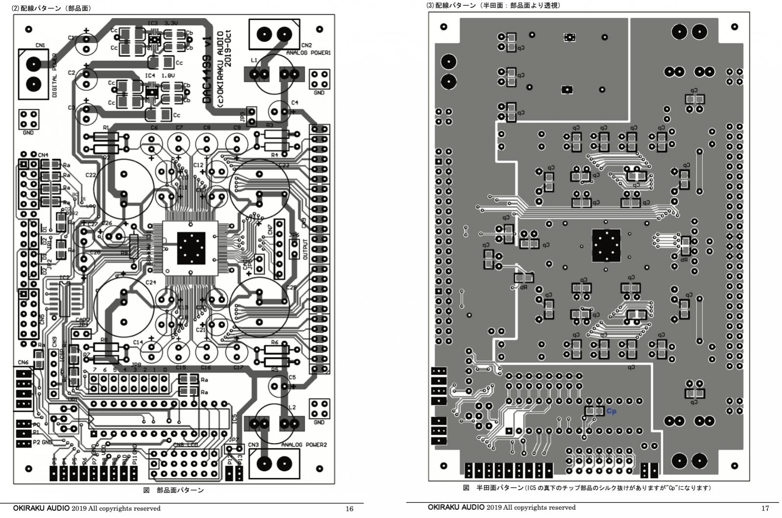

just wonder how bad is then this one?
Pretty bad at first sight: the ground plane is interrupted by long horizontal traces and there are no vias above and below those traces to short the gap via top level ground fill. In fact there is no top level ground fill anyway above a large part of those traces, because the top layer is crowded with vertical lines. Whether any of this actually matters depends on what signals those traces are for; if both the horizontal and the vertical lines are digital GPIO lines that only switch once per hour, it may not matter at all.

Sure but most audio isn't that complicated and you can use zero ohm links to jump topside traces over one another.
It's worth pointing out that the ak4499 eval might used a 4 layer board but they do not use an uninterrupted ground plane on any of their layers chopping the copper up on purpose in an attempt to control ground currents. Mostly I would expect this to be unnecessary but they do it anyway.
Sure there are parts that necessitate a 4 layer board, or more, and when using them you obviously go that route.
to me it looks like inner planes reflect their data sheet recommendations:

Yes but still, they've chosen to split up the ground planes rather than use one layer as a solid plane. They could quite easily attach the return path for the vref supplies to the solid plane at an advantageous point, rather than slicing it up and providing the return beneath the vref power traces. These are inherently low bandwidth, what with the 10R in series with the main vref caps, they don't need a plane directly beneath them to return to. One wonders if they've tried the alternative or not. Either way it works and I guess that's the important thing.
Of course it's not optimal as it causes an increase in low frequency distortion, but with a large vref cap the increase is pretty insignificant. You can offset the reduction in absolute output by increasing the vref voltage too if necessary.
