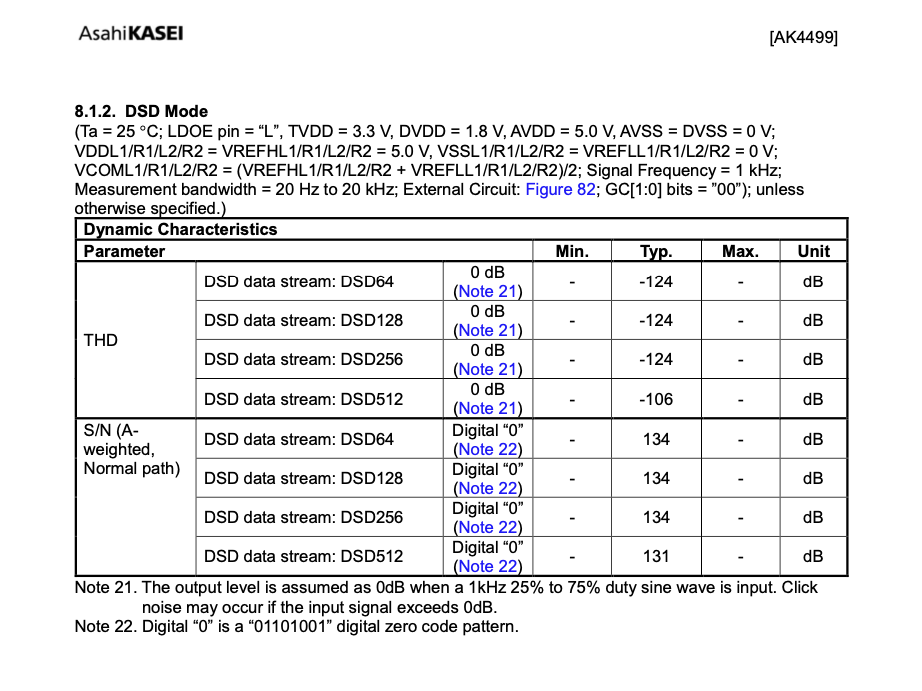

For the AKM 4499, one can see right in the data sheet that the specified performance of the chip is worse with DSD 512 vs. DSD 256.

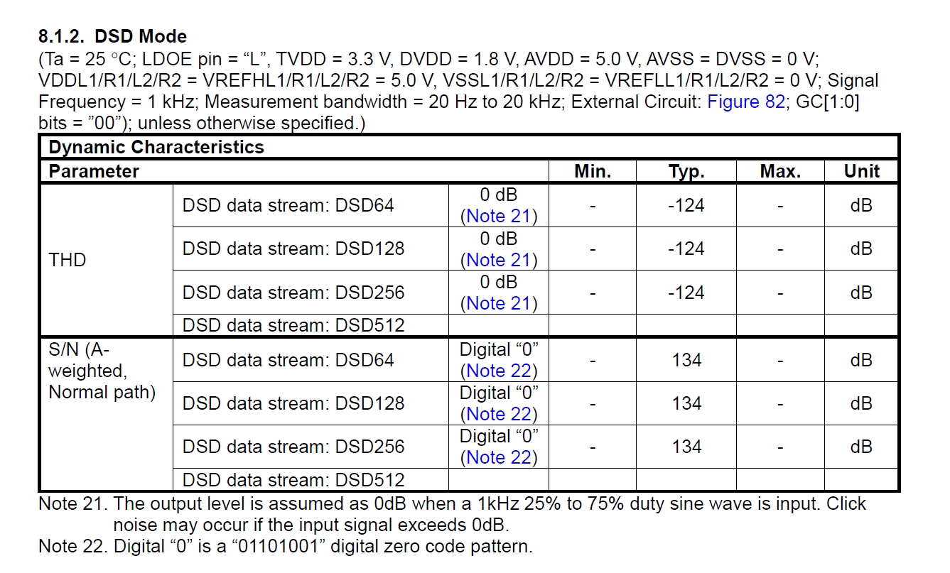

Looking in the data AK4499 data sheet and search for the term 'THD', I find the table attached below. There is no specified minimum THD, there is description of how THD was determined, and just a blank for DSD512.
There are some graphs for PCM modes in the eval board manual, but didn't see any for DSD.

Looks like...
You might have a different data sheet than mine?
