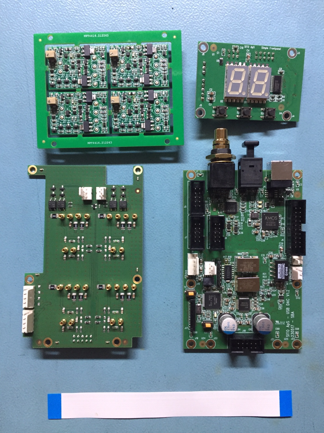

And by the way we are going to make an output shield with 2 x60watt into 4 ohms load when running at 24vdc. It is based on tpa3244
Together with the dac it is possible to make a compact digital only integrated amplifier for 528€ excluding chassis and power supply.
With powersupply and chassis it will be possible to make a amplifier for less 800€ which will real high end sound.

It is very simple.
The output boards are all made and tested.
The DAC boards are made but they are a little complex, and our assembly has been a little careless with the solderpaste, so we have shorts on some of the finepitch pins on the DAC boards. 🙁😡🙁
So we are removing those solderballs and testing them afterwards. At present time i am working on 3 boards from the first batch that has this problem.

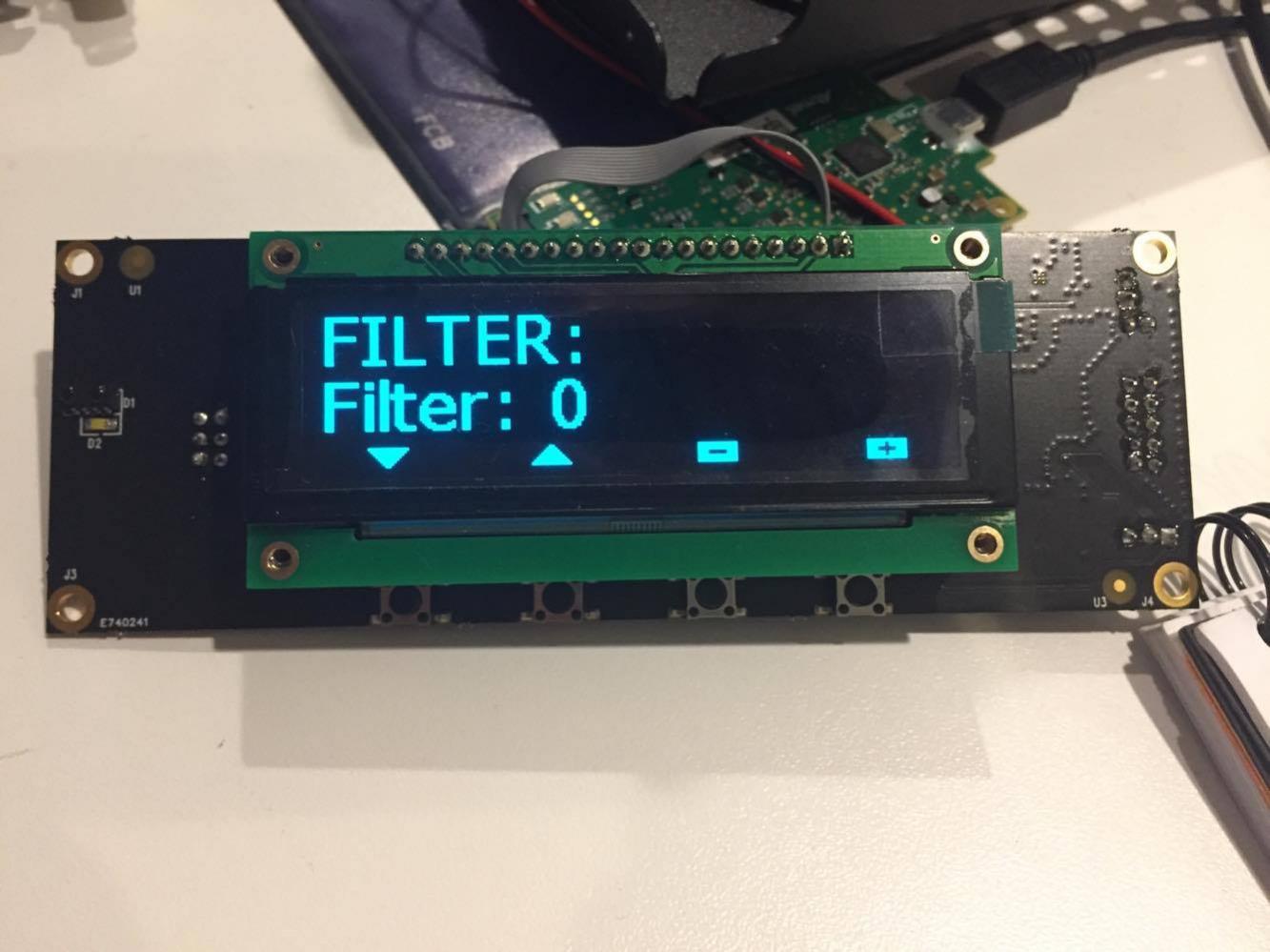

secondly we have updated the firmware but as with the frontpanel you can do a firmware upgrade using a Seriel port (USB to RS232).
I have a new firmware for the OLED display as well. Birk got some updates yesterday for controlling the new DAC with that as well.

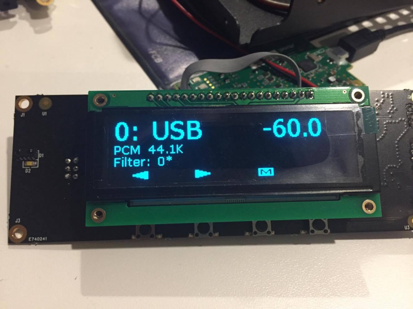

Aboe was right, the sound of this new DAC is extraordinary, thank you, Sonny !!

I am going to send A package. WithNew firmware package for the ones used with the Oled display.
I am also going to upload Documentation on How to program new firmware to the dac and display

What is the OLED part number, looks so good I need one 😉
It is a 256x64 pixel display. I will find the digikey number
