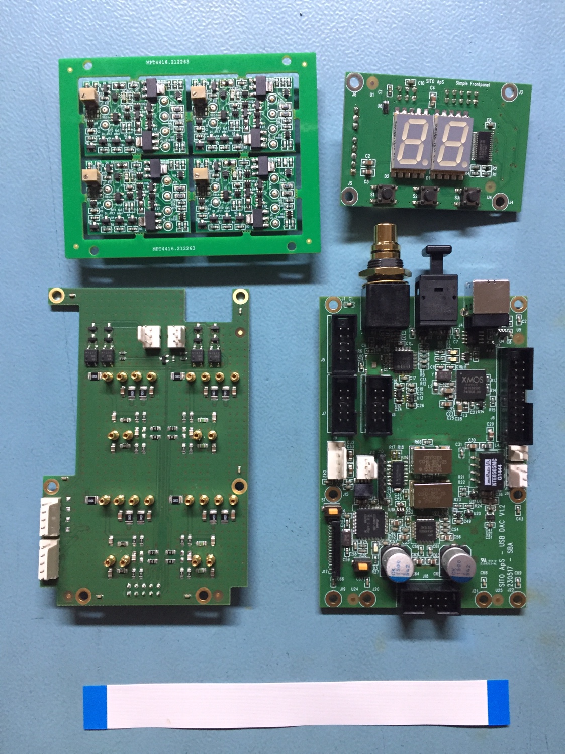

Hi guys.
Right now we have a list of features.
We have 1 week rest now because of holidays but we are really close. We need to test the channel switching. that's all.
I have attached drafts for the userguide
The motor driver is a sparkfun serial motor driver for controlling a ALPS potmeter with motor.
MCP23009 is an I2C bus expander that giver you volume control from 57 to 255 on a 8 bit bus. => 0 - 99 on the display.
In the AK4490 it is equal to 1dB step from 0 to -99dB
Remote pairing is in place.
Display is showing volume when using encoder or remote for 15 seconds after release going back to Channel display. Which again dims to low level after 15 seconds. The PCA9955B is really good at controlling the LED's in the 7 segment displays.
1 dot is lighting up when remote is used.

Simple Frontpanel
Hi
I hvad tested the simple front panel and Sonny have added some ekstra functions.
Switching between the different i2s codecs.
We can also adjust the speed for a alps motorpot.
It alls works through the apple remote, and it's really well done.
So thanks for your works so far :)
Hopefully All you that have ordered the new Dac well be as pleased as I am. Looking forward to hear your comments when you receive and get the possibility to try it.
Cheers
Aboe

They are ready to ship out:
And by the way we are going to make an output shield with 2 x60watt into 4 ohms load when running at 24vdc. It is based on tpa3244
Together with the dac it is possible to make a compact digital only integrated amplifier for 528€ excluding chassis and power supply.
With powersupply and chassis it will be possible to make a amplifier for less 800€ which will real high end sound.
