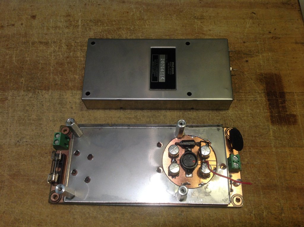

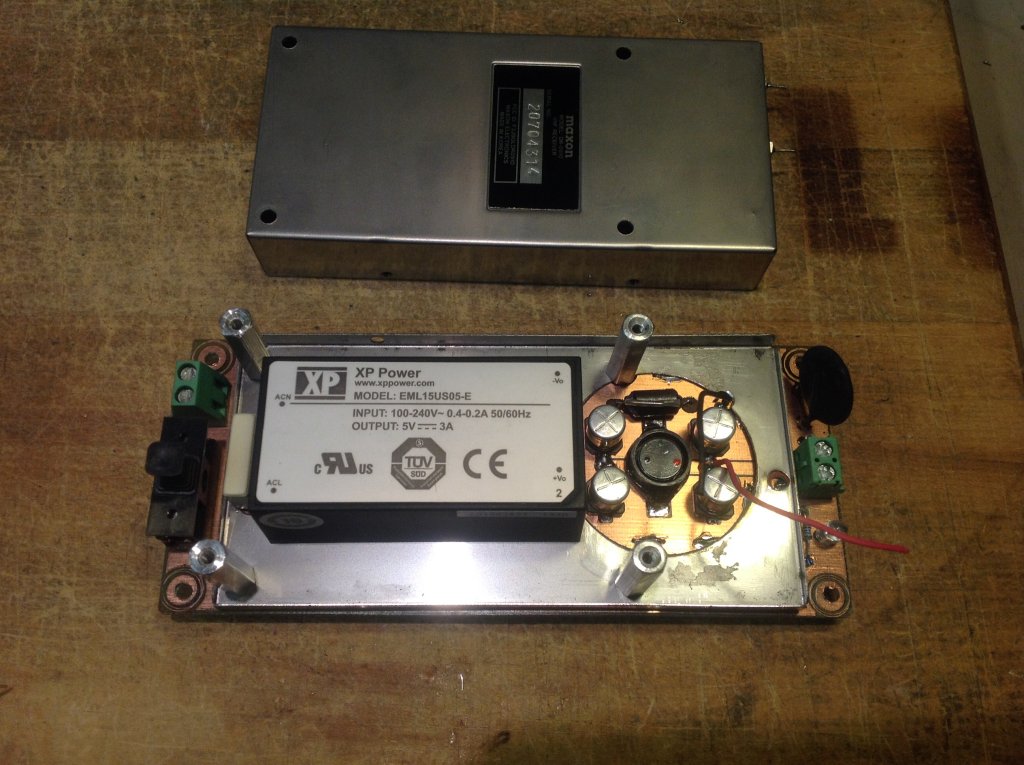

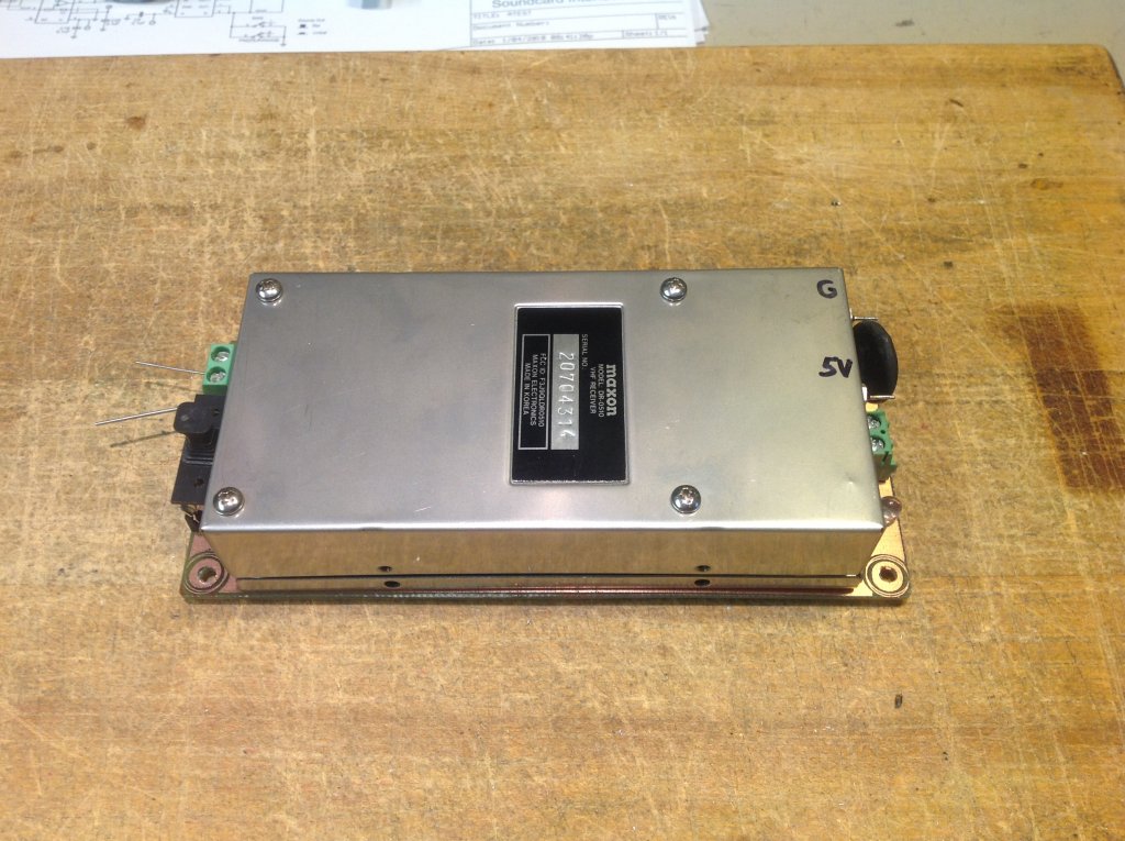

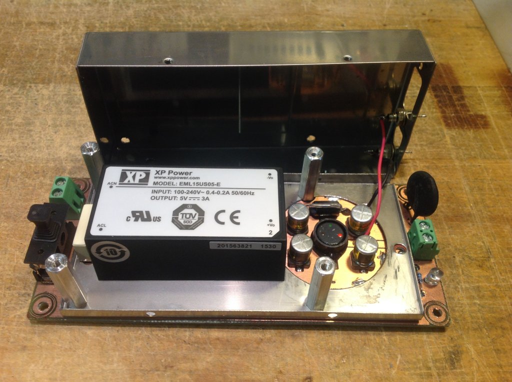

Here how I'll supply the DAC. For the analog +-15V section I'll use the excellent Twisted Pear dual Shunt regulator Placid HD-BP, with toroidal power transformer. I had them in stock so...
For the digital 5V I used Sonnya recommended switching power supply module, with a twist. I made a custom pcb, with ground shield, output CLC filter, shielded mu-metal enclosure, and output using feedthrought filters. Here a few pictures...

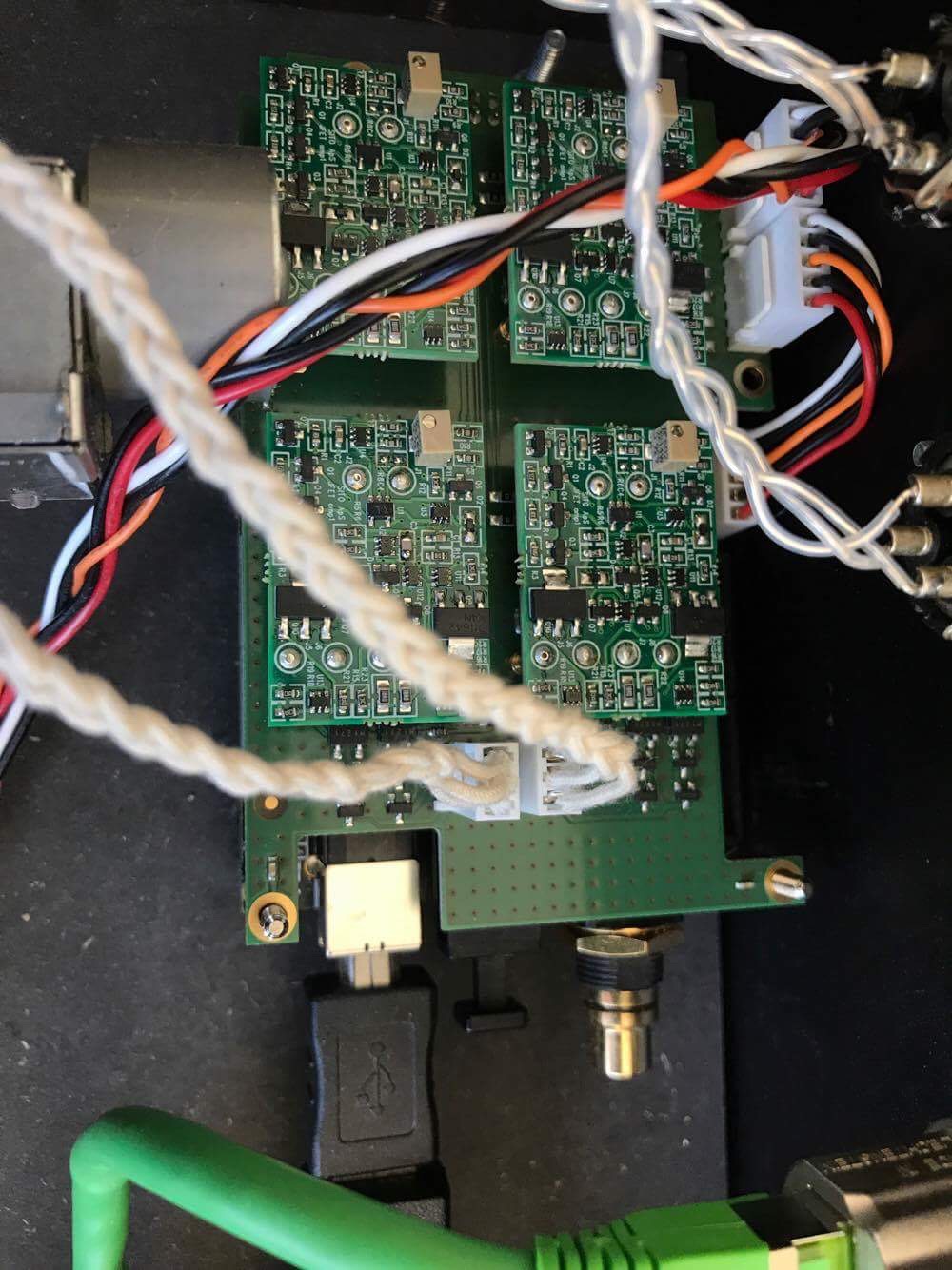

Just How it is assembled.
Now Birk who has started at my company last week (programmer) was sick today.
It was planned that we should show the menus tomorrow but we will work as fast as possible to get it ready.
So right now we have the output stage ready (10 is assembled right now)
And the front panel (first one hand soldered by me. That's the reason for the ugly solder points).
Margit is ready with the other order that we have in house tomorrow, so she will start assemble the front panels and the new dac boards with errors removed.
Sent from my iPhone using Tapatalk

If sound quality is proportional with beautiful assembly and design - then I understand Aaboes comment These 4 gain modules on the motherboard look as a piece of art --- Impressive...Hi
