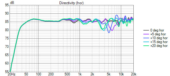

I lowered off-axis cancellation between 1 and 2 kHz in my crossover with addition of simple RC leg (12 ohm + 3.3 uF) parallel to woofer inductor:

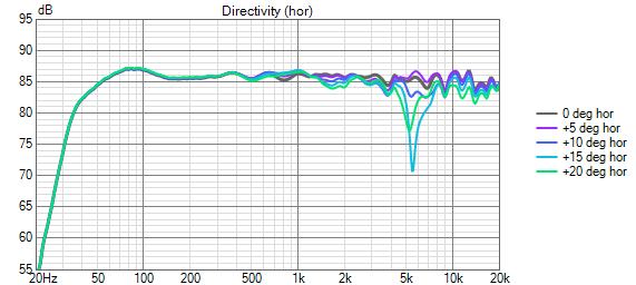

To compare the horizontal off-axis cancelation - below is your fourth-order crossover:

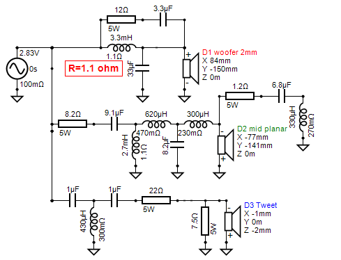

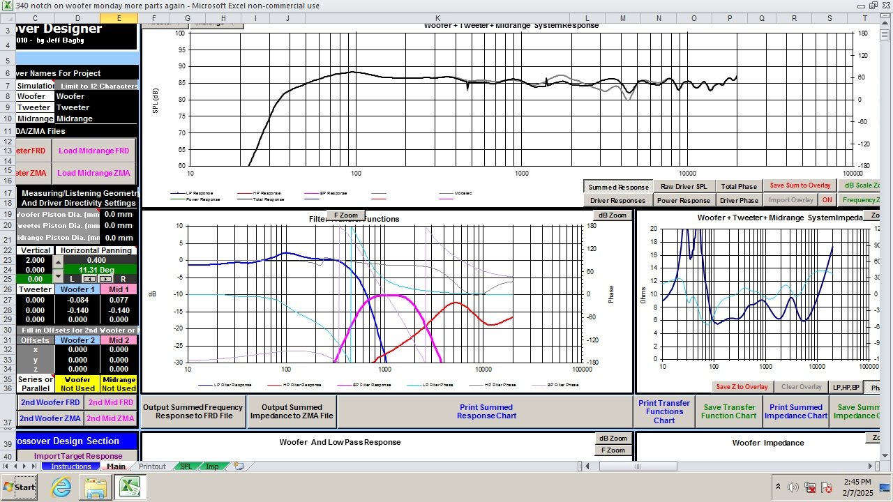

Inserted. What am I missing here? This seems far off.
My camera resolution, and hand writing lead you astray. That should be a .5mH coil on the mid, not a 5mH. The dot blended into the tail of the number 5. I didn't notice it looked that way initially. I later saw it, but figured you would catch it.
Start with about 20 degrees off axis, and then go about ten degrees each way, The variation is not bad, using the 7 degree frd files. So 7 degrees to about 30 degrees is a listening window. .The direction probably matters a lot, but I couldn't tell which way my software was indicating.

Here's eleven to thirty three degrees. Note that I don't show coil dcr, but typical values were included ranging mostly between .3 ohms, and .5 ohms. I changed the tweeter slightly. The 7 degree frd showed the top end a little hotter than the on axis. Anyway, the main reason this might work, is the lower tweeter x-over point. I tried to make this work at very high frequencies, but the range around 10k was not cooperative.
Just noticed. The 10uf cap in the mid filter should be 18uf.
My thinking is that as you move around at your desk, you may go from 20 degrees to 10 degrees on one speaker, and from 20 degrees to 30 degrees on the other. These were using the 7 degree frd files. I didn't have the others to try.

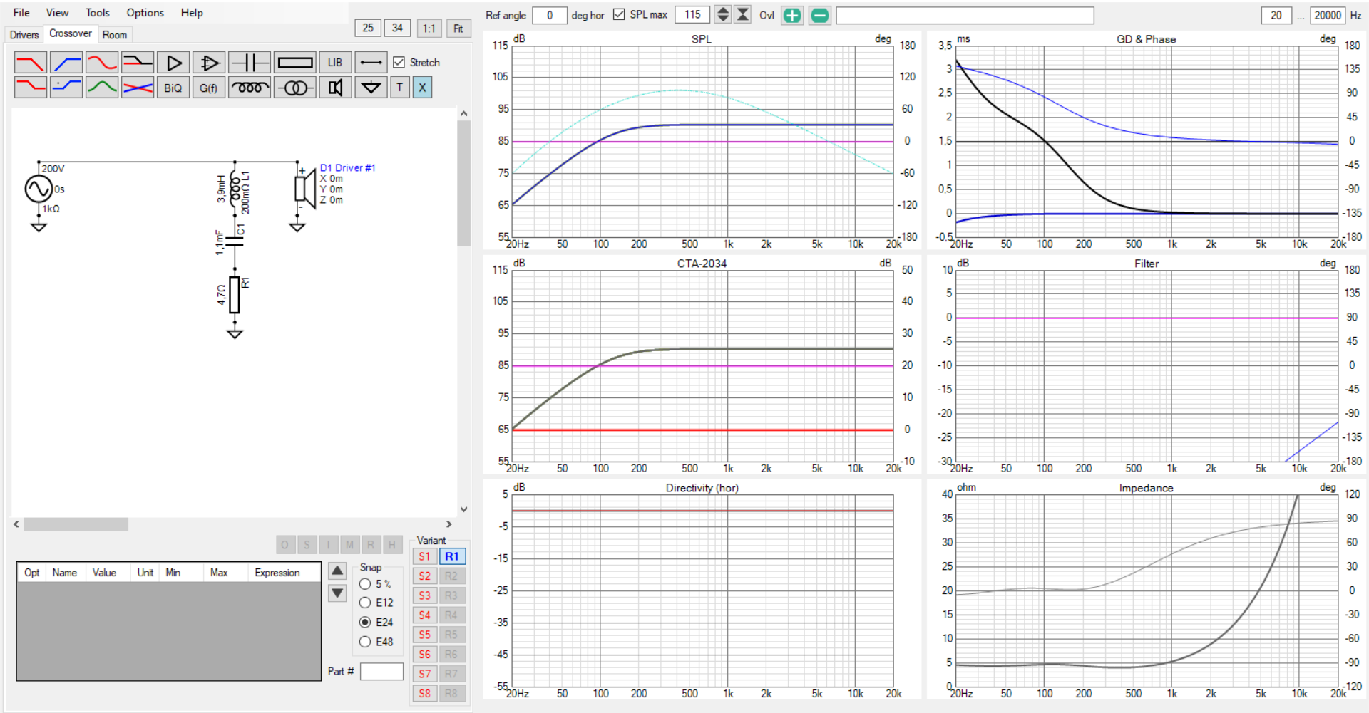

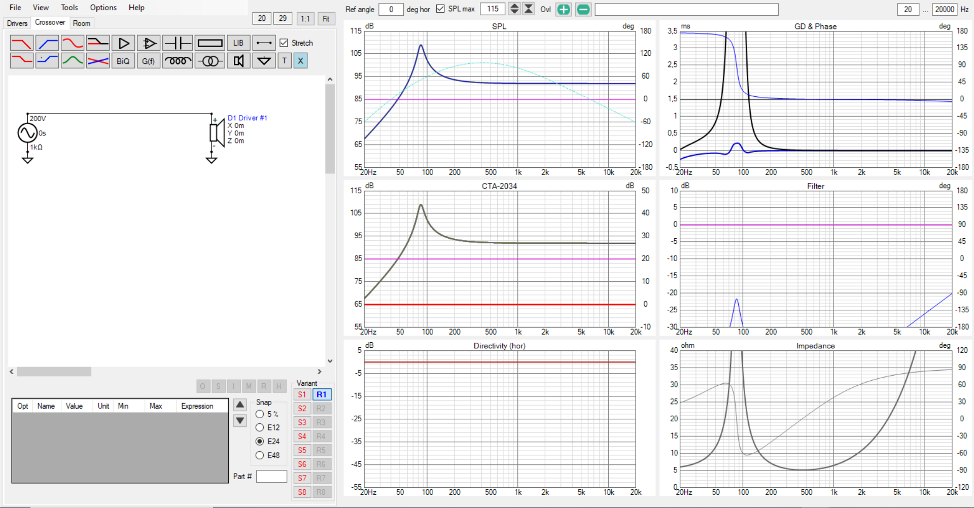

Here is a driver in a simulated box, low output impedance in the generator as it would be with our high damping factor amplifiers, so the response is familiar to all, right.
Here is output impedance of the source jacked up greatly, and the response changes.

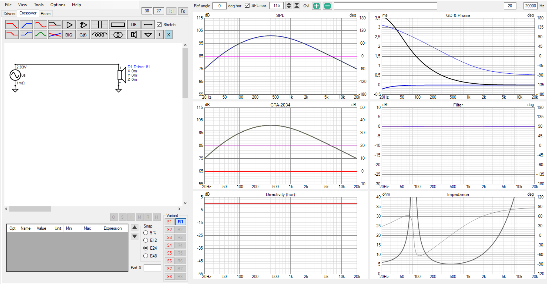

Here is the magic crossover, it makes low impedance path between driver terminals enabling some electrical feedback.
