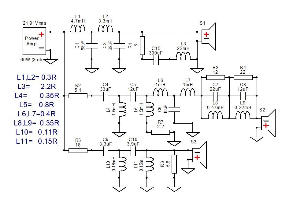

My camera resolution, and hand writing lead you astray. That should be a .5mH coil on the mid, not a 5mH. The dot blended into the tail of the number 5. I didn't notice it looked that way initially. I later saw it, but figured you would catch it.

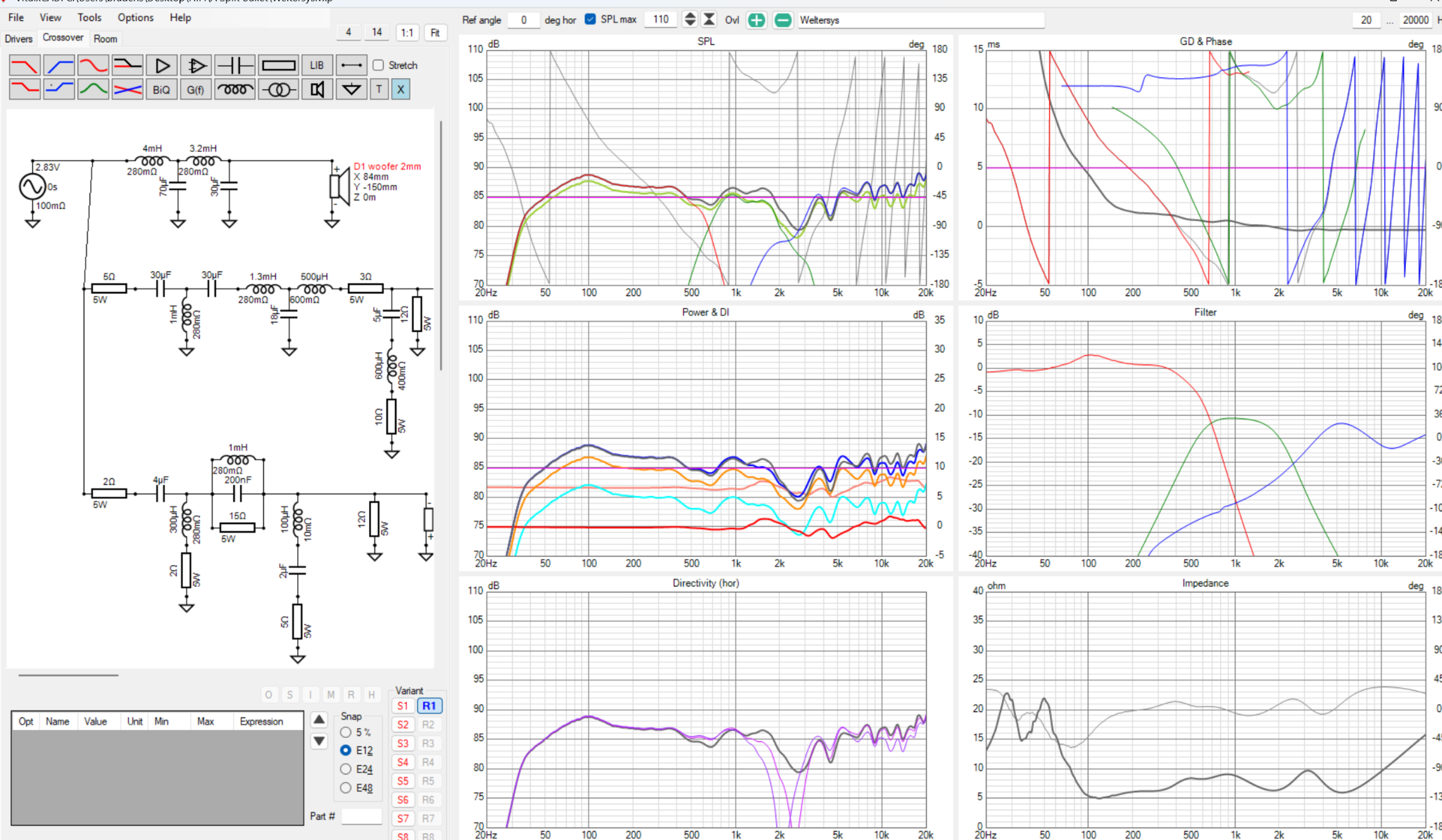

Start with about 20 degrees off axis, and then go about ten degrees each way, The variation is not bad, using the 7 degree frd files. So 7 degrees to about 30 degrees is a listening window. .The direction probably matters a lot, but I couldn't tell which way my software was indicating.
This is to 20 degrees off axis. Black line is on axis. I entered in approxamations for the inductor DCRs and this includes the driver offsets.

Here is the magic crossover, it makes low impedance path between driver terminals enabling some electrical feedback.
Well, that is not the magical crossover, but only additional LCR series circuit to compensate the woofer impedance rise at the resonant frequency ("conjugate loading" by KEF, many years ago).
Sorry, but 1.1 mF (!!!) condenser, 3.9 mH inductor and 50W resistor are very expensive addition to the crossover, only to make current drive usable! Besides, you didn't post the crossover schematic (as asked!), because current drive will mess up the frequency response of crossovers posted here before.

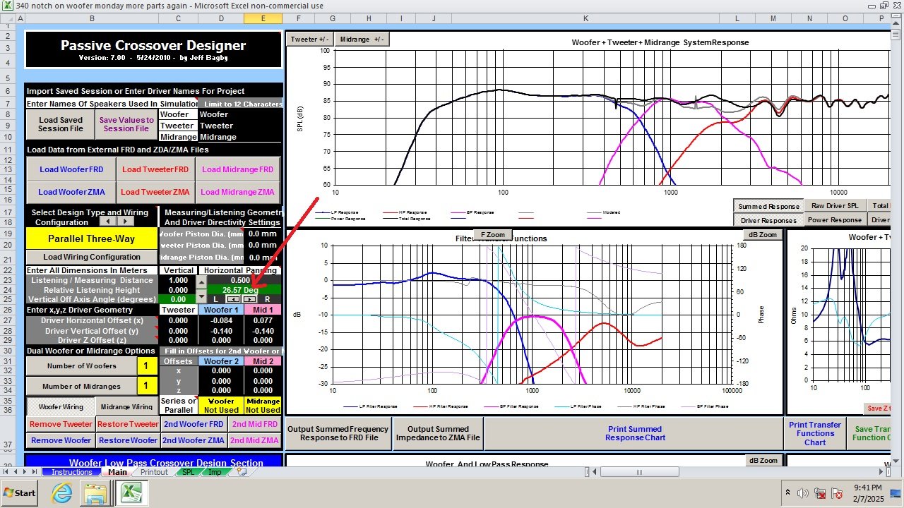

I don't know for sure why there is a difference. Here's from minus 3 degrees to plus 25 degrees. If anything, I would suspect that the mid drops a dB or two at 2k, and twenty five degrees. The flattest response was around 14 degrees, I think. I've also made minor changes, but they are insignificant to the results you showed. Black line is 26 degrees, and the gray line is minus 3 degrees.
My Z offsets are set to zero. Are yours?

The bad part of unknown measurement type is that here we cannot see the whole picture. That red line on directivity graph should show meaningful and important data, but it does not. I can guess, that at the crossover point of tweeter here we can see some problem, but from 40 degrees of data it is hard to tell.
What is the red line supposed to show? What data needs to be input for that? All the speaker angles?
