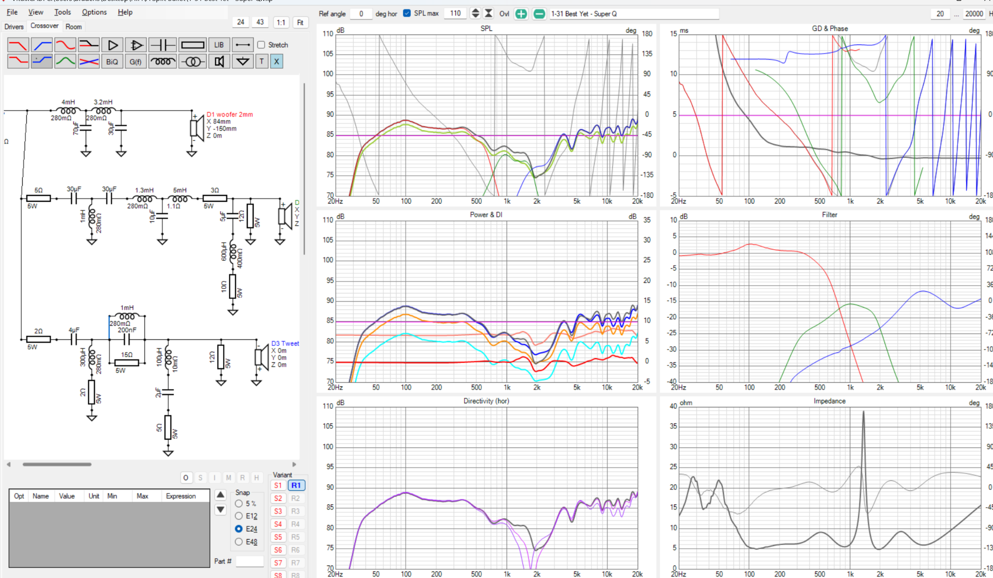

Here ya go. You really must model at least to 7 degrees on this one because otherwise there WILL be horrendous cancelations.I have a filter or two worked up using the original woofer frd. I would like to see the results with the revised one.

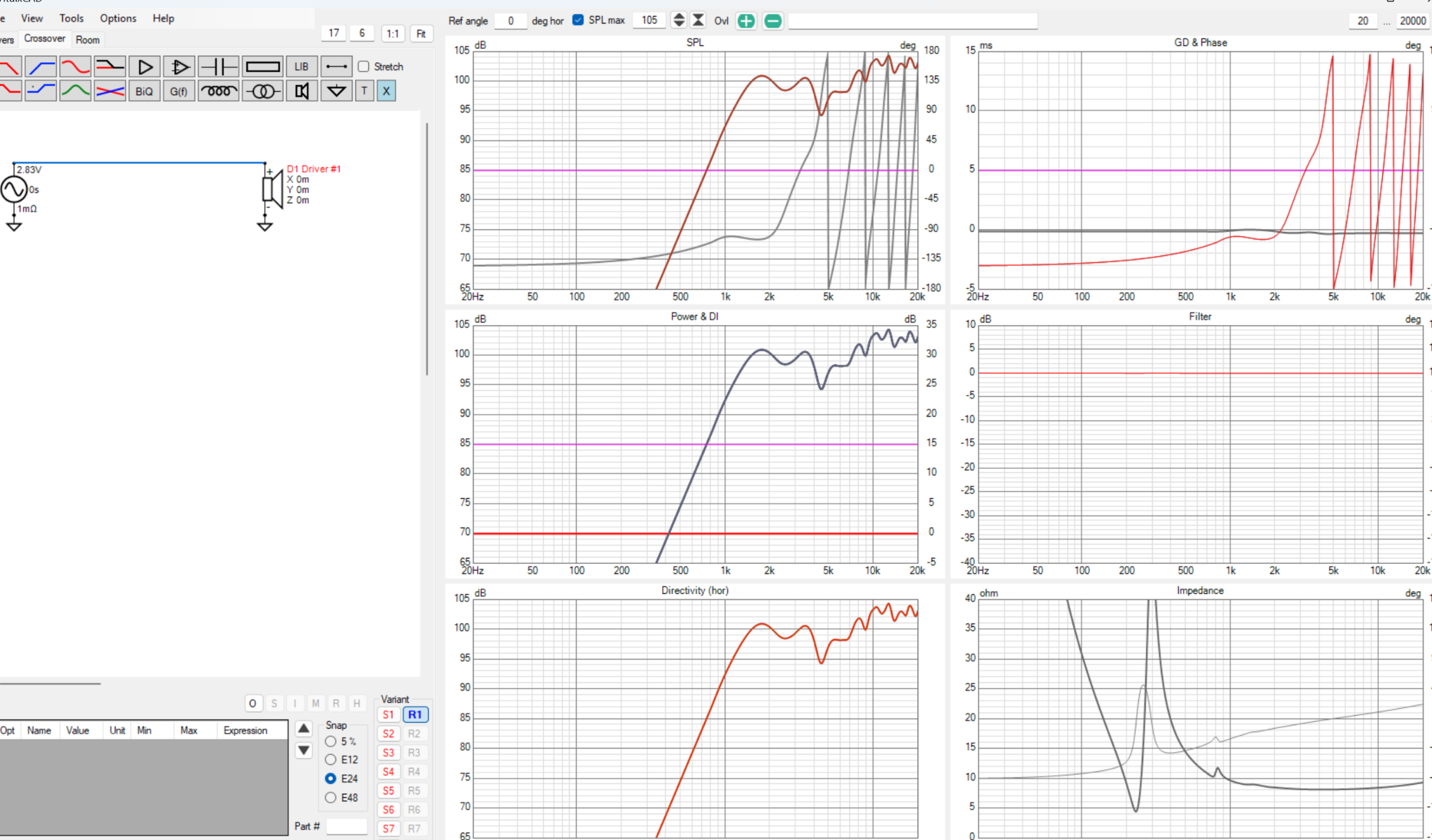

Something isn't right then. I just checked the tweeter files and the ones in the google drive are correct. Did you mix up the impedence data possibly?it is in the data that you gave me. This is the tweeter with no parts active, so open to the amp:
They have resistors. I've done this on a few other builds and the amplifiers are fine. One system I did similar to I listen to for around 4 hours a day. Its been like that for 3 months. Still alive.what you did with your lrc filters parallel was creating shorts on certain frequencies that would kill most amplifiers. If you want to filter that passive you need a series lrc filter, that will have other negative effects. And as most don't hear that high anyway, it does not matter much. That kind of correction is typically done active (be it analog or dsp), not in a passive crossover.

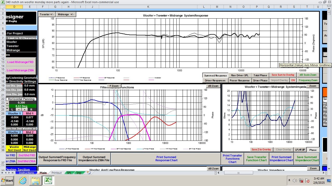

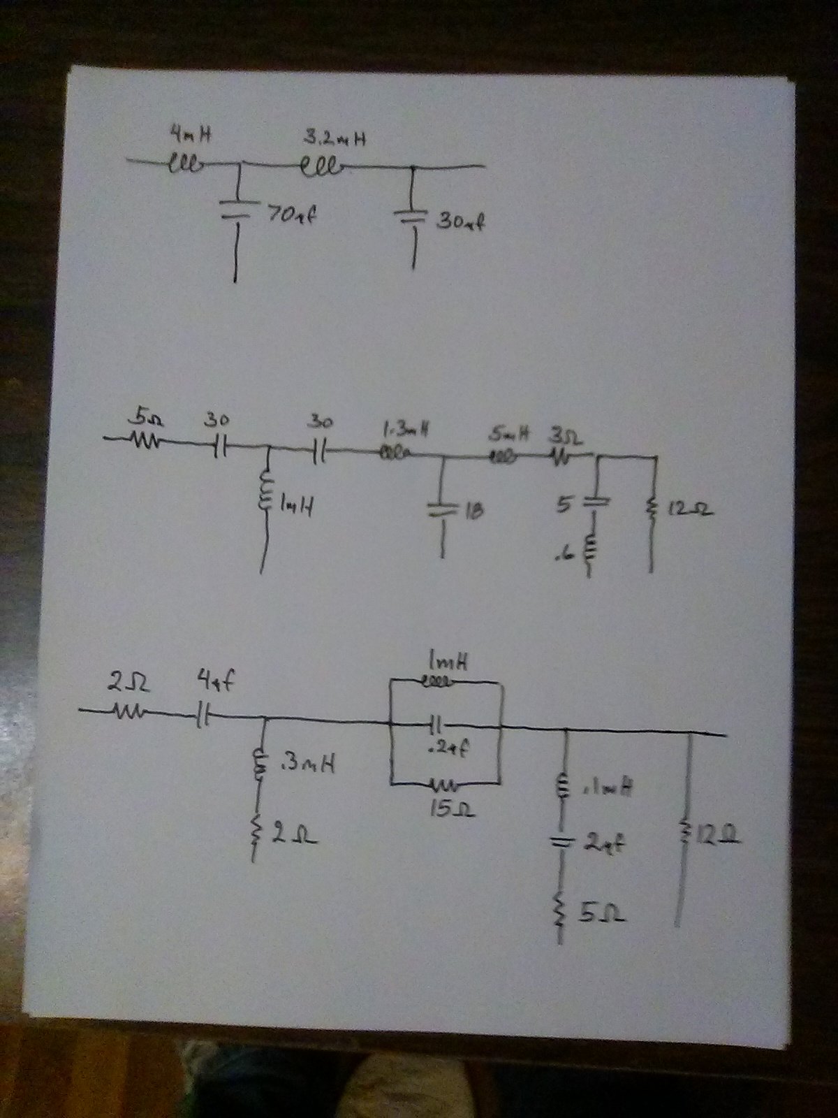

Go check my original XO. It does have the issue but up until around 15 degrees you get no dip. I was able to achieve this. You said you could with less components, and yet, you did not.The midband dip is due to the aliggnment, that is almost impossible to get in phase over a wide frequencyband enough to avoid that. It's something you can try to eq out, but it will sound worse then when you don't because of phase issues you create. And the dip is small enough to not be hearable. But with the drivers and the alignment you use it's very hard to get a full neutral even dispertion sound, therefor the layout is not right. I told you that before in another tread about this speaker months ago.
That dip is definitely hearable. Thats a full 6 decibel dip over nearly 3,000 hz of range.
Yes, you did say the alignment was right. You suggested vertical alignment which would have had worse cancelations in the vertical range. This gives me cancelations in both the horizontal and vertical but to a far lesser degree. I don't sit in the same spot in my office chair. Sometimes I sit upright, sometimes I slouch, sometimes I lean back and listen. So your vertical alignment would have had horrendous cancelations if I did anything but sit start upright in my chair. I think we can all admit we don't sit stark upright in front of our computer at all times.
Thank you for this. Now I fully understand how to calculate DF. I may be able to tweak the system to use slightly smaller inductors. Without the 4th order there I will get a massive horizontal and vertical phase cancelation at the XO point within my listening window.n amp with 1000DF at 4 ohms would have an internal output impedance of .004 ohms.

This build, like any other, is a series of trade offs. If I want them to fit underneath my monitors then this is the size they must be and to fit in that space they must be in this alignment. Its a tradeoff I am willing to make.
This is why I used a cheaper AB amplifier for the last two rounds of data collection. I didn't want the cap in because I wanted proper phase alignment. I was willing to kill this amplifier to get this proper data. Luckily, it did survive. Running it active for an amount of time I believe would kill it. For 10 sweeps I think just about any amplifier will survive.The ribbon transformer presenting near a dead short at DC may be a problem for many amps, and the use of a capacitor while testing changes the phase response
I used just the on axis measurements....But I designed with toe in. These results show from 9 degrees to 30 degrees. I figure that's a reasonable range. Everything in between, is in between these two lines, and it transitions smoothly. The tweeter, and mid will change slightly at these angles, but I think with some tweaking, a suitable compromise can be had.
That looks really good. What are the component values and schematic? Also, what program is this you are using? I've seen it in some how to videos but I've never figured out what it is.I used just the on axis measurements....But I designed with toe in. These results show from 9 degrees to 30 degrees. I figure that's a reasonable range. Everything in between, is in between these two lines, and it transitions smoothly.

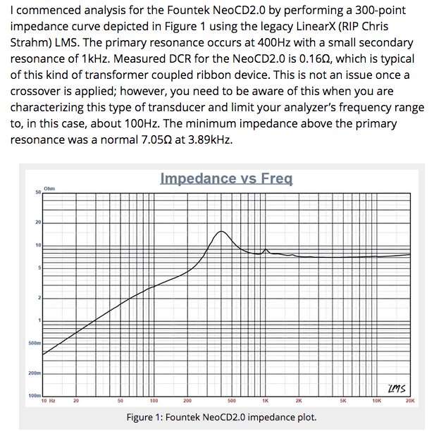

The ribbon transformer presenting near a dead short at DC may be a problem for many amps, and the use of a capacitor while testing changes the phase response.
Best of luck getting to the cause of your ribbon tweeter measurements exhibiting far too many 360 degree phase rotations within it's pass band.

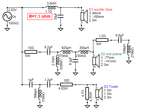

If you have the schematic, can you insert the off axis measurements automatically? This would probably need to use the 15 degree measurements rather than the on axis, but with these drivers, I don't think it will change drastically. The top end may droop, but as you can see in the transfer functions, it should be easy to bring it back up with a resistor change..

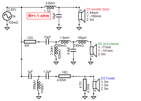

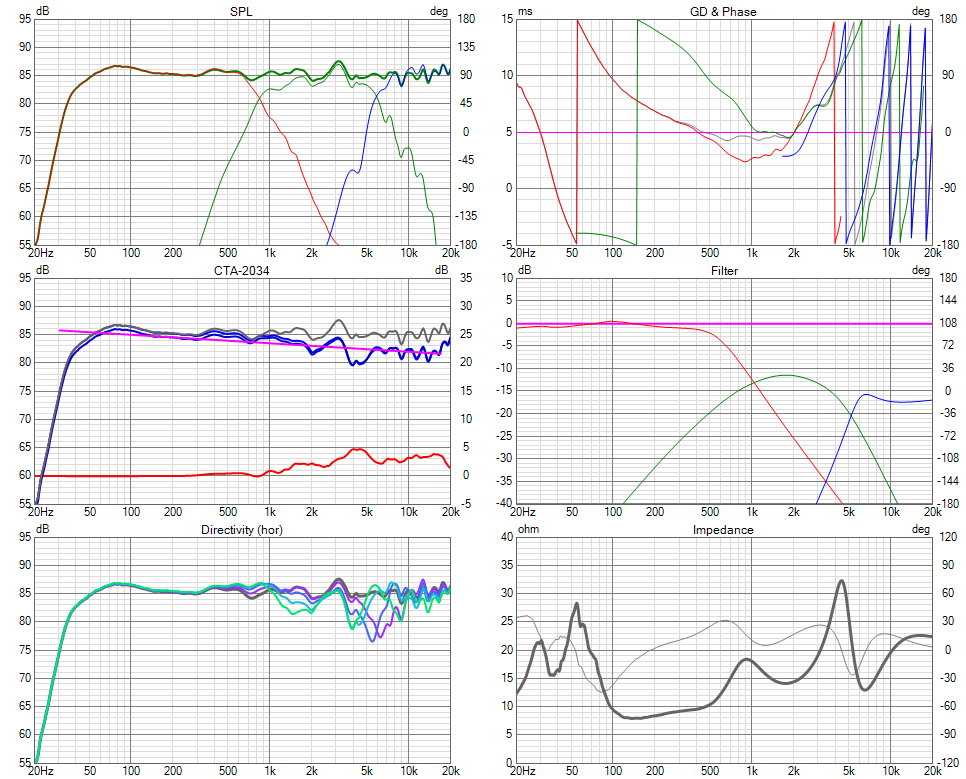

Simple crossover:
Impedance is usefully high.

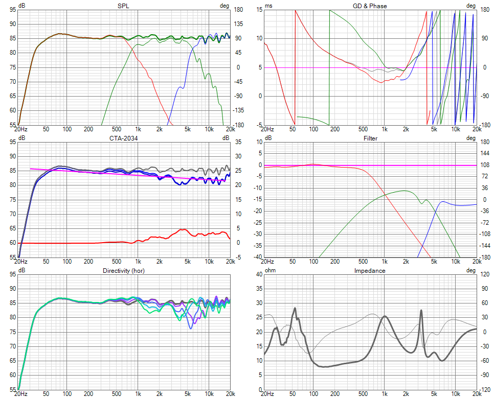

With one additional RLC notch filter at 3 kHz:
Off axis frequency response is slightly worse than 4th order crossover (post #1), but the crossover cost is significantly lower.
Much better is the free solution: put tweeter and mid planar drivers in the same vertical line, one above other - no need for 4th order crossover!

Inserted. What am I missing here? This seems far off.If you have the schematic, can you insert the off axis measurements automatically? This would probably need to use the 15 degree measurements rather than the on axis, but with these drivers, I don't think it will change drastically. The top end may droop, but as you can see in the transfer functions, it should be easy to bring it back up with a resistor change..

Your impedence is much better than mine. I'll have 3 hours on a plane tomorrow to take a look at what you did differently with your values to get your impedence up so much higher than mine.Off axis frequency response is slightly worse than 4th order crossover (post #1), but the crossover cost is significantly lower.
Yes, your off axis is much worse. I am going to notice that even just sitting in my chair. You very much did achieve similar on axis with far less components.
I'm going to try and fiddle with the values on mine. Try and incorporate some of the work you have on yours. Maybe I can get my impedence up a bit. I use relatively cheap amplifiers so I am not so concerned with frying one. It only dips to 1.8 ohm at its lowest so I'm not too worried about killing one. That said, I have a bad habit of getting low impedence ranges near my crossover points and need to rectify that.
