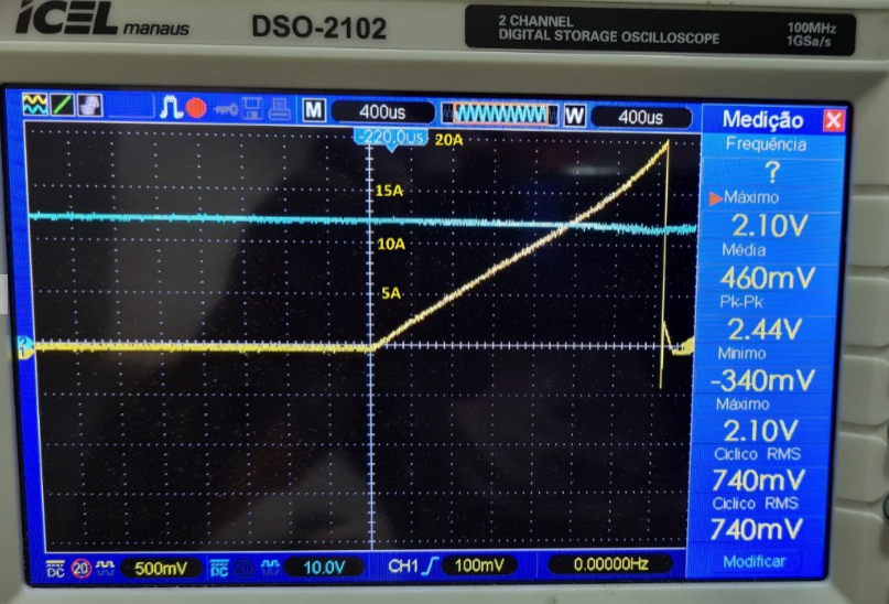

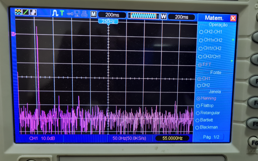

I use iron core, manually made of E + I core with an air gap (ur/u0 around 10 to 15), for the woofer when I need something around 2mH to 4mH.
Harmonics are below 48dB, which is the limit of my 8-bit scope and is good enough for me.
I also check the current limit observing the current as a function of time when applying a step voltage.
This was for a 200W system power @4ohms, so maximum peak current is 10A.
Saturation starts above 15A as shown below.

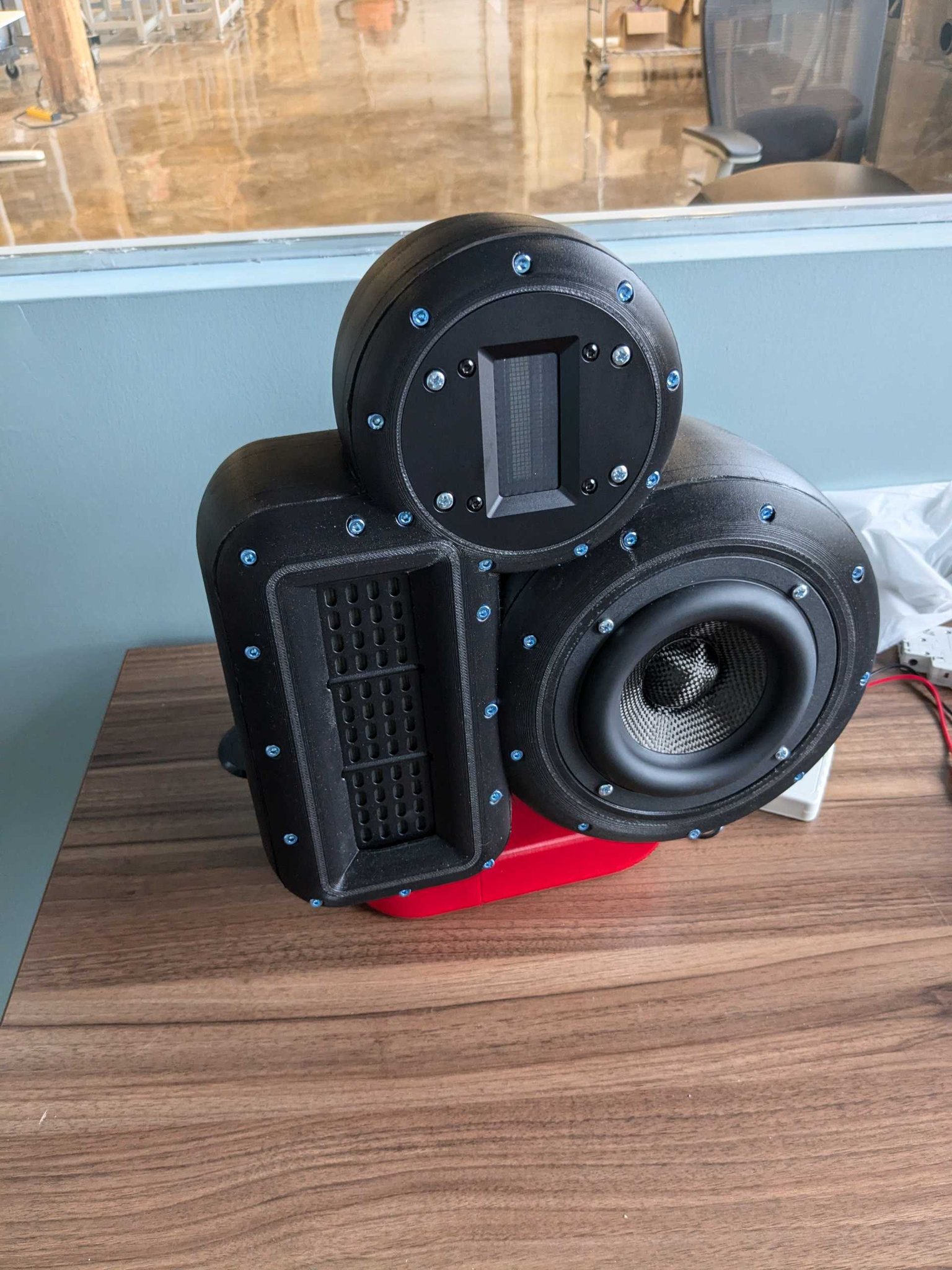

This speaker is for nearfield use only. It also uses an unconventional driver arrangement, which complicates things.

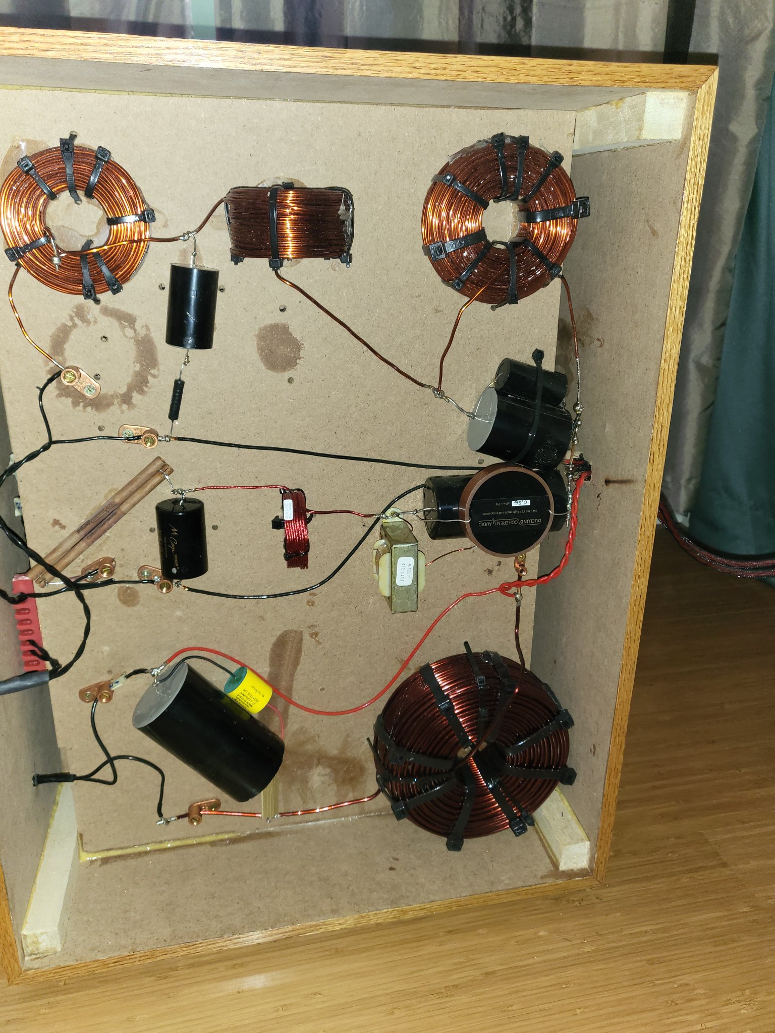

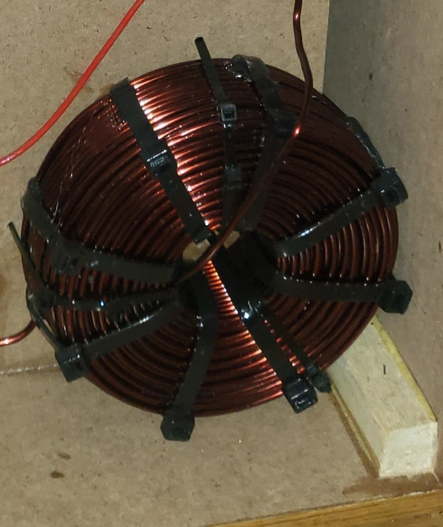

Back when North Creek Audio was still in business, I had them wind a pair of 8 gauge copper, 4.3mH air core inductors to replace the iron core for my Infinity RSIIb outboard crossovers. Large and very heavy, but they do sound good!

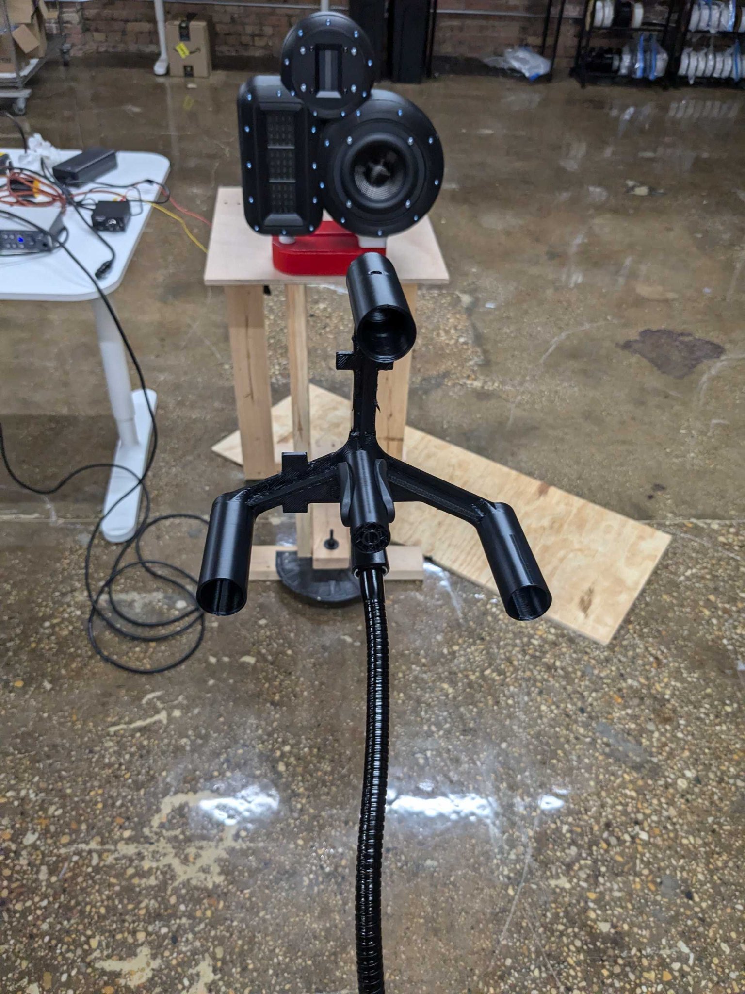

Can I ask some questions without making you mad? What are you currently using for an frd? Is it a gated measurement with a tail added, or something else? Did you measure the zma, or use factory data?
My experience with Sims is that on my speakers, they are never accurate. There's several reasons though, and not necessarily the fault of the software. ( I cut corners.)
Gated measurements with a a calibrated mic and loopback reference. I took my own impedence data with the drivers in the enclosure.
My builds have come out to within 3 db of my simulations except for the low end which is almost impossible to simulate because of room gain and such. Most of the variation can be chocked up to room reflections and I cannot take a full range measurement without reflections.

If you want, I can send you all the measurements and you can take a whack at it. Maybe you can figure out a more simple crossover. I have all the measurements from 0-75 degrees. I didn't go all the way because it doesn't really matter when I sit within 30 degrees. The last measurements I took I only took to 60 degrees. The last 3 sets align almost perfectly so I know they are accurate. Measuring this unit was its own difficulty.
These pictures were taken before I changed the port design. The stand is also the port. All the interior volume is for the woofer. The tweeter has a protection back cup built in. The planar mid has a its own, quite large, back cup which is filled with damping material and a 3d printed diffuser. I tried 6 diffusers, this one works best.
This is good data to have. 48 db down seems like low enough it won't matter. This system will never see that kind of wattage so I think I'm good on the saturation
