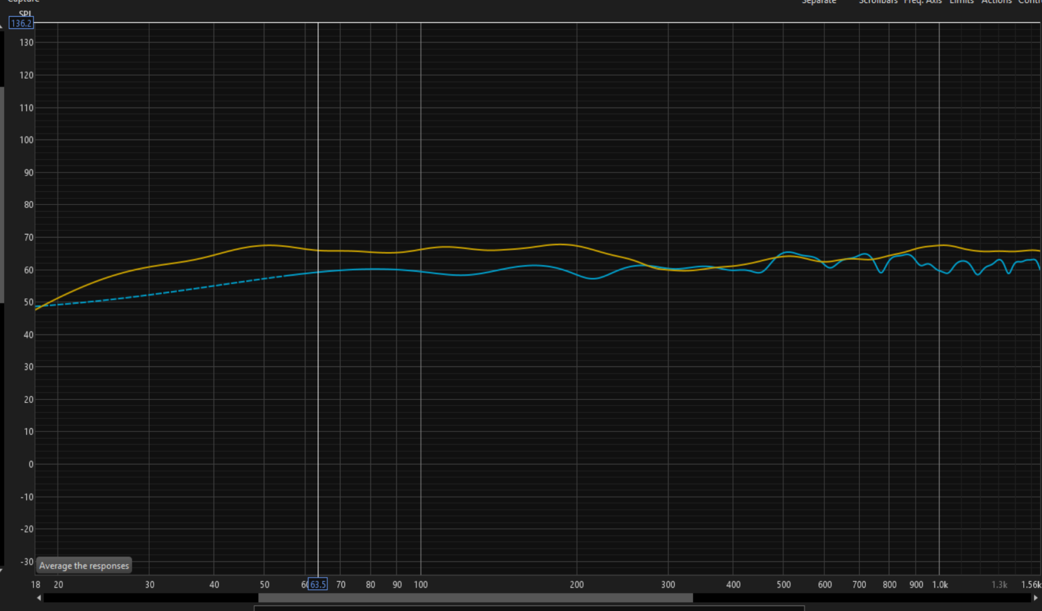

Here's looking back at a design. The woofer itself is the blue line. The yellow line is the full system response with crossover in the network. This was crossed at 350hz 2nd order using an iron core.
They are not exactly SPL aligned but pretty close.

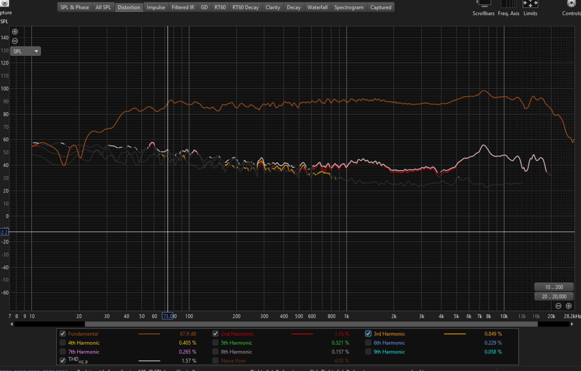

Woofer distortion
System Distortion.
Of course this isn't totally apples to apples but, it is higher distortion with the XO in place than without.

Yes, it's a bit higher with the filter depending on the frequency range.
Between 100Hz and 200Hz, no filter has an average (by "eye") of around 0.3/0.4% and with filter around 0.6/07%.
At exact 50Hz, both have 1.5%.
Acoustic variations are so huge, when looking at specific frequency, due to reflections, mic position, cancellations, distance etc when measuring speakers, that I don't consider this difference much high and detectable when listening - you'll be able to tell us.
Apples to apples only if you build an air core to compare with an iron core with the same inductance.
Keeping everything the same, speaker/mic position, volumes, capacitors etc, and just swapping inductors (with the similar DCR).
Extra work, but it is something for a life. From this test on, you will have your final opinion.

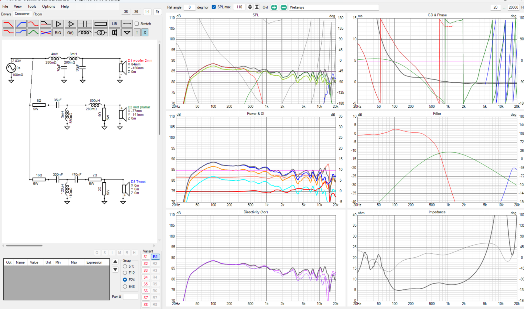

Its not the worst thing I've ever seen but I'll be honest, I think you try using a different program. This makes the tweeter kind of useless.
It does make it a super tweeter I guess. Doesn't everybody hear to 30k? There are angles that the mid, and tweeter sum flat. I question whether someone working at a desk would notice any difference when they move, if there's a notch at 15k.
On the other hand, if you were ten feet away, sitting on a couch, you would be hearing a nice on axis, combined with some room reflections with different arrival times. Crossing lower for that use is probably just as good, although some builders seem to like keeping the x-over outside of certain ranges. You know, the guys building single driver designs. Most of those designs probably don't make it to 12k. (I'm just guessing, not intended as an insult. ) Last I checked, I think I could hear 13k, but that was maybe 10 years ago, and not a precise test. Maybe I'll check again using REW to generate the sweeps.
This x-over uses a reasonable amount of parts, and any amp should like the impedance.
I really don't know why our Sims don't quite match. The software I use, is free, and probably used by thousands of builders. For my own designs, I usually don't use Sims at all. I find posting Sims on the forums, using files supplied by others, to be quite entertaining.
I did recently try making my own frd files for a center channel speaker. It was kicking my a$$ trying to get what I wanted by trial and error. The woofer response made it a challenge. I made a sim using my frd files, a factory impedance file for the woofers, and a similar tweeter zma file from a different tweeter. On the tweeter, there was so much padding that the filter only saw a flat impedance anyway. The sim was pretty accurate. I made a few changes, and continued by trial and error to get a smooth off axis response that was actually my intended listening axis of about 20 degrees. After four nights of use, I like it a lot.

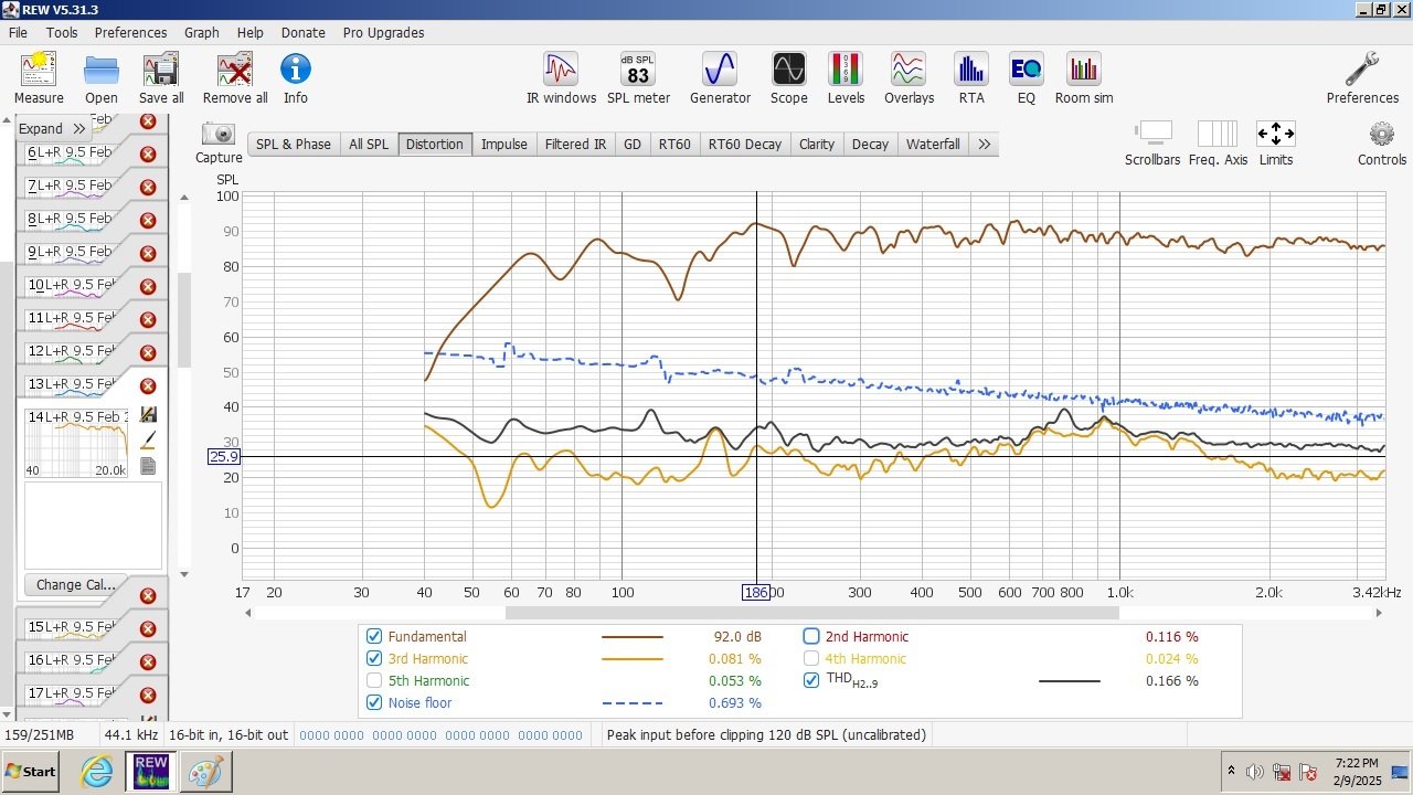

Since you are discussing coils here, I have the distortion measurements of my center. It's not a terribly loud sweep, but I have tested louder. I can't find a loud sweep at the moment. Maybe later. The dashed blue line is the noise floor. The coils used are nothing special, and the woofer is 4 ohms. Crossover uses only two coils.
I have lots of both types of coils, and can measure them pretty easily if you would like. This speaker is crossed to a sub, but the woofer can play much lower.
What frequency range are you concerned about the distortion? Below 80hz?
