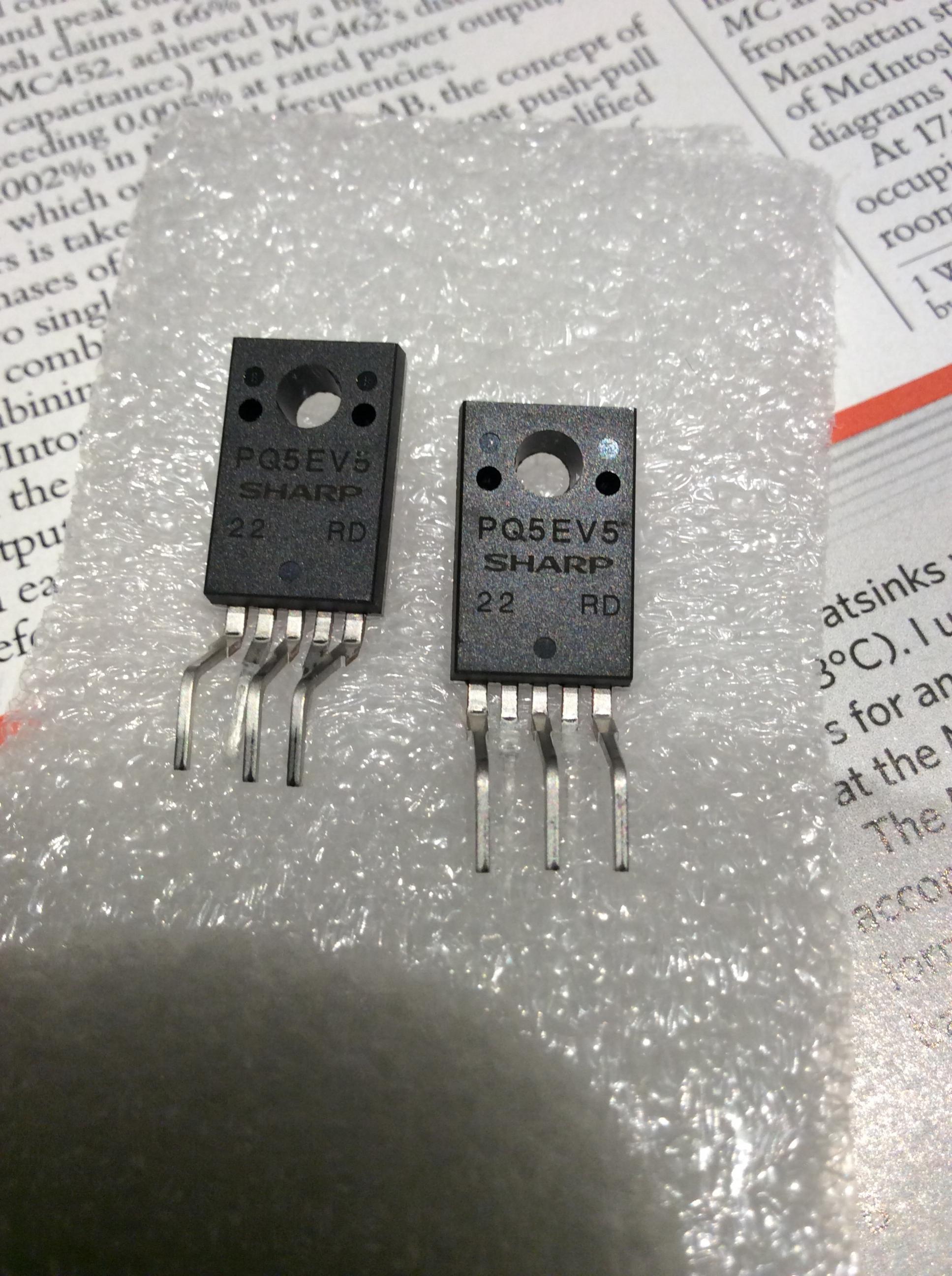

Hi George.
The pair of PQ5EV5 arrived from Suburban Electronics today. Delivery was quick, and they appear to be the genuine article. Once again, a list of Tubelab approved SS components to replace ones that are end of life/no longer available would be a much appreciated addition to your site. Thanks again for the link to the PQ5EV5s.

The old Sharp regulator was the best available 15 years ago, and that is still true. The new Microchip part is a few millivolts worse in the dropout region, so I added two more caps in parallel with C1. These could be added to an existing TSE off board (with short fairly heavy wires) if needed, but that shouldn't be needed unless you are running 2A3's with a marginal power transformer.
