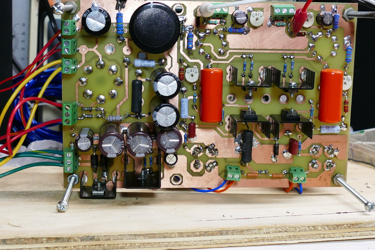

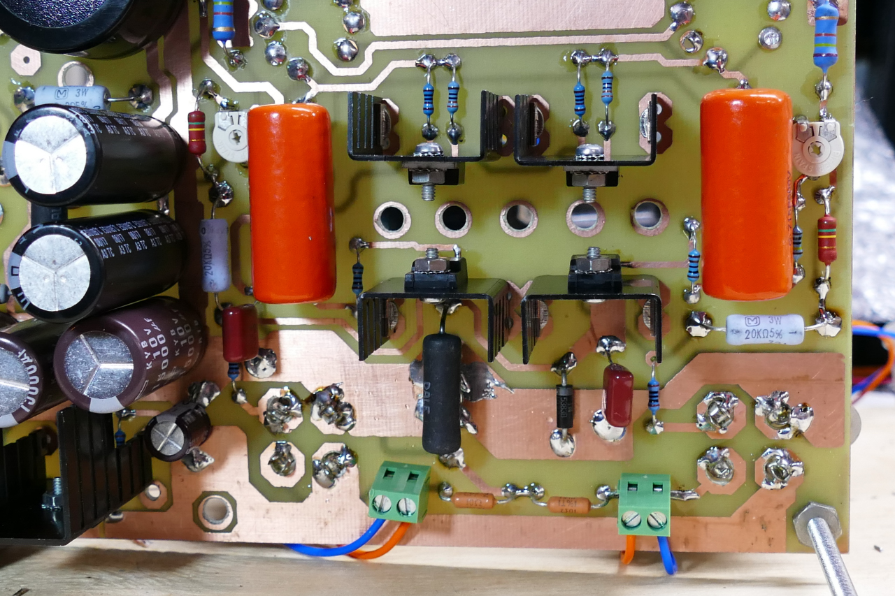

For folks who want to mount MOSFETs on the underside of the TSE PCB
George,
Some folks have mounted the MOSFETs on the underside of the PCB vs the top. Others want to do that so the input tubes are more visible. Understand that some of the heat gets trapped underneath the PCB if the MOSFETs are mounted on the underside.
Would having a few holes near the MOSFET area (now bigger in the new proto design) help the heat escape through the top? Some PCBs have small vias - in this case, probably slightly bigger holes would help. In turn the builder would have to make slits/holes on his top plate corresponding to the MOSFET area of the PCB to allow the heat to escape through the top of the chassis.

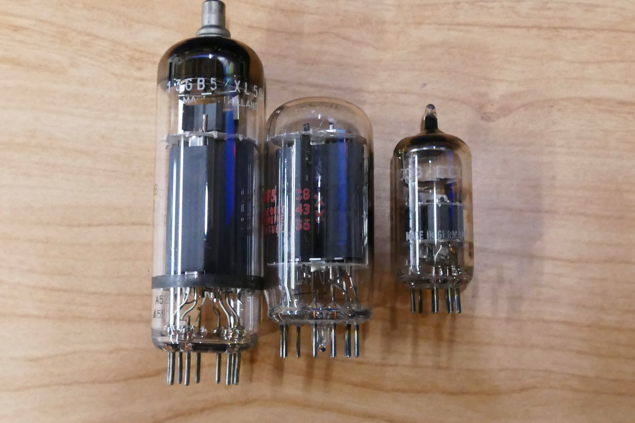

Not being familiar with US sweep types, are these comparable in size to the European EL36?
I don't know the EL36, so here is a picture of the tube, a 6GF5 in between a 13GB5 / XL500 and a 6DJ8 / ECC88. Don't let its 9 watt plate rating fool you. It's a 6DQ6 stuffed in a tiny bottle. It's plate fins are gone, so you cant squeeze 100 watts from a pair like the 6DQ6.

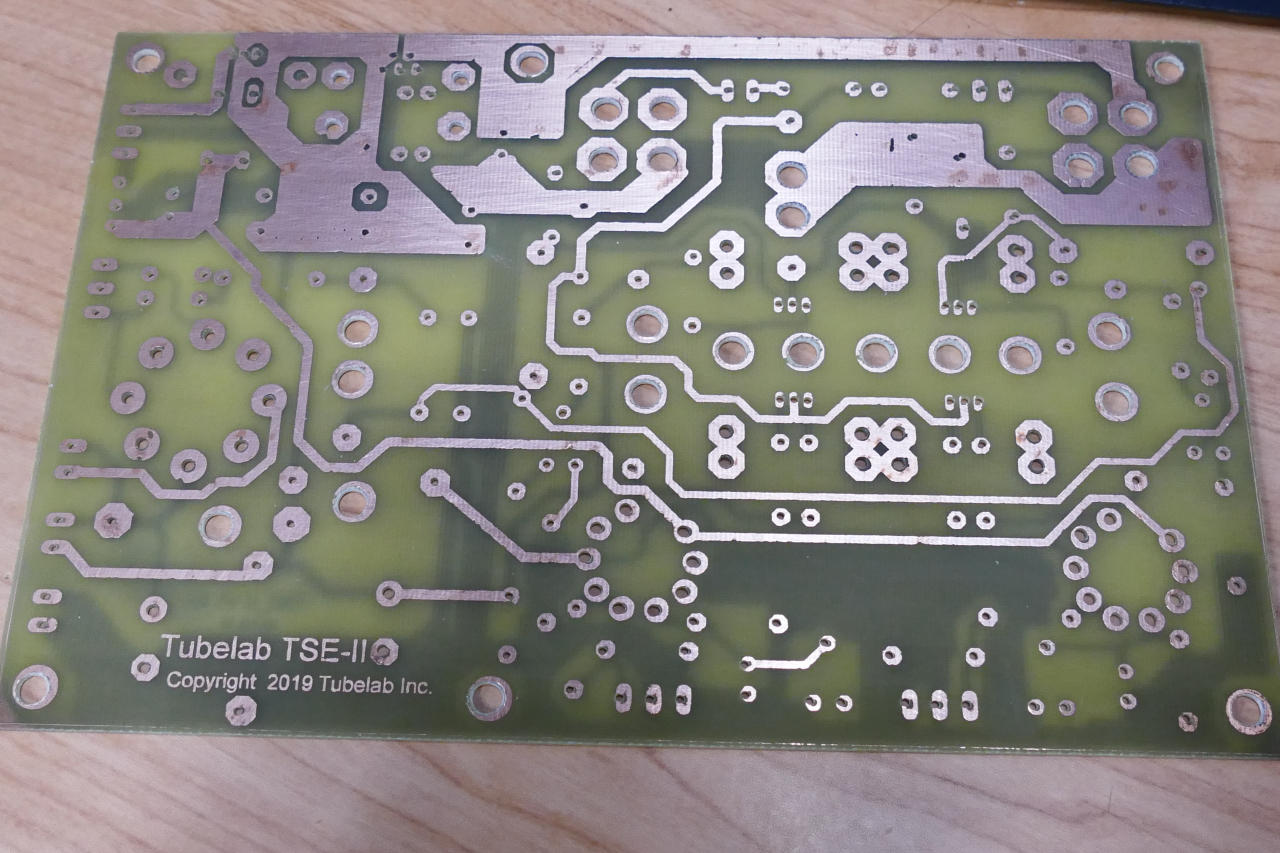

I'm trying to fit some in now for the next test board. This one will be built with the parts on the bottom to verify fitment. Then I will stick it in a tiny box and cook it to see how hot it gets. Right now the resistor that drops voltage for the mosfets gets hotter than the mosfets themselves, so I'll need to tinker with the zener voltage to balance it all out.

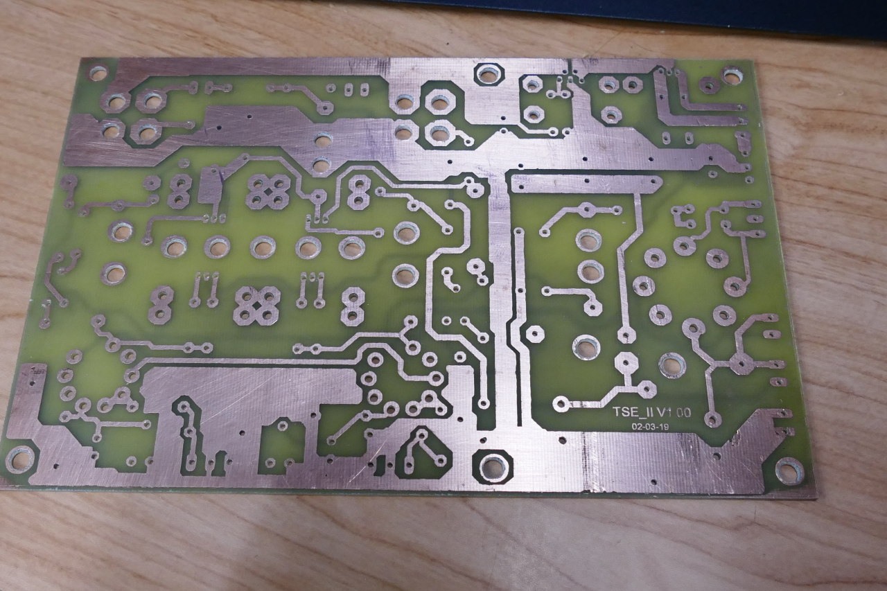

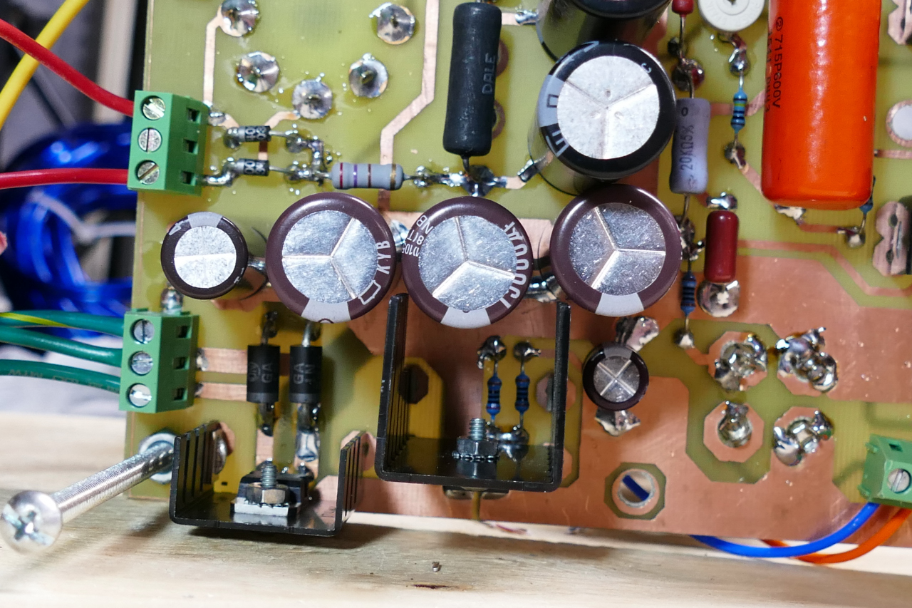

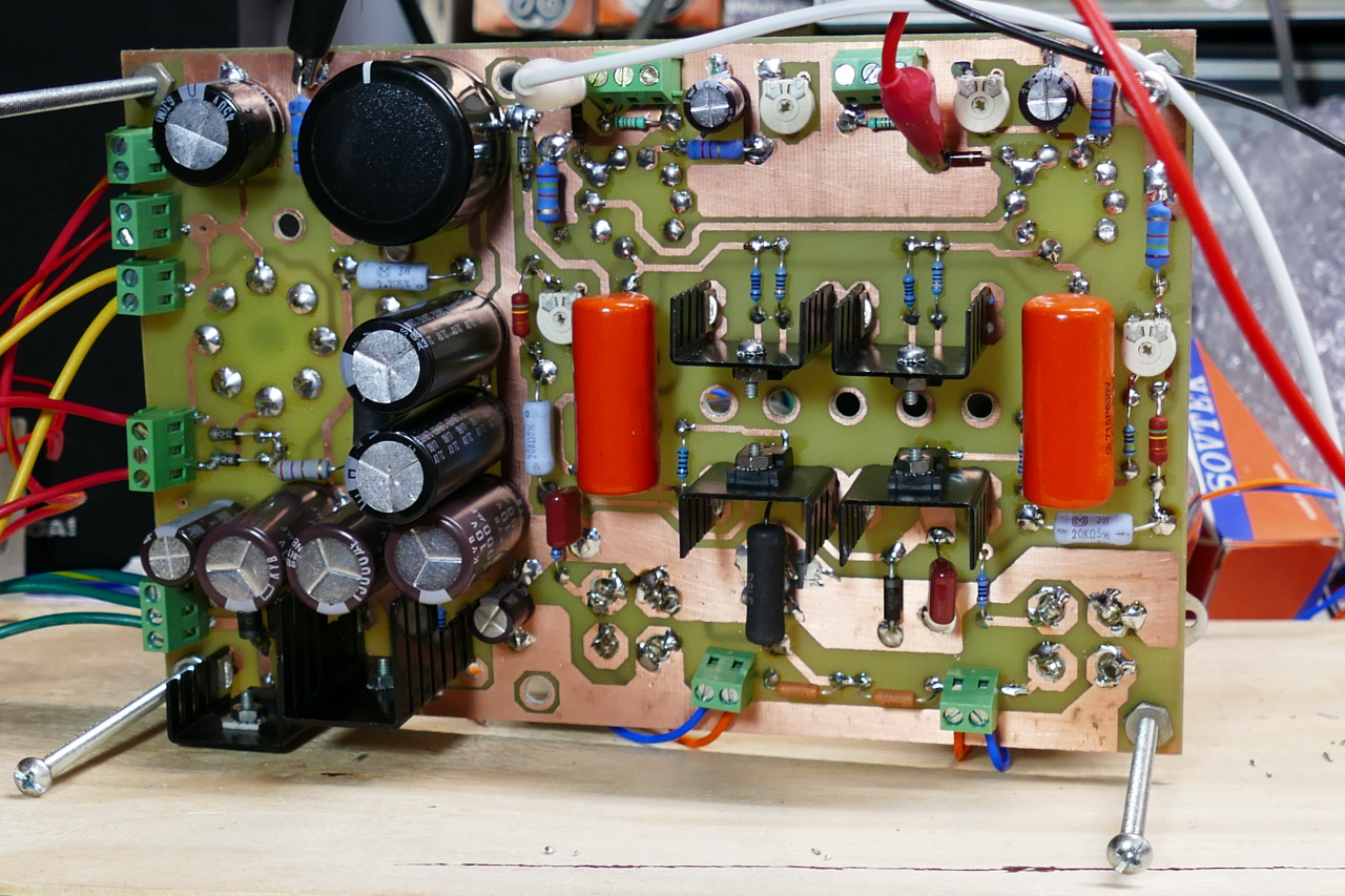

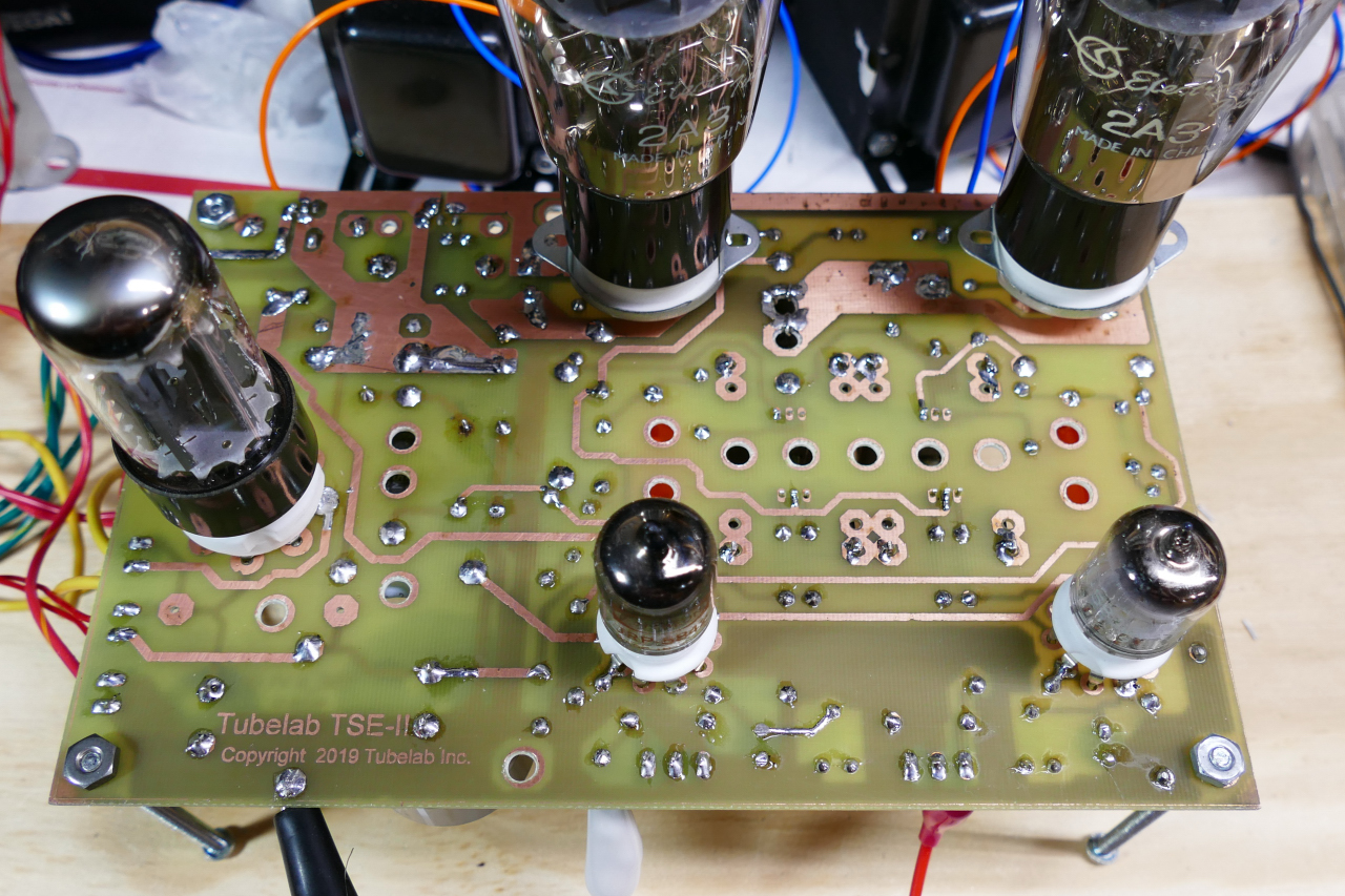

Wednesday was an uncharacteristic warmish (50F) sunny day, so I spent much of it outside with a piece of copper clad, some ferric chloride, and a drill press. At the end of the day I had a bare prototype board that incorporated several more changes, and had more holes than a block of Swiss cheese. (first two pics).
Yesterday was the second of two nice days, with the threat of snow last night but I resisted the temptation to play outside, and spent it in the basement with a soldering iron. Sometime around 6PM the board was populated. I wired up the 6.3 volt leads from the power transformer, and plugged it in. I had 2.48 volts at the 2A3 sockets.....good.
I added the HV wires from the power transformer, plugged it in and poof there was some smoke and two halves of the R5 resistor remained where a whole one had been. It didn't take me long to realize that both C6 and C7 were in BACKWARDS, and I had only ordered two pair.....not so good.
After stuffing my face with leftovers, I turned the backward caps around, replaced R6, and tried again. No smoke, plenty of negative voltage......good.

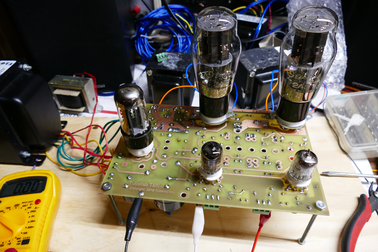

I wired up the 5 volt winding from the power transformer, and the choke, plugged in a 5AR4, and fired it up again. No B+. When you make your own PC boards, it's nearly impossible to do plated through holes, so you must solder the components on both sides ov the board to make the through connection is it is needed. I had missed a solder connection on the 5AR4 socket. After fixing that, I had B+, and the grid voltage at the output tube sockets would adjust from -25 volts to -90 volts........also good.
I installed the 5842's and set their plate voltage to 175 volts without issue. I popped in some 2A3's and set their bias to 70 mA each.....good. I hooked up some speakers, and touched the inputs....no buzz......not so good. It was late, I killed power to the bench and walked away. During the 3 evening hours my front yard had gone from green, to white......not so good, I fetched the snow shovels, a broom, and the gas can for the snow blower from the shed and went to bed wondering what could be wrong.....
This morning I cleared the driveway, and one of the cars, and set out for the gym. Upon returning I flipped the board over to look at the bottom, to compare it with the good one, and it was obvious. I had not installed any coupling caps. A pair of big fat Orange Drops and I had sound......good sound. I beat on it a bit today and will test it some tomorrow.
Due to some other commitments necessary to pay the bills, this will likely be the version I send out to the board house, unless I find a problem in testing.

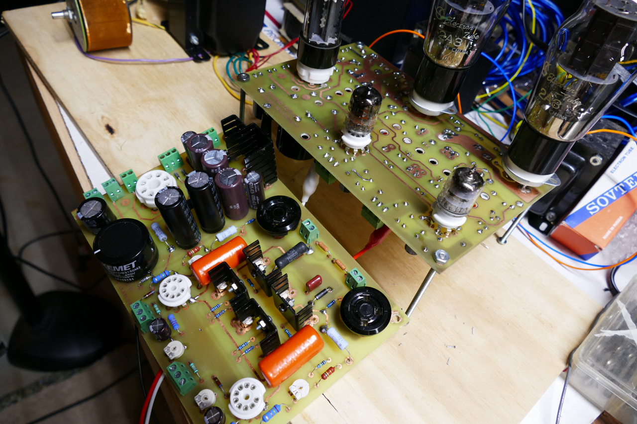

There are now two working proto boards. One was built with parts on the top. The other was build with the tubes on top, but all the other parts on the bottom. There are mounting holes for all partd to be on either side, except for the tube sockets, they MUST be on the top.

Any of the parts can be placed on either side of the board except the tube sockets which must be on the top.
It's up to the amp builder whether they want holes in the top plate or a removable top plate to adjust the bias, or to adjust from the bottom. It will work either way.
I plan on close fitting this board to a 1/8 inch thick aluminum plate, so I will adjust from the bottom. This will be a conventional wood base - metal top type of amp.
I haven't yet decided which tubes either amp will get, but I plan to test both boards with the 3 usual choices in the next few days.
The other board with all the parts on the top might go into a rack mount cabinet. If it does it could end up with sweep tubes since they are more suited to horizontal mounting on "L" brackets behind the board. Much of my early sweep tube testing was actually done with a TSE board. They play well together.
The other possibility is a conventional wood base with a clear Lexan top and some "bling" to dress up the guts. I still have such a chassis I made for a TSE and never used, so that choice may be used for the "last TSE."
