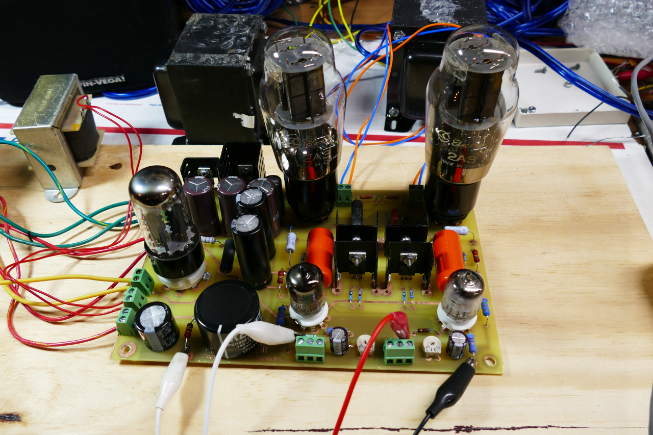

Using nothing more than a voltmeter to test the voltages, set the bias on the output tubes, and plate voltage on the drivers, the board came right up and plays nice. It currently has Chinese 2A3's in it which have been worse case in the filament regulator department.
would it be possible to add test points to the board?
There will be at least one more iteration of the layout to fix some minor parts fitment issues. I'll look into adding some probe points for the major voltages, but I'm hesitant to mess with success too much.
another aspect that can be (maybe) improved - please refer to the the MOSFETs and heat-sinks
The number one request for the new board was to improve this area. People complained about the dual heat sink, often saying it's hard to find (Digikey still has them), the area is too crowded, and gets too hot.
I addressed these concerns by incorporating individual heat sinks that are quite common (yes 1 inch tall), spaced then further apart, and modified the circuit to reduce the dissipation. After playing for over an hour I can put my finger on the heat sink without burns. NOTE, DON'T do this, they still carry B+ voltage unless insulators are used. The board can be assembled with the heat sinks (and other parts, except tube sockets) on the bottom side to allow for close to the top plate mounting. My next build up will be done this way to verify placement before sending out for boards.

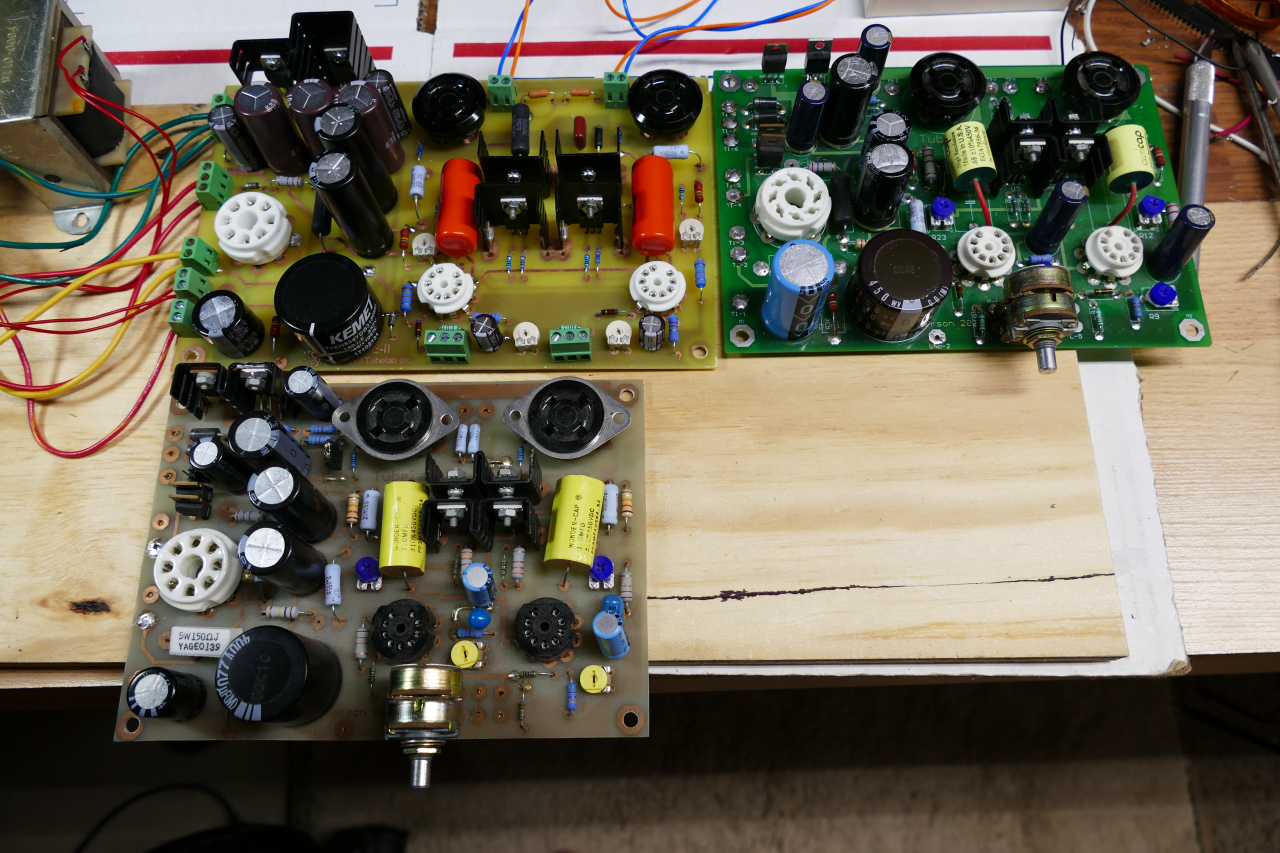

take a pic of the old and new board side by side.....if it'll fit in my current wood open top cabinet.
In order to accommodate the heat sink requests, and the requests to increase the spacing between the output tubes, the board got larger in both X and Y directions. The placement of all 5 tubes moved with respect to each other, so I doubt existing cabinetry will work.
I'm going to let it play for the rest of the day while I work on Tubelab's taxes. Maybe later I'll try some different tubes or take some measurements.

It's a high heat area too.
Well understood, and fixed.
The TSE was designed with 45's in mind. It was the early 2000's and good used tubes could still be found on Ebay, in flea markets, and at hamfests for $5 to $10 each! At that time many of my amps were hand wired, and constantly evolving. Most were actually Push Pull amps using 6L6GC's or KT88's.
The discovery of "PowerDrive" brought the mosfets and PC boards into the picture. I can find pictures and Eagle files of at least 4 different versions of what became the TSE. Often the board changed to fit whatever parts I could get surplus, and all boards were DIY like the one in these pictures. They all went to my technical friends, who often built them themselves.
I couldn't make enough of them so myself and some friends decided to pool our money and get a batch of boards made for our 45 amps. I did the "final layout" for that design based on parts in the 2003 or 2004 Digikey catalog. We even got a bunch of different caps and took them into the plant to analyze them and picked the best....this is the reason for the huge cathode bypass caps. As with this board I made a prototype board to test the layout before spending money on a batch of boards. That proto board from 2004 is the one in the foreground of the 3 boards picture in post #63. It still works too!
There have been ZERO changes in the TSE board since then, but people (including myself) stuck bigger and bigger tubes into it, and line voltages keep going up, so it runs a lot hotter than in 2004. Time for a change.
In spite of the heat, the TSE has been a popular amp design once people got over the "sand in the signal path" thing. Therefore, I'm hesitant to make any major changes. The most popular request was "make it bigger." The amp looked funny when some fat 300B's were installed and they nearly touched each other. I stretched the board to the biggest size that would fit the mailing materials I use and used most of the room around the heat sinks, tube spacing, and the new heater supply (more caps).
The TSE was always marginal with 2A3 tubes since that eat 2.5 amps each. That was another design criteria for the new heater circuit. It has been playing for 3 hours now with 2A3's running 75 mA each at 125 volts AC line and nothing is excessively hot. I plan on tweaking some resistor values to even out the heat once 45's and 300B's are tested.
After about an hour I smelled something hot. Investigation revealed that the B+ choke I borrowed from an old HP audio oscillator really doesn't like 170 mA of current through it.
One more suggestion if it's not too late for consideration.
A fifth mounting hole in the center of the board somewhere might be a good idea. The shorter board flexes a bit when tubes are inserted and that will become more evident with the longer board.
A pair on the centerline at the edge would rock but I don't see a suitable location.

Hi George,
Here's another suggestion for the revised board.
Would it be possible to change the orientation of the power sockets so that the tube labels will face forward? I believe this would mean that pins two and three are in the rear and pins one and four are in front.
I like the suggestion of adding a center mounting point to add stability to the board.
take care, Jacques
Every tube is different. You can see the labels on the front of my 2A3's in the board the way it is now. It would take a complete redesign of the board to move those two FAT traces capable of carrying 2.5 amps. That's not possible now that I have a working board that just needs minor tweaks.
That one was on my list as the SSE already has 5 holes, and I missed it. I am in the process of fitting it in now, which will mean one or two more test board spins before sending the board out.
label the parts on both sides of the board to facilitate dual side assembly?
That is possible. I need to see If my board house will do it, and how much it will add to the price.
