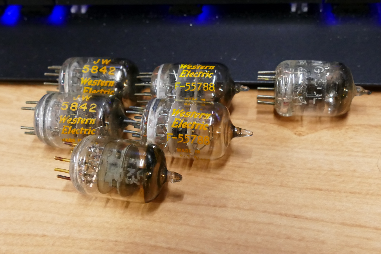

Since my last post I discovered a few more tubes hiding in my stash. There are some Western Electric tubes marked JW 5842 in the usual yellow paint, no mention of 417A. There are also some WE tubes marked only F-55788. One has no getter left. I plugged the other F-55788 into the TSE-II and it works.
I now have two TungSol tubes, and they were not likely made by Raytheon. The getter has no stamped steel support, it is "D" shaped and not connected to anything internally.
I have another oddball that has faint white lettering, gold pins and the number "039" etched vertically along one side. It is a different construction from all the others. No clue who made it, or what brand it was. The printing is too messed up.

Technically the 417A has a Mu of 43 or 44 while the 5842 is 50. I have compared WE417A's to Raytheon 5842's and they are indeed different. The WE417A does have lower gain and they make it hard to drive a 300B to clipping from an iPHONE source. Yes, people use WE tubes in a TSE with a phone, iPOD or iPAD source, so I must test for that.
More gain can be obtained by increasing the value of R15 and R26 to 470K or 1 meg. This change will be incorporated in the new parts list for the TSE-II.
I have not yet directly compared the different flavors of WE tubes, and I sold most of my collection to fund further activities of Tubelab.
I discovered this bag of tubes yesterday while looking for something else. They were segregated for a reason over 10 years ago, but I don't remember why. They may have problems, but I will try them all when I have time....right now it's tax time.

My dual marked RCA's have gold pins, and I am thinking they are actually Amperex. That oddball might be an Amperex, but all I have here at the office are Raytheons. The RCA whatevers are at home, so I can't get a pic of them.
I've never seen a Raytheon marked as anything other than a 5842. But I have the dual marked RCA's, that might be a 5842. Or they might be a 417A?

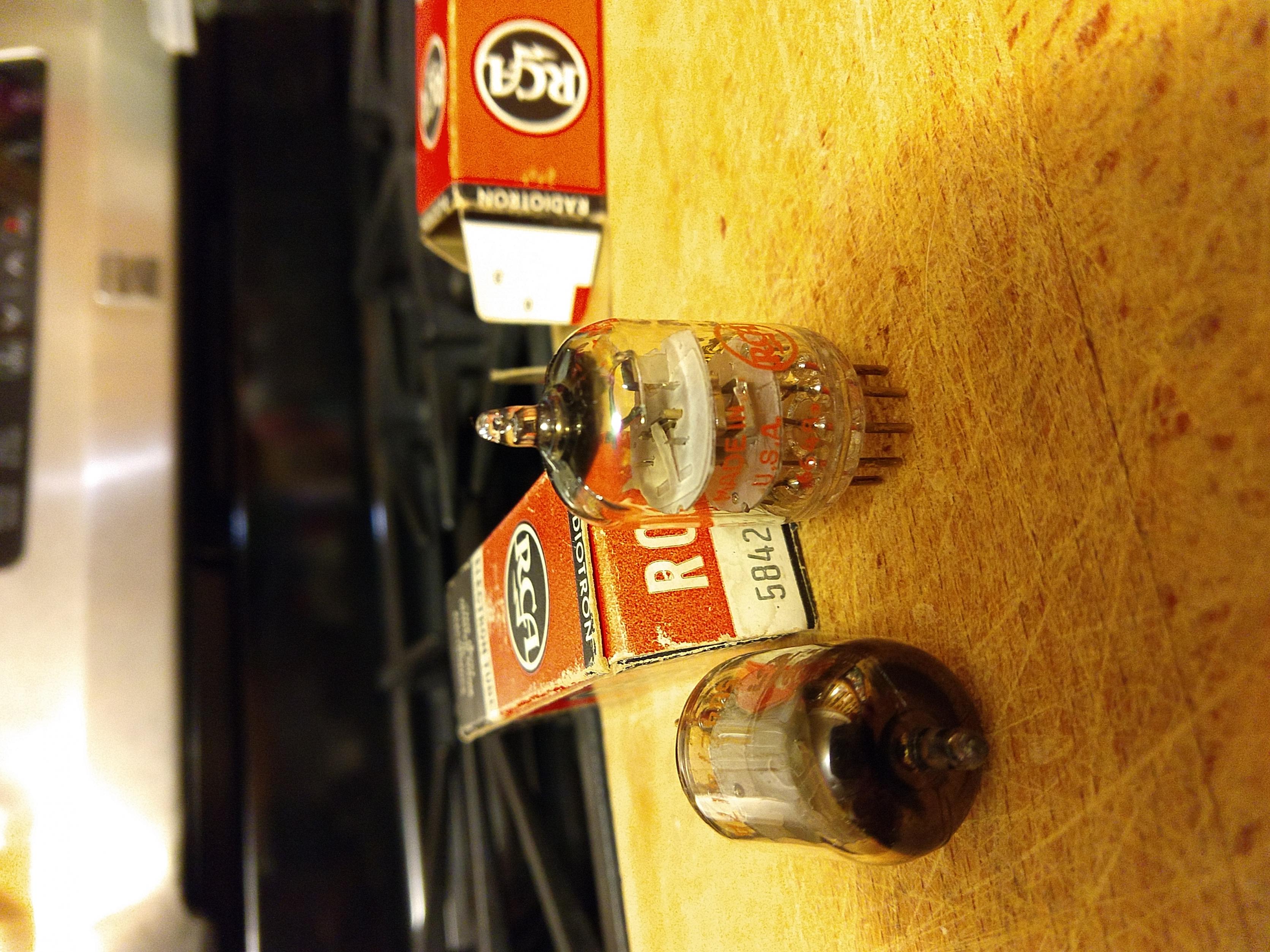

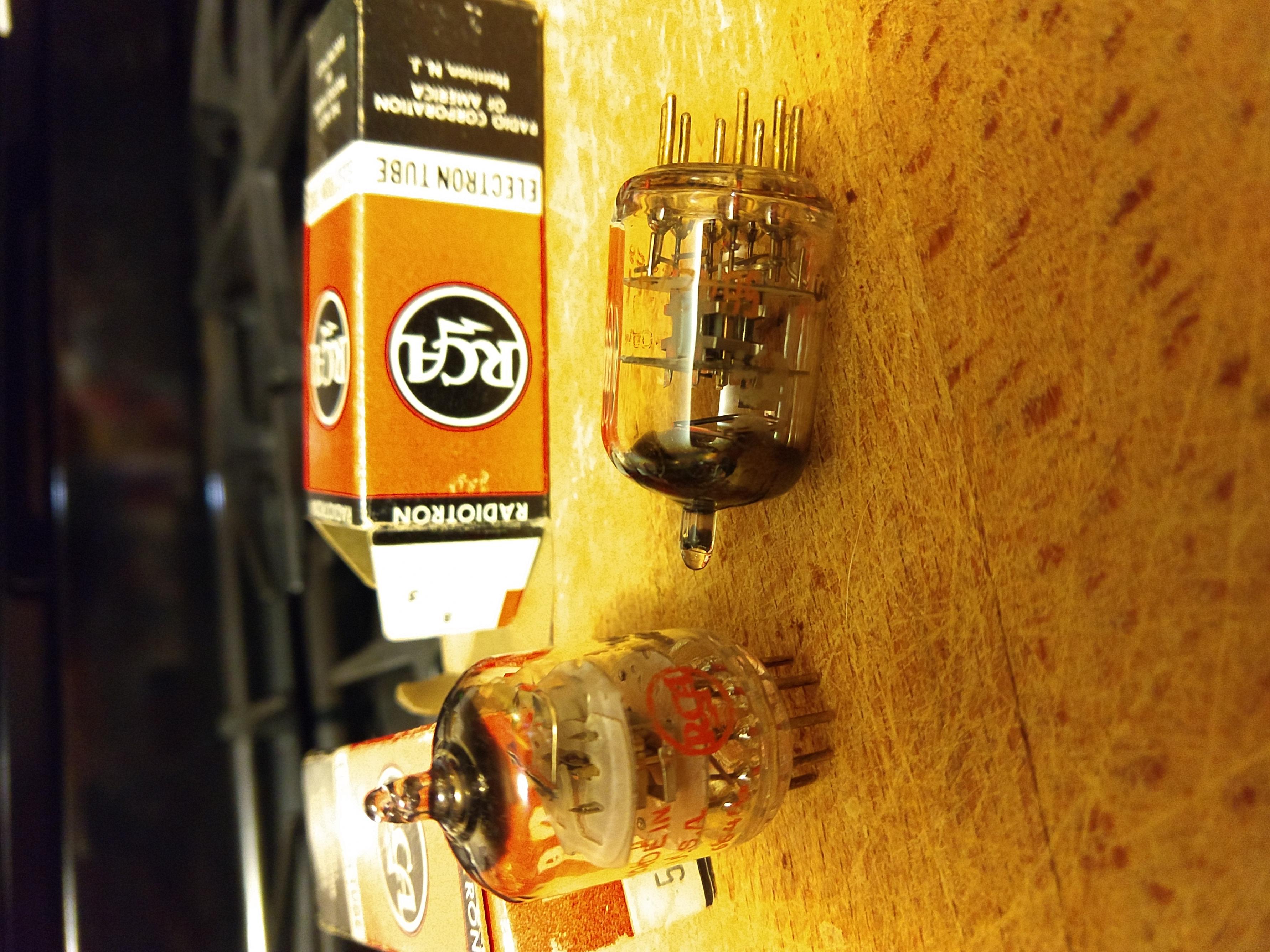

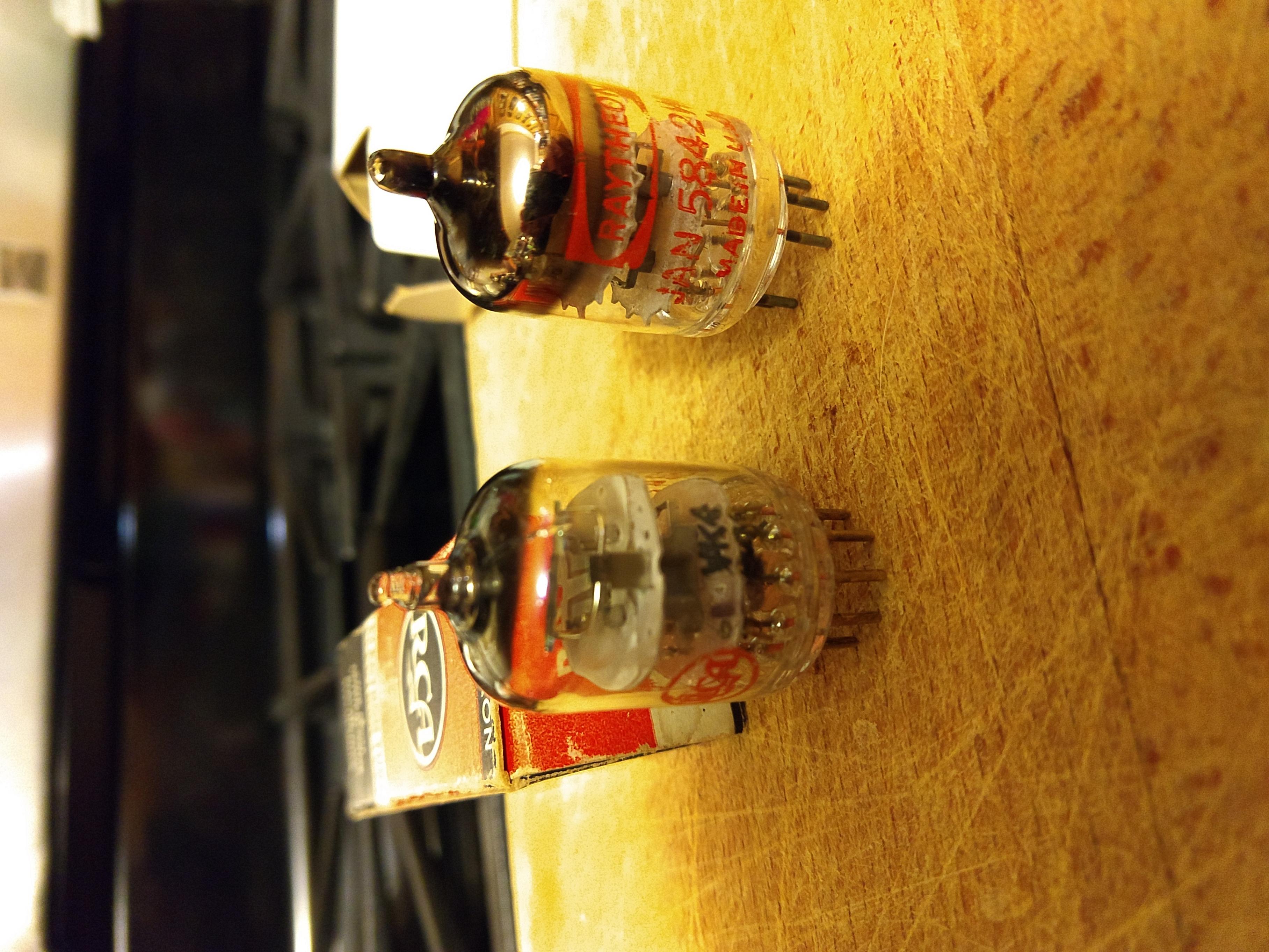

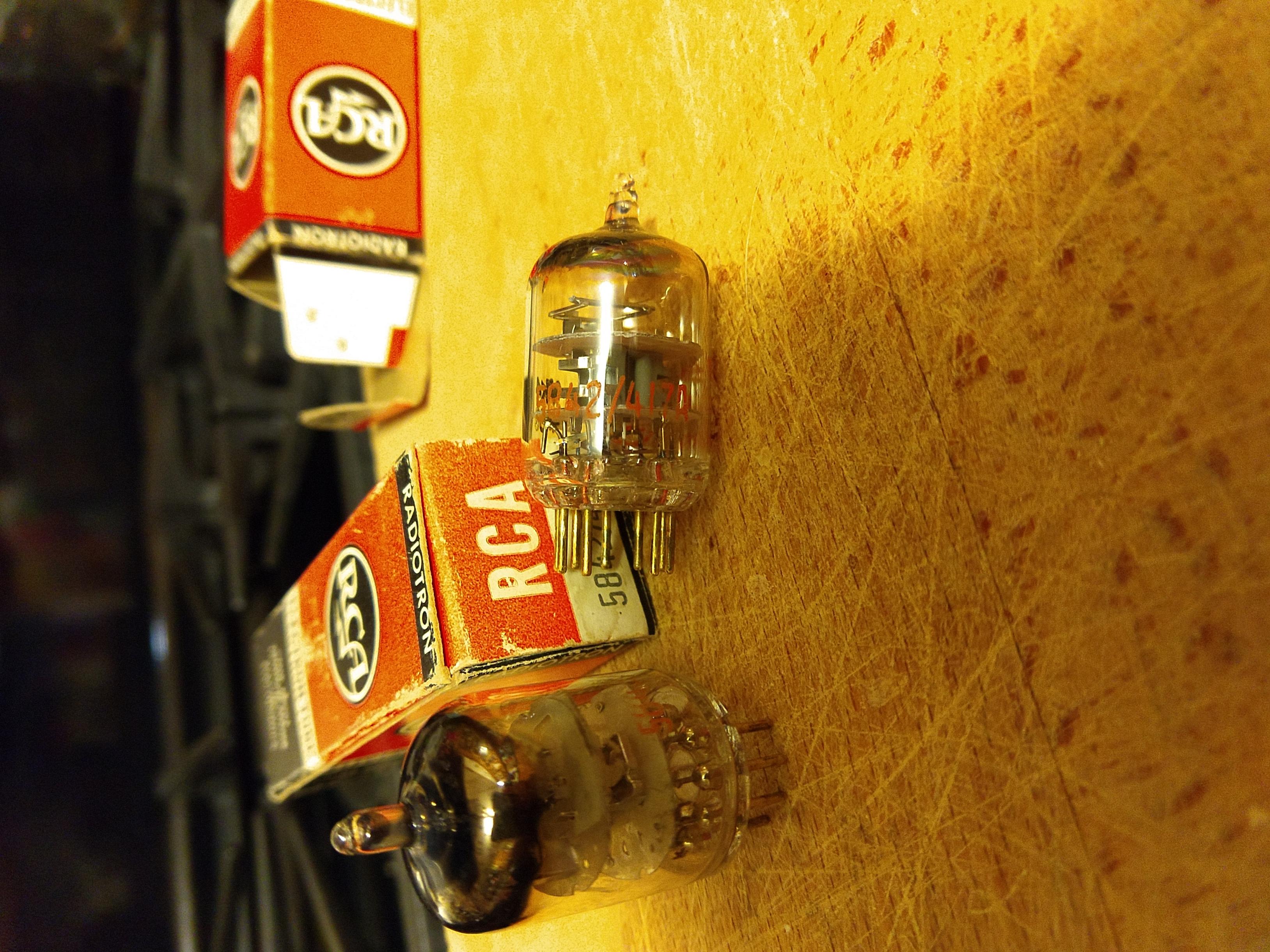

Two date codes - 1962 and 1966. Clearly marked made in USA, but have the cross seams on the top of the glass, and what looks like Mullard codes etched into the glass. They also have larger digits etched into the glass, similar to Tubelab's mystery tube, but that didn't show up well in the pics.
The Raytheon is a 1985 date code. I found some 1984, also.
I'm still thinking Amperex. But are they 5842's, or 417A's?

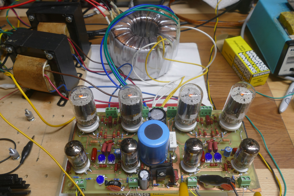

I have several pentode driving pentode amps in the works. Two are working prototypes now. The unique thing is the triode curves I'm tricking those pentodes into giving me. The curves ARE evenly spaced. My manual measurements with Harbor Freight measurements are a bit off in the placement of the 4th line.
This "un-triode" is a TV sweep tube that looks like a triode, and eats 550 volts. A pair of them will squeeze out 80 WPC on a regulated supply, and 50 WPC on an Antek toroid. All 8 tubes are pentodes.
The amp shown here is a push pull design. Meet Little Brother from post #97. There is a Single Ended un-triode I call the UN-SET in the works.
