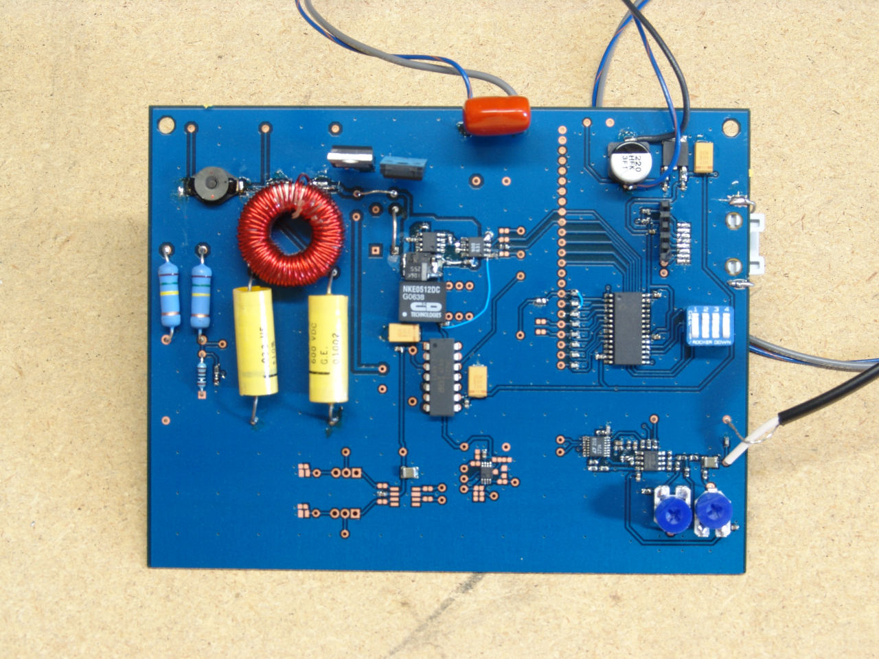

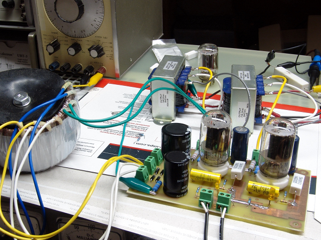

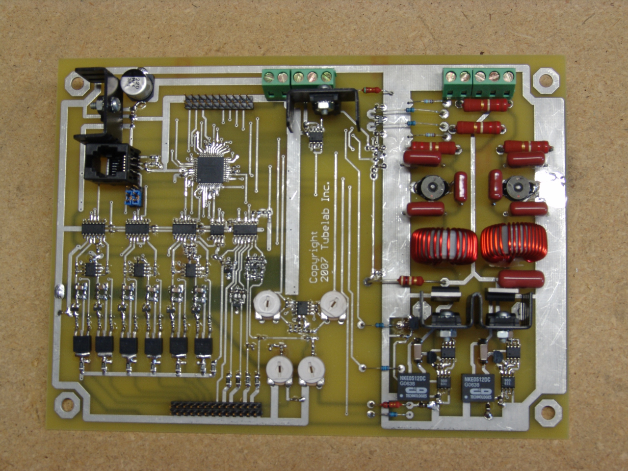

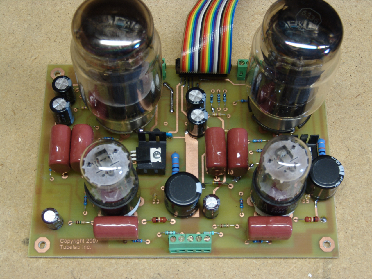

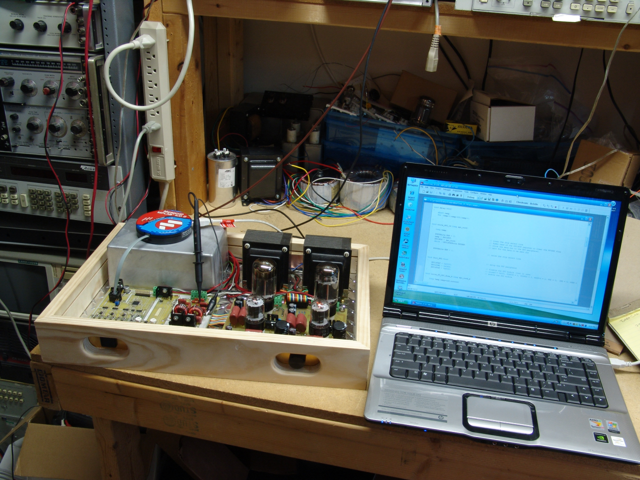

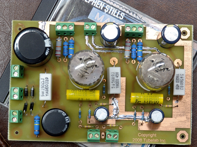

The amp was all leaded components. The controller used SMD, 0805 and bigger. The blue board is an early test board for the digital section. See pictures.
The last picture shows the "tune up." Setting the bias and optimizing for power and distortion using a laptop! I still don't think the tube amp world is ready for that one, but my kilowatt will have a processor and a USB port.....if it ever gets built.

Despite what some would have you believe, these are NOT pinout compatible. Could someone hack up the PC board and wire an EC8010 into the TSE? Yes, if they knew what they were doing. Would it work better? It's doubtful that it would produce a lower distortion number. Would it sound different than the 5842? Maybe, I don't have any, and they are hard to find in the US, so I don't know. Different, may sound better to some, and worse to others....unless it was really a lot different.
The 5842 was selected over 15 years ago because it consistently produced the lowest distortion at the output level needed to drove a 300B compared to all the tubes that I had available to me. At that time I had a warehouse that held over 100,000 tubes. Is there something better out there? Maybe, it is possible. Is there something out there that is easier to find that is as good, or "good enough," whatever that is? Maybe, but it's going to take some time to test a bunch of tubes.....and I don't have that time right now.
As soon as I verify a few more things, and assuming nothing bad is found, the TSE-II board as it sits now will be sent to a board house for duplication. When the first batch comes in, I will need to build some boards and make some build documentation.....maybe even a Youtube build video.
