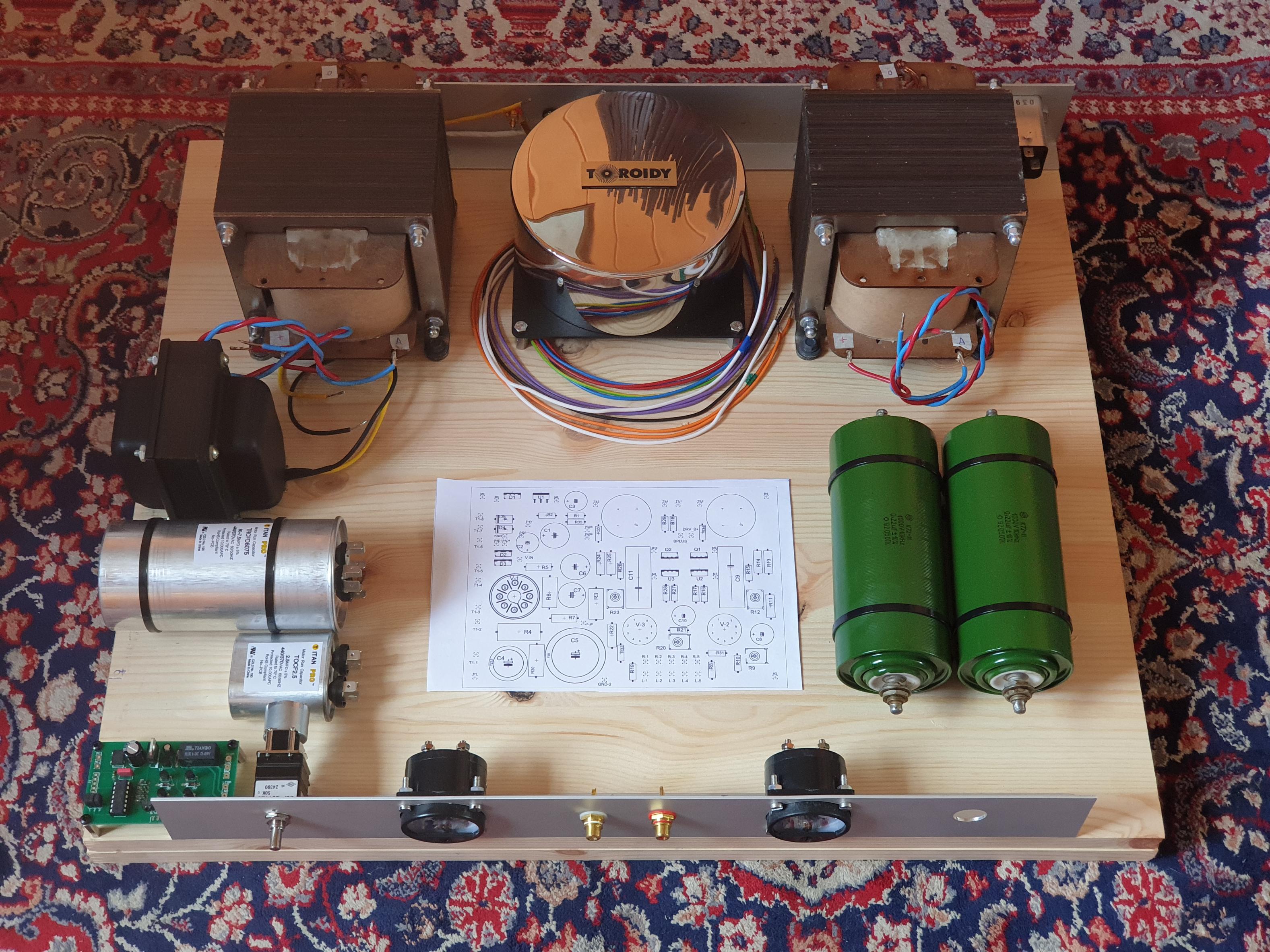

Here is my build so far with the paper pcb the correct size, so I have more than enough room. I'm just waiting for the illuminated on/off switch to arrive that will go in the hole on the right hand side of the front panel and then will wire up as much as I can. This is my first build that isn't from a kit or recapping old amplifiers/radios. As such I'm prototyping it on a wooden board before I build my first chassis. I love the green Russian k72-11s but at 2.8lb and the size (over 7 1/2 inches long), I might have to change to smaller coupling caps when I make the final chassis.
Here is a new piece of paper with the correct picture. Verify that it prints out at 8.5 X 5.5 inches. Some printers are off by a little.

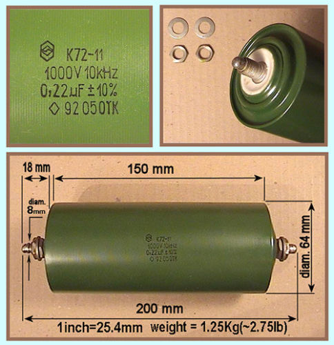

Those are the biggest coupling caps I have ever seen......seriously, I don't know what their value is, but there is such a thing as too big. The original TSE had anywhere from 100K to 470K resistors installed for R15 and R26. I have increased this to 1 MEG for the TSE-II in order to boost the gain a little. This gives a 10 Hz corner frequency with a 0.1 uF coupling cap. Installing a really big cap would lower the corner frequency to the point where it takes too long for the bias to change when turning the pot. If your system has no low frequency roll off things like a warped record can make your speaker cones move....a lot! I learned this in my solid state days with a Carver 400 watt amp. In a tube amp it causes distortion due to OPT saturation.
I wouldn't use a cap much larger than 1 uF and reduce the value of R15 and R26 if you go that large. In this design the coupling cap works into a high impedance, the 1 meg resistor and a couple of pF in the mosfet. This makes minor imperfections in the coupling caps a non - issue. super expensive caps are really not needed, but you can use them if you prefer, just keep the value near 0.1uF

Just the physical size is large, the caps value are your recommended 0.22uF (I wouldn't arbitrarily use a totally different value), These are teflon caps rated at 1000v so that probably accounts for their size.
They were actually quite cheap, but I see are not selling that fast, at 50USD for a matched pair. Not sure if I can post ebay links, but if you are interested and search for "MATCHED PAIR Russian Teflon Capacitors K72-11" you will find them. I've attached a picture from the listing. (There's also a listing for unmatched k72-11s for 20USD each).
