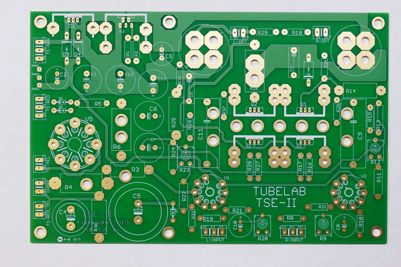

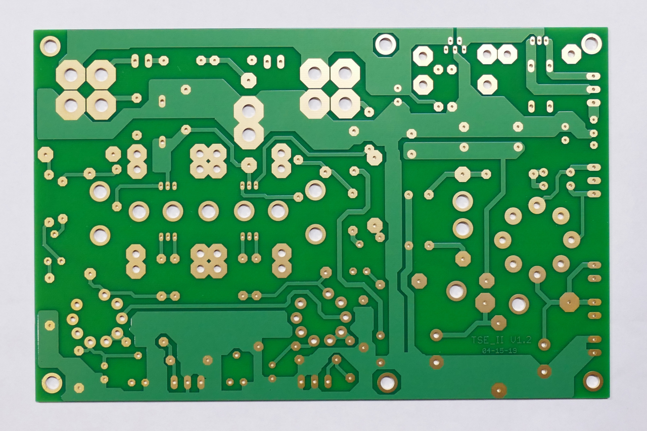

I received a PM asking about the cost of a TSE-II board. Due to it's larger size and gold finish it will be USD $40 instead of the usual $35.

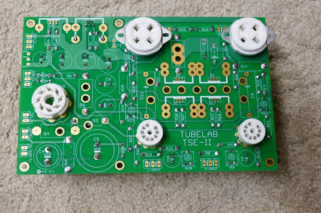

After ripping up the mower, I decided to build the TSE-II board.......Except I had forgot to order some missing parts before my trip. I decided to do the unthinkable in the name of time......I ripped apart my working proto amp. With any luck I'll finish the new board tomorrow and fire it up.
Another question before ordering parts......Is there any interest in pre-packaged parts kits for these boards? They would be a collection of all parts needed for populating the PC board. All the components for the board would be purchased from Mouser, Digikey, or Allied, and the tube sockets would come from ESRC.....all exactly the same stuff seen in my builds. The parts would be sorted and bagged and I would charge about $20 for doing this. I did it for The SPP and the SSE, and they sold in spurts. I would do this for as long as the parts kits continued to sell. That seemed to be one to two years for the SSE and SPP.
If there is interest, do we want gold tube sockets or tin? I need to order these NOW since I will see Stan (ESRC) at the Dayton hamfest next week (no shipping charges).

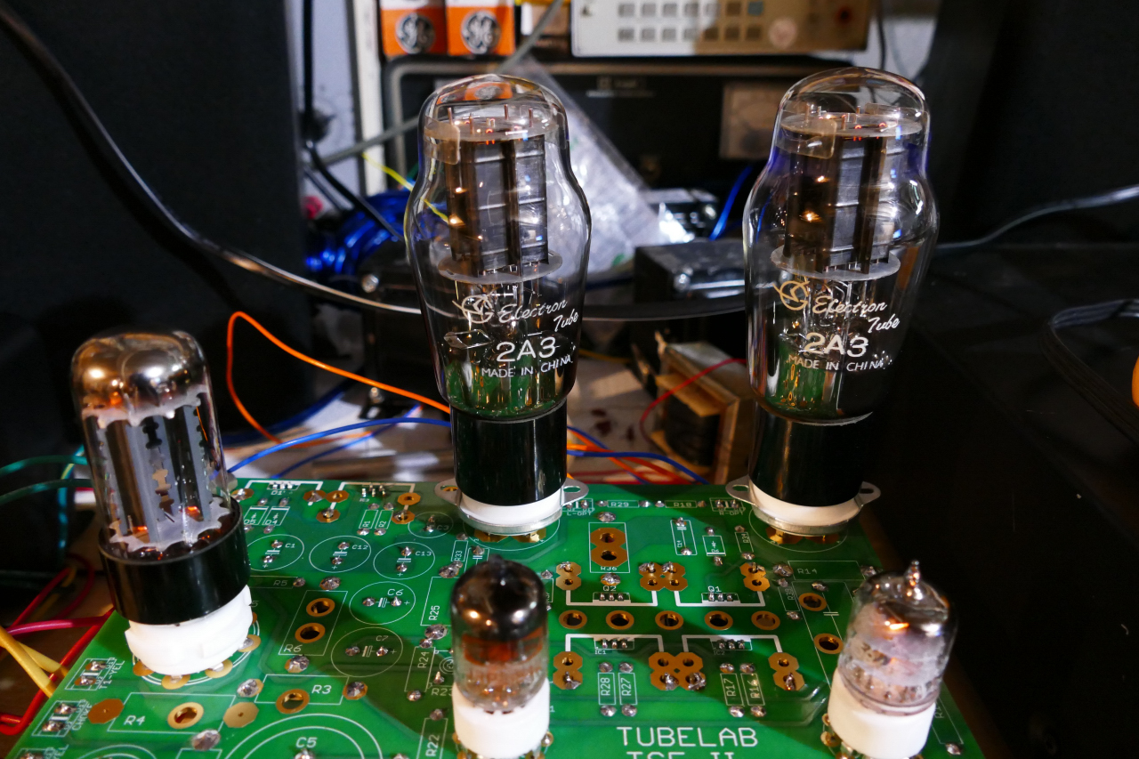

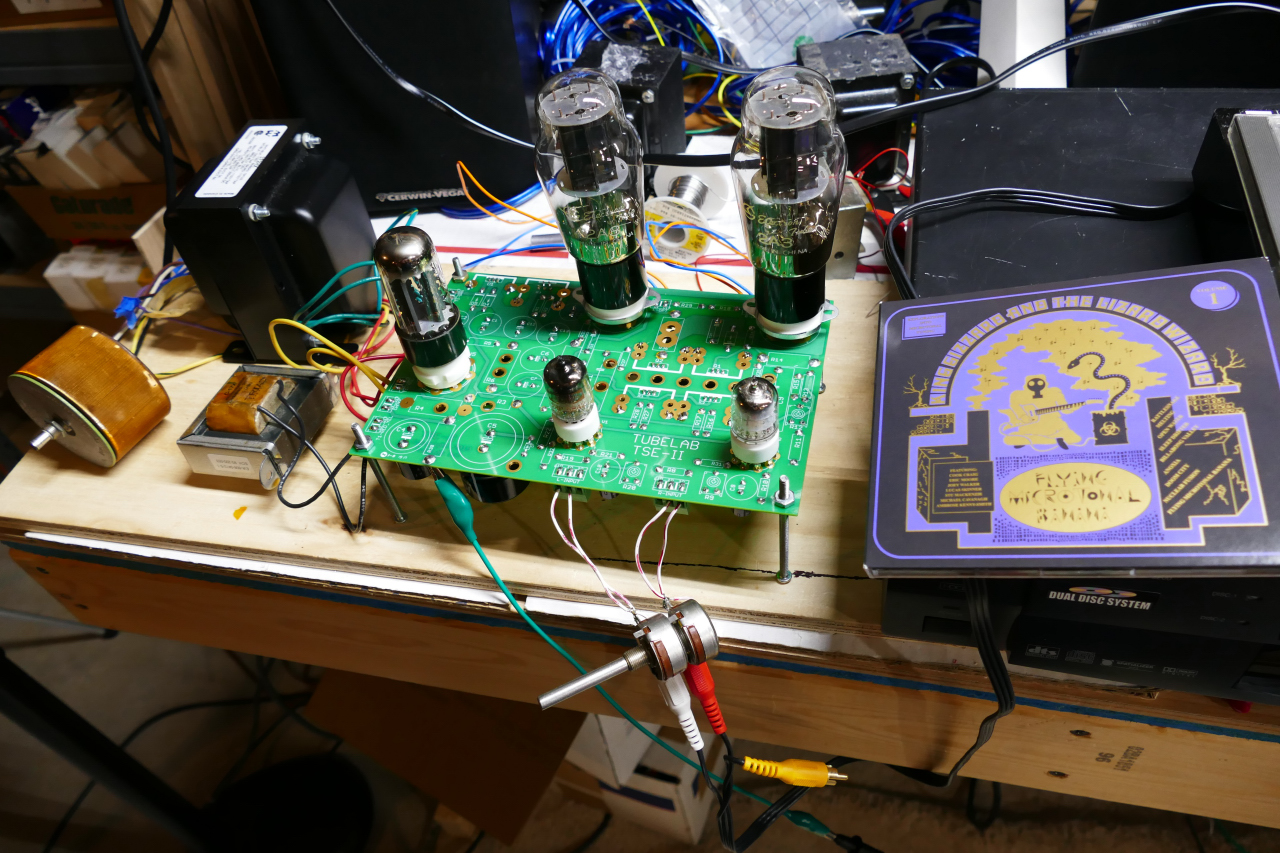

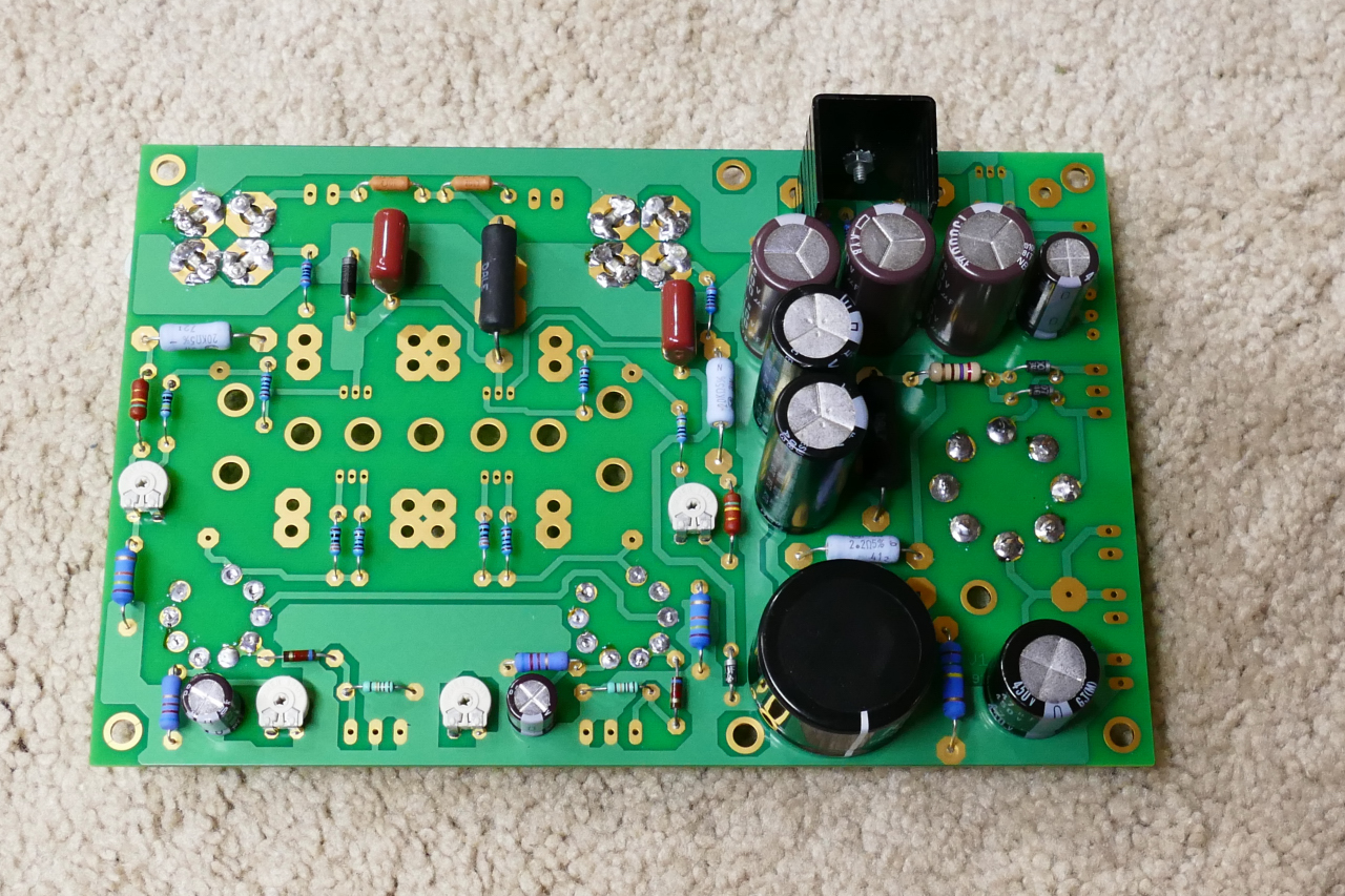

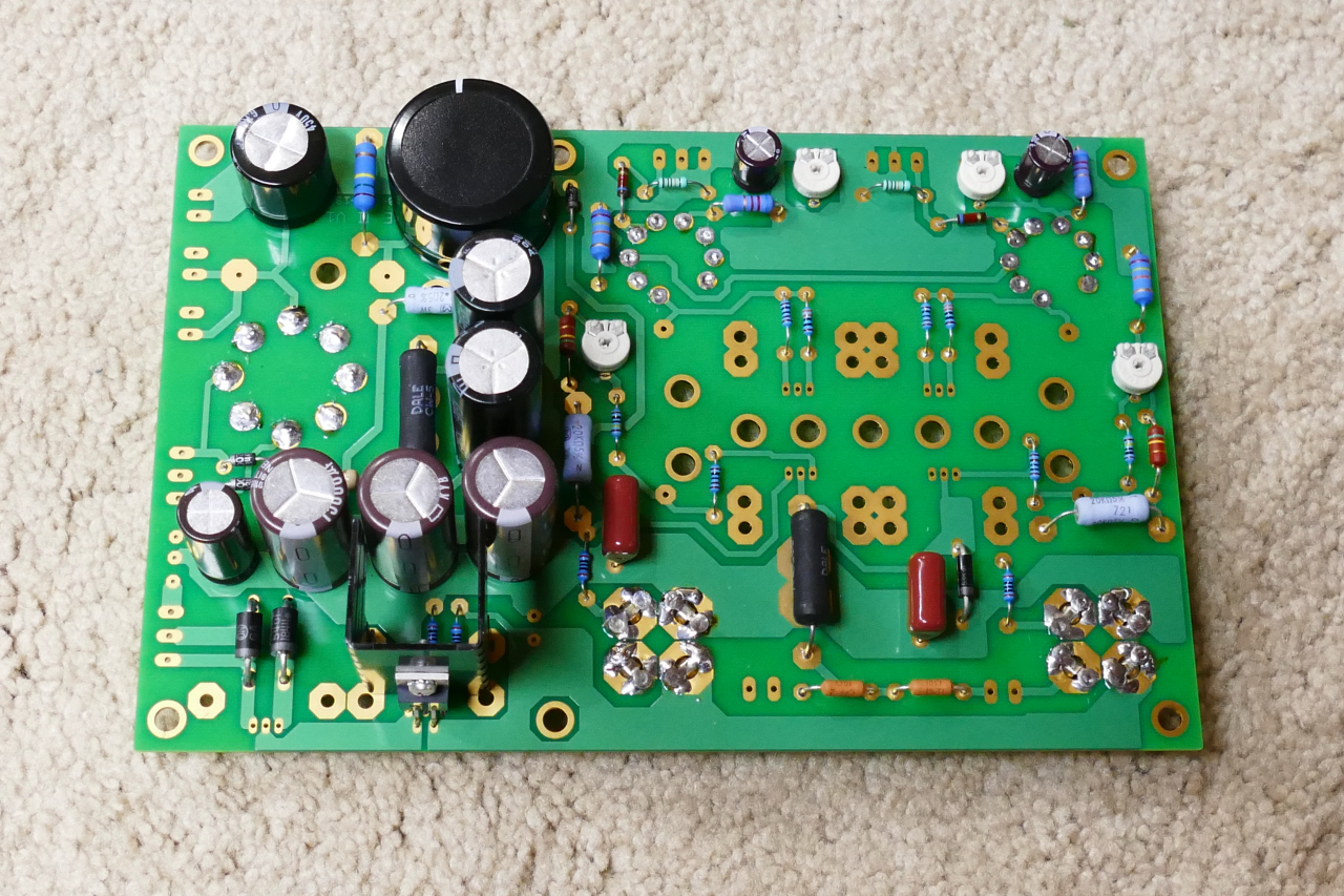

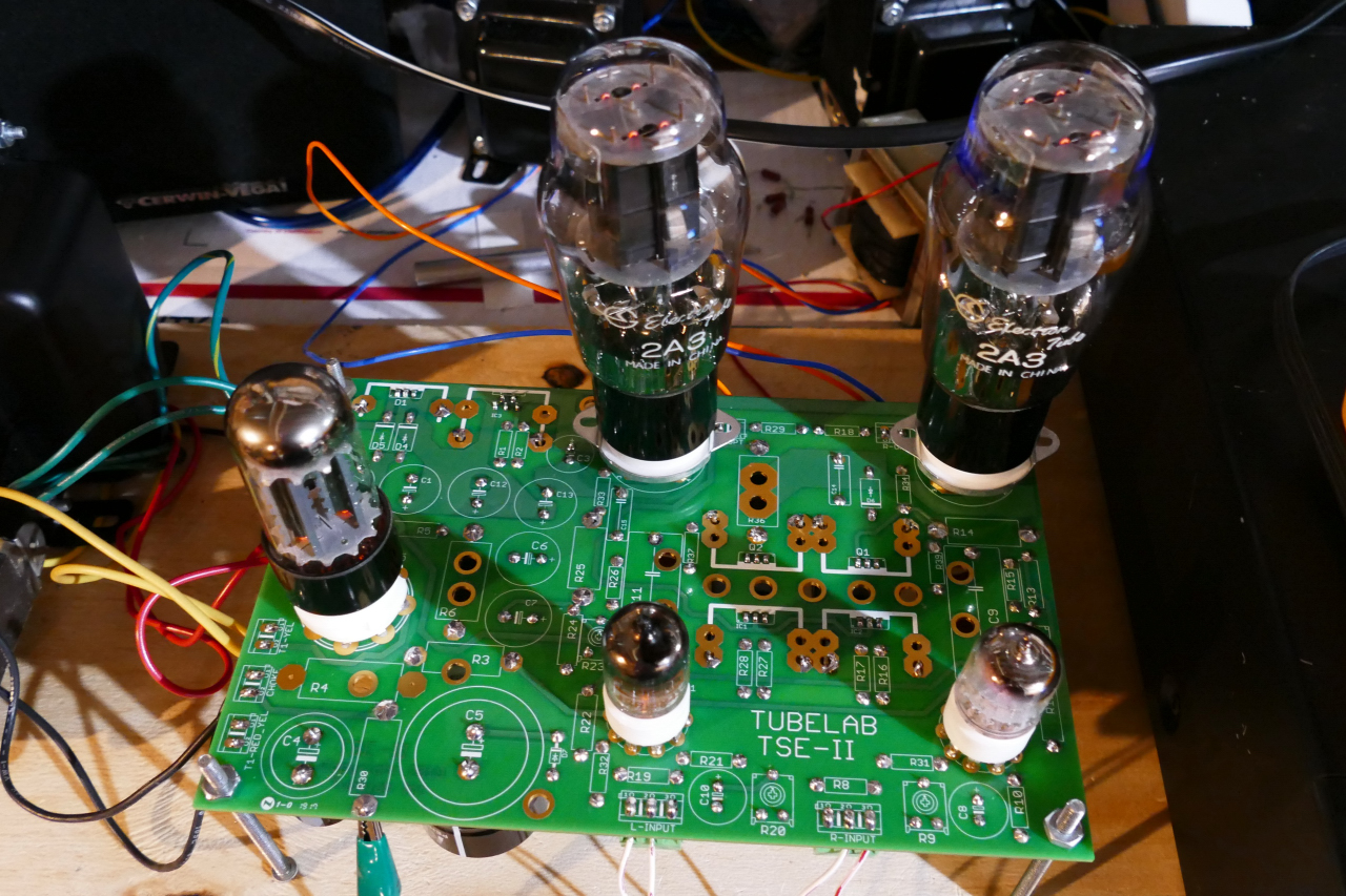

So I finished putting all the parts in the board this morning, took a step back, and plugged it in........only to be met by the smell of smoke being let out of a resistor.......not ALL the smoke, just some. The DUMM BLONDE had put the zener diode in backwards (why do I always mess up at least one diode. I have been doing this long enough and the picture is printed right on the board). OK, I turned the diode around and fired it up.....there was enough smoke remaining inside to power up the board.
It has played flawlessly all day long. It has played everything from Dave Brubeck to King Gizzard, and is currently almost done with the Loreena McKennitt the Mask and Mirror CD.

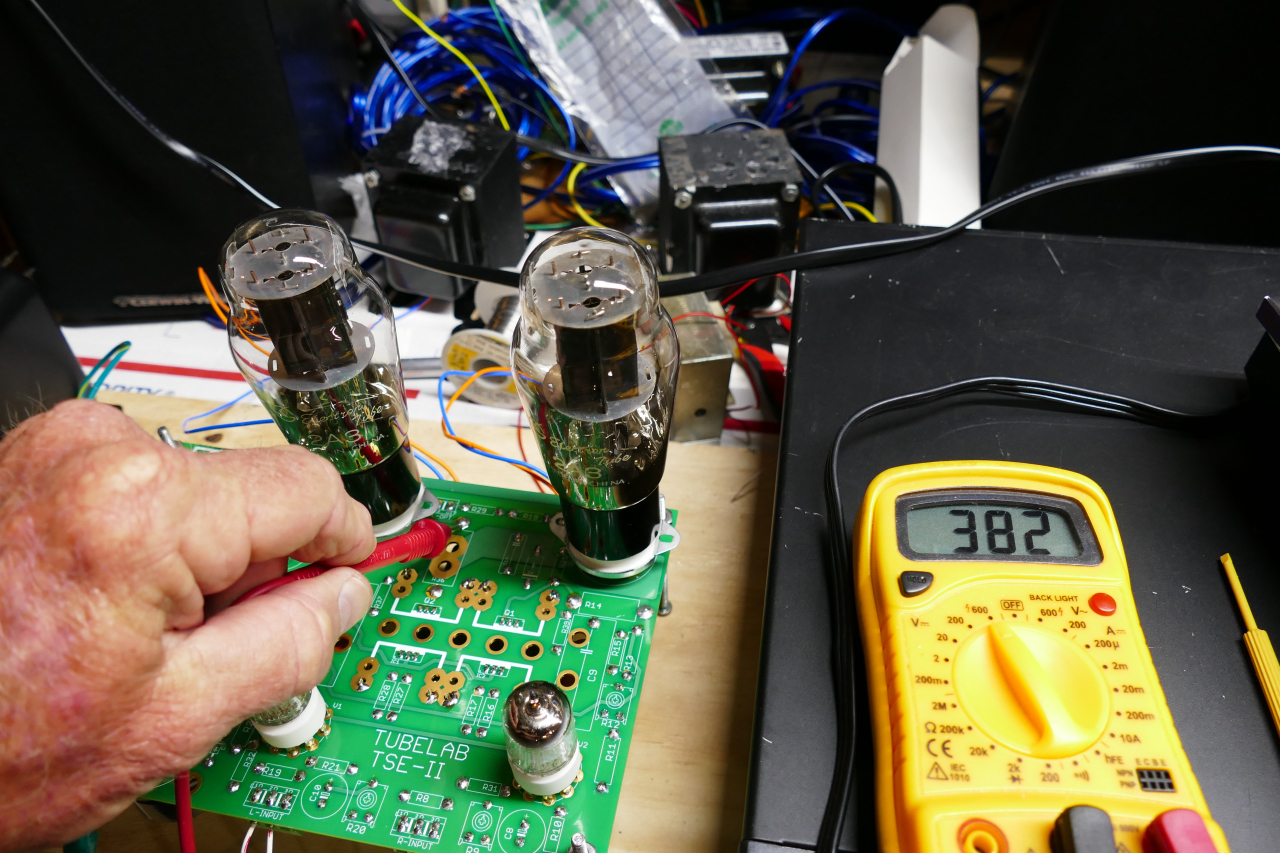

I got bored with the status quo a couple of hours ago and cranked the Variac on the input up all the way. The line voltage going into the Hammond 372HX is bouncing between 128 and 130 volts on the 120 volt tap.
How much voltage can 20 year old Chinese 2A3's eat? B+ varies between 380 and 385 volts. Bias was set at 70 mA per tube. Ever see a blue glow on the glass of a 2A3?
How hot can that new filament regulator get? It's been too hot to touch for hours. 2A3's at high line voltage is worse case. Some supplemental heat sinking might be required with 2A3's in a poorly ventilated case. I am running just the stock heat sink at the moment.
