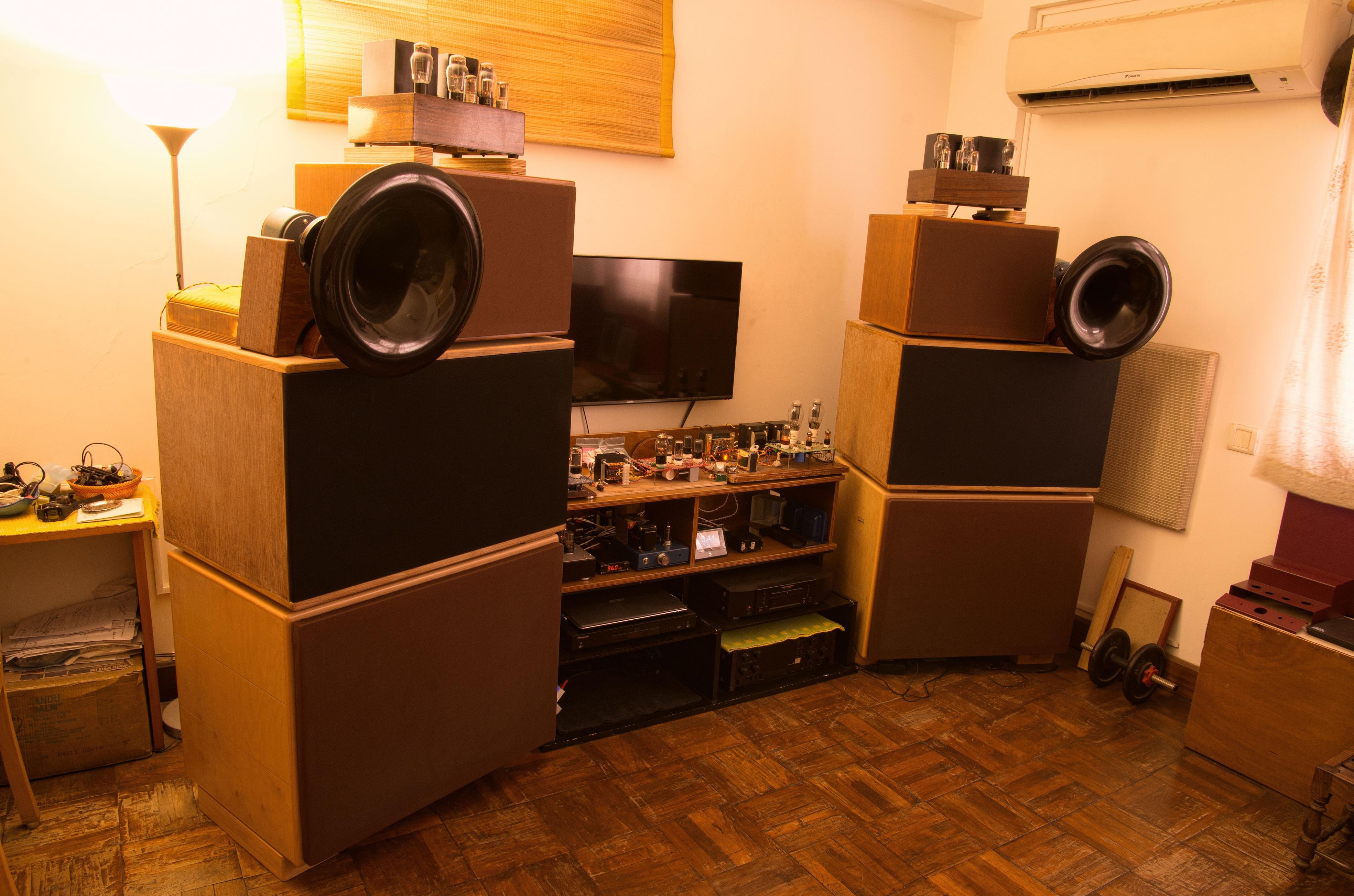

So, thats my rig. The TSE-300b's power the centre co-axial (Altec 604e) and the Brook 12A Monoblock's power the Altec 515 bass units at the bottom.
The air-conditioning is really close to the right channel. Was wondering if somebody could tell me if thats ok. The left channel does cool, but not as much.
Will this reduce life or performance over time ?
The TSE just runs warm.
I wouldn't put tube amp on top of speaker.
I've encountered some microphonic preamp tubes that would prove this point rather dramatically...
If it's up to me, I would move that dumbbell and put the tube amps there.
I see what you mean. Its a small room and pic is distorted because there's actually very little place near that dumbell.
I've had no problems with microphonics whatsoever. I tend to use neoprene a fair bit to isolate components and its done a decent job with the vibration near the amps on top.
The AC is my biggest concern.
