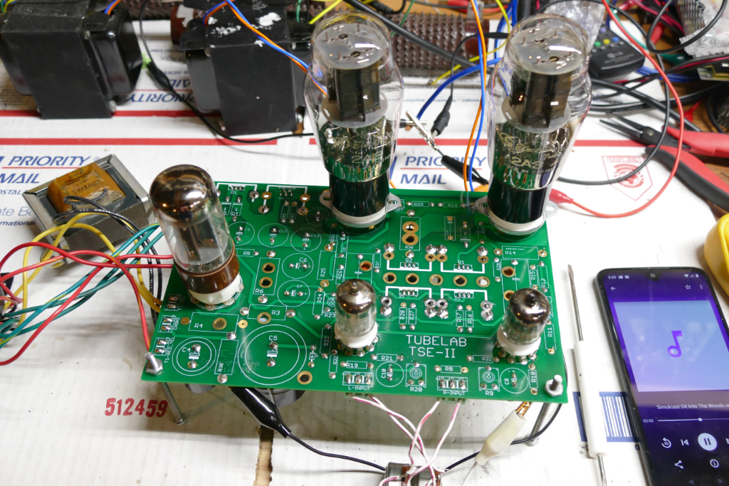

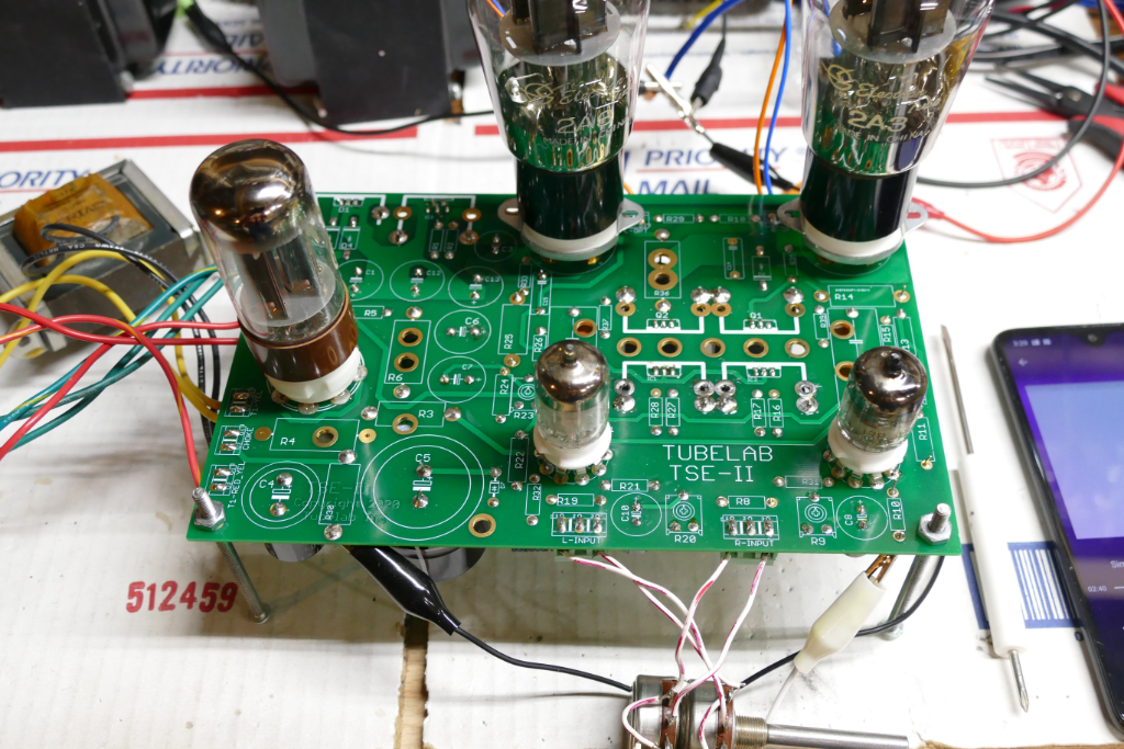

I just received my TSE-II board (thanks George) and was wondering if anyone has tried the JJ 2A3 in the board?
George: sent Paypal remittance for TWO each TSE-II boards
Oops, second Paypal for shipping, sorry...

I haven't used the JJ tubes specifically, but I'm currently using a pair of Chinese 2A3s in my TSE-II and have been very pleased with the results. They appear to be similar to the JJ tubes (300B structure with a 2.5V filament). I'd certainly give them a go.I just received my TSE-II board (thanks George) and was wondering if anyone has tried the JJ 2A3 in the board?
Single Plate?
Does "300B structure" mean that these tubes are SINGLE PLATE?
On one hand, makes sense that they would use 300B internals, OTOH single plate 2A3s are historically as rare as hen's teeth (or cheap 300Bs). I did see some current production singel palates 2A3s years ago, but they were very high priced and rare...
I haven't kept-up with current 2A3 production, but I'd certainly be willing to try 2A3s again IF they were indeed single plates.
Thanks for responding. Looking at the plate structure, it pretty much looks just like their 300b, hilariously. OTOH, I ain’t buying NOS 2A3s....or even low testing ones. In any case, I think the JJ is a decent product that is supposed to sound very good.
I have other large envelope SET amps and I can get NOS for those much cheaper.
Greg

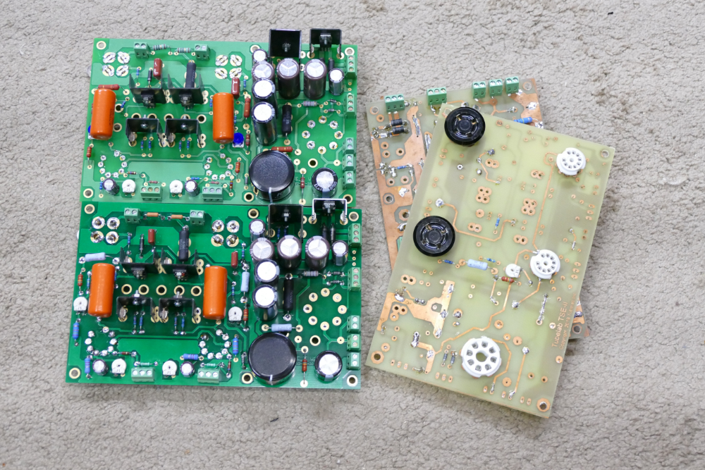

The new vendor's TSE-II boards arrived Monday (see UPDATE 3-18-21 in post #1). The new boards are a bit darker in color. That is the only visible difference.
Top board is old one, bottom is new, to right are old proto board stripped of most parts.
I have built one by stealing known good parts from two old prototype boards to save time. Testing will start soon.

It's alive!
These are 15 year old Chinese twin plate 2A3's running a smokin hot 80 mA on 360 volts. Good for 5 WPC.

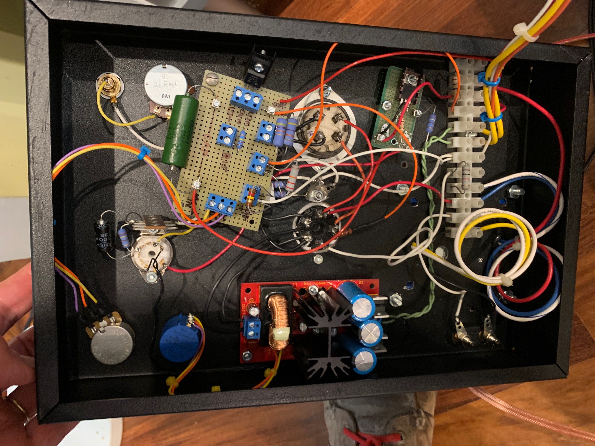

The whole 46 project got sidetracked when I tried a EH 300B in the Simple 45 Clone, but thru the BIG Edcor SE OPT (25W CXSE)
I usually don't spend like that ($100 tube +$100 OPT per channel, not to mention the 5842), but I accidentally had everything in stock for some reason or another.
BAM! as Emeril would say, everything just came together. Deep bass, smooth as silk, and (most important) 'UGE headroom compared to every dinky DHT I've tried over the years/decades; 71A,45,46,2A3
Probably not as detailed or "precious" as the 45/46 family, but (if properly driven) the 300B fills the house. I mean FILLS THE HOUSE.
THEN, I added a MOSFET clone board so it's now a +/- credible TSE-I clone. Not a gigantic difference, but noticeably better.
In my mind, the most important things about George's evolved TSE circuit are:
(1) an adequate (single stage) driver for the 300B (ie 417A/5842) although the current prices are killin' me..
(2) 10M45 plate load; works great where ever I try it (including on top of 6SL7 for a 6AV5 SE amp), and of course simply MAKES the SSE what it is
(3) Regulated DC filament supply. This has been a revelation after spending YEARS chasing HUM with a balance pot..
(4) MOSFET coupling; I'm not convinced that this rises to the level of the other improvements, but it's not expensive and does seem to give some headroom UMPH. Probably wasted on me with my old-man musical tastes...
See the photo. Note:
(a) Pete Millett Fils P/S, analogous to George's on-board filament P/S
(b) big&crude MOSFET "coupling" board (ie between driver an 300B), and
(c) tiny CCS (10M45) at the wrong end of the chassis, don't know why
(d) deck pot for bias adjustment
Based on this implementation, I ordered a couple of TSE-II boards (which I'm using for Mono Blocks, and will order a couple more once George gives the thumbs-up on the Chinese sourced ones.
