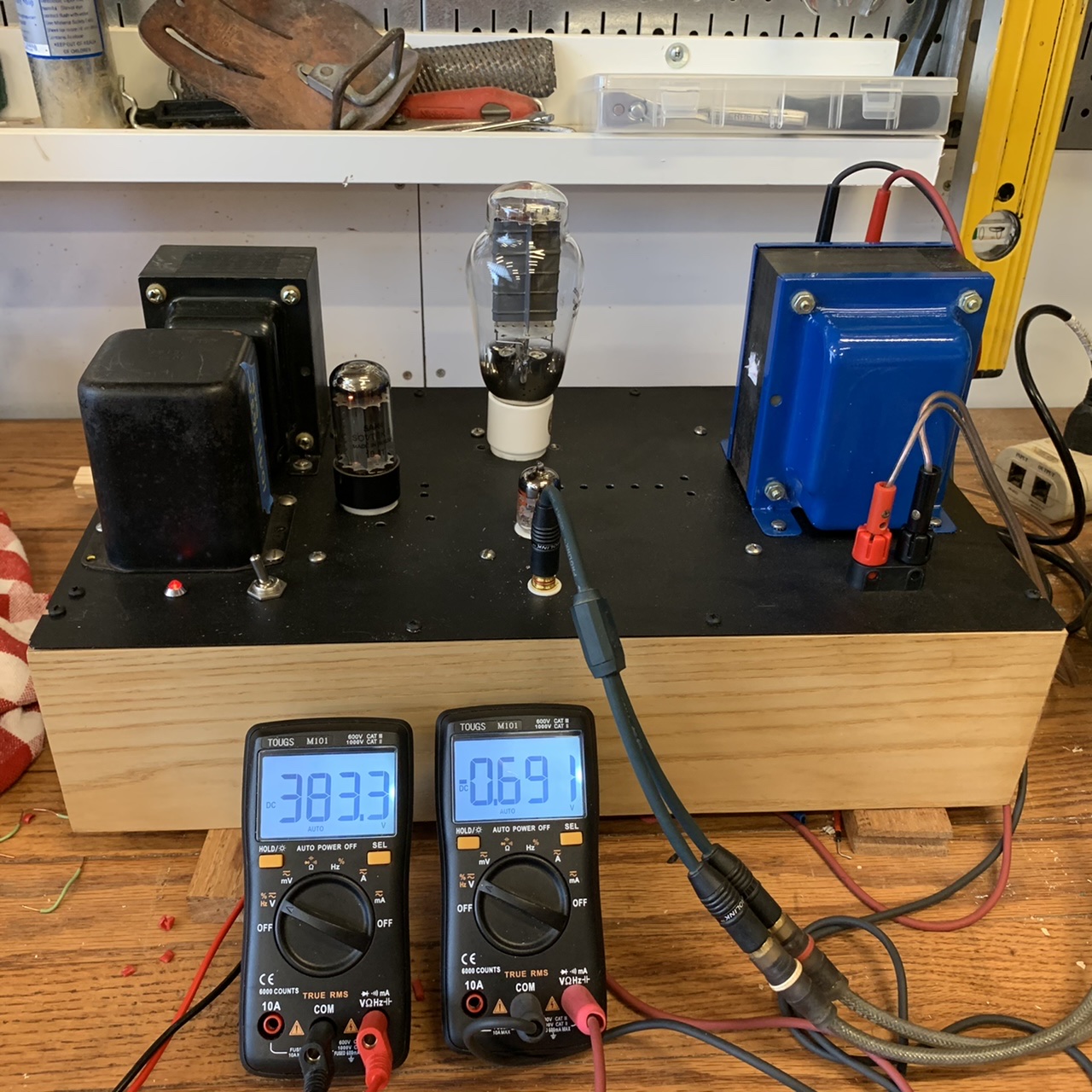

It’s ALIVE! TSE-II 300B Mono-Block #1
Sorry for the GIF; just wanted to take a look at Terry Garr again..
With a tiny amount of tinkering, mostly due to the MONOBLOCKnature of the beast (e.g. ~6.7 ohm resistor to get the 5842 fils down to 6.2 vdc, plus twinning the MOSFET “grid” resistor to ~36K, really 39K), everything biased-up nicely, first time. Always a SHOCK (the emotional kind) when that happens.
300B fils at 4.9something volts DC
5842 fils at 6.2something volts DC
B- span from about -35 to -183, which was nice
B+ about 350v with 5R4 in ST coke bottle for starters; switched to 5AR4 to get the numbers you see.
The EH 300B seems to like to run a little hotter, say 390 and 75 mA...so I’ll be tinkering.
PST is the ubiquitous 6K7VG, but with only 4uF Russkie OIP 1st cap; will likely raise that a bit. Obviously, it runs very cool in this application (for once..)
Choke is a Heathkit 10H, 163 DCR
OPT is the big EDCOR 25W at 5K
Right now, in the shop, have paralleled 8ohm speakers to try a 2.5K load; sounds quite good (and louder, of course) but this is a noisy, large volume space, so I couldn’t hear any degradation anyway...it does fill the 750 ft2 shop, plus some of the neighbors’ yards.

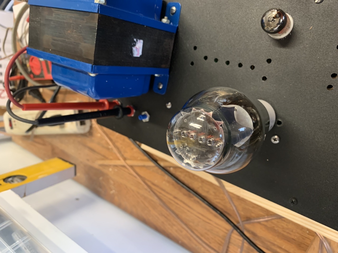

Note the external test points wired to either side of the 10 ohm 300B plate resistor., and the external 100k linear bias pot. The pot’s a single turn, and a little touchy; I’ll likely swap in a nice Bourns 10-turn like I use on regulated power supplies.
Pretty fast build, biased right up, sounds exactly like the Flexi-Amp TSE clone, except without the mild drift of the old Heathkit P/S..
Gotta tidy it up, then on to #2

Added an old French poly (polyester, not Polynesia) cap (4.7uF) across the 3.8uF Russkie PIO for a C1 of about 8.5uF, and the B+ came-up nicely to 390v at 75mA (~29W dissipation).
Pretty conservative compared to the OEM ratings:
but I think I'll leave it there for a while. This is about where I've run the TSE Clone for the last year.
Is ANYBODY running EH 300Bs over 400V and near 100mA? Just curious.

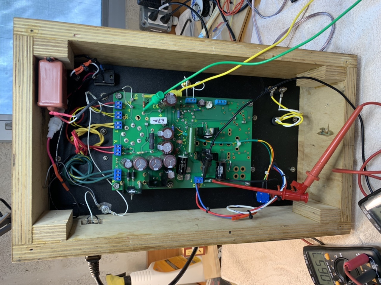

Well, apparently I brought the bad Gri-Gri upon myself by mentioning the DRIFT of the Heathkit regulated Power Supply.
Moved the mon-block inside to the Music Salon (snort) and left a meter on the bias test points.
After about 1-1/2 to 2 hours, the underside of the chassis is hot enuf to cause the bias to drift steadily upwards.
Note: components are UNDERNEATH the board.
The Good News: sounds terrific around 100mA.
The Bad News: not likely to sound good very long if the bias keeps drifting UP & AWAY.
I DO NOT have lots of ventilation holes; will yank out the board and "install" lots more tomorrow (when doing the multi-turn bias pot).
Any suggestions on improved Thermal Management? The Index Finger Pyrometer puts most of the heat (a) over the MOSFET (b) over R36.
The existing vent holes are directly over the vent holes in the board; I'll enlarge those, plus add more, particularly around the periphery.

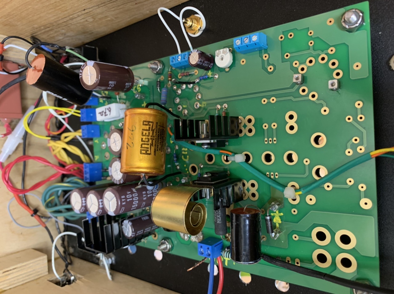

The ONLY anomaly in the circuit (other that the small C1 in the power supply) is that the MOSFET "grid" resistor (R25) is ~39K instead of the recommended 36K (for B+ 350-400V); I didn't have a 36K 3 watt, so have 2 x 20K 3W in series, measured at 39K.
Don't know exactly WHAT is getting too warm and allowing the bias to creep-up slowly.
(a) regardless, with so much hot "sand" under there, we need more ventilation.
(b) if R-25 (MOSFET voltage-setting "grid" resistor) gets too hot and "drops" resistance, would THAT increase bias current?
(c) similarly, could it be the MOSFET itself? Perhaps a supplemental heat sink?
Suggestions gratefully accepted.

BIAS DRIFT Repair Plan
Today, I'll pullout the board, and
(a) drill more/larger vent holes
(b) check/redo the heat-sink attachments (possibly add thermal "grease")
(c) change the MOSFET "grid" (voltage-setting) resistor (R25) back to 36K
(d) change bias pot to 100K linear 10-turn Bourns
While I've got the board out, is there anything else I should be doing
(1) larger heat sink for MOSFET?
(2) REPLACE the MOSFET?
(3) Higher wattage resistors?
Any suggestions welcome...

Before you go crazy with holes, larger heat sinks might solve all of it. When that doesn’t work, I resort to my weapon of choice: a large heat spreader, i.e., the top deck. I mount all of my devices if possible to the top deck and use it as a heat sink, which in your case will require some rework. You could just do them on short flying leads.
I’ve also just mounted large copper sheets to the inside of my boxes (if made from wood) and mounted devices to the sheet.

Wandering bias, continued...
Back together after a brief trip to the chiropractor ( the TSE, not me).
R25 is now just under 36K.
Bourns 10-turn bias pot installed. I love these things..
Replaced the MOSFET OUT OF AN ABUNDANCY OF CAUTION, plus added a “supplemental” heat sink made from a curlicue strip of brass shim-stock.
Though I had another tall Heatsink, but they were wrong pin-out..
Using my 20-year old faithful (and well-abused) EH Gold 300B, the bias upward drift is still there, but APPEARS to have showed considerably. Looks like we may be close to reaching a Steady-State after about 45 minutes.
The Bourns 10-T pot is adjustable to THOUSANDTHS of a voltage (across the 10 ohm plate resistor) which a pleasant (if inherently false) thing.
Adjusting bias to 65 mA; plate stays pretty constant around 392 vdc.
IF it does actually stabilize, then it will be interesting how long it takes to warm-up to Steady State on start-up (and what the initial bias will be).
Clapton Unplugged “Walking Blues” playing now, loud, and as good as I’ve heard it. I can hear the slide across the bass strings. Yikes.
The 300B TSE definitely seems worth the pound of flesh it has cost so far...
We definitely got an asymptotic-looking function going-on over here.
Gettin’ close to steady-state at just over an hour....
PS measuring bias with the inputs turned-off but not disconnected...
The minute I started playing Cool Jazz (Jazz @ The Pawnshop) the bias cooled-down a couple of milliamperes, and is just sitting there (snapping fingers, I assume).
Coincidence? I Think Not.
Looks like it has +/- reached a steady state at ~65 mA and ~390Vp, give or take...
Next step, honking big (tall) Heatsink that will fit the board.
Since I’m only using ONE CHANNEL, I wonder if I could “thermally tie” to an unused Heatsink for the other channel...hung...

Right now I am struggling with wandering bias which APPEARS to be caused by HOT MOSFETS. I think I’m about halfway to a solution, but it has taken DAYS of tinkering with no “support”. No worries for me (a crusty old pensioner), but the TSE was never intended as a plug & play project.
