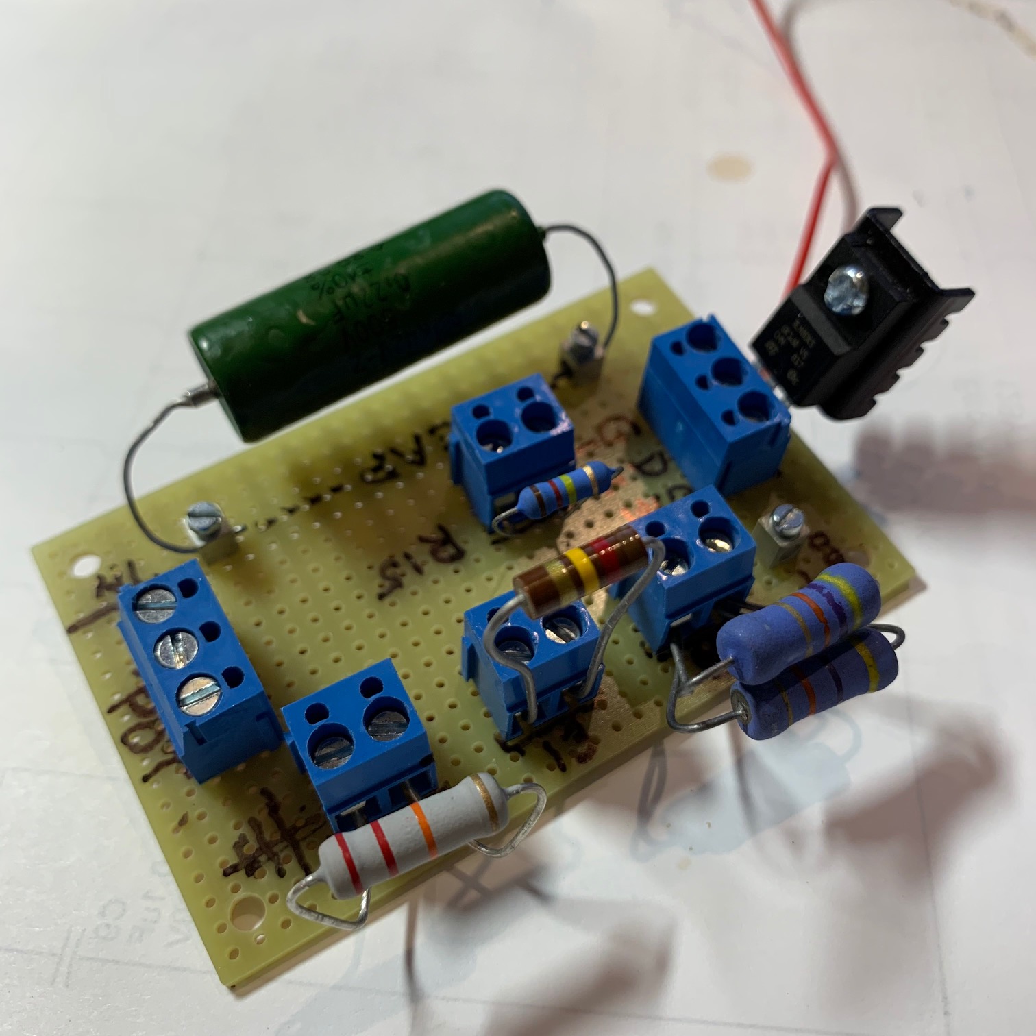

I'm slapping together a little "coupling" board with screw terminals for
(a) MOSFET
(b) bias resistors
(c) coupling cap
that I can install between the 5842 and 300B.

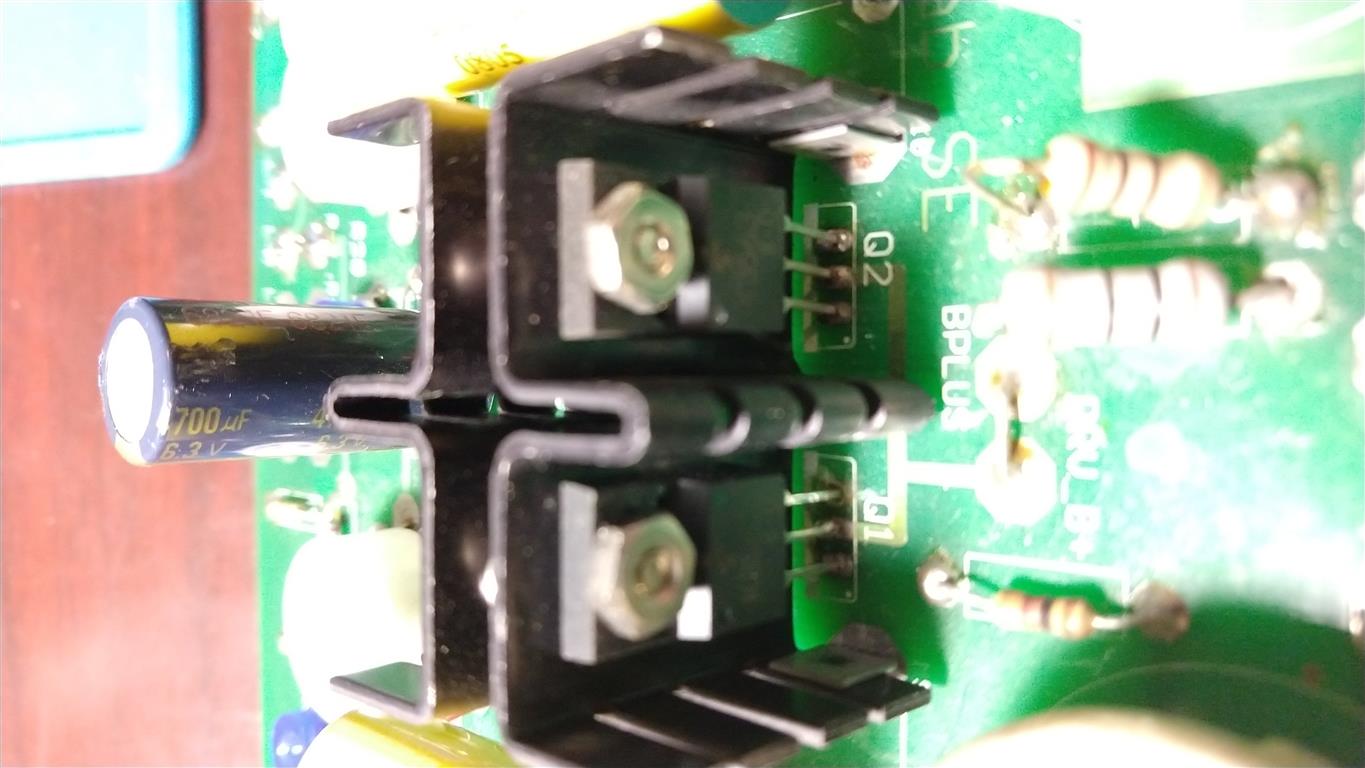

One question: it appears that the MOSFET middle pin (DRAIN) goes to B+.
Is that correct?
I derived that from a shot of the PCB in the assy instructions in which the middle pins are clearly tied together, and B+ is the only thing common between the two MOSFETS, but wanted to make sure...

PowerDrive Board
A quick prototype Power Drive Board.
Once I get the resistor "ladder" adjusted (e.g. so that the 100K pot is in the middle of the range for ~70mA), I can do another smaller board...

Point-to-Point 300B TSE Mono-block Update
I installed the “coupling” board (above) with the recommended resistor values, that is:
Grid resistor: ~32K (5/6 of the recommended 36K for 400V B+, as Heathkit maxes-out at -125vdc bias).
Voltage divider, top-to-bottom: 130K / 100K pot / 22K to ground.
Pre-MOSFET grid resistor: ~120K
MOSFET is STF3LN80K, for the record.
The poor little power supply would bias to ~70mA or so, but would only get to about 260-270vdc B+ with the bias pot cranked to 11. Clearly, sucking too much potential down the drain.
Changed the voltage divider resistors to, top-to-bottom: 47k / 100K pot / 100K to ground; essentially inverted the voltage divider. Did NOT change either “grid” resistor (pre- or post-MOSFET)
This time, biased right up at low 70s mAs; volts across the 10 ohm plate resistor agreed with the Heathkit milliammeter with B+ just shy of 400vdc.
C- is spot-on -100Vdc.
I believe that I could get the bias voltage up to (that is, DOWN to) -125vdc by further increasing the resistance below the pot, or maybe reducing the pre-MOSFET grid resistor, but it sounds so gooood right now I ain’t touching it for a day or two...

That No Tinkering interlude didn’t last long.
Got under the chassis and installed the original voltage divider resistors, but inverted: 22K top / 100K / 130K to ground.
Now it biases-up at 400vdc B+, 70 mA, with the 100K pot exactly in the middle of the range. However, the C- supply is still at -100Vdc.
I suspect l’m heating-up the pre-MOSFET grid resistor unnecessarily.
Next incremental step, I’ll try dropping that resistor in stages to reduce the bias current, which should bring the C- up above -100 (than is, a higher negative value).
Any comments?
