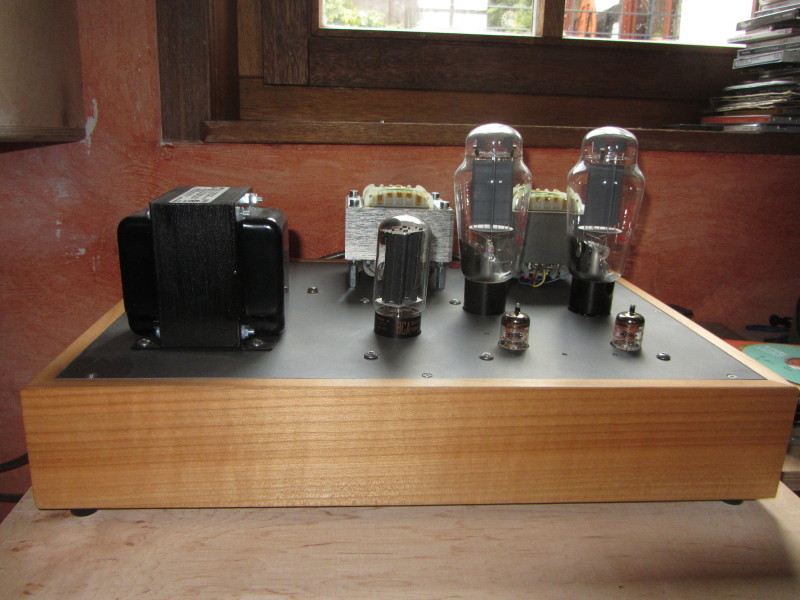

For years I have been planning to build a 2A3 power amplifier, had studied many different circuit designs but never started to build anything until George presented his TSE II.
Now it has been in operation for a few months and I am very happy with it.
Thank you George for sharing your knowledge and experience with us!
