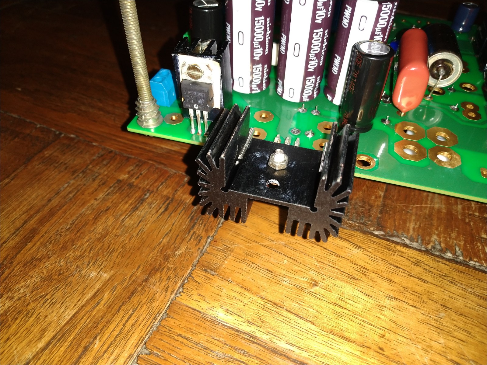

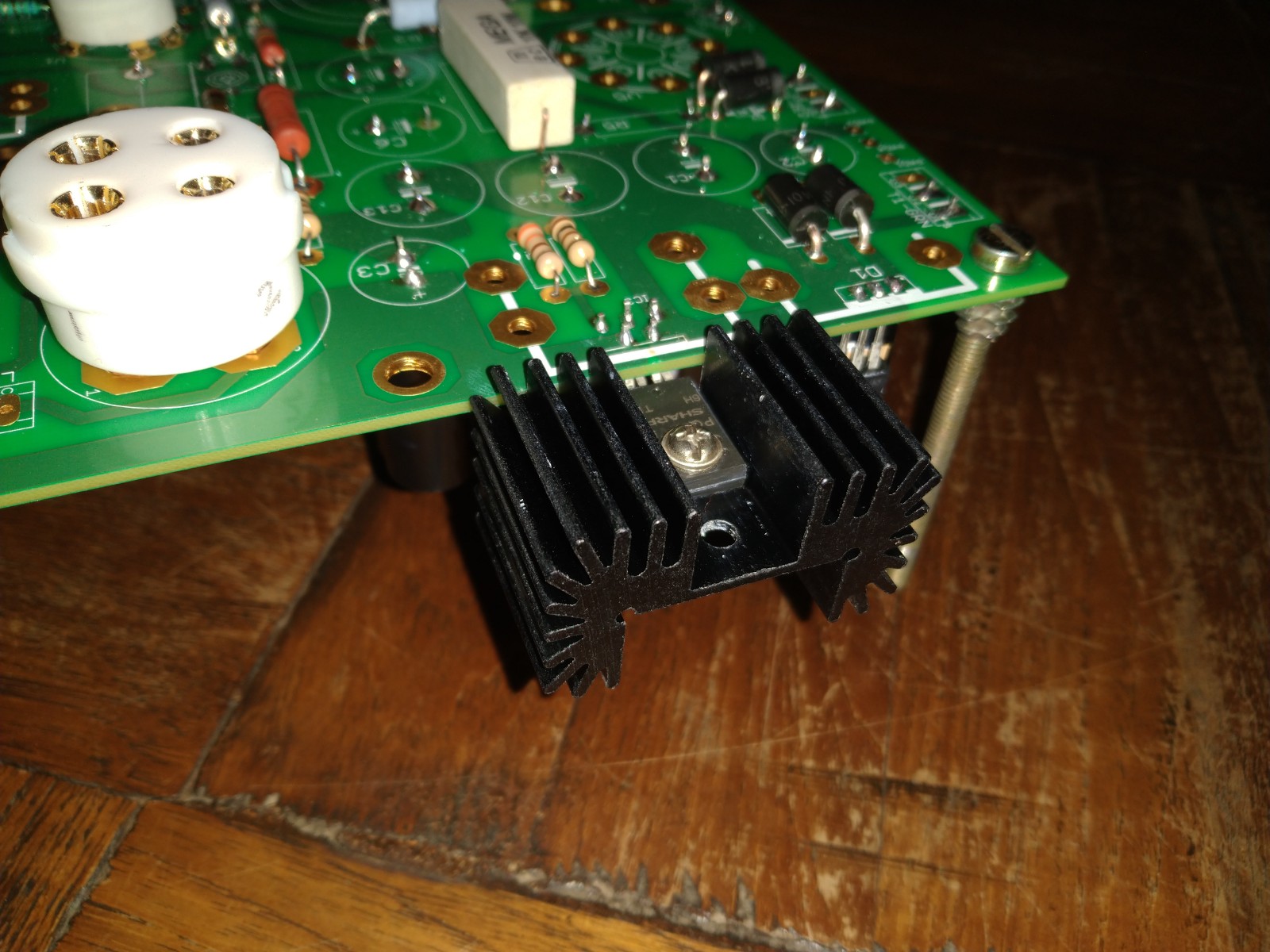

Fixed the regulator and made a L-brace of sort for the heatsink. The regulator is not directly attached to the heatsink. Will this work ? Should I look at some other way to heatsink. Not sure if this is a good idea or if it will even work.
The HS is 1.5" x 1" and 2.5" height. Can someone please comment ?

The general concept looks workable, but the "L-Brace" needs to be thicker and aluminum to be able to conduct the heat from the regulator to the heatsink.
It is just a gut feeling, but I would make it from 1/8" or thicker material. Also make sure that the surfaces at all of the contact points (regulator to L-Brace and L-Brace to Heatsink) are as flat as you can get them and put the required electrical insulator pad thermal paste at the joints to promote heat transfer. Also I am assuming that the weight of the heatsink will not be permanently supported by the regulator.
Thanks csample. I had the same doubts on the contact between the HS & the brace. Decided to try another HS. When the board fires up fine,
I will solder a support from the HS back to the board, right now its hanging of the regulator.

Anyone else see the obvious problem in Sunil's board?
The board is a TSE-II, but the regulator chip seen on the heat sink is a Sharp part for the original TSE board. These are not pin compatible, nor completely electrically compatible. The TSE-II board should use the Microchip MIC29502WT part as listed in the BOM on the first page of this thread. Several other parts, mostly resistors have changed in the new version as well.
Note, that someone who knew exactly what they were doing could probably make the Sharp part work in this board, but it would take some work. I have not tried this, but I did make the new Microchip part, and several other possible choices work in the original TSE board during the early testing of the new design. It did involve a bit of lead bending and shrink tubing.
It's a TSE-II. The Raytheon 5842 is the obvious give-away. SSE's only have one small heat sink, and the board will work without any heat sink at all, but the chip may fry in a hot closed box environment. I had one unsolder itself early on. It was still alive and is still working today.
Thanks George. I completely missed the Sharp part as being incompatible in the TSE-II. The resistors and caps are what was in the first page BOM. 🙁
What a bummer !

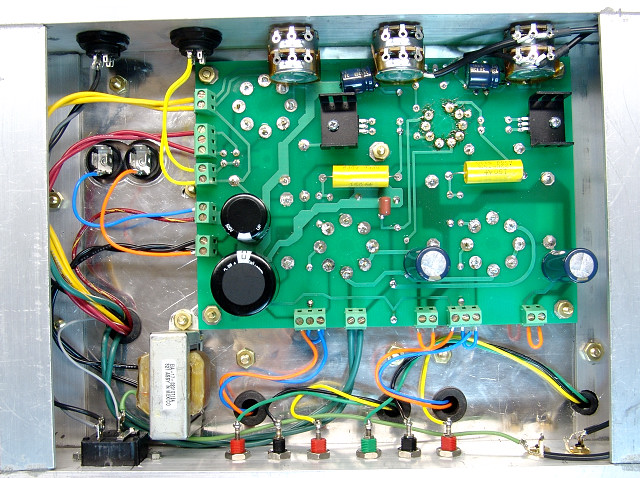

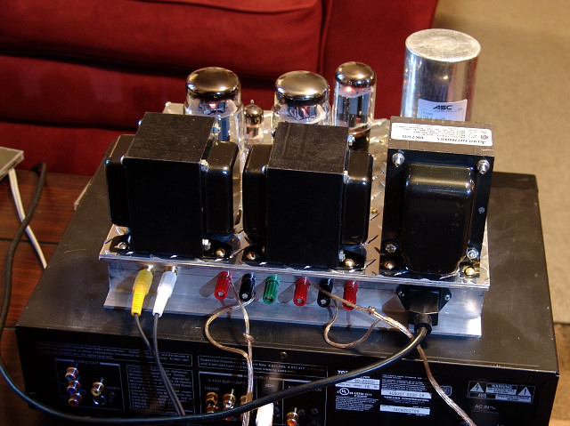

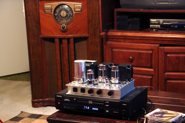

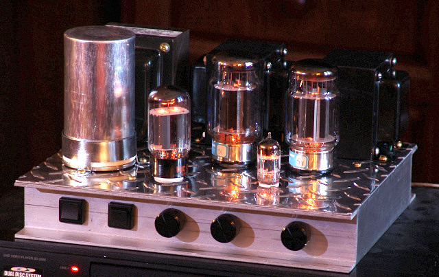

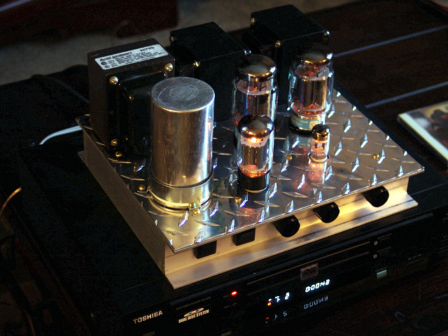

Here is an example of what NOT to do. I built this SSE in 2006. It was the first one I built into a chassis. It has worked flawlessly for 14 years and served as the amp for my "computer speakers" for about 3 years. They were Yamaha NS-10's and my computer also had full MIDI and audio recording capability, guitar, microphone and keyboard inputs, and even a turntable connected to it. This amp was on whenever my PC was on, even if music was not playing.
The SSE ran KT88's and got HOT. The power transformer would be too hot to touch after 6 or 8 hours, yet the amp never faltered, and still had the same tubes in it when it was packed up to move in 2014. Unfortunately is was dropped during the move, and looks rather out of shape today....but it STILL WORKS! The PC board is a bit discolored though. This is the amp where one of the 10M45's unsoldered itself.
Note that when placed on a flat surface there is no place for any heat to escape the box. The cathode resistors alone generate about 8 watts of heat.

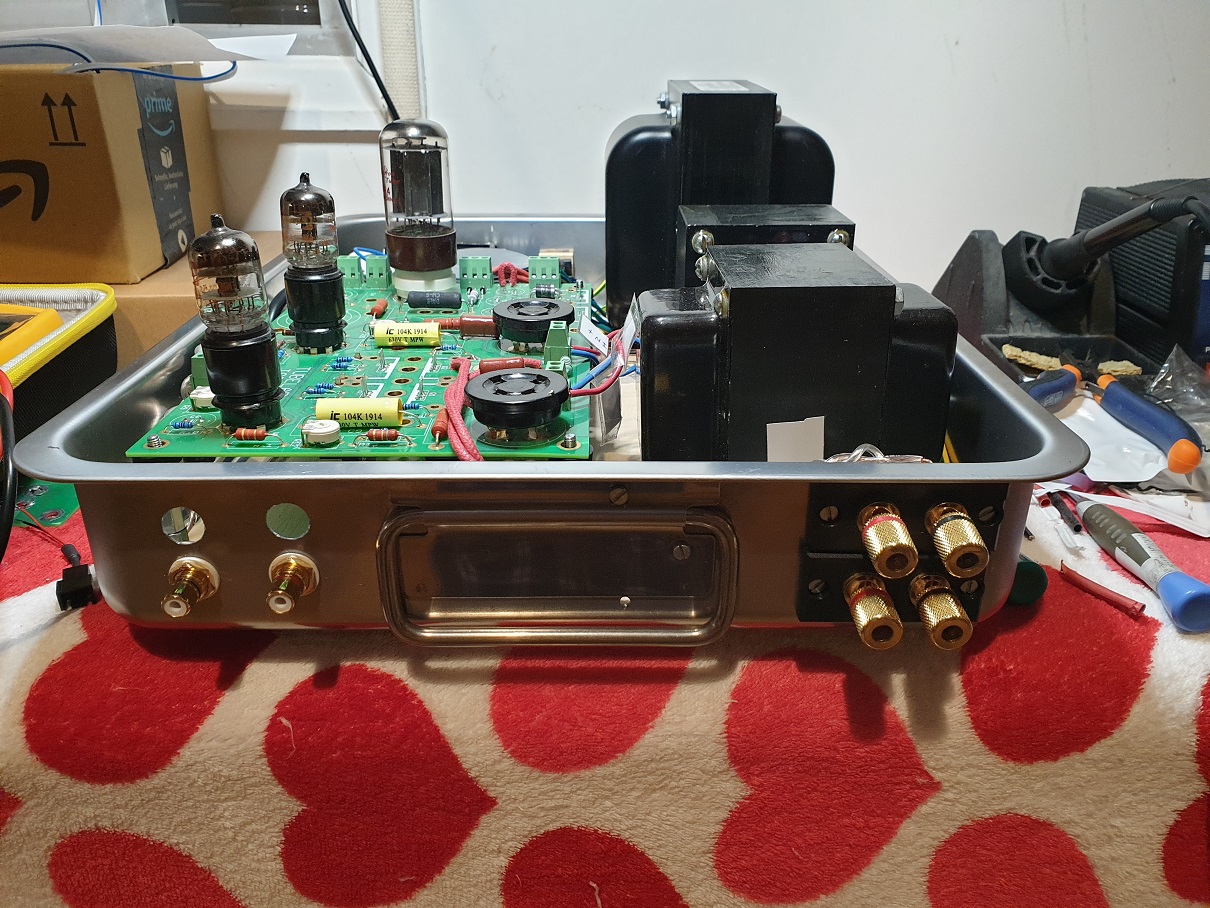

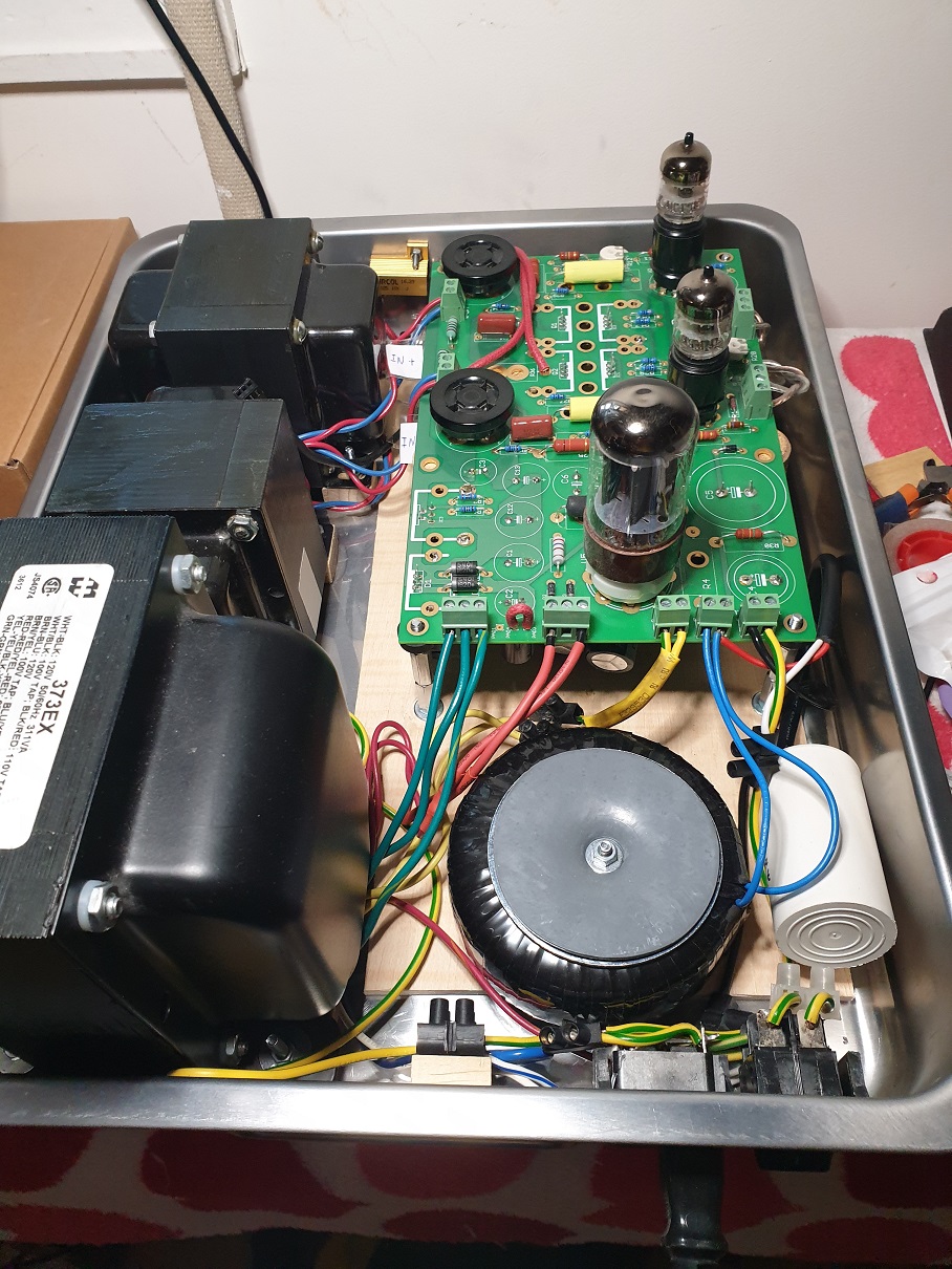

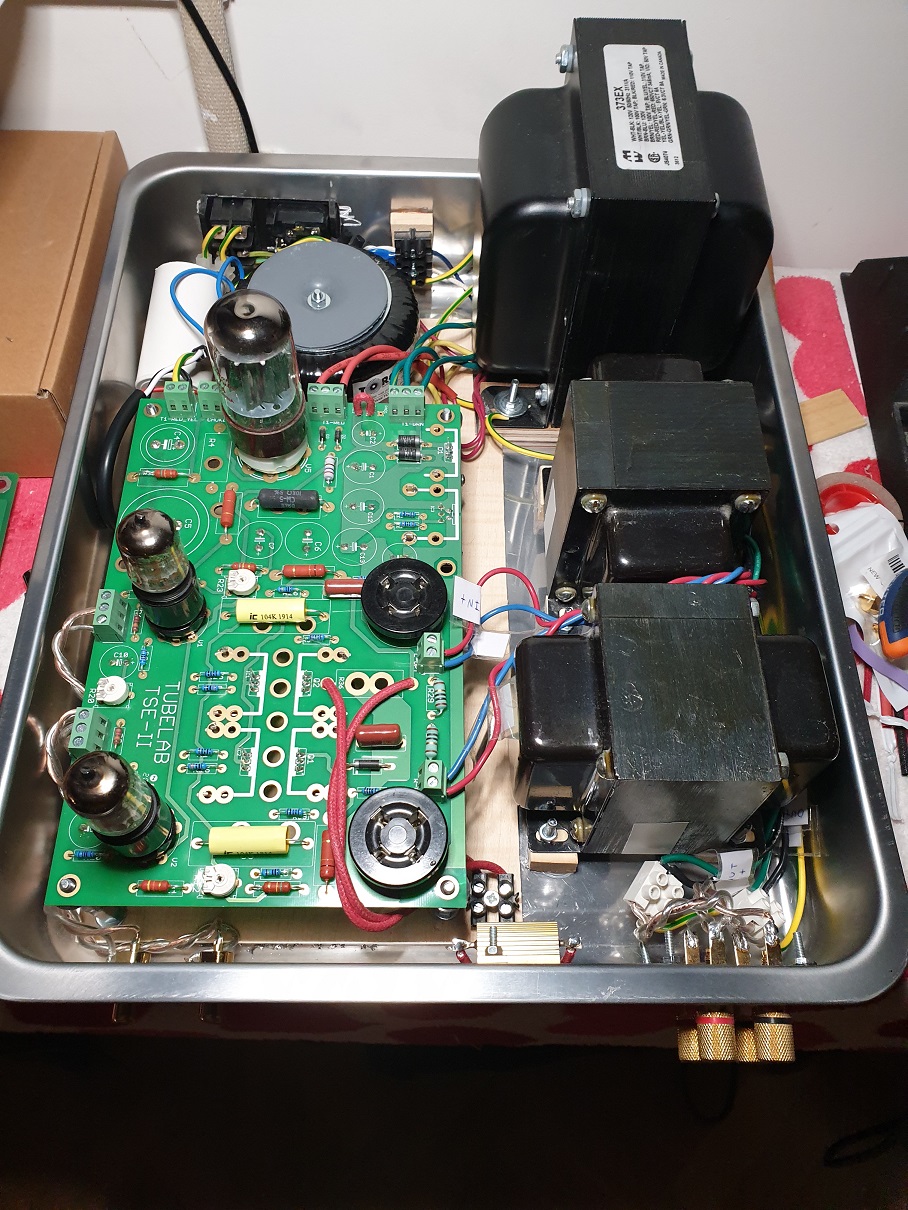

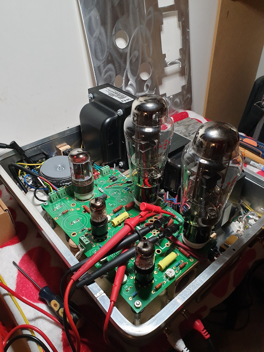

Happy to report a new TSE-II is up and running.
Some photos, details and a couple questions :
300B – Emission Labs
I can say now they sound warm, detailed, super easy to listen to.
B+ (R30) : 415V
5842 plate : 175V
300B (R29-R18) : 83mA
R36 gets really hot….
Using a nice little fan near Q1-IC2, don't know if would be better near D1-IC3
As for the case…I like to use Ikea trays (photo attached)
Checkout : pdf attached (hope helps)
Questions :
1) How mandatory is 175V on 5842 plate? Could be 173V? Could be 178V?
2) Today I’ve seen the bias on one of the 300B (R18) change from 80mA to 50mA some seconds. Is this normal? What may be?
3) Where would you put the fan?
4) Would you think this little voltmeter would be OK to put outside the case to check bias? Any other suggestion?
GWUNW voltimetro digital BY536V 9,9999 (10V), 5 bits, medidor de prueba de voltaje de alta precision|digital voltmeter|dc digital voltmeterdigital dc voltmeter - AliExpress

cool looking build!
As far as the voltage on the driver tubes, george has said in the past that the voltage doesnt need to be exact. On r36, im also running a remote mounted resistor that is bolted to the chassis to help it disipate the heat it generates. Havent had any issues after lots of use.
