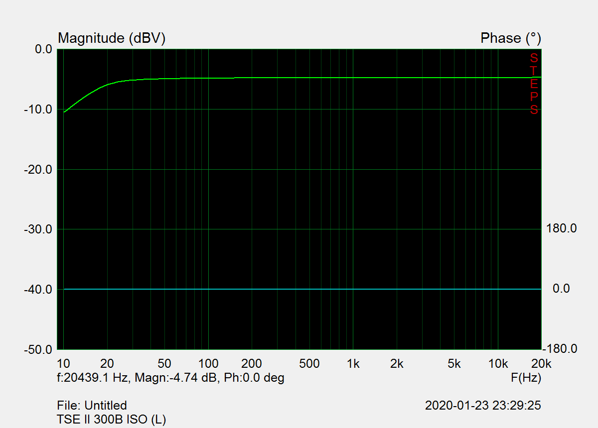

Have my 300B amp up and running now for a few weeks. The detail is very good but it seems to emphasize the higher frequencies to the point of being schril. I have it running through an old Nikko SS preamp. That sounded the best out of the three I tried. Have the treble way down and the base up, but the high notes are really hot. Speakers are 96db Sonist Audio. Any suggestions where I should start to look for solutions?
Okay maybe this is obvious but is it surely the TSE and not something else like speaker positioning, the preamp, or source?
If you have a sound card analyzer, you could run a frequency response plot and see if indeed the curve of the TSE is tilted up.
Which 5842 tubes are you using? I found some subtle differences between Amperex Gold Pin, Raytheon 5842 and Western Electric 417A.
Which output transformers ?
And... what is the source?
EDIT: attached is the FR with Gold Lion PX300B tubes... pretty flat.

Before this amp I was using a Jolida integrated with EL35s. Sound was very good, no shrill to it. Put the TSEII together and tried: first a custom switch box with just input switch and volume. Couldn't any volume out of it. Next tried old Easter Electric Mini Pre but that has problems I need to fix. Then used the Nikko pre and that sounded the best of the three. Yes the preamp might be part of it. I will have to hunt up another to test that out.
5842 tubes are Raytheon. Source is DVD and Vinyl.
Output transformers are Eletraprint SE 3k @ 100ma.
I can't remember what the B+ volts were or what I set bias at. I will hook up multi meters tonight and check them out.
The only rectifier tube I could get on short notice was a Groove Tube 5ar5 at the Guitar Store. I could try a better tube there.
At this point it would be hard to pinpoint the exact issue.
If it were me, I'd try to rule out as much variables as possible.
Starting with the source, if you have a cellphone or small portable player you can use that as your source/preamp (assuming it has volume control).
I recall that if the 300B is under-biased the sound can be shrill, so I would double check where you're at. Depending on your B+, that could be anywhere between 60mA and 90mA.
Also double check the 5842's are set at 175V.
If all of that checks out, then could be a speaker impedance mismatch. If your speaker impedance is mostly below the tap you're connected to, you'll have less than 3K at the 300B which is probably not optimal.
