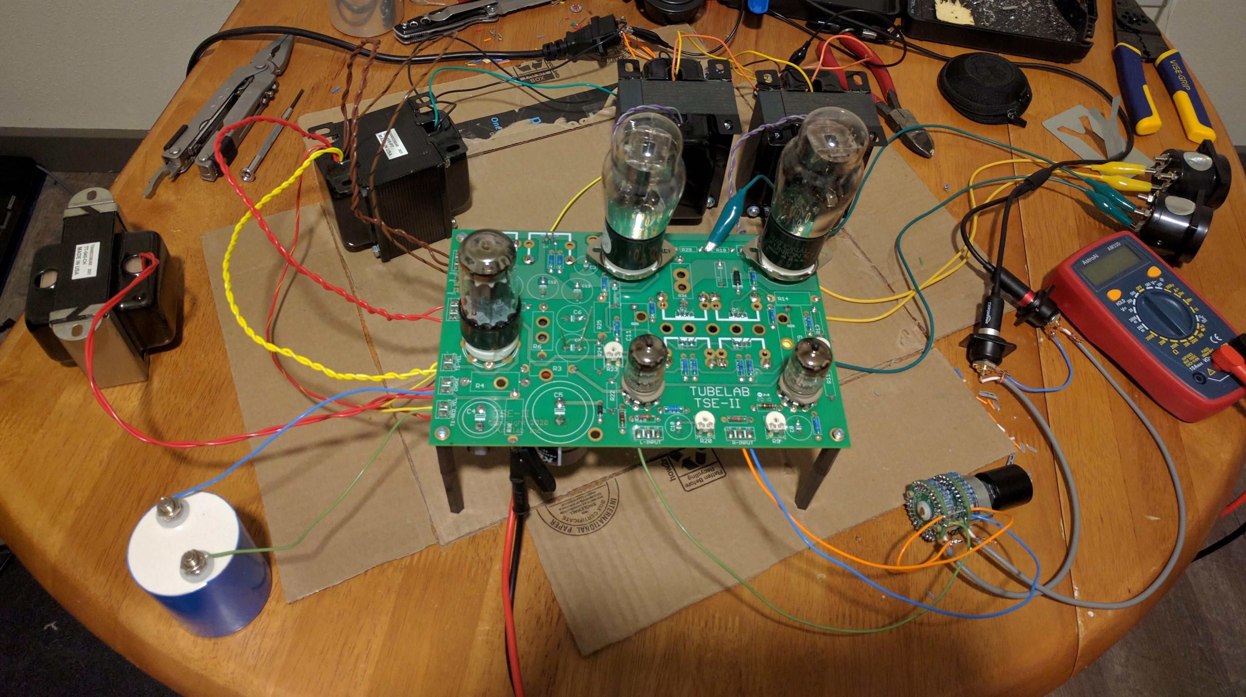

I ended up sticking with the standard layout. So all the tubes are where they're supposed to be. Here's some pics (shown is the standard CLC filter iteration with auxiliary cap):
I'll read that article you sent and see if it gives me any ideas.
Did you switch out the 5842 tubes?
Try the amp without the 5842's. If the hum remains, they are not the problem.
It is possible that the filament regulator is on the edge of dropout, especially if your line voltage is on the low side. How much voltage do you have across C1, C12 or C13 (they are all in parallel).
The hum is still there with the 5842's unplugged. So we can rule those out.
The voltage across C12 is 3.68V, and my line voltage is 124V AC.

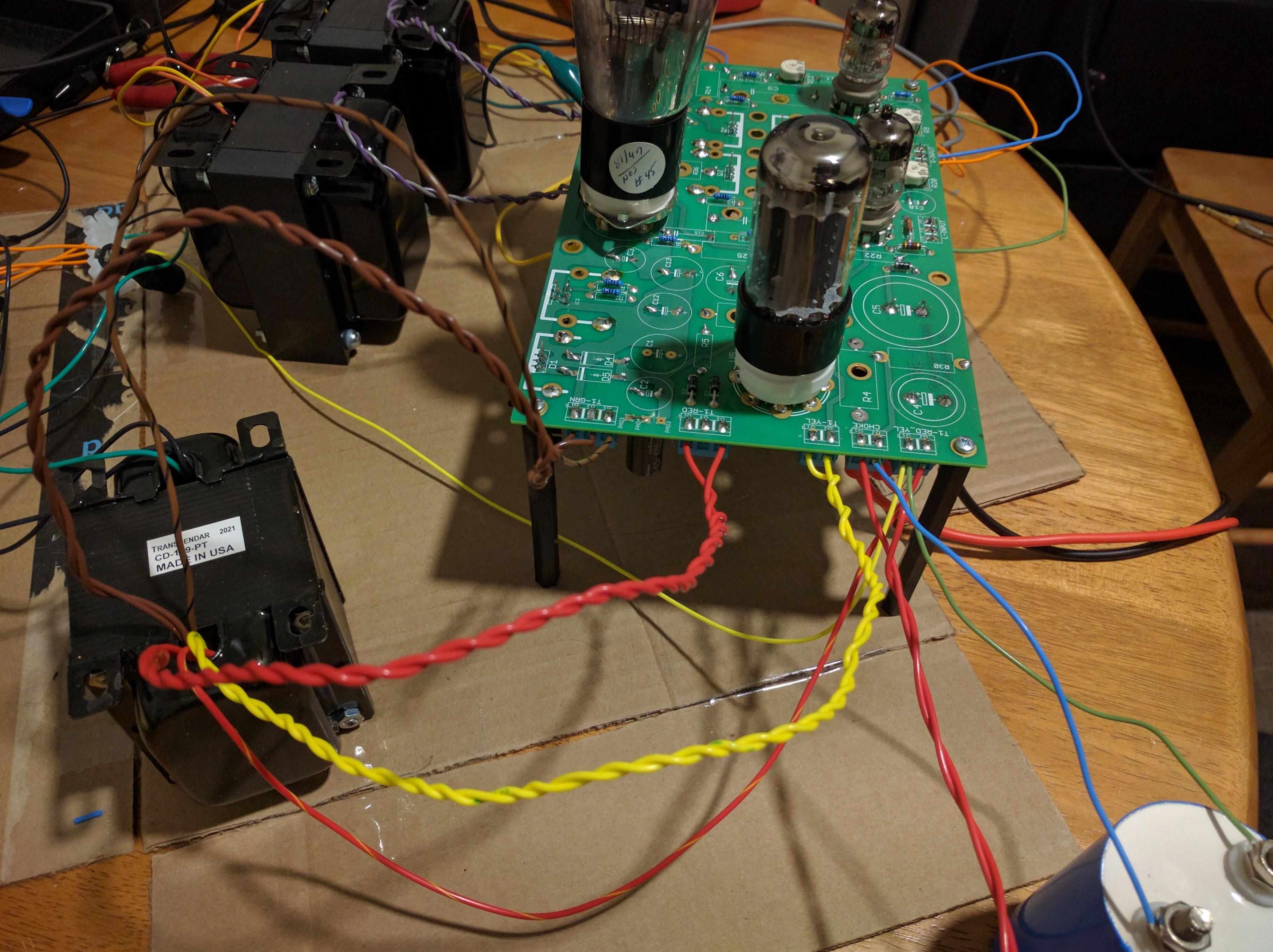

it might be my PT complaining about having too much current drawn from it.
I have built several amplifiers including my original Lexan TSE with a transformer that was too small with good luck except for the heat produced.
When a transformer is feeding a rectifier follower by a cap input filter most of the current is drawn right at the peak of the sine wave. The TSE and TSE-II are worse in this regard because two out of three secondaries have this type of load. This can cause the transformer to exhibit higher losses at the peak current point.
An oversized transformer is good in this case. I am using a Hammond 372HX on my TSE-II because I had one. It was originally intended to power TWO SPP boards at the same time, which it did just fine, but wouldn't work with my odd packaging scheme that I made for this amp.
The 372HX works good in the TSE-II with 300B's at about 385 volts, and 2A3's at about 380 volts (way over spec). The increased filament draw is the reason for the 5 volt B+ drop.
The 370FX should do fine with 45's.

Still no volts at C11

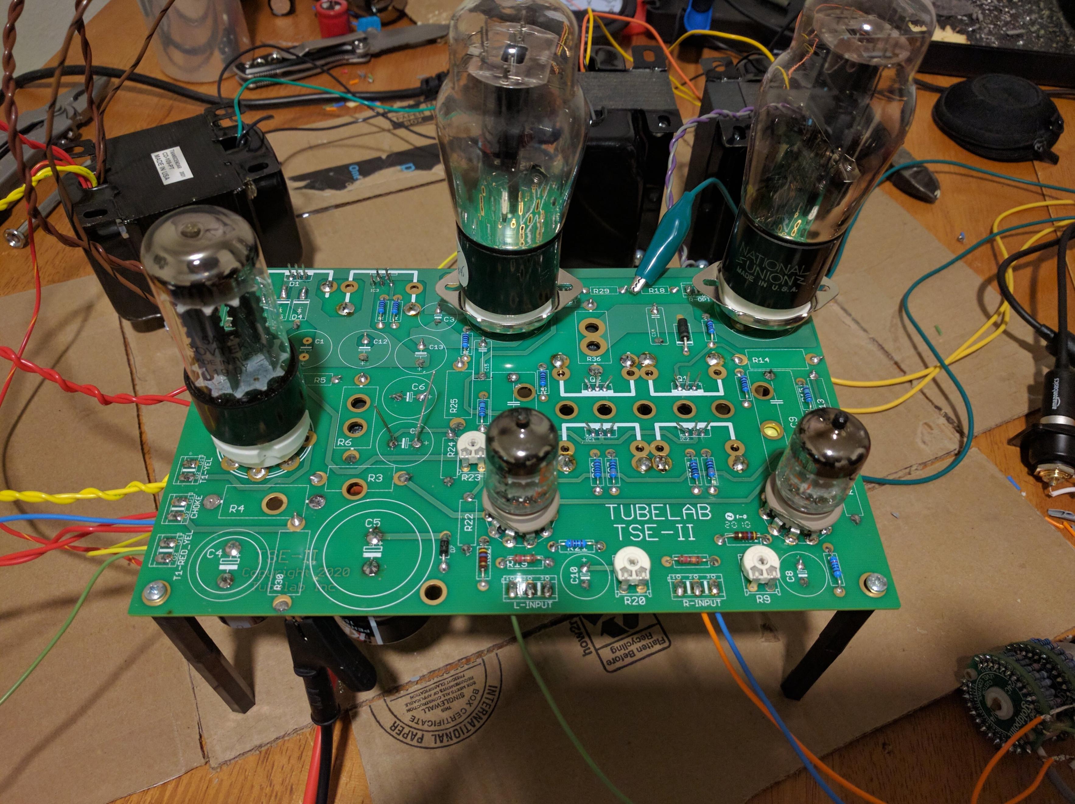

It's me again. I had no voltage at C11. I started tracing voltages from the IC's (both channels) toward the c11 and c9. Right off I found that IC1 had 419 v at A but nothing at S & G. IC2 had 419 v at A and 211 +/- at S & G. I took an old IC from my TSE I board and tried it but got same result, but I know it is easy to short out these ICs so that one may be bad also.
I'll order a couple of new ICs (one extra) and see if that solves the no voltage problem.
OK, you have the right voltage going into IC1, but nothing coming out. The voltages are even low without the 5842 tube (post#787). There are three likely reasons for this. A bad chip, R27 or R28.
I looked at the picture that you attached in post #790 and it looks like R27 may be the wrong part. It should be 330 ohms, orange-orange-black-black-brown. Yours looks like orange-orange-black-orange-brown, which would be 330K. This would result in very low voltage coming out of the chip.
I can't tell if the colors are correct on R16 in the picture, but it should also be 330 ohms.

You were right George. That R27 was 330K I replaced it with 330 and I am now getting the correct voltage at C11. My eyes are so bad I can't make out those color bands very well. Now on the the next step. Thanks
I have my 300b tubes in and I get 400 B+ volts. What should my two volt meters be set to (Volts or amps) and what should the desired current be?
I have my TSE 300B at ~400V B+ and 70-90mA (there are tradeoffs for each setting)
To adjust it, you need your DMM set to measure Volts.
Since you are measuring on a 10R resistor, if your DMM reads 700mV, then your bias is set at 70mA.
