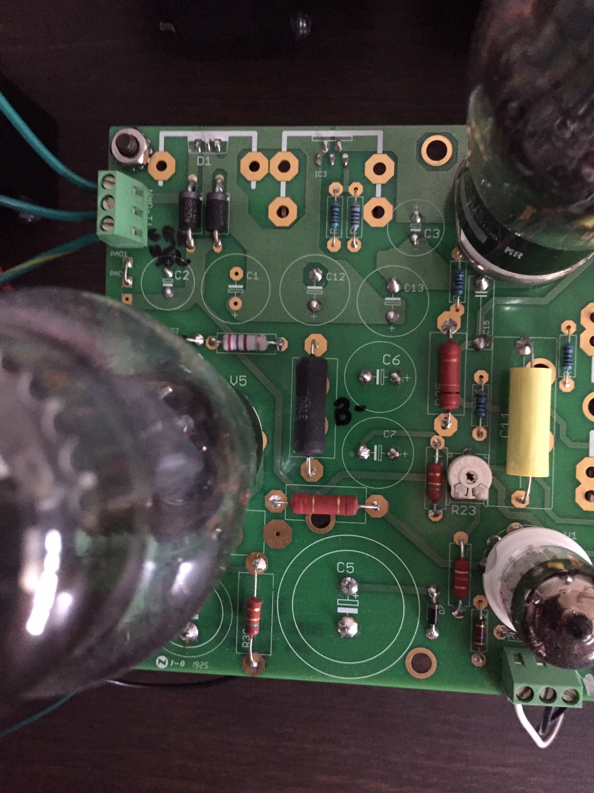

Where to connect meter for B- voltage
with R7 no longer in the design, where do you connect meter to see you B- voltage?
More specifically R6, that black resistor right over to there where it say "B-":
Across C7.

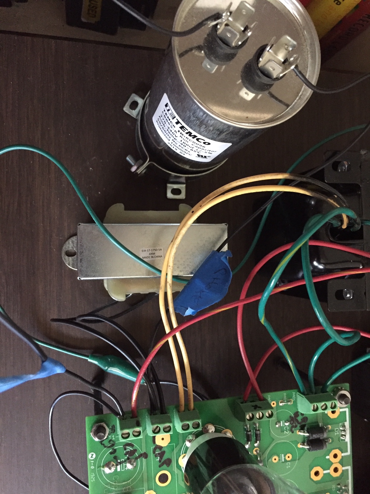

I am also at the part of the checkout where I insert the rectifier. My B+ is way higher than I expected. My PT HV winding is 265-0-265V @ 130mA and my power supply is CLC: 47uF cap -> 40H 480 ohm choke -> 150uF cap. Modeling this in PSUD, I should be getting about 285V B+, but what I'm measuring across R30 is 365V. Any ideas why it would be so high? This is for a 45-based amp.

Maybe I'm missing something, but you said your B+ was 372 with the rectifier plugged in... which is way too high for 45's as well. Even with all your tubes plugged in and your B+ went down to 339V, that's still too high. 45's should be operated around 275V, yeah?
Regardless, I still am not sure why my B+ is so high when PSUD reports I should be getting 285V.

On the website, he says he operates them at 325V. That's great that you can run yours so high, but I don't want to do that. I'm more concerned that my B+ is so much higher than expected given the components I have. Makes me think something isn't quite right.

I get a B+ voltage of -431v. I can't find anywhere what that voltage should be except that George states it should be negative v.
The B+ should be positive, and +431 volts is not out of line with only the rectifier tube installed. It will drop some when the 5842's are installed, and drop a lot more when the output tubes are installed and biased up.
If the B+ remains too high after adjusting to the desired bias current, replace C4 with a smaller cap. I have used as low as 4.7 uF in a board, to shed voltage but usually its 10, 22 or 33 uF.
The B- should be negative. I have seen voltages from -200 to -300 volts or more. The exact voltage does not matter. What is important is that the grid voltage at the output tube socket pin is negative, and adjustable by turning the bias pot. It should vary from around -20 V or so to - 90 V or so. Set it to the highest negative (-90 V) extreme before installing the output tubes.

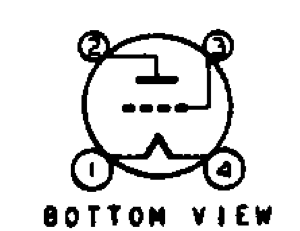

I'm measuring ~2.487 V dc at output tube pin 1, ~324 at output tube pin 2, ~ -76.8 at output tube pin 3 and ~ 2.48 V dc at output tube pin 4.
That's using negative probe on ground and positive probe in the pins listed above. Rectifier and 5842 tubes installed.

I'm not exactly reinventing the wheel here. I'm using a choke as suggested by the tubelab website, and I'm even using a PT with similar specs to the ones he used when getting 325V B+. And yes, all values were calculated with PSUD.
Thanks for that comment George! I didn't realize that the B+ would drop so much after the whole thing was set up. I got all the tubes in and biased the 45's, and now my B+ is sitting at 275V. Much better!
