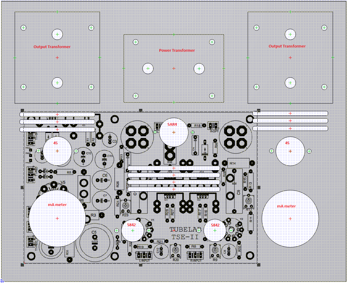

Another symmetric layout proposal

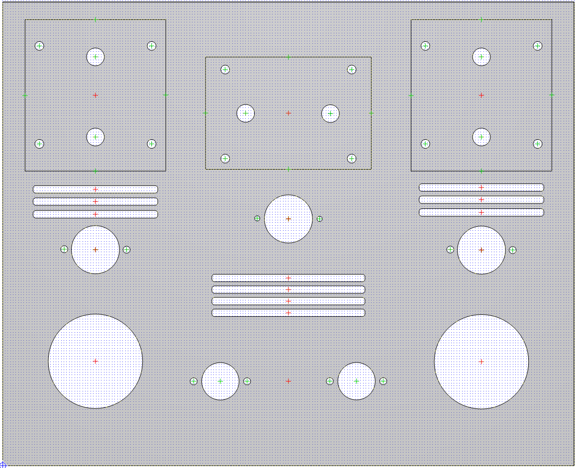

I had a similar idea to csample's symmetric layout and just happened to check up on this thread recently. Glad I did! I learned some things about proper remote tube placement.
Here's a couple pics of the layout I was planning. One showing the board placement inside the amp, and one not. I tried to adhere to George's recommendations for tube placements. In my layout, almost all components will be mounted on the front of the pcb, then the pcb will be mounted to the underside of the top of the chassis with long (60-70mm) standoffs. I have to do it this way for 2 reasons: 1, because there has to be enough room for the tall capacitors if mounted on the front of the pcb, and 2, because I want to fit panel meters on the top, so the board has to sit low enough behind the top panel to fit the meters.
Trying to figure out how it will all fit has been a pain, but if this has any chance of working, it'll be worth it.
