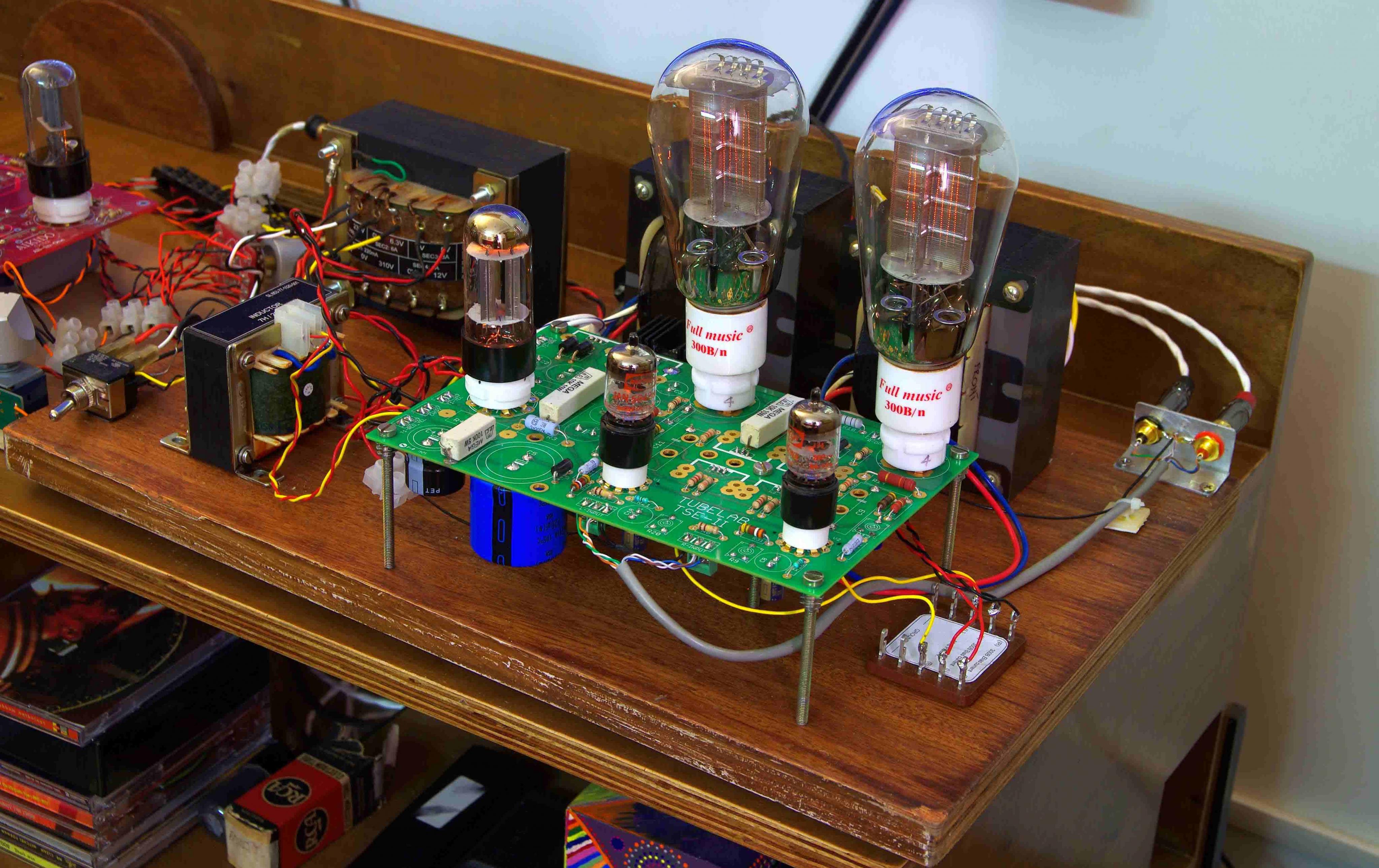

The amp is running. Sounds super with Altecs. No noise or hum with ears stuck into the horns. Surprisingly R6 is hotter than R36. IC3, Q1/2 and IC1/2 are just fine.
Edcor CXSE25 | 310-0-310v | 7H /60R /200ma
B+ - 350v
B- - 148v
5AR4 - 5.1v
300B - 70v| 5.3v | 60ma
5842 - 178v | 6.14v

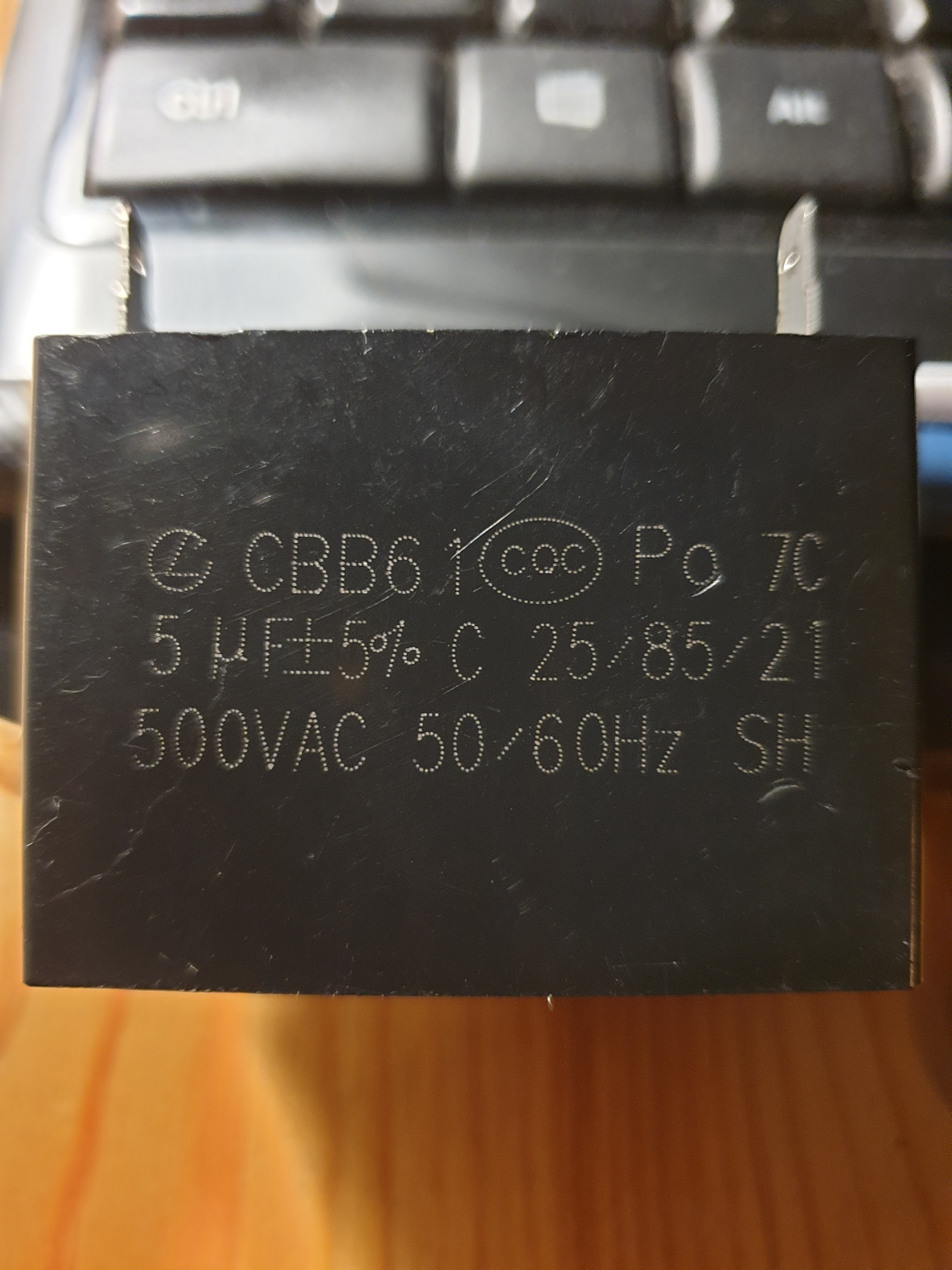

2) this 5AR4 gives 430V, just to remember to lower DC I should REDUCE the polypropylene microfarad correct? Now it's 10uf, shoud for example use a 5uf

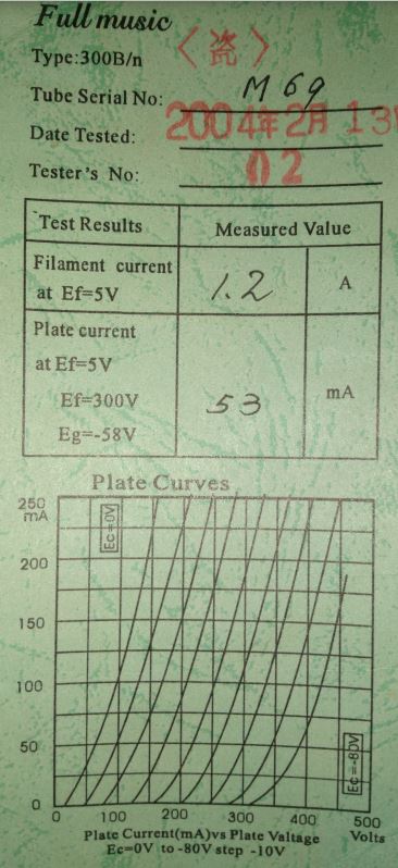

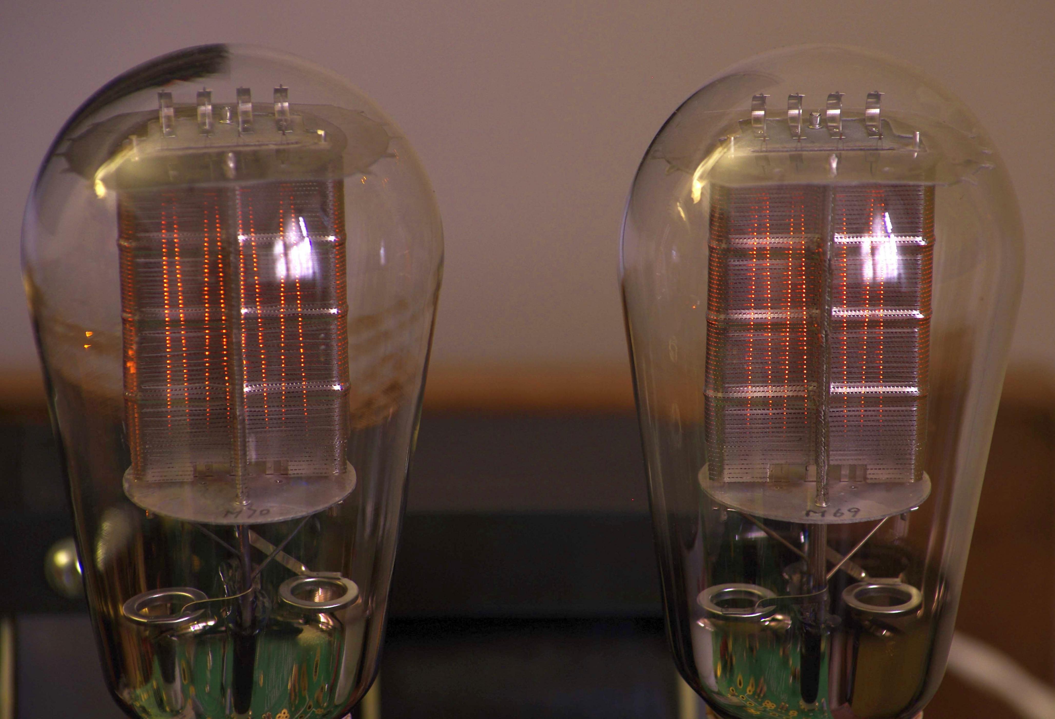

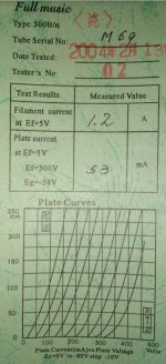

First DIY tube build - still bare, works fine and sounds superb. Runs between 360 and 370v ~ 67-70ma. I've built a test board for easy measurement on the right side.
Had a question, the tube test sheet shows plate V@300v and 53ma. Is that a minimum or just a result.
It is a test result used for basic testing and tube matching.
It means that when the tube is tested with 5 volts on the filament, 300 volts on the plate, and -58 volts on the grid, it drew 53 mA of plate current.
They should have minimum and maximum plate current values to determine that a tube is good before shipping.
Thanks George. Besides the sheet there was nothing else in the box.
I'm hoping they will give a few years of use with 360v/70ma that my build is running at.
