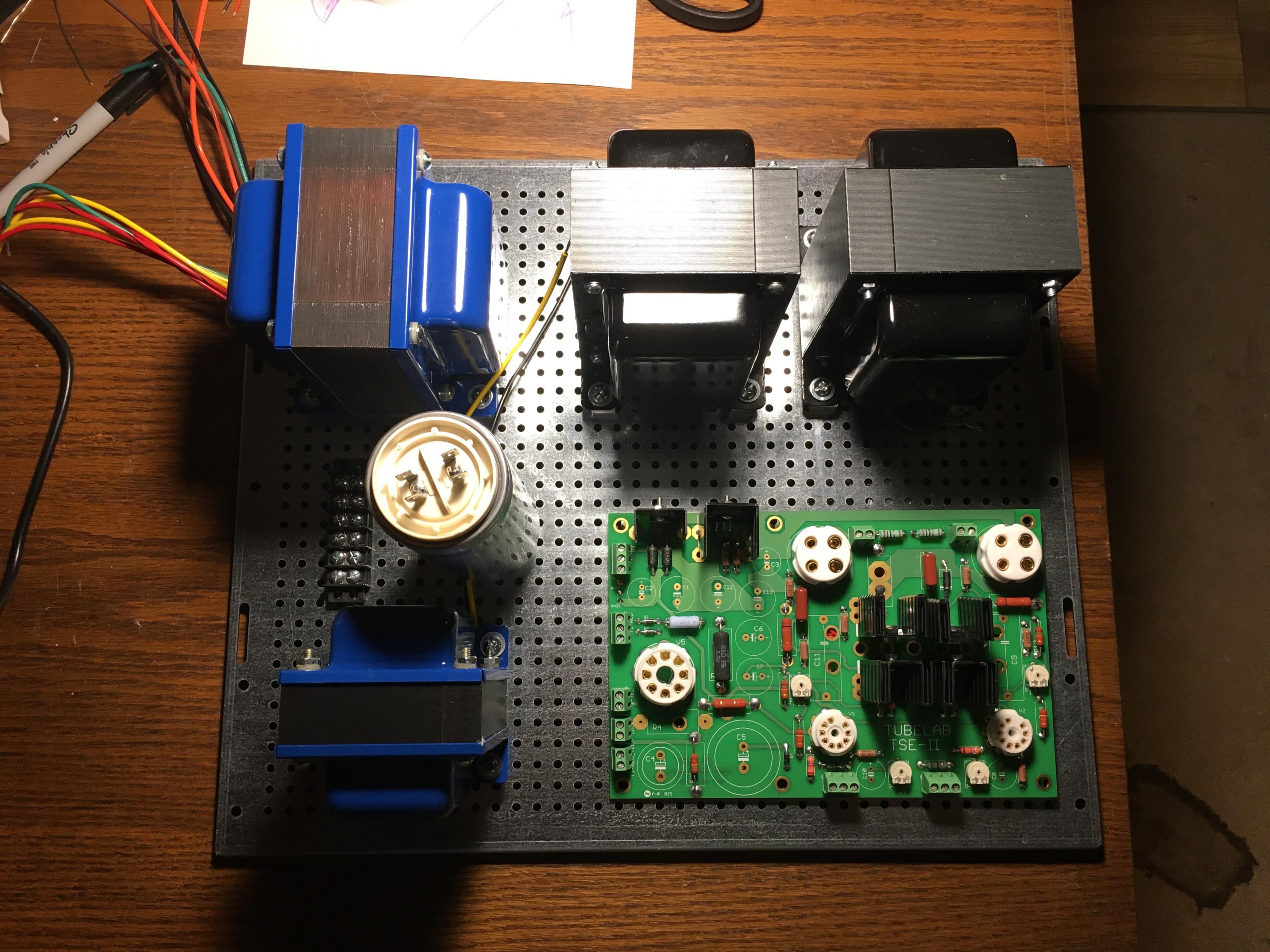

Any reason I can't ground a TSE-II like this?
Wiring Diagrams | Tubelab
Are you referring to the ground section in the middle of that page?
Looks like its basically what I did on my TSE.
I used a wire brush attached to a drill to scrap the paint off of my transformer feet to attach a ground wire to. I have a wooden chassis, so I had to wire up everything. If your transformers are mounted to metal, you still need to scrap off paint where the transformers mount. Paint is non conductive.
Make sense?
Randy
Yes, that's what I was looking for! Thanks all for your replies.
At the end of the day, I know that I can connect wires and see how it works.
This is a high voltage amp, potentially lethal, so handle with care.
As such, proper grounding is very important. Check your grounds with a meter, make sure everything that should be is really grounded.
I did just realize my inductor bodies are not grounded, but they are also buried inside my chassis so do not pose a safety issue.
One thing that is mentioned in the manual, and I remember from my first boss, is when you work on high voltage, keep one hand behind your back, or in your pocket, somewhere away from the amp.
You don't want high voltage to go through your body. If you only have one hand in the amp, there is no way for the voltage to get through it.

There are a few ways but that arrangement is pretty popular. That's also how I did it.
You can see the end result in this post:
https://www.diyaudio.com/forums/tubelab/331038-14-run-tse-die-48.html#post5910810
The FPD is shared a few posts after if you're not drilling manually
If I were you, I would rotate all transformers 90 degrees so that OPT would face bell cover to bell cover.how does this general arrangement of the major components on the base plate look?
